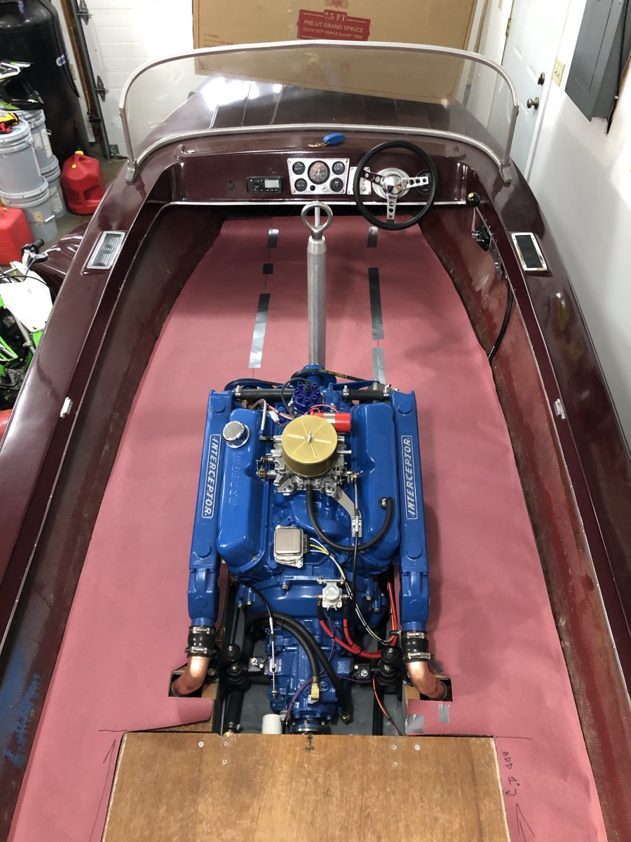

    Here’s the engine installed (reposting photo).

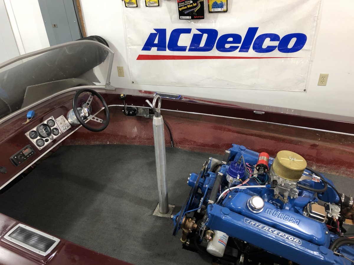

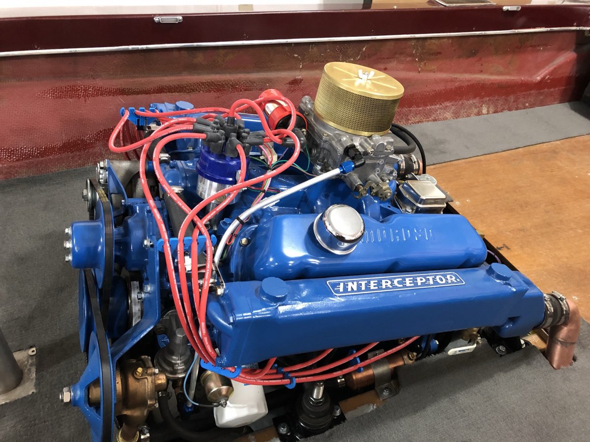

    I brazed up the copper exhaust last summer and connected it with silicone couplers. All control cables are new and are smooth as ****er. Rebel wiring built me a custom harness which I just started to install.

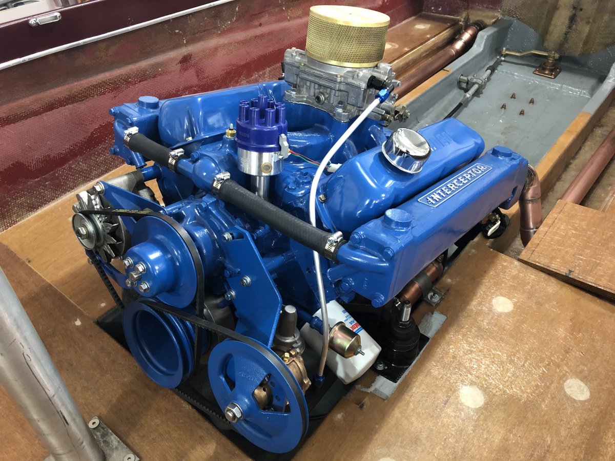

    Okie Pete, Lepus, RICH B and 2 others like this.

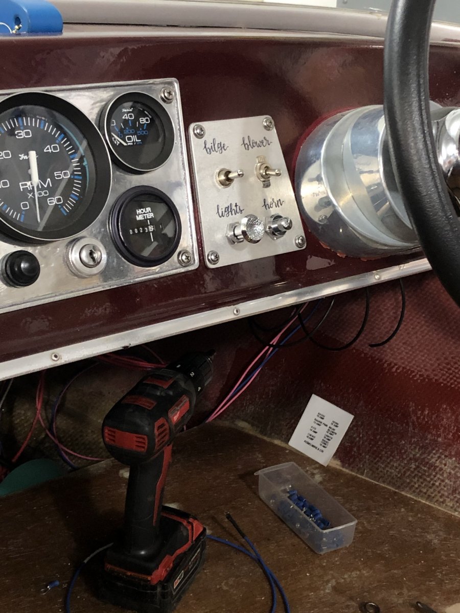

  3. Chucky
    Joined: Mar 15, 2009
    Posts: 1,867
    Chucky
    Moving right along with the harness. The back is done, as is the engine. I’m under the dash now and about half done. Things are progressing nicely. My daughter lettered my switch panel. My son hands me supplies. The hour meter is used and has 23 hours on it, everything else is new.

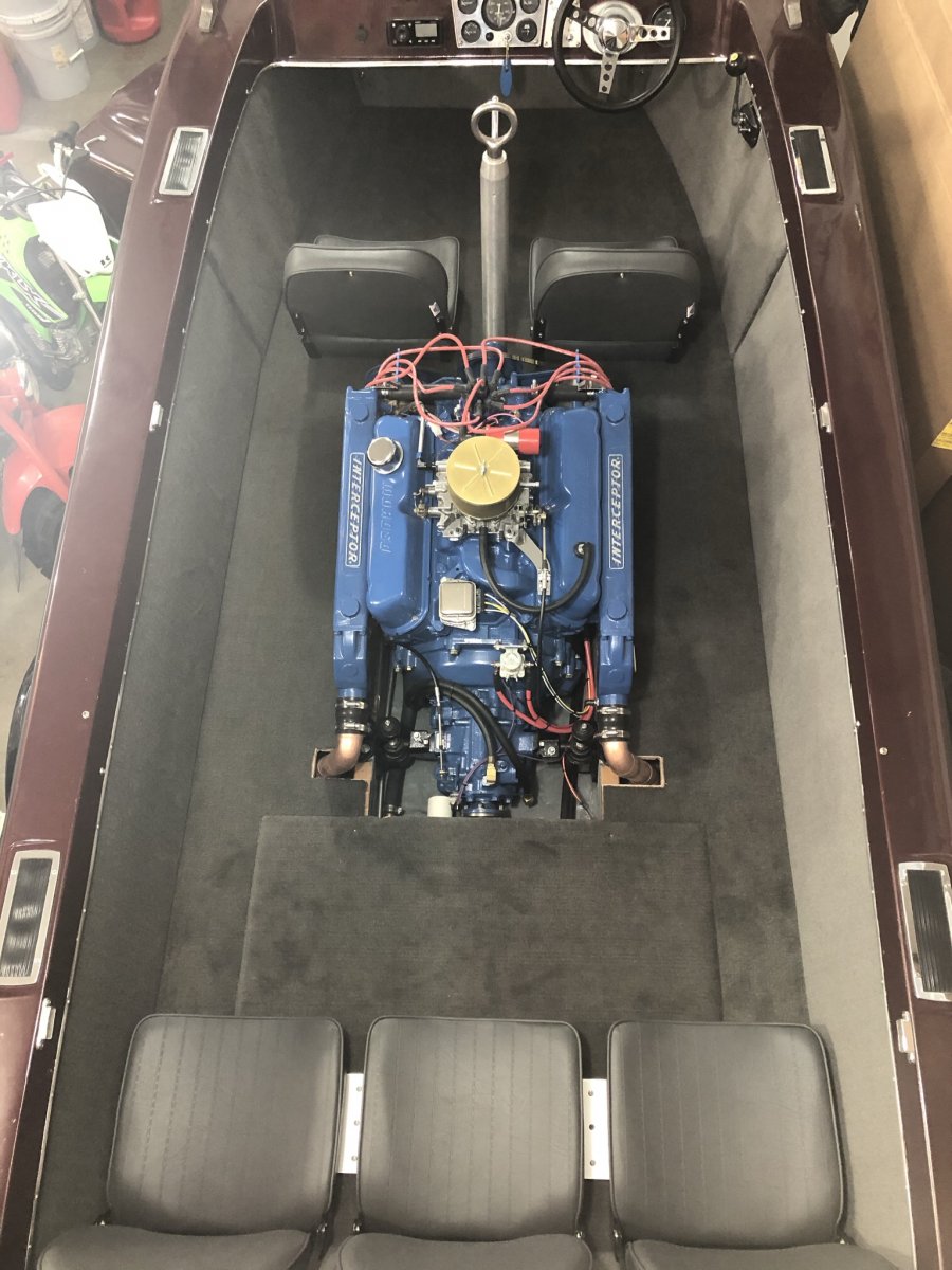

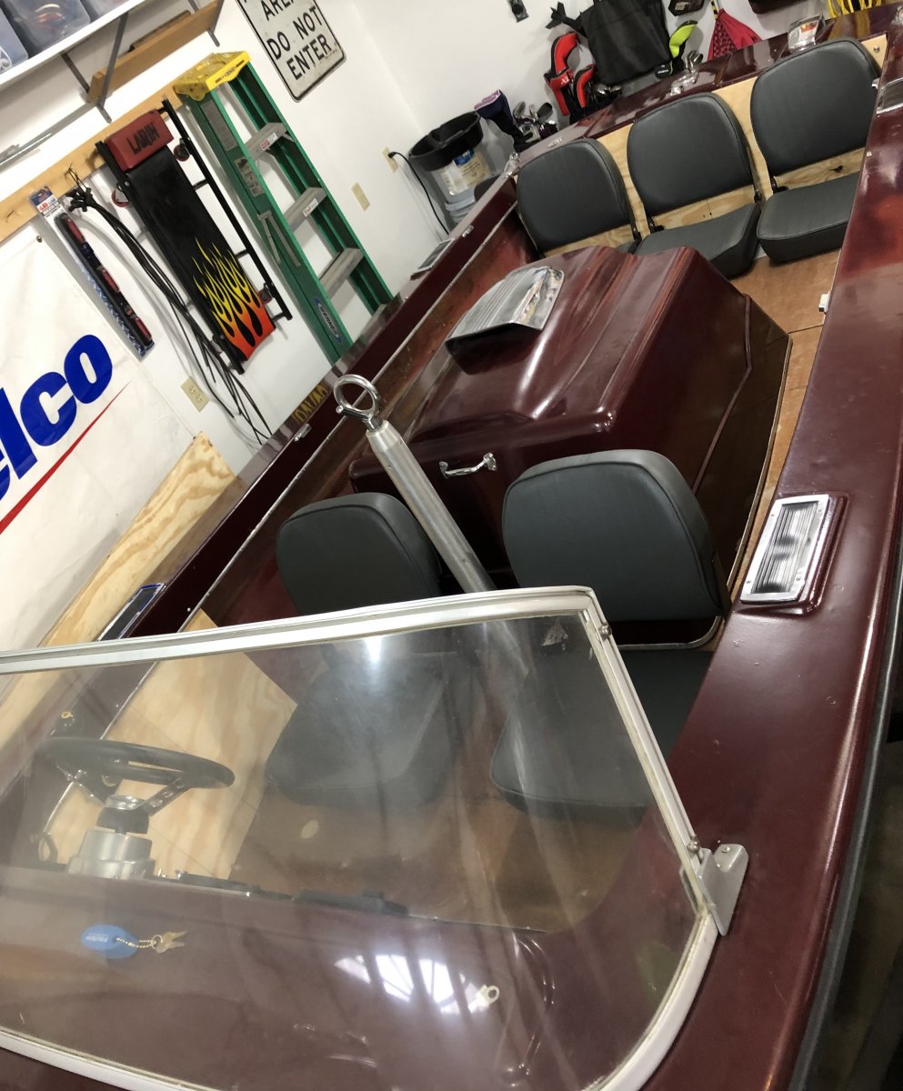

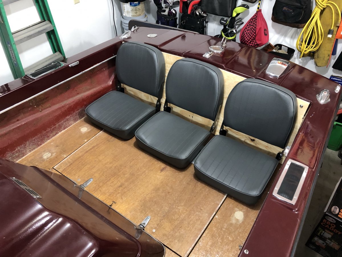

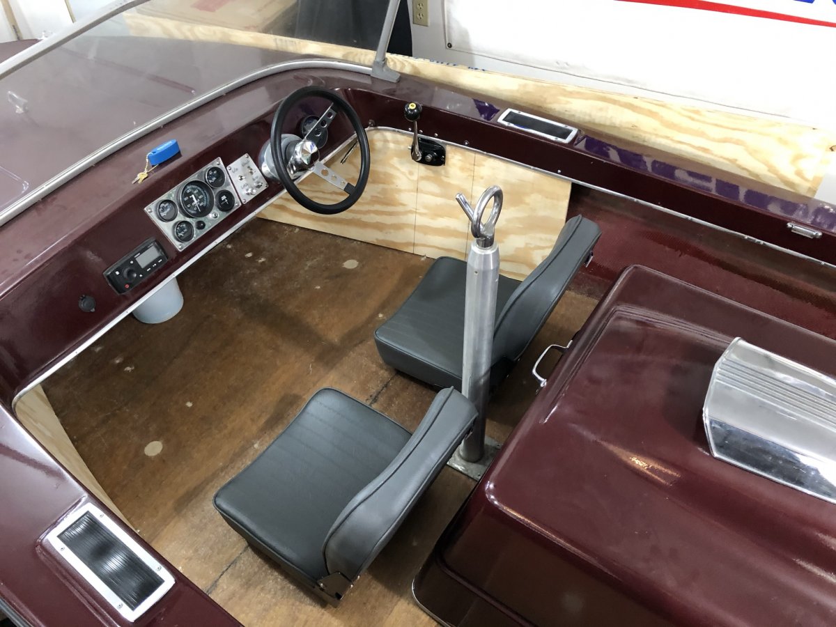

    I’m not using the factory fibergl*** rear bench seat. The ergonomics of it are horrible, even with cushions. I opted for these (cheap) folding low-backs. The front seats both fully rotate. The rear seats are all mounted to a 1/4” thick aluminum sheet, making them like a bench seat. The wiring is 99% done. The doghouse is mounted. Carpet is coming soon!

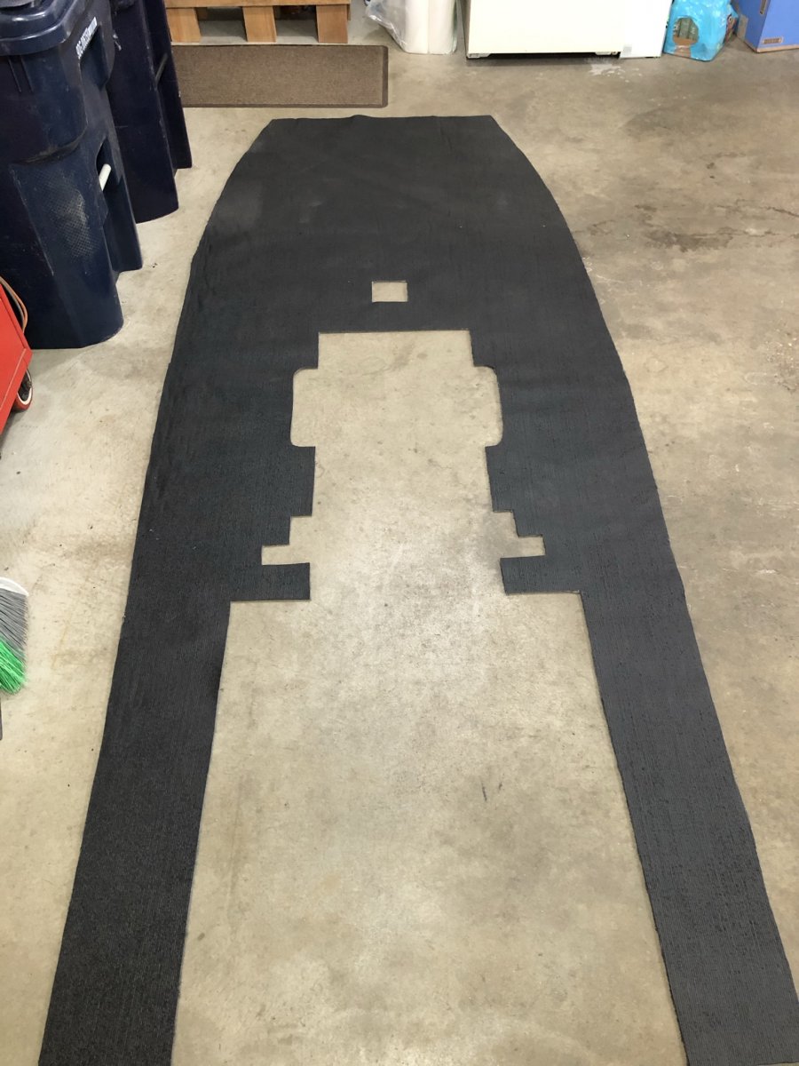

    Made a rosin paper pattern today. Transferred that to the new carpet and I’m on my way.

    I hate making spark plug wires. Not a huge fan of the red, but they came with the project.

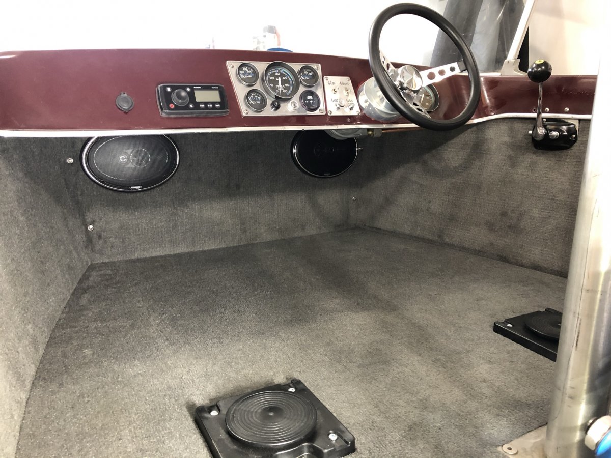

    I also hate making interiors, but it’s coming along quite nicely. My son approves of the stereo.:)

    @LBCD - I did fab the panels using regular plywood in the 11/32 thickness. I’m hoping that thickness will resist warping. It’s not like they get soaked, unless something goes really wrong. And, the carpet has a rubbery backing that provides some protection too. I learned the plywood grain matters when making a curved panel. It would also help to glue the carpet to the panel, if the panel is curved. I used an Arrow brand pneumatic stapler and a box of 1/4” staples from Home Depot (under $50 total). My boat had existing holes through the fibergl*** lip that surrounds the majority of the interior. I used the rounded head, stainless steel screws along with the stamped, domed stainless washers to attach the panels. The panels are not attached at the bottom, however, because it’s carpet on carpet, they are quite secure. Keep in mind the panels get larger in all dimensions after attaching the carpet and that fact can affect hole alignment if you’ve pre-drilled.

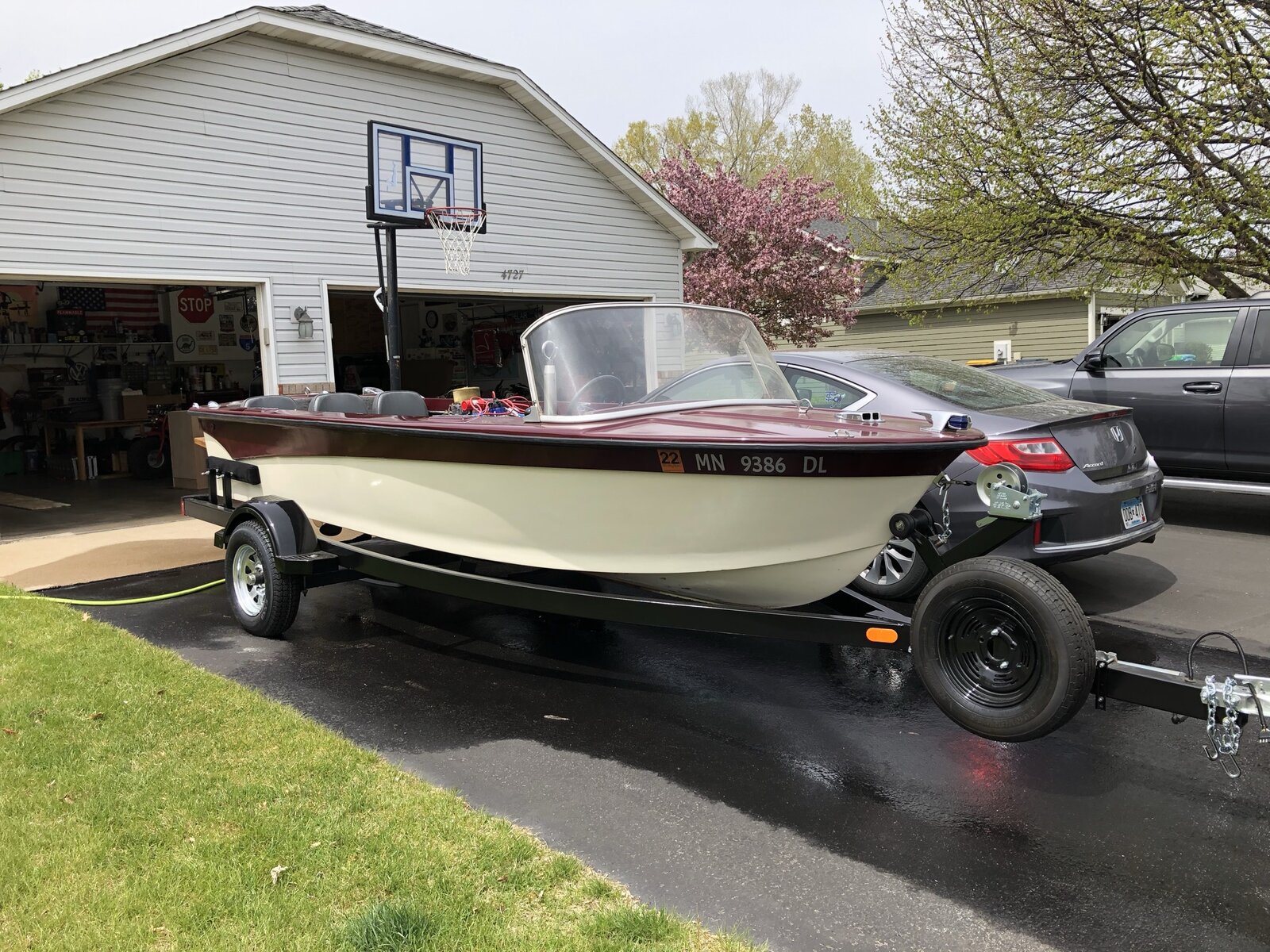

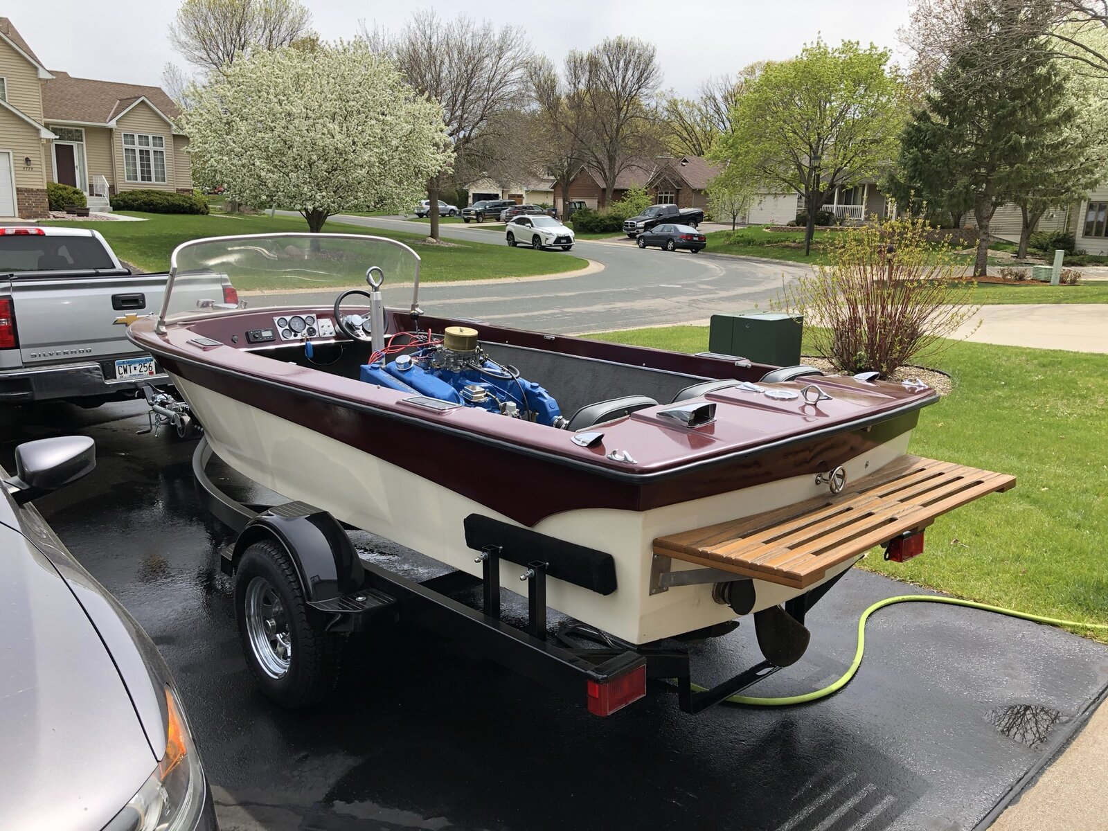

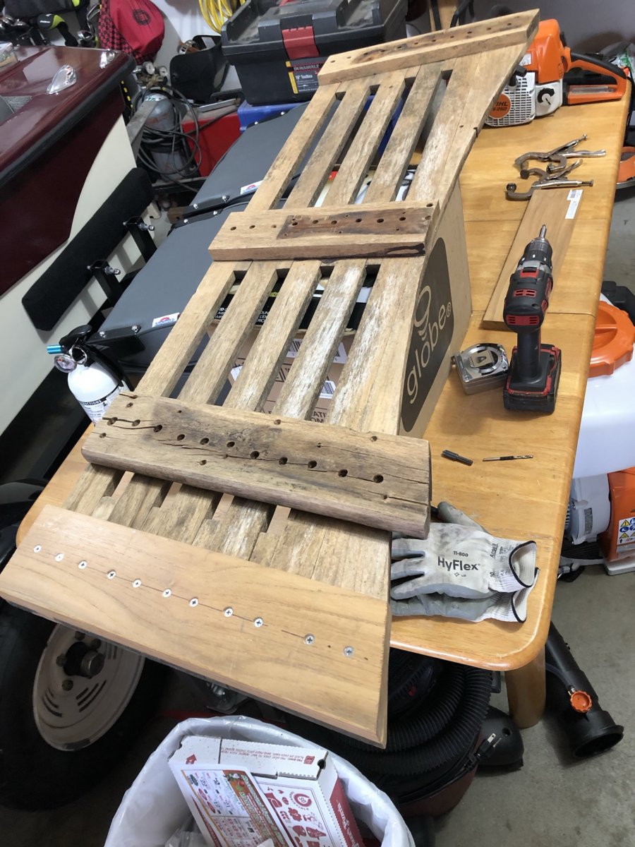

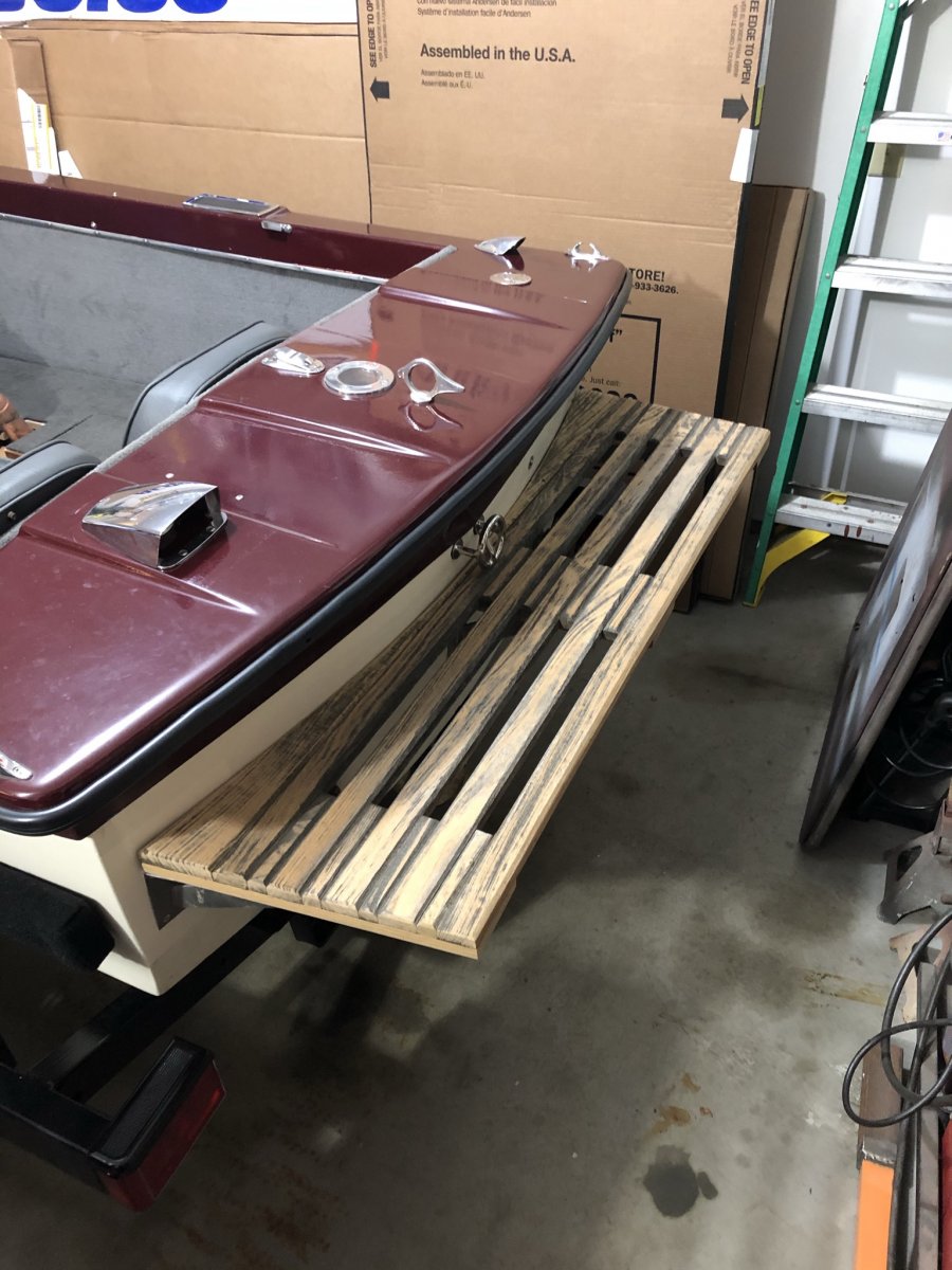

    I made some progress on the non-stock swim platform. New wheels and tires for the trailer showed up today...can you say “hit it!”:p

    If you want, you could pressure wash that teak swim platform then let it dry and sand it. It will end up looking new. As a retired "yacht carpenter",I know what I am talking about...

    Agreed, you gotta sand those gray spots out of the wood, then drench it in oil. Never poly or paint...
    It also may behoove you to back it off the transom some, it looks like it is touching. I'd personally round those sharp corners while I was at it, but not totally needed.

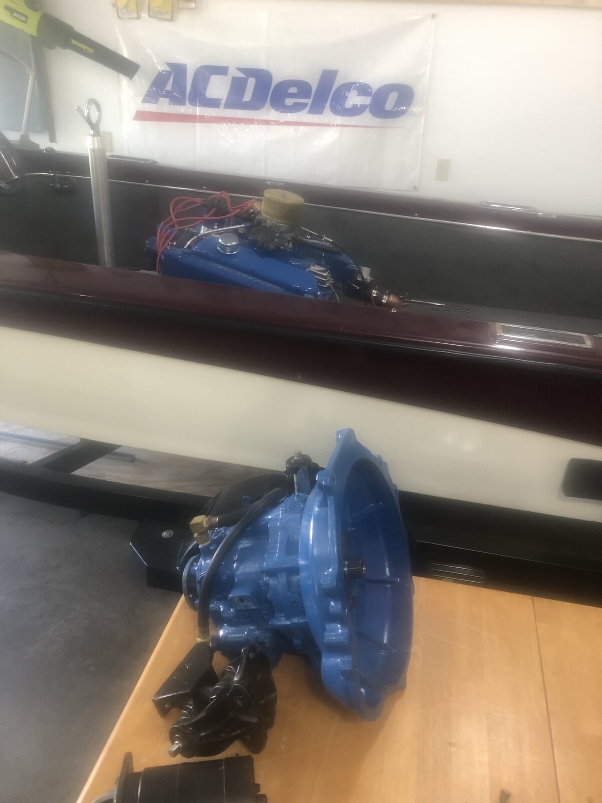

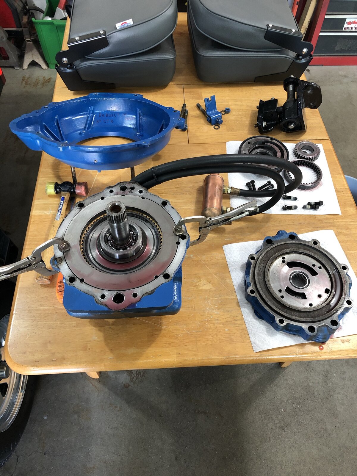

    I guess I’ve been too busy to update this thread. Well...The engine runs great, but the trans was stuck in reverse. Turns out, I had too many clutches in the reverse pack. I finally had time tonight to yank the trans and correct the problem. I’m hoping to re-install tomorrow night and get it on the water this coming weekend. 35EF02DC-9046-4E94-B279-558DFD6B28A6.jpeg 3416927A-82E0-4297-B700-B6EC992E15EC.jpeg
