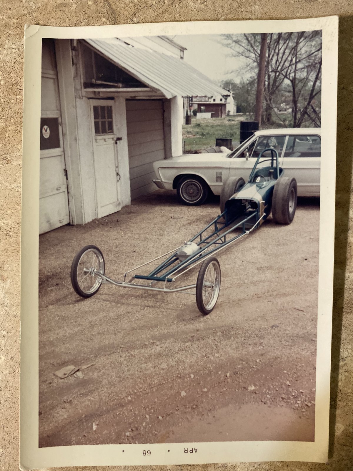

    C/D was for small cu in and lite weight cars. D/D was for flatheads in-line 6 and other combos. C/D couldn’t exceed about 4 lbs per cubic in. Max cu in was 300. Here’s a photo 67 C/D my dad had with Desoto

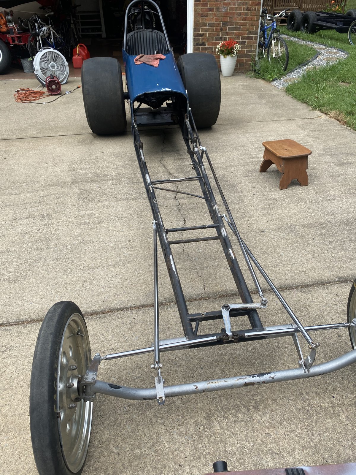

    Scott Mize
    Today cleaned up all the added tabs and brackets that weren’t original. Found 3-4 places that will need to be tig welded but no major issues.

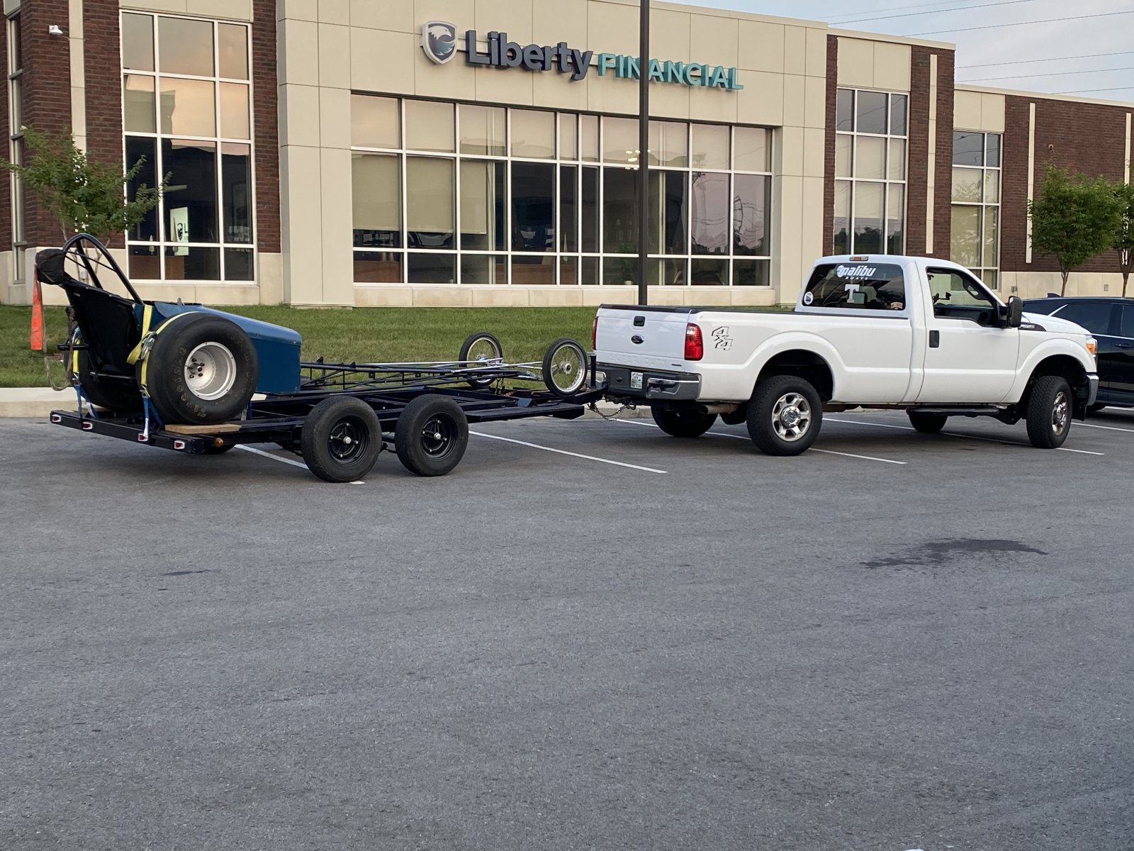

    Scott Mize

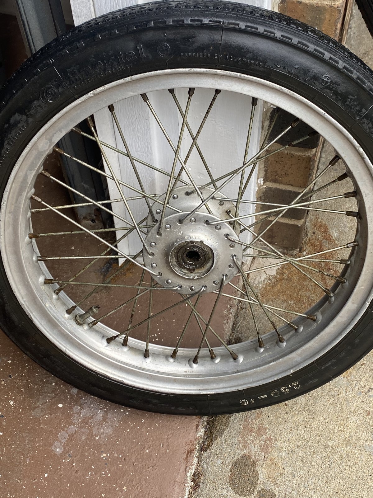

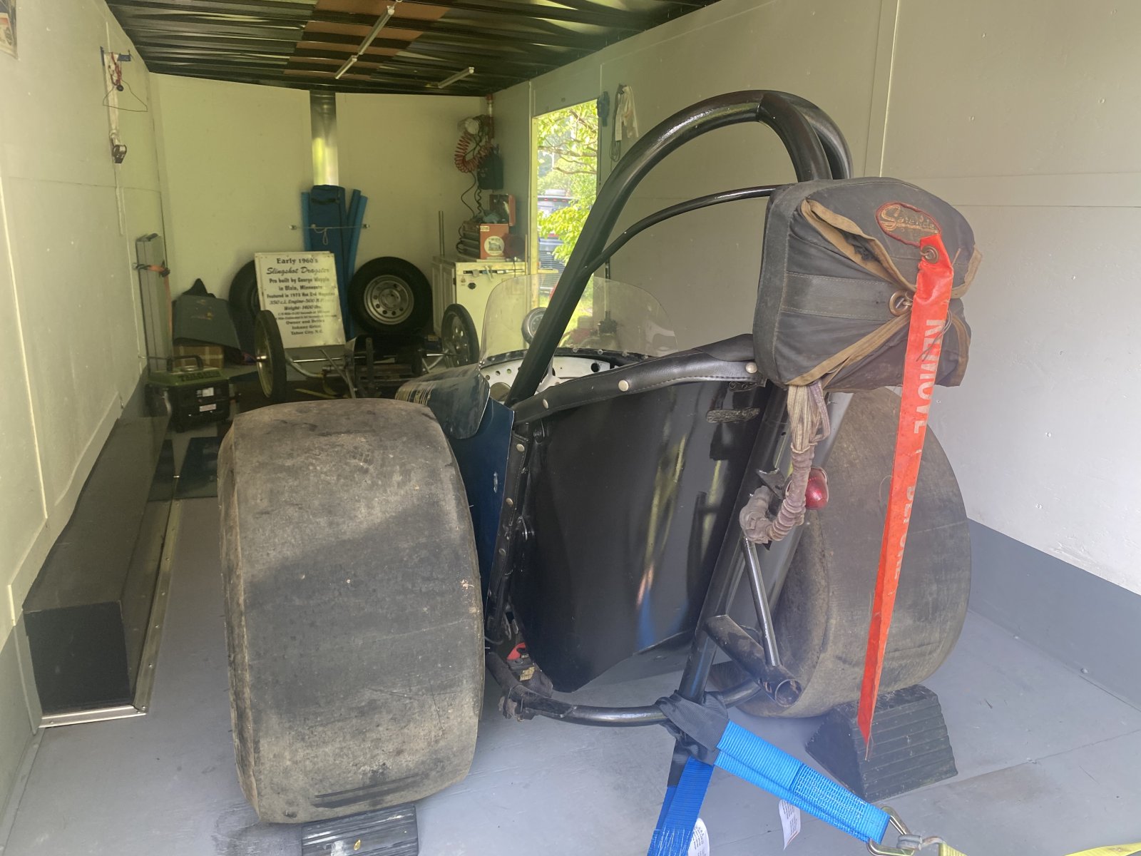

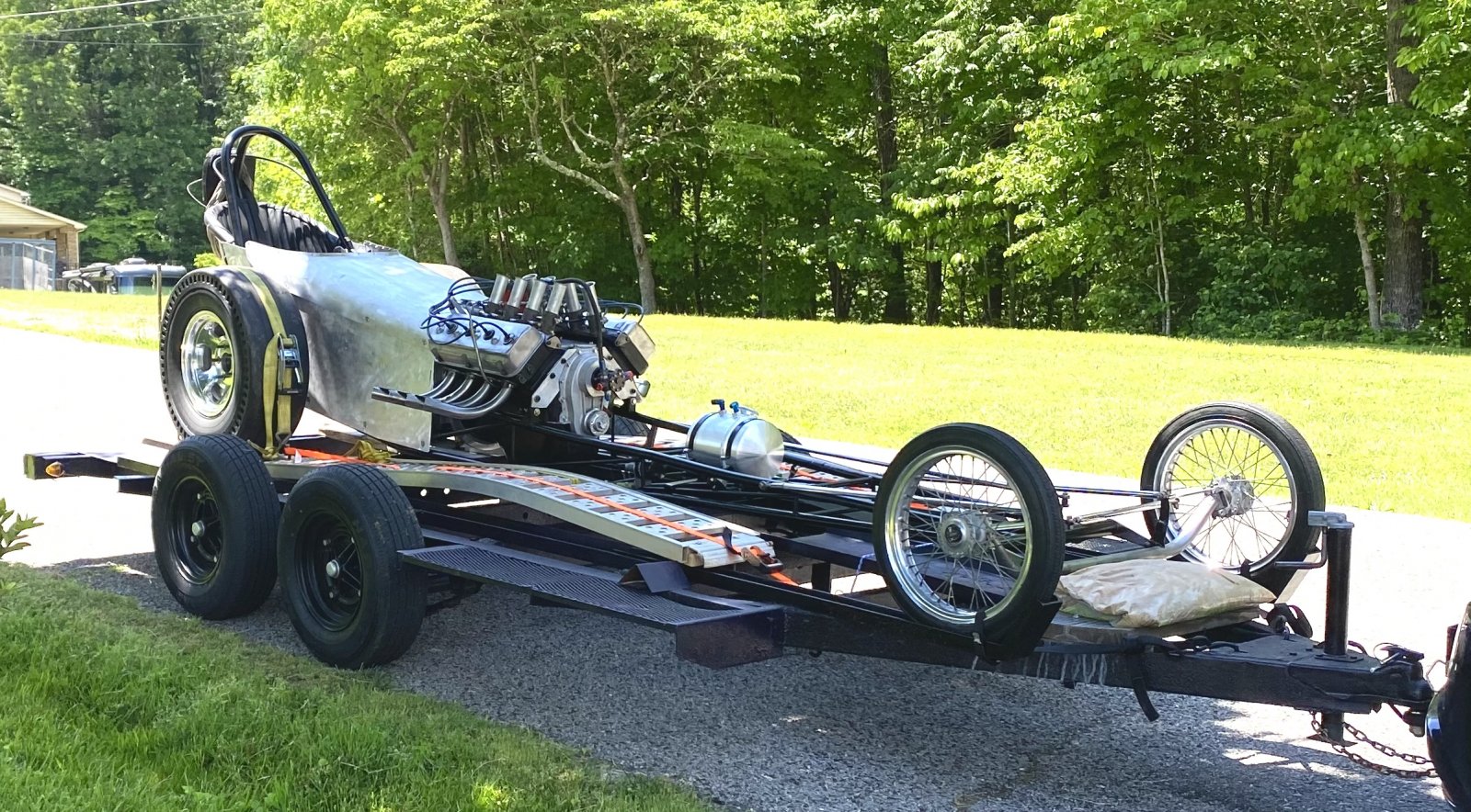

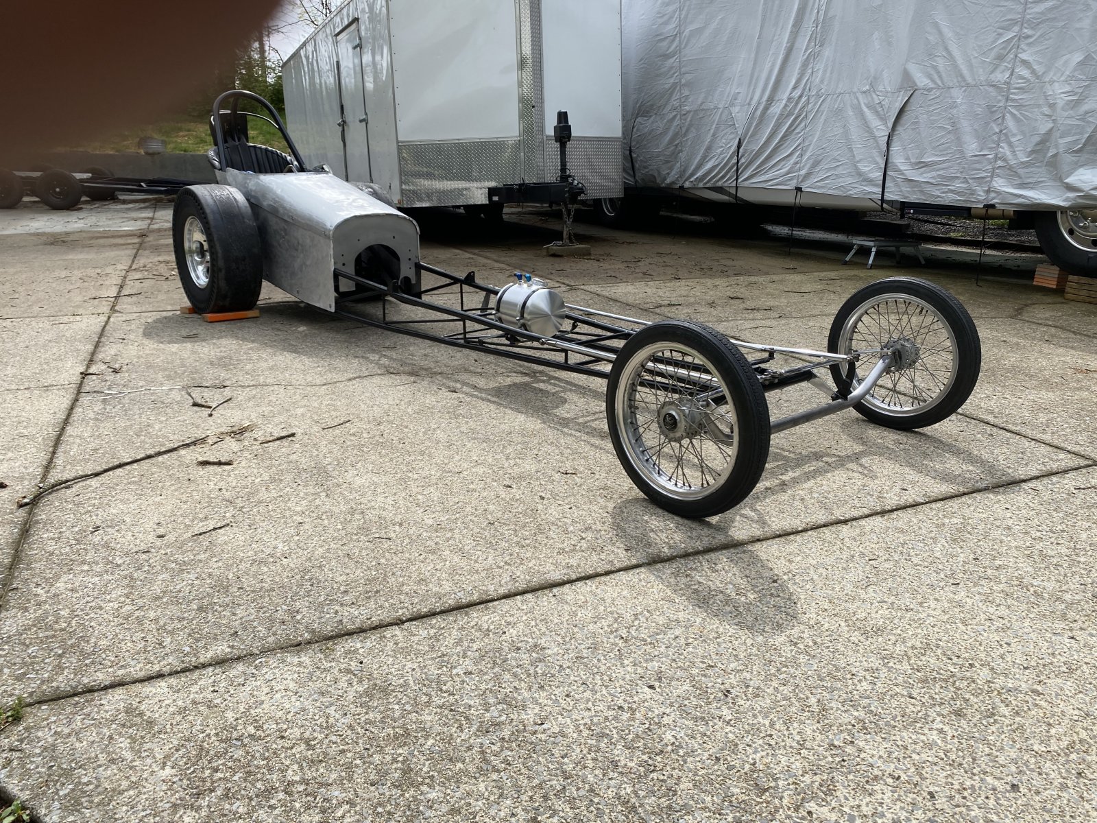

    First time on flat trailer.

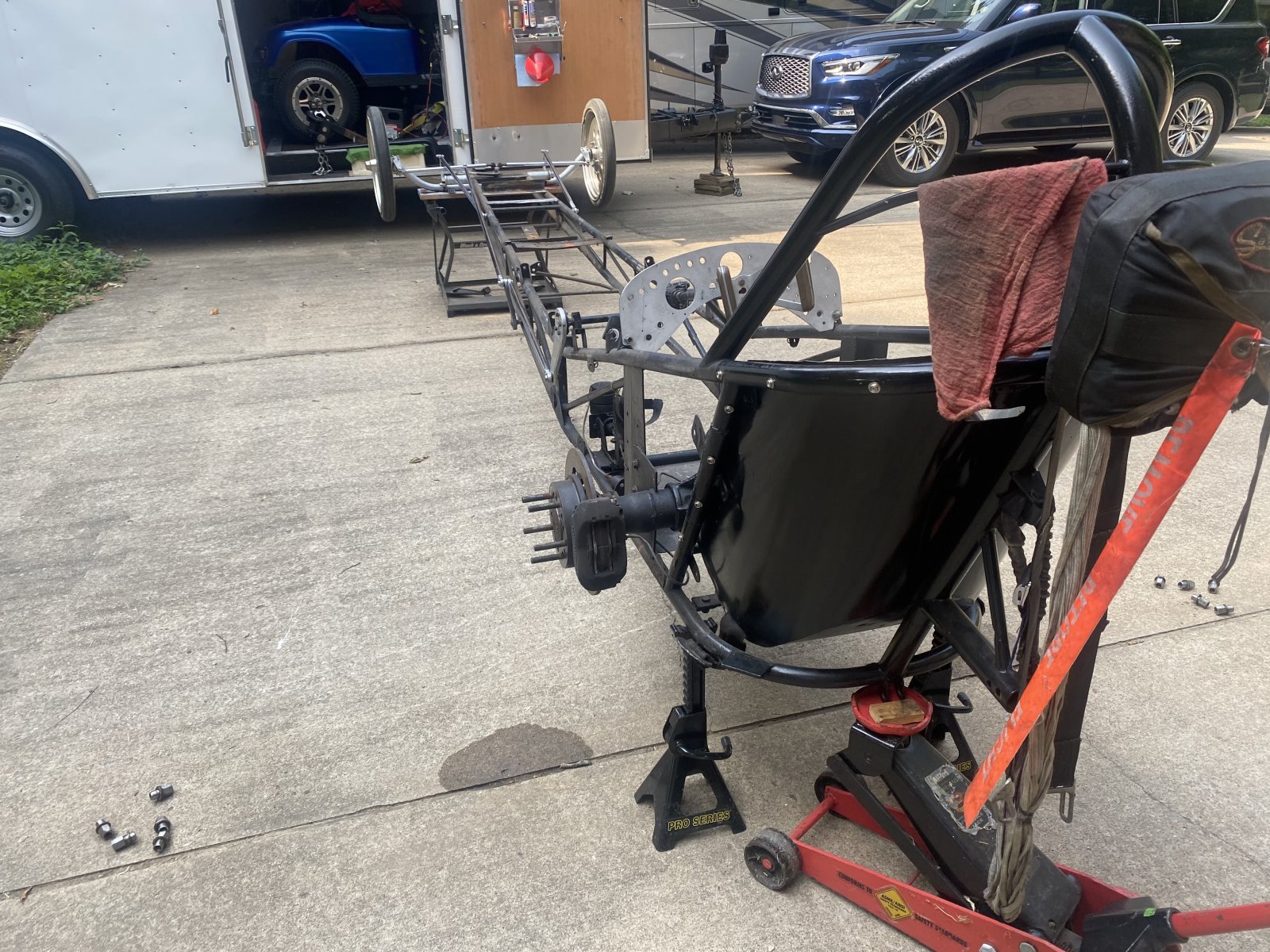

    Dis***embled front end for cleaning
    saltflats and loudbang like this.

  18. Scott Mize
    Joined: May 29, 2017
    Posts: 87
    Scott Mize

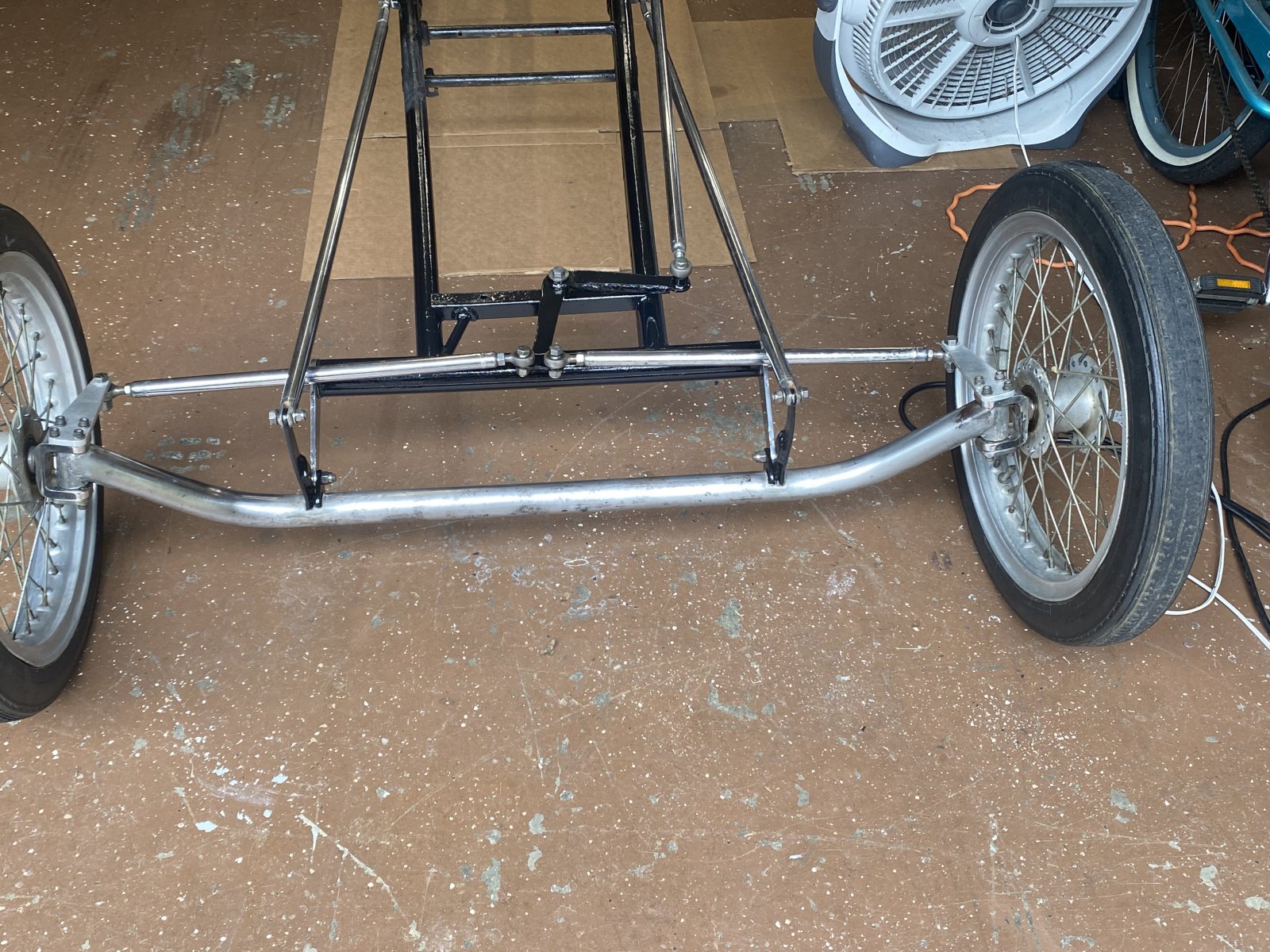

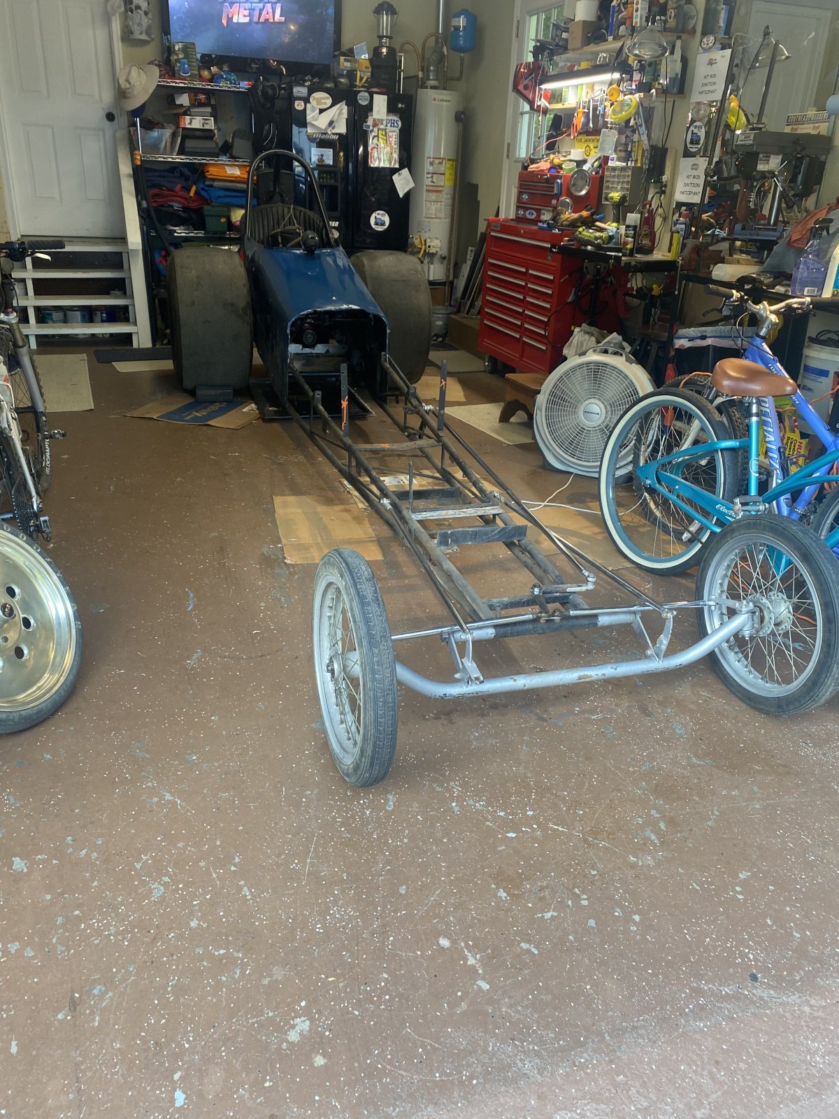

    Finished dis***embly of front end. Cleaned 4 layers of paint off front axle. Cleaned and cleared the axle. Not going to Rechrome from axle.
    AHotRod, 427 sleeper, Chucky and 3 others like this.

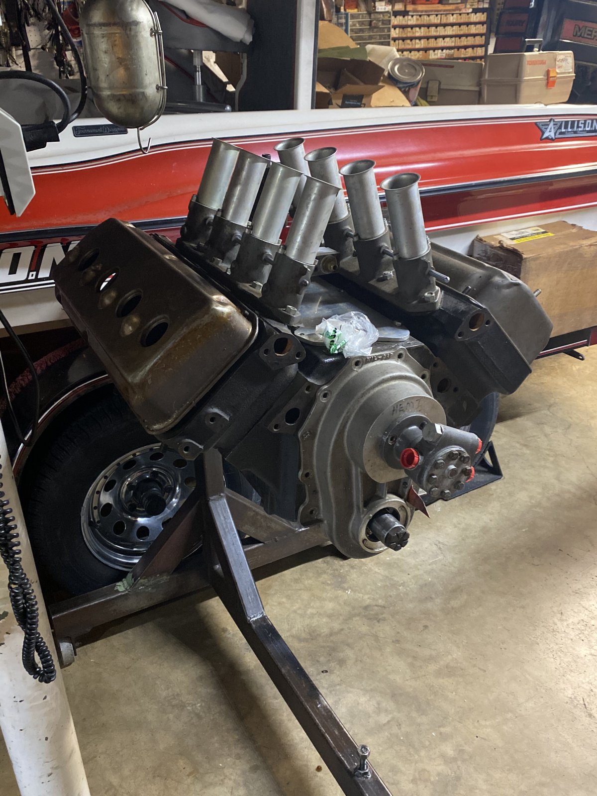

    Finally have the engine mounted with handmade motor mounts and firewall.

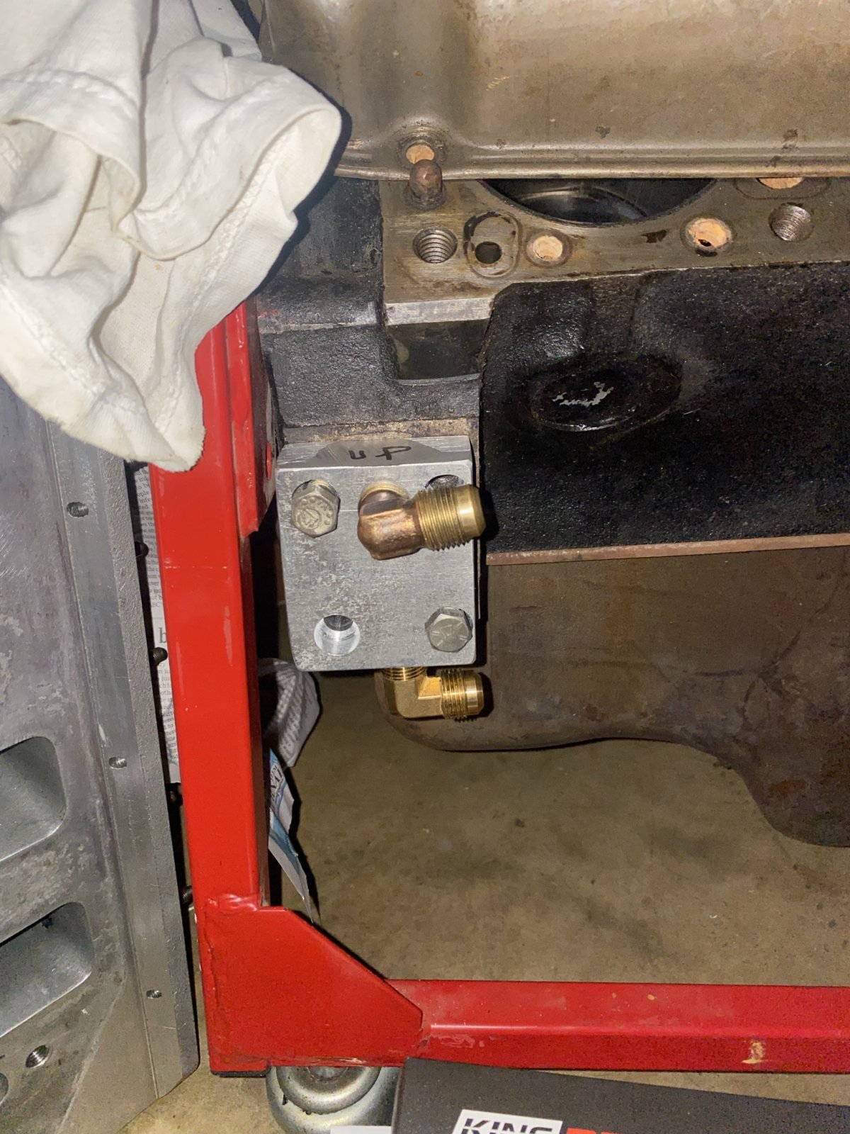

    Also made a oil filter bracket to clear frame and supply remote oil filter
    Fordors and loudbang like this.

    Have the engine/powerglide mounted with handmade firewall and handmade motor mounts. Dad is doing all the Fab work and he is 85 years old.

  23. A lot of the old frames are rusted from the inside out. I think as a cackle car you are ok but when hauling the car, build a support to keep the frame from flexing. You might avoid a surprise. :)
    FinnishFireball likes this.
  24. Scott Mize
    Posts: 87
    Scott Mize
    Thanks for the info. I was lucky that the frame has always been stored inside. We did as thorough a check that could be done including some repair work on two very small cracks. All paint was stripped off with a razor blade and not one area with rust was noted. We will cackle and maybe do a burnout but otherwise it won’t make full p***es

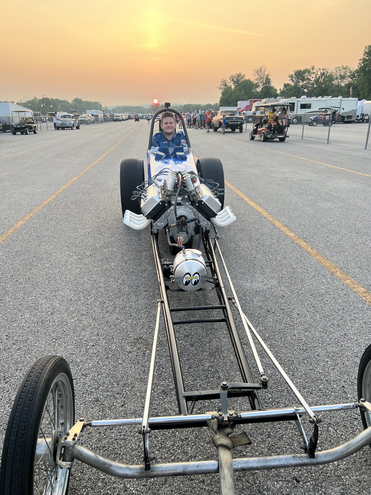

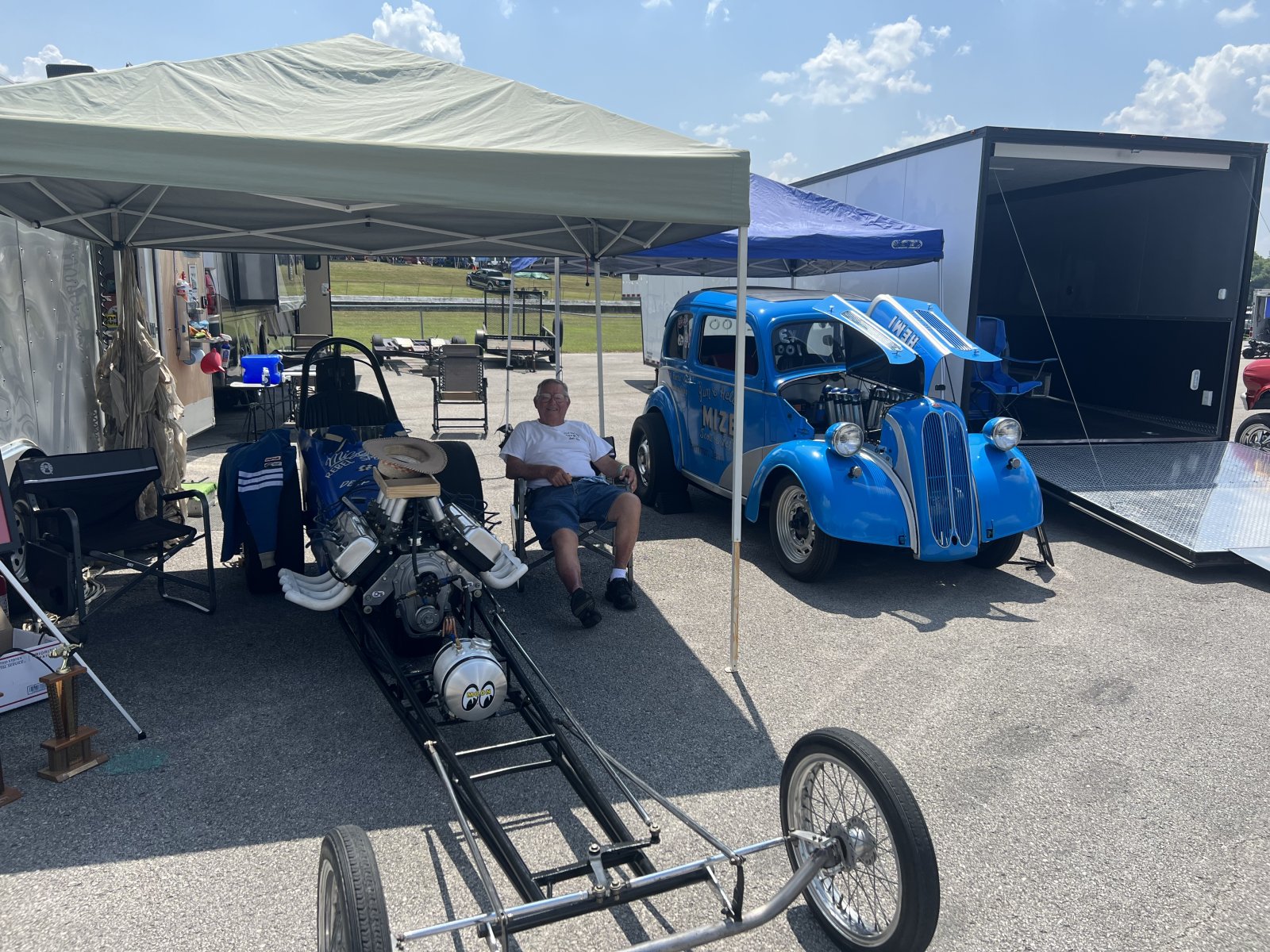

  27. Scott Mize
    Posts: 87
    Scott Mize

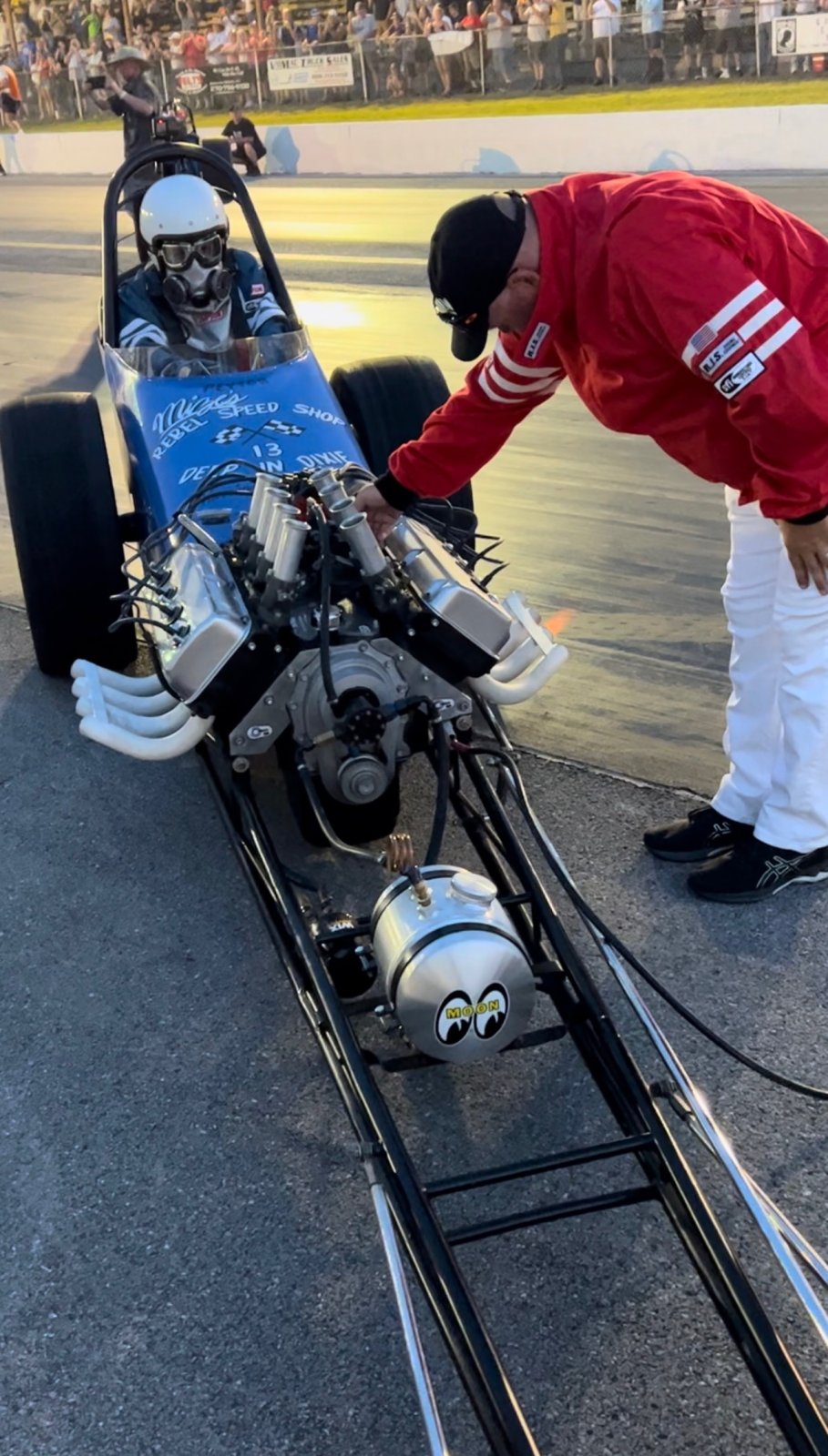

    Well we’ve finally got the dragster finished and cackled it at the Wally Parks Nostalgia Nationals this past weekend. Some photos. IMG_8952.jpeg IMG_8911.jpeg IMG_8951.jpeg IMG_8952.jpeg IMG_2749.jpeg
