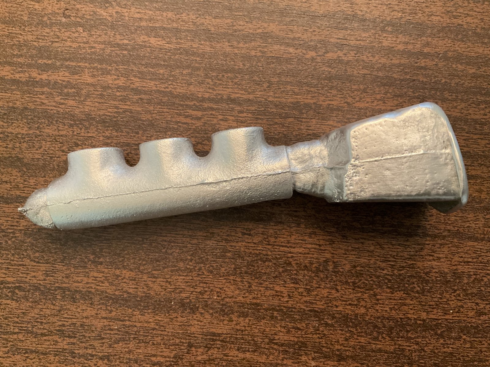

    A somewhat successful pour, today! I changed my approach for inlet and outlet sprues. Though, the risers on the bosses remained the same. I did puff some graphite into the mold cavity and upped the pour temp to 760 C. The humidity was low at 57%. The outcome was a really busy piece:
    The surface finish is pretty nice. But, there was some pocking/bubbles (maybe?) on the bottom of the casting:
    It’s hard to see, but there was some shrinking on the center boss. The two end bosses were pulled down a bit toward the center. Probably why the surface finish in the center is a lot rougher than the ends. Notice the risers didn’t fill to the surface of the flask, again.
    So, here’s a picture of the fuel block with all of the gates and risers cut off. Now, it’s easier to see how the center boss sank and pulled the other two. The center surface finish is really rough, as if the shrinkage occurred under the “skin” of the casting.
    I think I can solve the shrinkage by upsizing the input/output gates and the risers on the bosses. I’m making a set of sprues and gates that I can attach to the pattern. They should help make the fill smoother and more consistant. It should be way better than my “guesstimate” mess on this pour! :)

    I think you are being pretty hard on yourself. That looks very good. You have learned a lot.

    I agree. The finish is typical of sand cast parts. I think you will always have shrink to deal with on that design.
    Hand file the tops of those bosses and call it good.

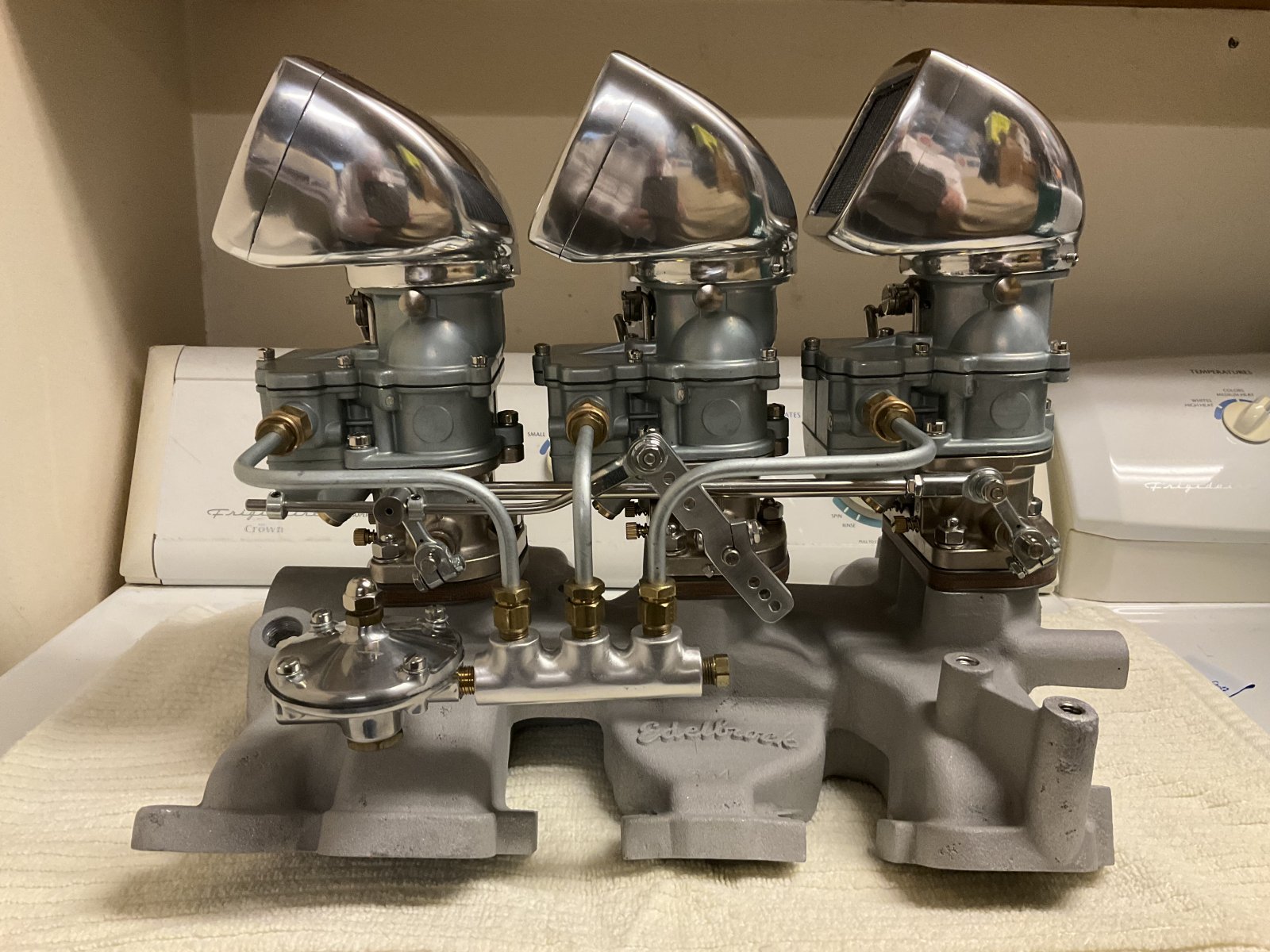

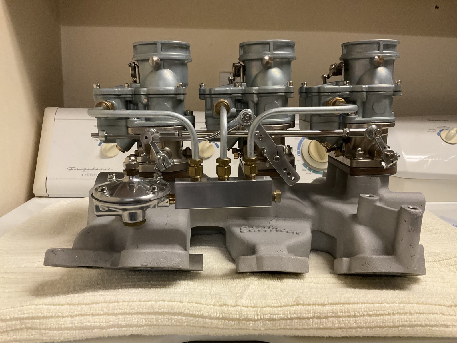

    So, here’s a mock up of my Y-block 3x2 (Chinesium carbs on a rather beat up Edelbrock 354) using a fuel block I made from a chunk of aluminum. Functional, but not an especially good look:
    Here’s my cast fuel block after drilling/taping and a little filing and sanding:
    It definitely looks better than the chunky block! Considering I have never done any metal casting before, I think it was a successful project. :)
