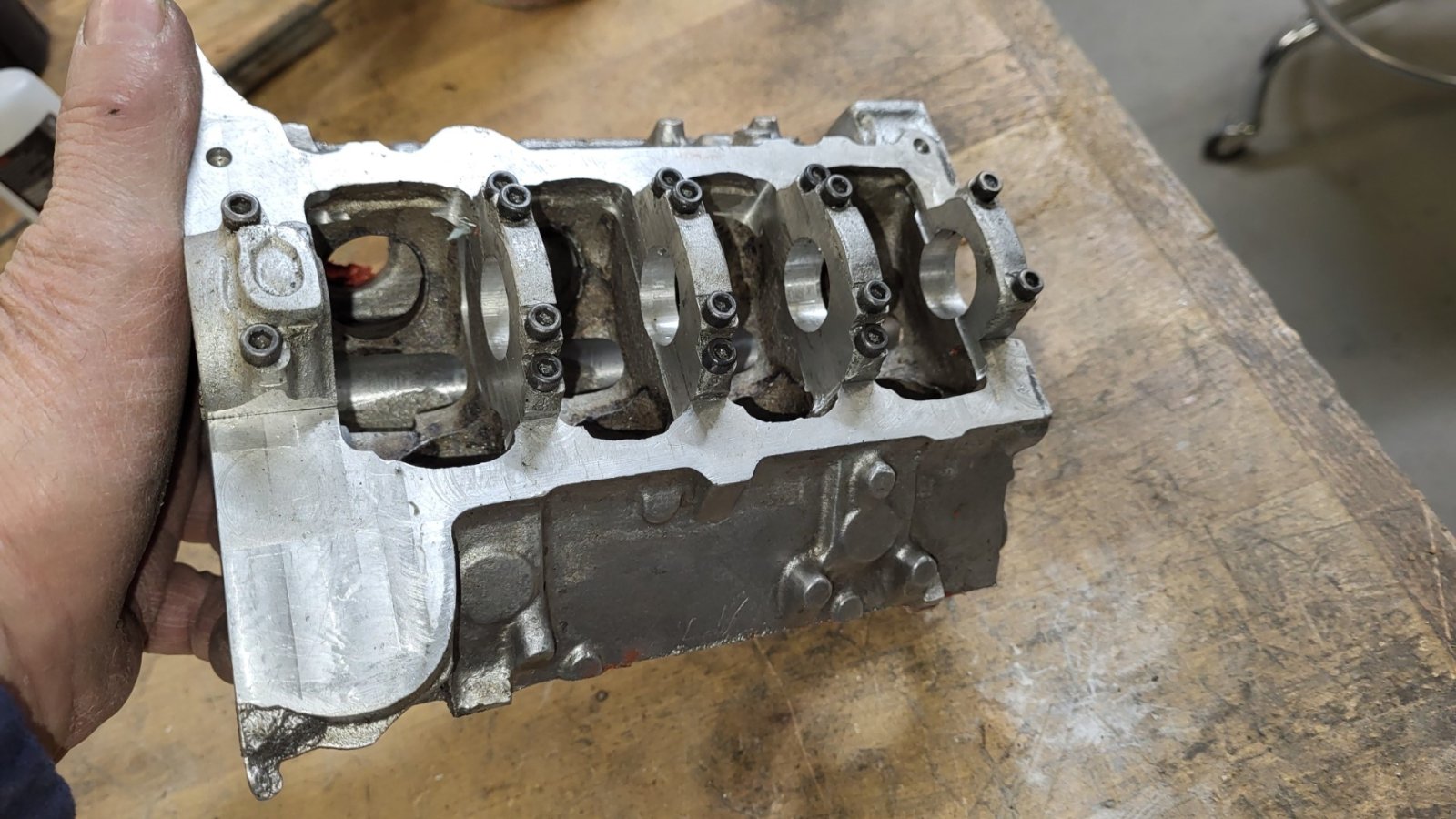

  4. Sandcrab
    Joined: Jul 25, 2022
    Posts: 221
    Sandcrab
    This is the block in my avatar. It was poured from aluminum wheels and quenched. The machining was done on a CNC mill and here it is with the caps ready for final line boring and the flycutting operation to face the web and cap.
  5. patsurf
    Joined: Jan 18, 2018
    Posts: 3,407
    patsurf
    that is relatively HEAVY showing off-even if it is LIGHTWEIGHT--wow!!!
    High test 63 likes this.
