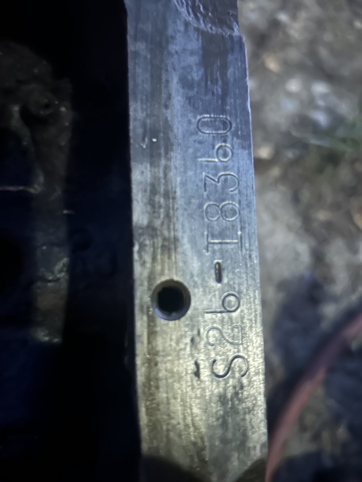

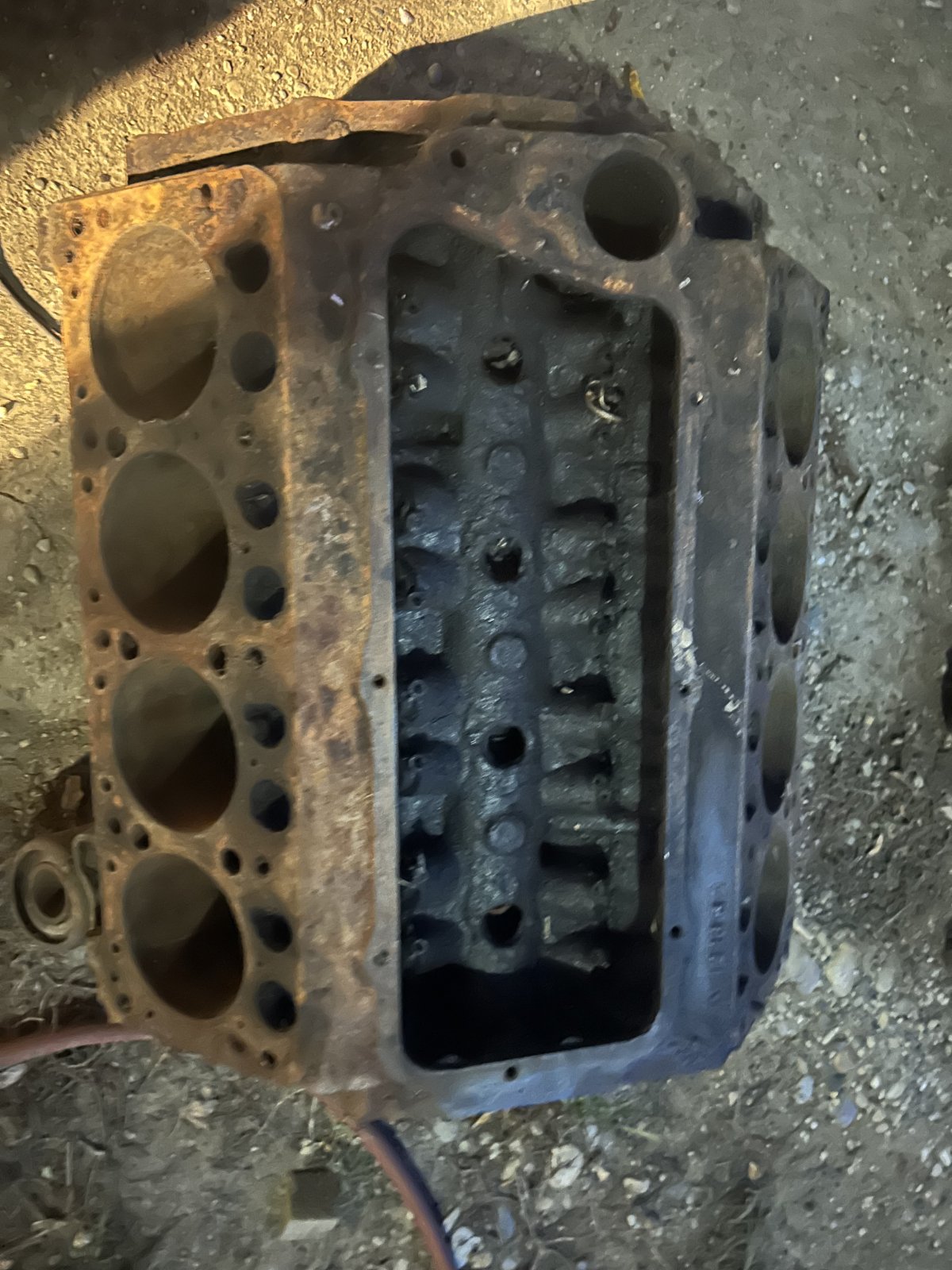

    An ad popped up on Kijiji a few weeks ago for a 354 Hemi block about five hours away, I bought it for $100 from a woman selling it for her dad. Turns out she was headed to my area for thanksgiving so she brought it for me and I got it home today.
    Upon decoding the number on it it turns out to be a 341 Desoto block, the cam and lifters are still in it. Oh well I’ve spent $100 on stupider stuff and I can say I have an early Hemi…sort of…

  2. Bandit Billy
    Joined: Sep 16, 2014
    Posts: 16,039
    Bandit Billy
    Cam is a big part of the build. Regrind. Not a lot of other options for the Desoto.

  3. Hemi Joel
    Joined: May 4, 2007
    Posts: 1,640
    Hemi Joel
    from Minnesota
    Dual quads from an Adventurer will fit. I don't think I'd use it as the basis for a build, though. Too many hard to find parts are needed. Unless you had a complete 341 with a bad block to use along with it to make one good engine.

  10. 73RR
    Joined: Jan 29, 2007
    Posts: 7,342
    73RR
    Actually, you have a decent start. Do you have the main caps? Those would be important.
    I'd suggest keeping the cam with the block so that if you decide to sell it the cam might be the kicker.
    The 330 and 341 are stout performers with a decent cam profile and 10:1 cr.
  11. 73RR
    Posts: 7,342
    73RR
    One of the 'problems' that most independent grinders face is that the rough cast area between lobes will limit lift and duration unless it is also ground down. I set up a machine just for this operation.
    The fat core is common on all Dodge and DeSoto cams.

    Yes the main caps are with it. I feel like the heads are the biggest challenge to find
  13. Start looking,,,,you will be surprised how many parts are around for the DeSoto engine .
    The cam is the important thing,,,,,you need a core at least to be able to do a regrind .
    Read up in these engines,,,,,,the low deck part’s mostly interchange with each other . The high deck heads will fit the low deck .
    The high deck parts are mostly only for the high deck .
    The high deck cranks are all the same ,,,,, difference in cu in was the bore .
    The high deck rods are the same,,,,, the heads are the same .
    These engines run very well when hopped up,,,,like Gary said .
    You need higher compression,,,,,,Ross can supply that easily !
    Stock compression can be supplied by Egge or other sources ,,,whichever you choose .
    Hotheads has an enormous supply of parts for these engines .
    I think they even have a new intake for the high deck,,,,,,it has a removable top .
    It’s not listed on the web site,,,,you have to call them .
    I have seen many parts for sale for the 330,,,,,pretty much identical stuff to your application .
    I’m fairly certain they even have the same forging numbers ?
    Tommy

    Id get it tanked and what ever to see if its any good as far as cracks or other issues before spending another dime .
    It possibly got robbed of almost all of it parts for a reason .
    keep a eye on market place and craigs list they pop up from time to time I saw one in WI not to long ago that was pretty complete .
