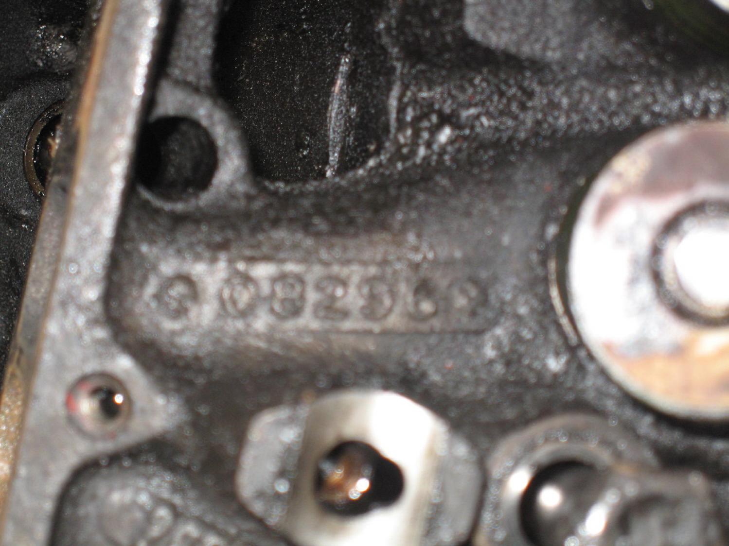

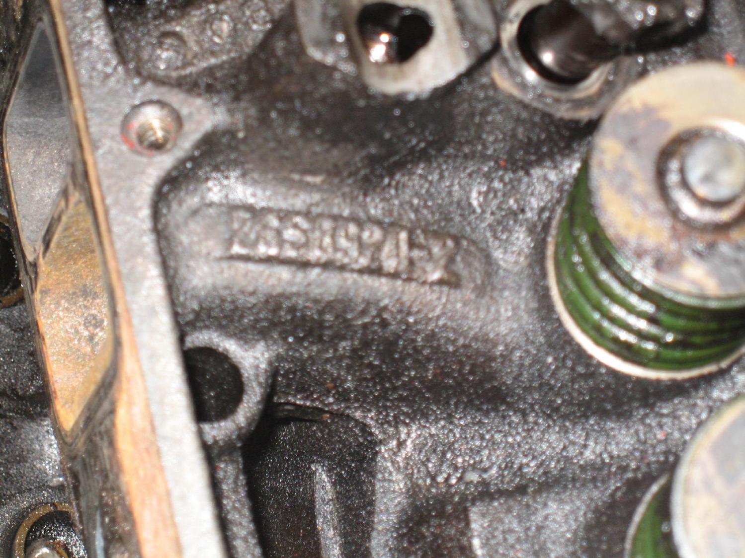

    The engine is a bit of a mystery at this point as it seems to be a 318 but the block numbers don't state it as such I will post a pic.
    Also this engine has adjustable rockers where nomally I would have expected to find stamped rockers, Any information on these would be helpful. What style of heads are these? My uneducated guess is that maybe this is the smaller LA engine or possible the canadian built 318?

    I believe that that is a 273 ci engine, 273 are the ones that came with adj rockers. I dont remember any 318 that had adj rockers.
    those engines work just fine but are just smaller cubes.:cool: Ron....
    what is the casting date on the side of the engine???

    2806030-1 is what it looks like. Where else would one look to properly date/I.D. this block. What would be the proper bore I.D. for the 273?

    Casting # is for a '67-'75 318. 273 bore is3.63, 318 is 3.91

    Look at the front of the block, just below the driver side head gasket, the displacement should be stamped there.

    that is the casting #
    on the other side of the engine there is a DATE cast #
    something like 4. 14. 71 that would mean that it was cast in 1971 and would have been put in a 1972 car.
    also a mentioned above,
    below the drivers side head stamped into the block, you should be able to find something like F 318 that would be a 1970(F) 318
    it looks like maybe someone put the 273 adjustable rockers and pushrods on a 318 at some point of its life
    <table border="0" cellpadding="2" cellspacing="2" width="280"><tbody><tr><td>2806030</td> <td> 318</td> <td> 1967-74</td> <td> LA</td></tr></tbody></table>
    like I said in the first post I dont remember any 318 around then that had adj rockers, but I am getting old and anything is possiable:rolleyes::D Ron...

    Like you Ron, I simply do not believe Mopar ever use adj gear on an LA 318. The A series 318 - the POLY, YES.

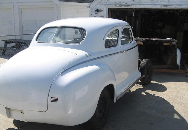

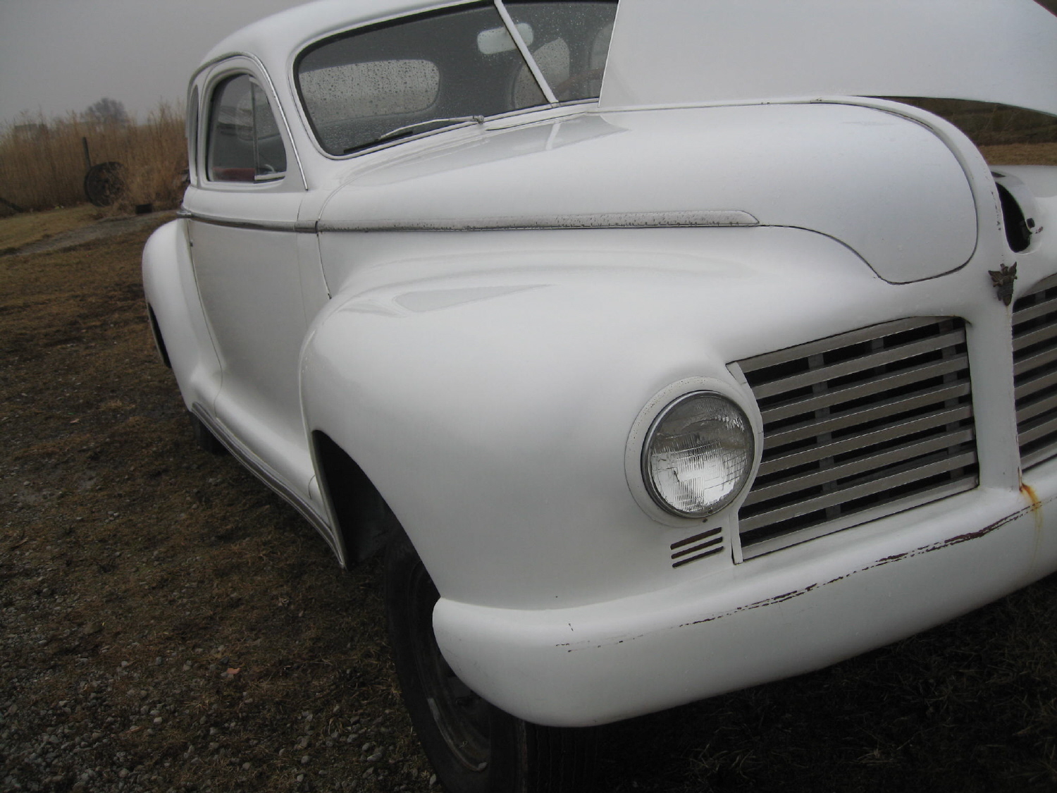

    Unless your front and rear sheet matal has been change, it looks like you car is a 42. 41's look like this.

    I was thinking the same thing, 41's still had running boards also. Car looks pretty solid, 8 3/4 e-body rear end will bolt in there also if you don't want to screw around with special u-joints or driveshafts. later shawn

    Looks indeed to be a 1942 title states 1941 is there a way to check the VIN?....I also deemed that i have the 273 adjustable rocker arms...I have the engine torn down now and will be getting some 340 heads from my boss for the engine. The 318 heads leak pretty bad and for the cost of the 340 heads i can't even get the 318 heads reconditioned so....I got my 904 back from the tranny doctor, all seals replaced and checked out good to go 300 bucks later. I will start to put the engine back together hopefully sometime this week just a couple of things i want to spec out while its apart. I need to get a new timing chain yet, and a slip yoke for my tranny. One day at a time...
