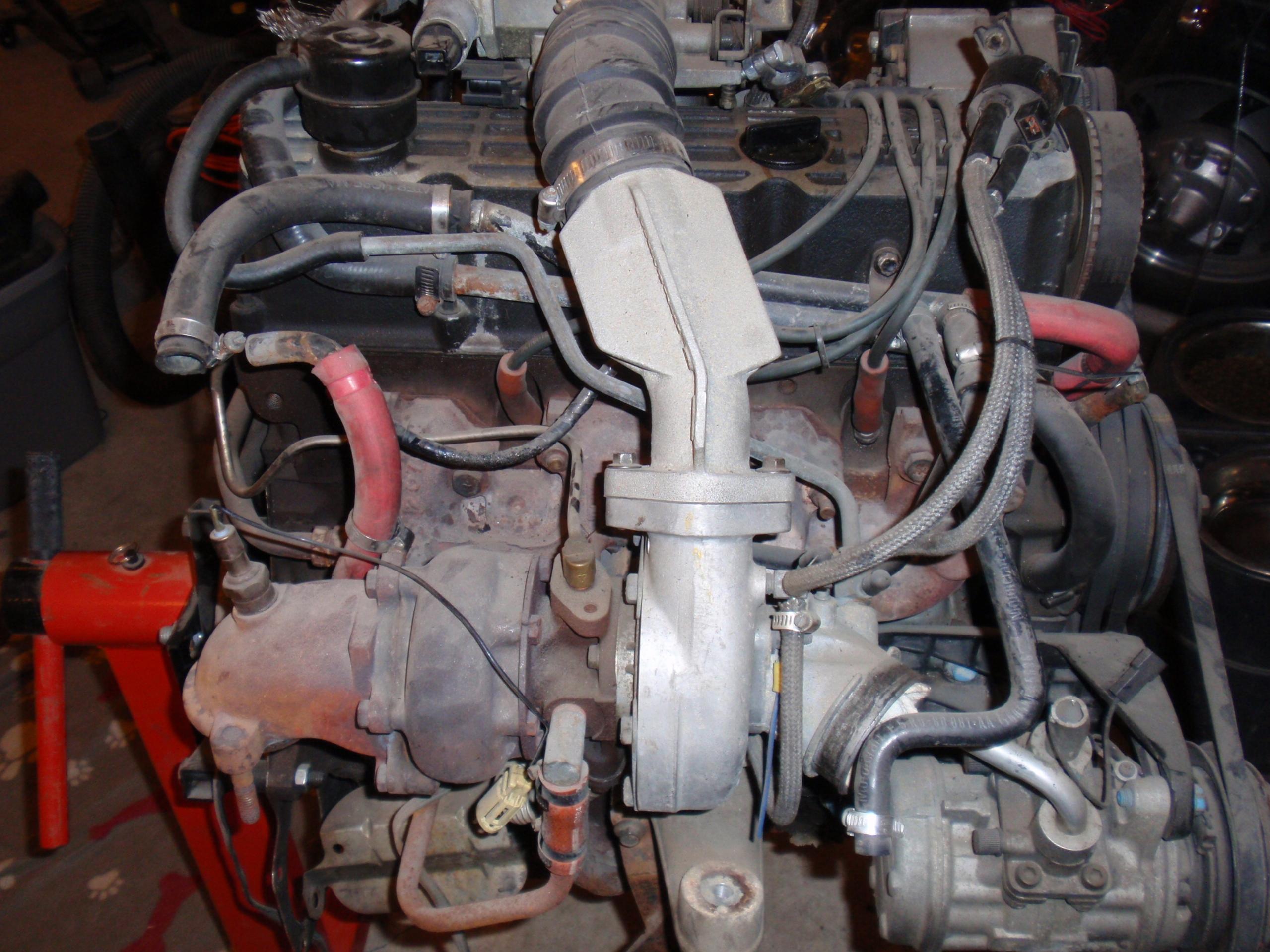

    thank you guys for all the great info... I am going to look at a 2.3 turbo tomorrow.... its a 1987 complete with all engine .,.turbo wiring .. computers the good ones I have been told... and its hooked to a t5 with clutch flywheel and pressure plate starter.... the works... and he wants $1000 for it all..... sounds like a good deal if its all ok...with gas prices reaching $1.30 a liter here... about $5 a us gallon..... it could be the way to go.. hope to have more soon....

    I purchased the 2.3 and t5 today... got a great deal and are very excited about putting it in my truck... I noticed it has the Merkur motor mounts.... they look like they may work ok with a mount with biscuits off the frame.... Ill look into that some more.... I think its going to be a fun project...
