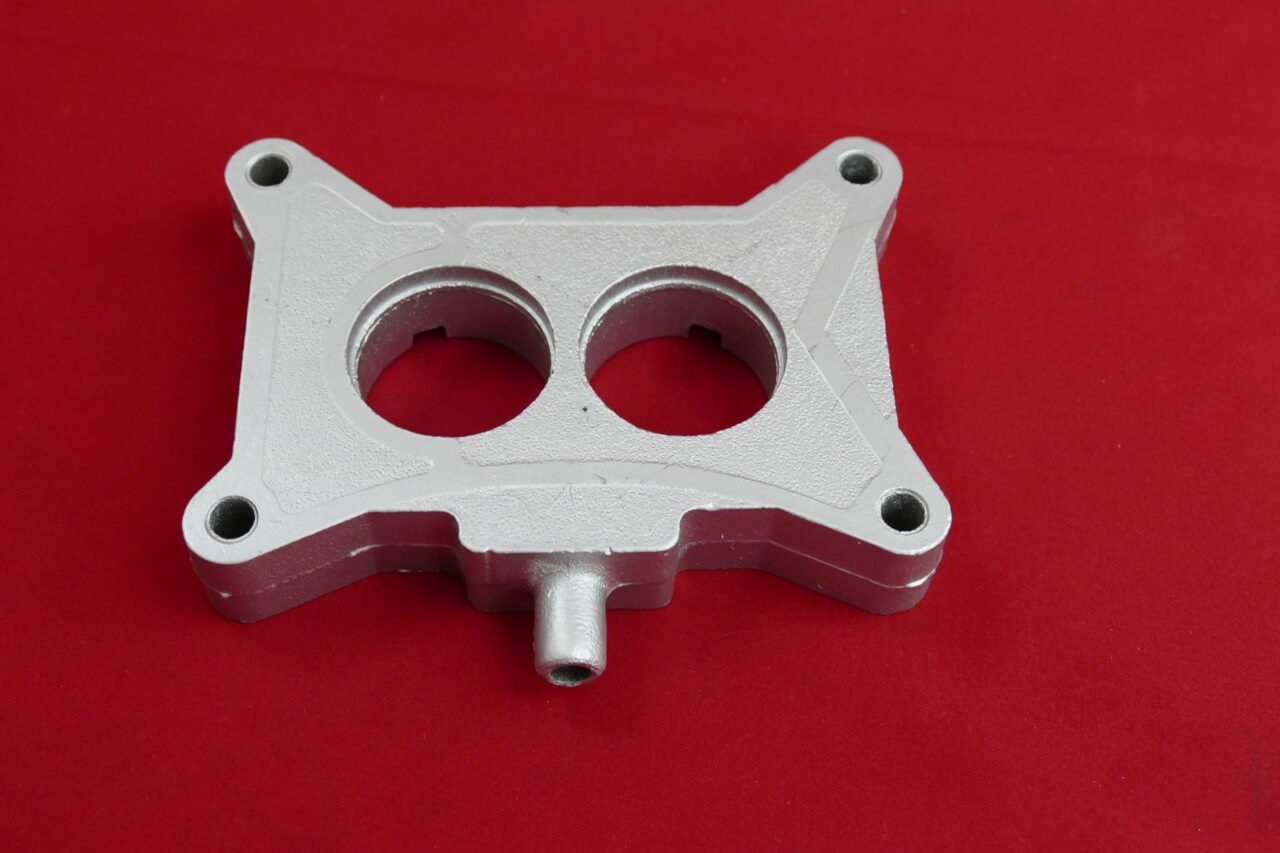

    What I’m saying is there are carb spacers for the Autolite with a threaded port. I just don’t know if there are other 2 barrels for Y blocks.
  5. Johnny Gee
    Joined: Dec 3, 2009
    Posts: 14,414
    Johnny Gee
    from Downey, Ca
    1oldtimer, Deuces and Joe Blow like this.

    The pcv I want to use is a original screw in and the 4 bbl spacers I have gotten have a threaded port and was hoping to find a 2 bbl spacer that also had a threaded port.
