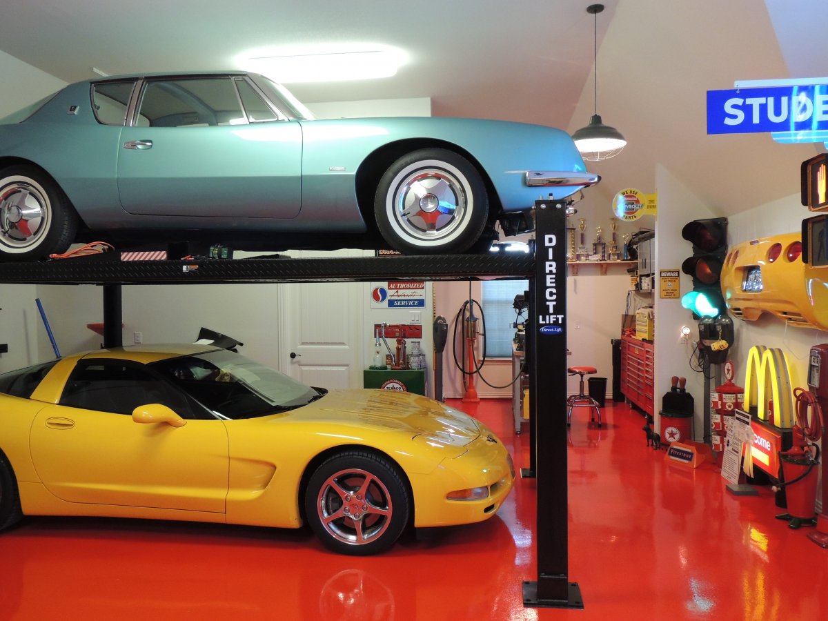

    image.jpeg I have had a Direct-Lift four post for more than two years. I have the sliding Jack. So far it has allowed me yo do everything I have needed to do. Had an issue with the sliding jack and Direct-Lift took care of it promptly.
    izzy412 likes this.
