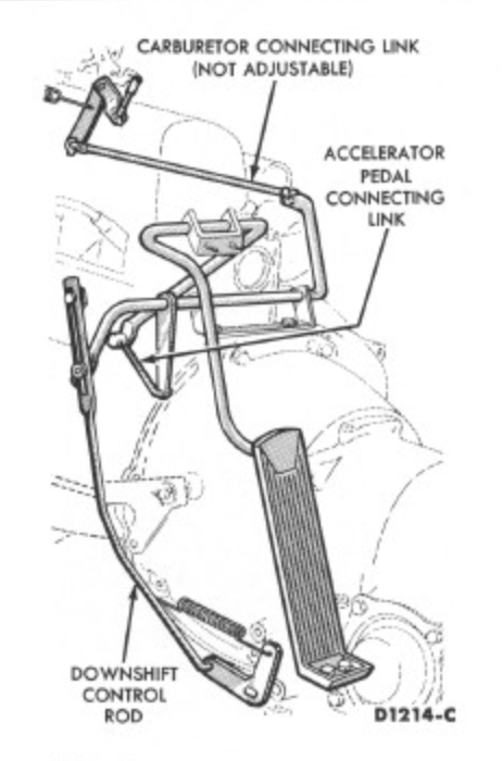

    I am starting a new thread for this hoping that it sees more traffic than my Father Son Falcon Project thread. I have read every thread I can find on the HAMB regarding Ford-O-Matic transmissions, but I didn't see anything specific to this 2 speed.
    We have a 61 Falcon with either the PCL or PCM style transmission. It's a 2 speed, and it will not shift into second gear while driving. I have verified that the Vacuum diaphragm unit holds a vacuum, and that the fluid level is good. Also, the linkage appears to be correct, and it's the style as shown in this pic.
    The motor is a late 70s 200 straight 6, and was put in well before I owned the car. The car also just got back on the road after sitting for 11 years.
    Does anyone have input on what the problem could be? Any other helpful advice is appreciated.
