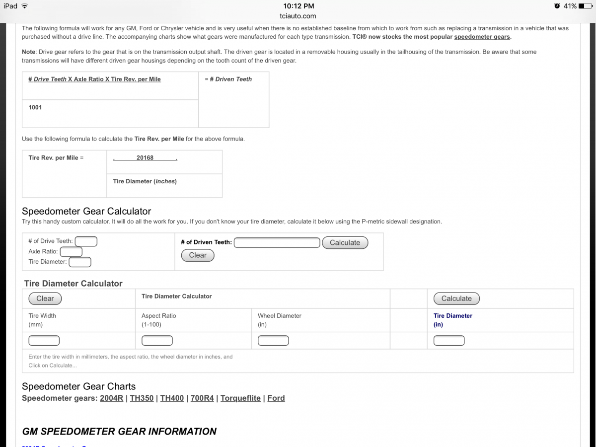

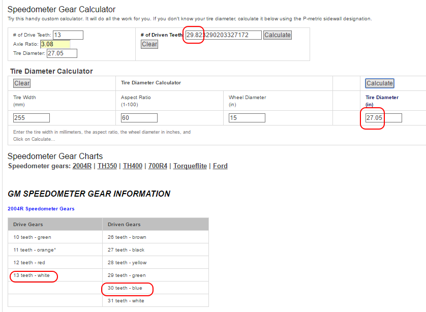

    Alright, had the car flatbedded to National Transmission in Calgary. They are known for working on muscle cars - had a bunch of 60/70s Camaros and 57 Chev in the shop at the time. Called back within 2 hours and said everything is fine. The TV cable just needed to be adjusted. We took it for a test drive and it shifted wonderfully. Total cost about $250 including the tow. Great deal as now I know it is okay. What a relief.
    Just have to dial in the speedo. I used TCI online speedo gear calculator to determine the "right" gear and after purchasing and installing it, it is off by 20% which is quite high. Makes me wonder if my rear end gears are really 3.08s or 3.73s. You'd think that I would know by now.

    From what I could see, the drive gear in the transmission is a faded orange 11 tooth and not white which would make sense and put the speedometer out by 20%. After running around the city, talking to several jobbers and transmission shops, I found a 13 tooth drive gear that was colored "light green"?
    Then spent the whole freaking day, trying to get the transmission pan off as the transmission mount was in the way. It finally slipped off and then spent a couple of hours looking for a governor cover gasket with no luck. Finally pulled the governor off and it is is a tan 13 tooth drive gear! WTF?
    Went to put it back together except I can't get the transmission pan on cause it won't slip back in between the transmission mount the way it came off. Gave up after two hours of frustration. Now I have to pull the shifter so that I can raise the transmission more to have more clearance for the pan to go back in. And have to buy a new transmission pan gasket.
    Now I'm totally confused. I had a 30 tooth blue driven gear in with the 13 tooth drive gear and the speedometer was out 20%. Back to square one.
    So tomorrow, back under the car to put everything back together and say "screw it", if the speedo is out, I'll have to live with it because it makes no sense.

    That is the calculator that I've been using and verified it on other sites:
