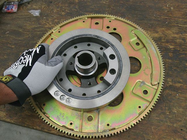

    In the continuing saga, I have a bad vibration at around 1800 rpm even in park. Is it the engine or the torque converter? I'll have to disconnect the torque converter again and rev the engine to see. I hadn't noticed it before the transmission install. Sigh...
    I have a 400 SBC that is externally balanced. I don't think that should make a difference.
  23. The 400 SBC takes a special balancer and special flex plate. Anything else will cause vibrations and anything else will also fit. The converter doesn't care what it's bolted to and neither does the Trans.
  24. miker98038
    Joined: Jan 24, 2011
    Posts: 1,762
    miker98038
    One more thing to watch. I got an externally balanced flexplate for a 400 sbc that did that. Turned out it was for an external balance big block (IIRC). Was visually ok till placed alongside the right one. Mis packaged by the manufacturer.
  25. blanchae
    Joined: Jun 6, 2008
    Posts: 57
    blanchae
    I've had the 400 sbc with the old TH350 behind it for about 12 years. I installed it with a new harmonic balancer and an external balanced flexplate. I'm using those components. Been too busy to check. I've read that sometimes, you can fix the vibration by rotating the converter on the flexplate one mounting hole (120 deg).

    One of the problems that I was working on was a noisy exhaust donut on the p***enger side. When I went to work on it, I saw that the rear of the exhaust manifold was just touching the firewall support frame. Which led to the vibration and noise which was caused by a sequence of events:
    1. The motor mounts are big rubber donuts. After about 6 years the rubber had softened and the engine lowered about 1/2 inch which put the oilpan in contact with one of the return metal tubes on the top of the rack n pinion unit. The rubbing worn a hole in the rnp pipe so I replaced it and raised the engine 3/4" for clearance.
    2. No problem but when I installed the 2004R, the transmission mount tilted the engine up enough for the back of the top of the p***enger side exhaust manifold to just touch the support frame on the firewall. This physical contact generated the noise I heard and vibration I felt.
    3. I lowered the engine 3/8" on the p***enger side and no more vibration or noise.
