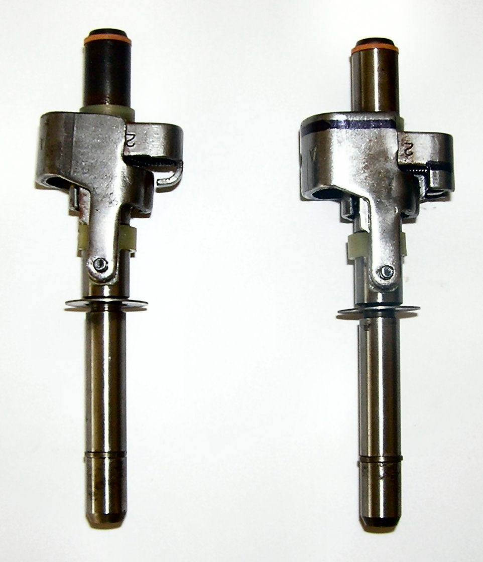

    Wow! Sounds like you have discovered all the problems you can have w/a 200R4. I rebuilt and installed two in a couple of my builds and have had great success with both. Mods I make are few; new stator shaft which are always chewed up on stockers; TransGo shift kits; and reduced weight and remove 1 spring on governor to improve shift points. Governors are cheap, only $12 last time I bought them so you can afford to experiment.
    Oh and always use a BowTie Overdrives throttle cable cam on the carb.

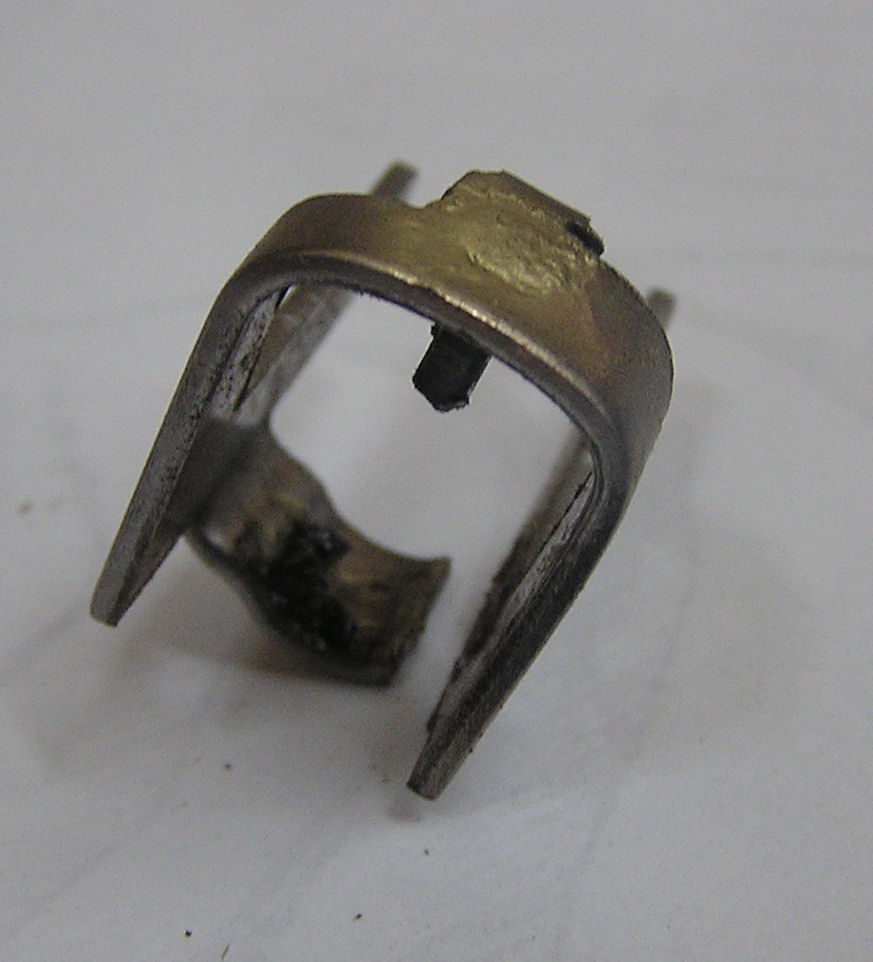

    Here are some pics on the governor mods. I braze a small nail in the spring alignment hole since they are prone to jump out if not so constrained.
    Left one is trimmed, right one is stock with pen markings on where to remove weight. This is t he only correct way to set shift points, don't try to do it with throttle cable. That has only one critical setting.
    Another view of weight removal.
    This is the spring to remove.
    view of the nail retainer brazed in place.
