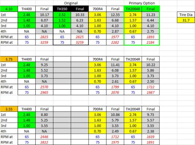

  17. anyone know, off hand what the gear ratio's are in the 200R4? Building a '67 Camaro for my wife. Been thinking about one of those. Have a 4L60E but can get a 200R4 out of a '86 Monte Carlo SS. Opinions?

    Well markyac it is an easy and common mistake to make considering the more popular 700R4 is mentioned more often. I just don't worry about it since most people probably figure out which one you are talking about soon enough.
    Alphebet soup,here is a nice little gear ratio chart I found awhile back .
