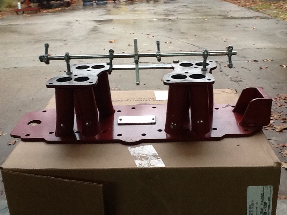

  12. Flatheadjohn47
    Joined: Aug 18, 2012
    Posts: 1,377
    Flatheadjohn47
    from Lewes, DE
    image.jpg Use the Edelbrock slingshot before using the Tattersfield. The Tattersfield is identical to the THICKSTUN; Hot Rod Magazine did a shootout about 18-20 months ago,and the Slingshot outperformed the THICKSTUN by 18 h.p. The Tattersfield,THICKSTUN looks great,but is a poor performer!
