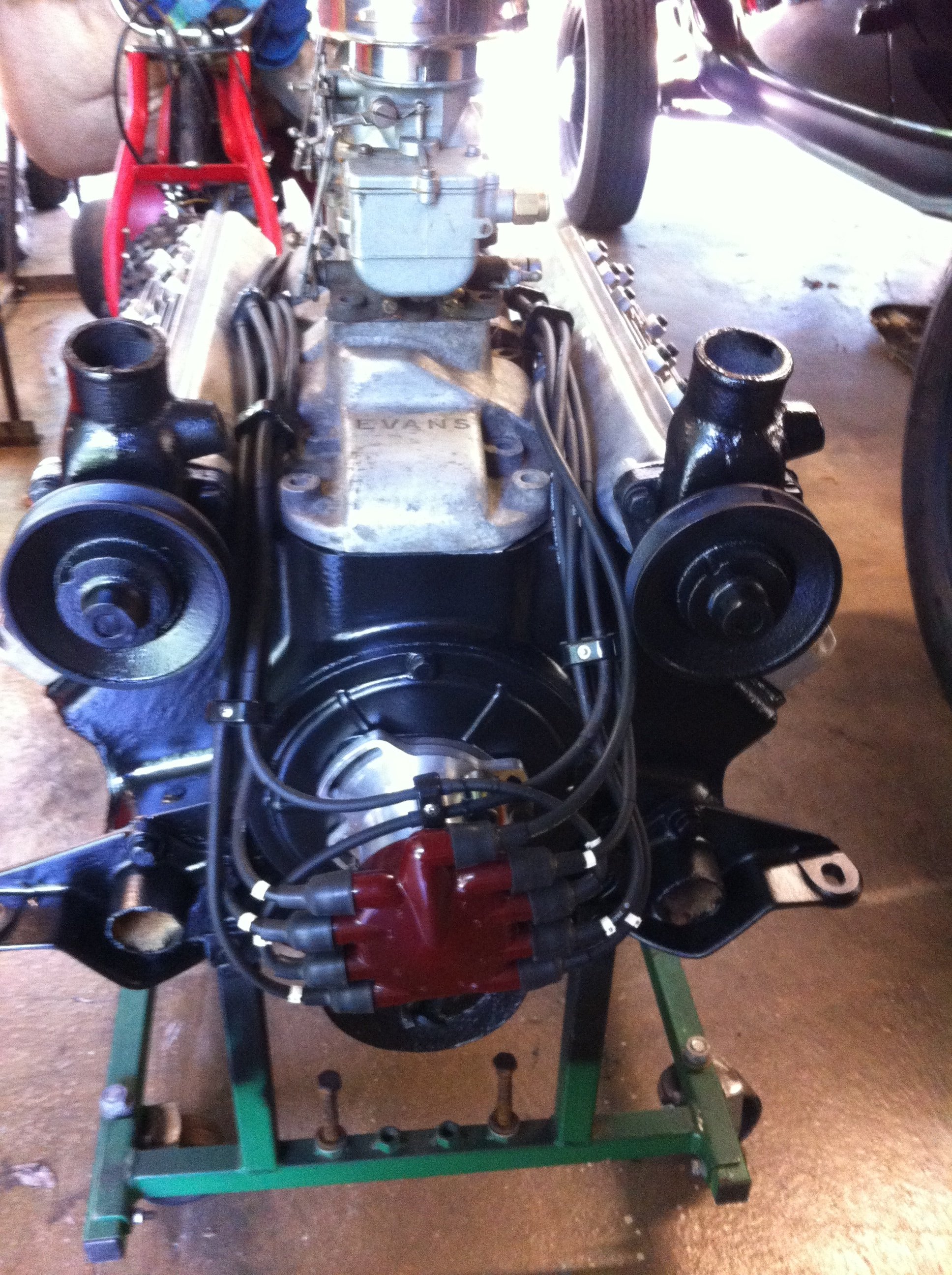

  10. ImageUploadedByH.A.M.B.1403365944.634213.jpg ImageUploadedByH.A.M.B.1403365986.843241.jpg
    This is my Kubota alt. mount on my EVANS triple. You could do the same with a generator or Powermaster because you have more room on the 2 carb. PM me for more detailed pics. Ron
