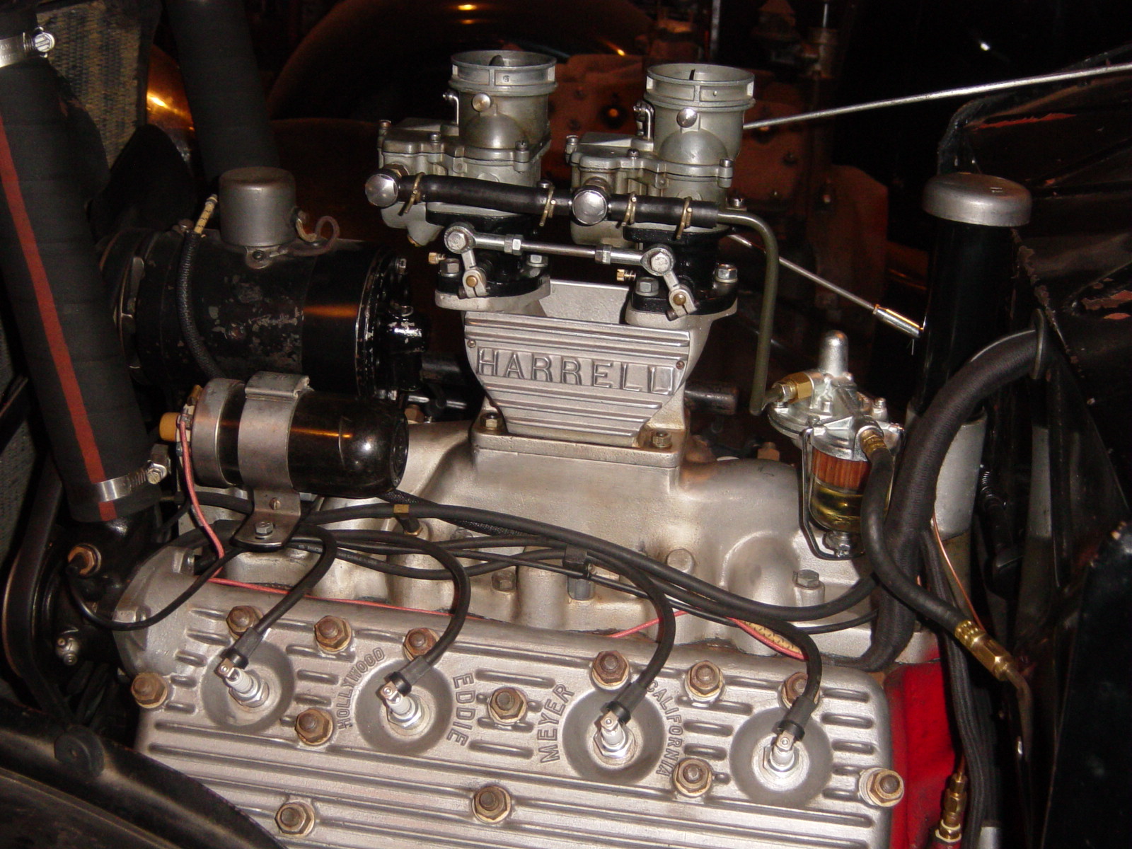

    I have two 97's on a Harrell high rise, this on a 21 stud with a mild Clay Smith cam. Have been changing jets to clear the plugs of soot. The 97 standard factory set up for one Carb is 45M & 65PV. I started at 43M & 69PV, then went to 42M & 69, just changed to 42M & 70PV. Good Luck Your car is beautiful. DSC02422.JPG is beautiful!
  10. Thanx....I love those Harrells & the Meyer heads ;) I'll check again but pretty sure its 45 jets. I'll start with these as the baseline then tweak from there but with the PM7/less CR I never fouled the hotter plugs with the stock rebuilt helmet dist. I imagine with the MSD ign and the same dist firing the box it won't be any worse if anything cleaner. What remains to be seen is the quality of distribution to the cyls as compared to the PM7 which was a little inconsistent.

    And that Harrell slingshot with Eddie Meyer heads is absolutely beautiful!
