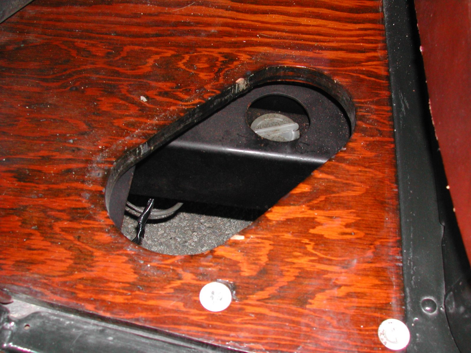

  13. There was a guy in the Fordbarn cl***ifieds about a year ago making the transmission cover to be used with the later transmission. As far as the master cylinder mounting goes attached are pictures of how I did mine without cutting anything. I kept the stock pedal ***embly.
