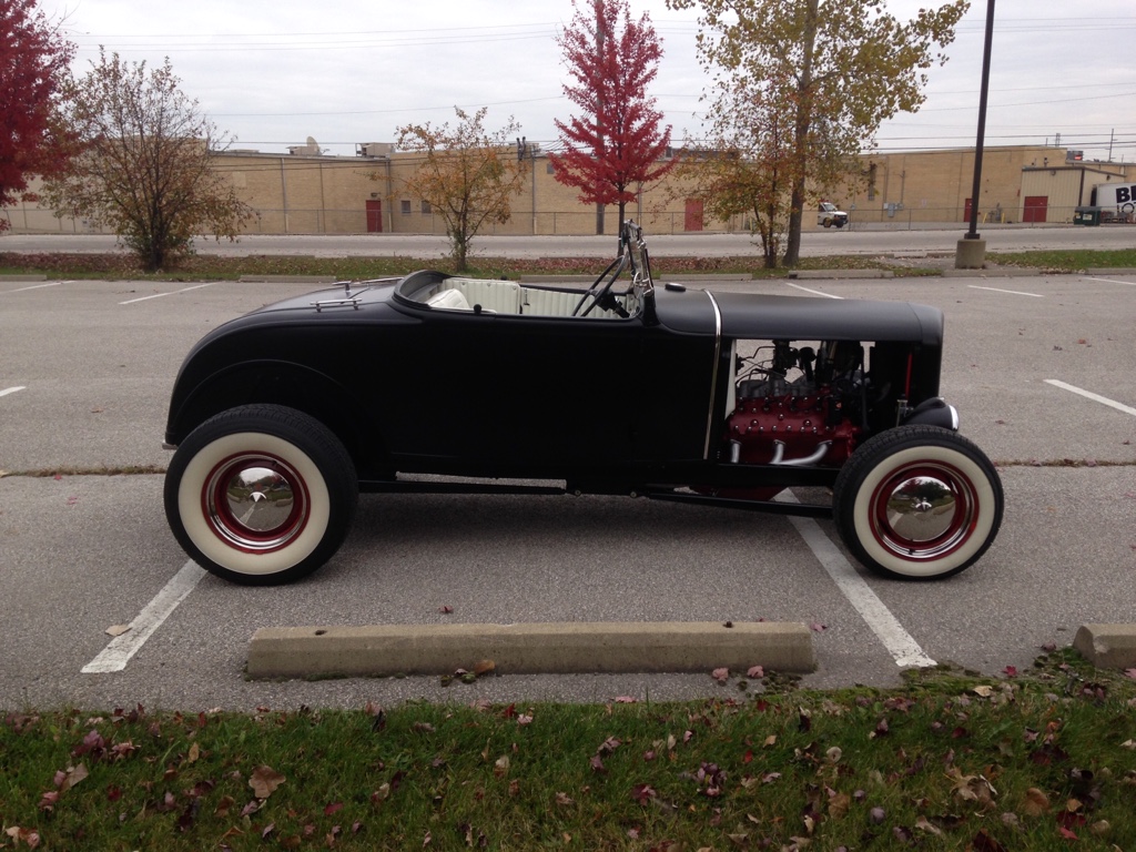

    ImageUploadedByH.A.M.B.1456794054.105829.jpg my 31 rumble seat , nothing better than a old school A hot rod

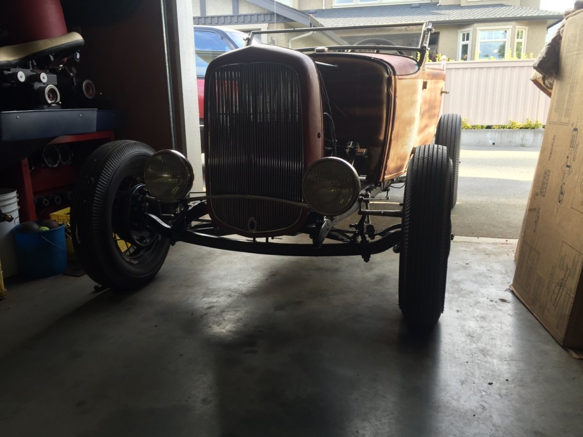

    Couple recent pics of the car as she sits might
    have to add a leaf to the rear... Thoughts??
    ImageUploadedByH.A.M.B.1462770190.116727.jpg ImageUploadedByH.A.M.B.1462770201.054305.jpg

    The way she sits is great as it is but a leaf in the rear wouldnt hurt. That windshield angle is perfect too. Awesome build!

    Hard to tell from the pics if you need to add a leaf in the rear or not, looks good to me.

    Put a flex hose in that fuel line, as it will stress crack in a short time. When the engine moves, the body doesn't.
    On the #2 valve, what did you find? (varnish on the stem/guide? Hope there wasn't a dislodged valve seat in the block...)

    In response to your rear leaf spring question I think part of that decision will depend on how much distance you have between the top of your axle tube and your frame.
    The stance looks good, but it also would be nice to avoid excessive bottoming out as well.
    Post this measurement and let the forum give a bit of feedback on expected suspension travel.

    Thanks for the responses boys I'll post the measurement tomorrow
    Mike I found varnish on the stem of the of the valve so we took it out cleaned it and lapped the valves.. So far so good ! Haha

    Roadster looks great. Give us a straight on side shot as long as the curve of the rear wheel well is above the wheel your good to go, in my opinion anyways.
