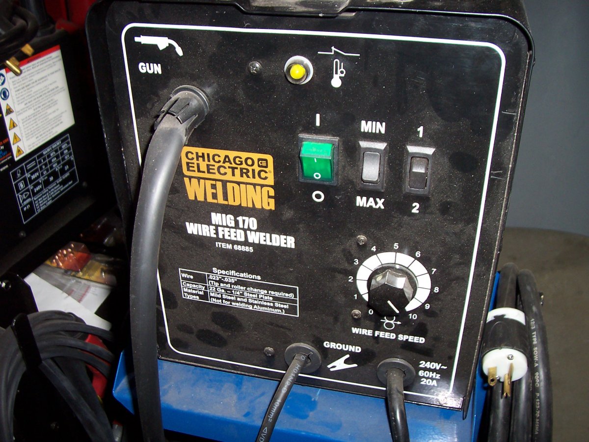

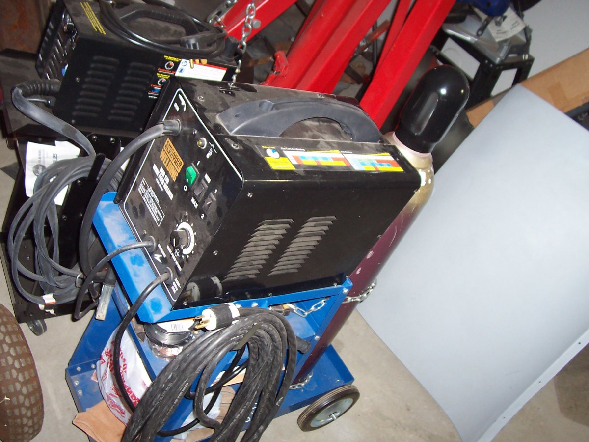

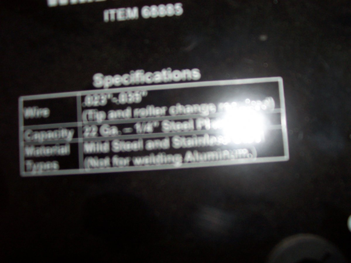

    Been using Harbor Freight welders for years and now have had my HF Chicago Electric 170 welder (chinese) for a few years and have never had a problem. My unit is 220v and is not switchable.

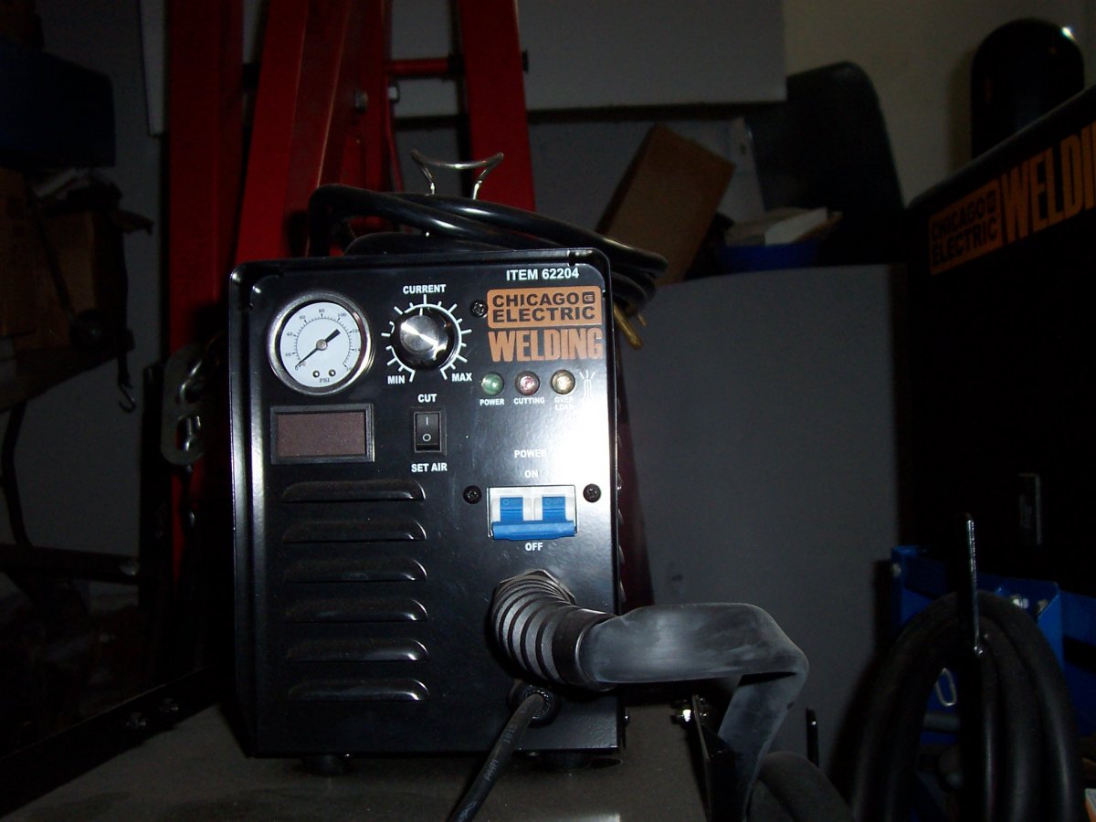

    I also threw in a pic of my HF 40 Plasma Cutter.

    Here's another reason to give Harbor Freight a go. With some tools I buy the 2 year extended service plan. With an item under $500 they automatically replace it. For the mig 180 it might be $30.
    I use their metal cutting portaband saw all of the time. (I don't really follow the guidelines and limits in the manual, I'm rough on them). I've burned out two motors so far (2 years), and both times I just took a break, drove to HF (2 miles), they just gave me a brand spanking new one no questions asked. Then I get a coffee at D&D's, then head home and keep working. The people there know the drill, they don't fight you like they do elsewhere, it's understood.
    I also have the $90 HF flux core wire welder and had the two year extended warrantee. I ignore the duty cycle, use cheap extension cords and generally beat on it. Two years is up and it's not failed once despite my best efforts.
    If I hadn't found this Solar 175 with cart and tank, spot welding kit, extra spools etc, for $200 on Craigs List;
    I was planning on buying the HF MIG 180 ($230) and a two year warrantee. The 180 has better control over your voltage than the the 170 which just has 2 settings, the difference in price is pretty small.
