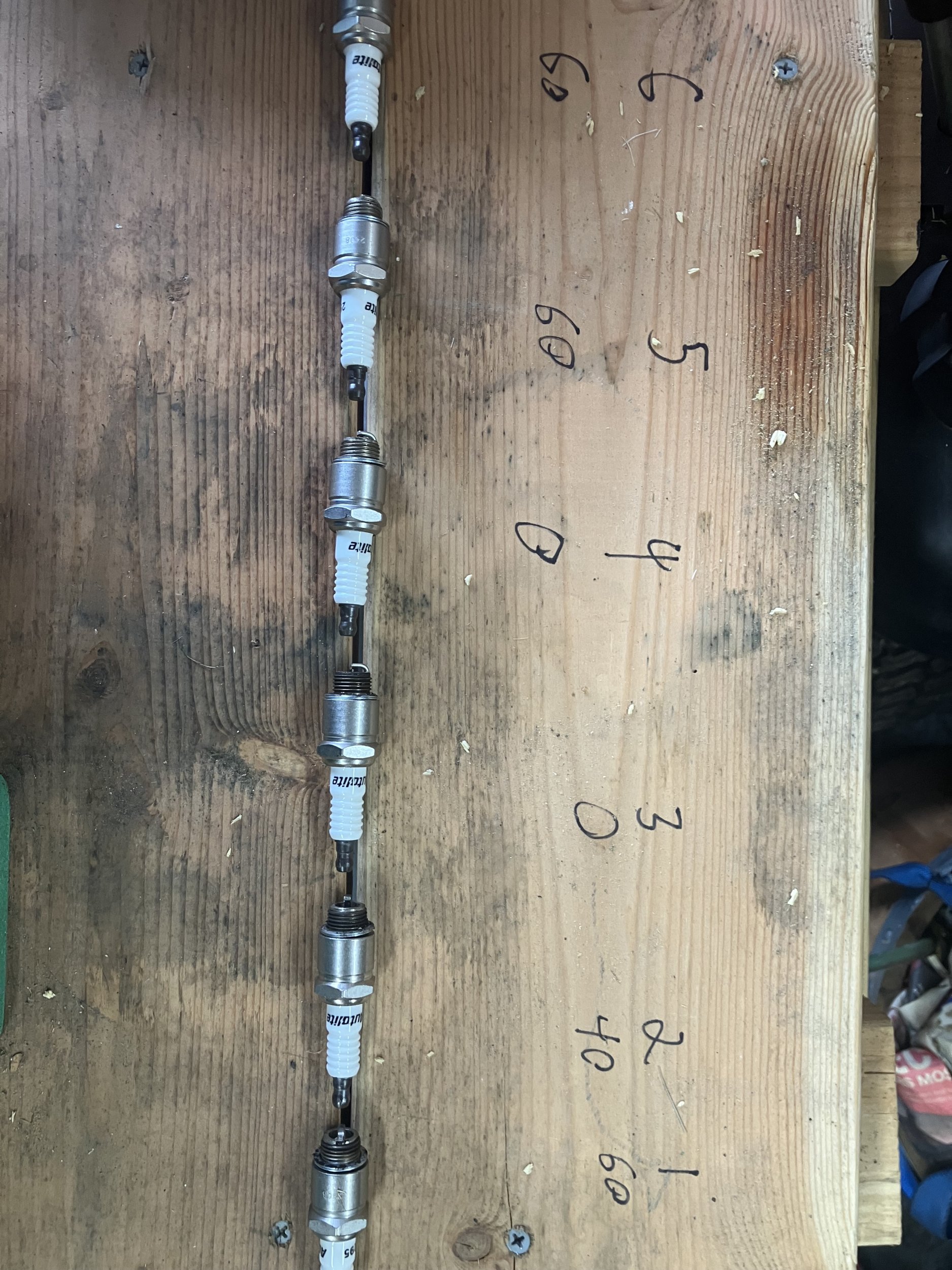

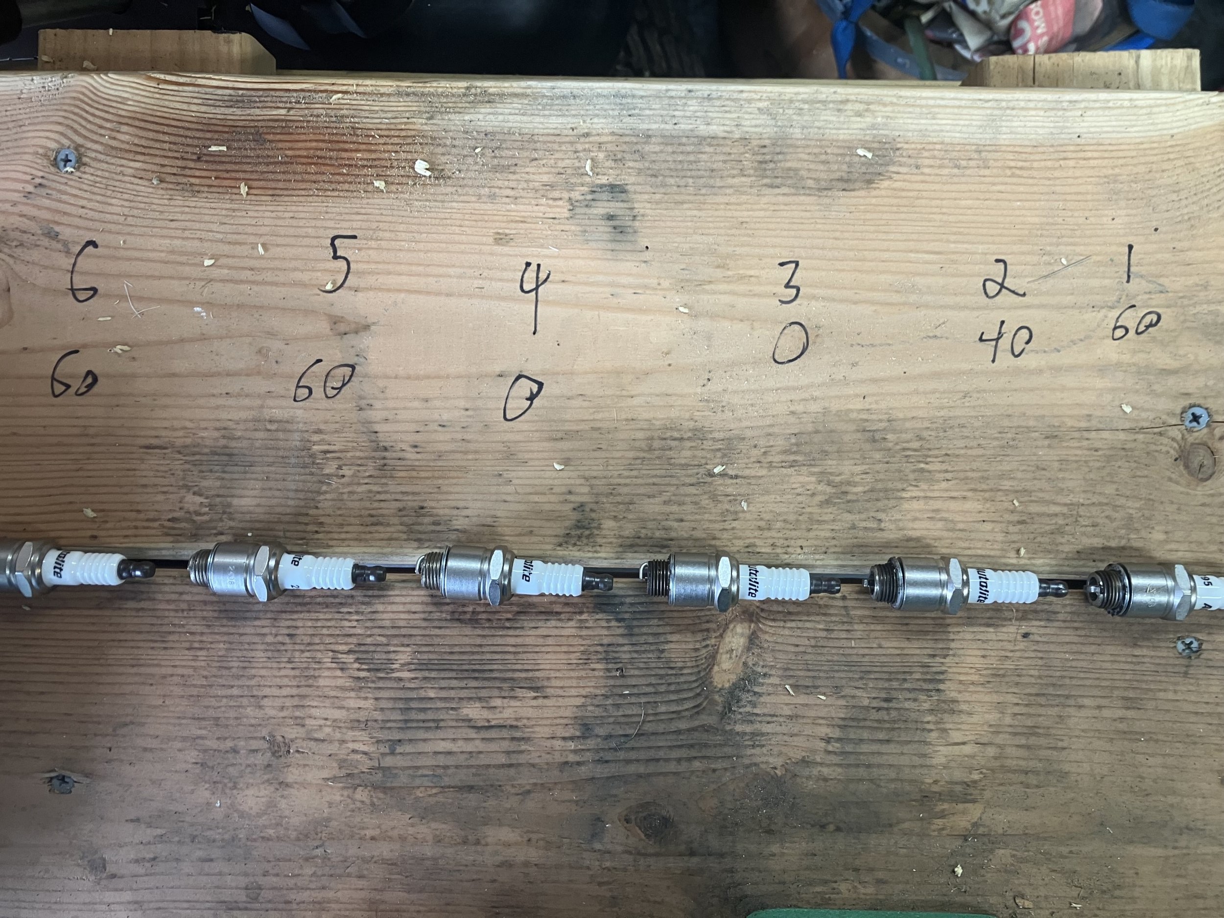

    I brought my compression tester with me. I didn’t test it as, the charger that I have which does 6v is a 4A automatic charger. It works but it won’t recover the charge very quickly.

    The more I dig into this car it’s apparent that what the previous owner said isn’t true.. I couldn’t get it running

    I’m going today to see what I can do. I have a new coil, a new condenser. Compression tester, good battery charger and a gallon of PB blaster that should make the valves un stick. I also of course got a set of ignition wrenches too.

    fixed the pic.. man you have trouble. possible blown head gasket?

    Definitely a possibility. I’m going to try to get it running so that I can get it to
    My house. I have a head gasket kit ready to go so that’s not an issue. Unfortunately my wife just called me to say that we lost some power at my house ( not all of it) so it’s game over for today. Gotta figure that out

    False alarm so I’ll keep on chugging
    Cause of no spark, and no vroom vroom seems to be that broken wire is the wire that goes from the coil to the inside of the distributor through the p*** through. Working on seeing if if I have something to macguyver it together with.
