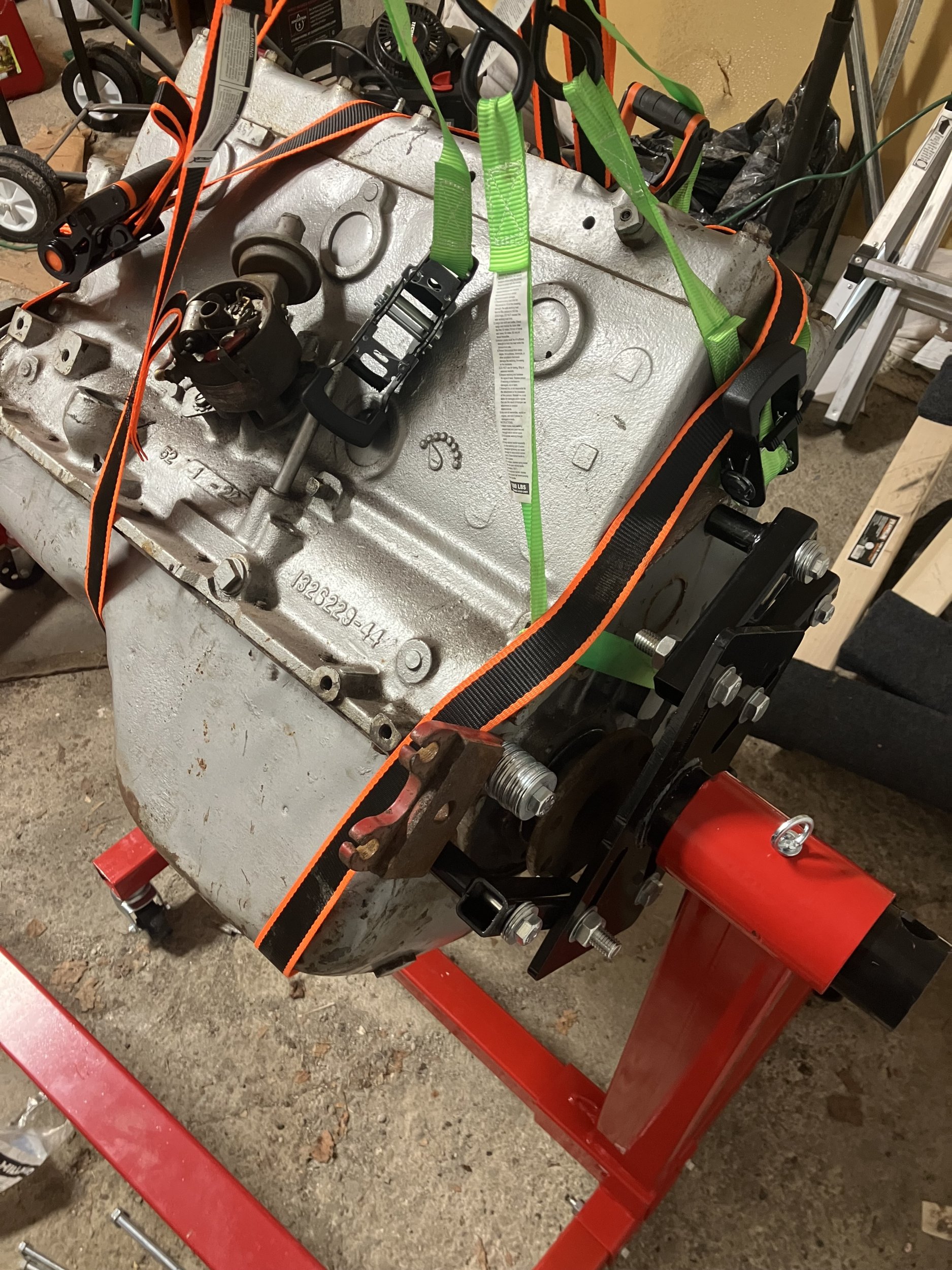

    Just got my 230 on a stand. I didn’t have any stands available anymore so I bought an EBay special 1,000 pound stand. Didn’t fit the engine so I had to get resourceful to make it work. I bought 5# of bolts from TSC and still didn’t have all the right length bolts. Off to get the car tomorrow
