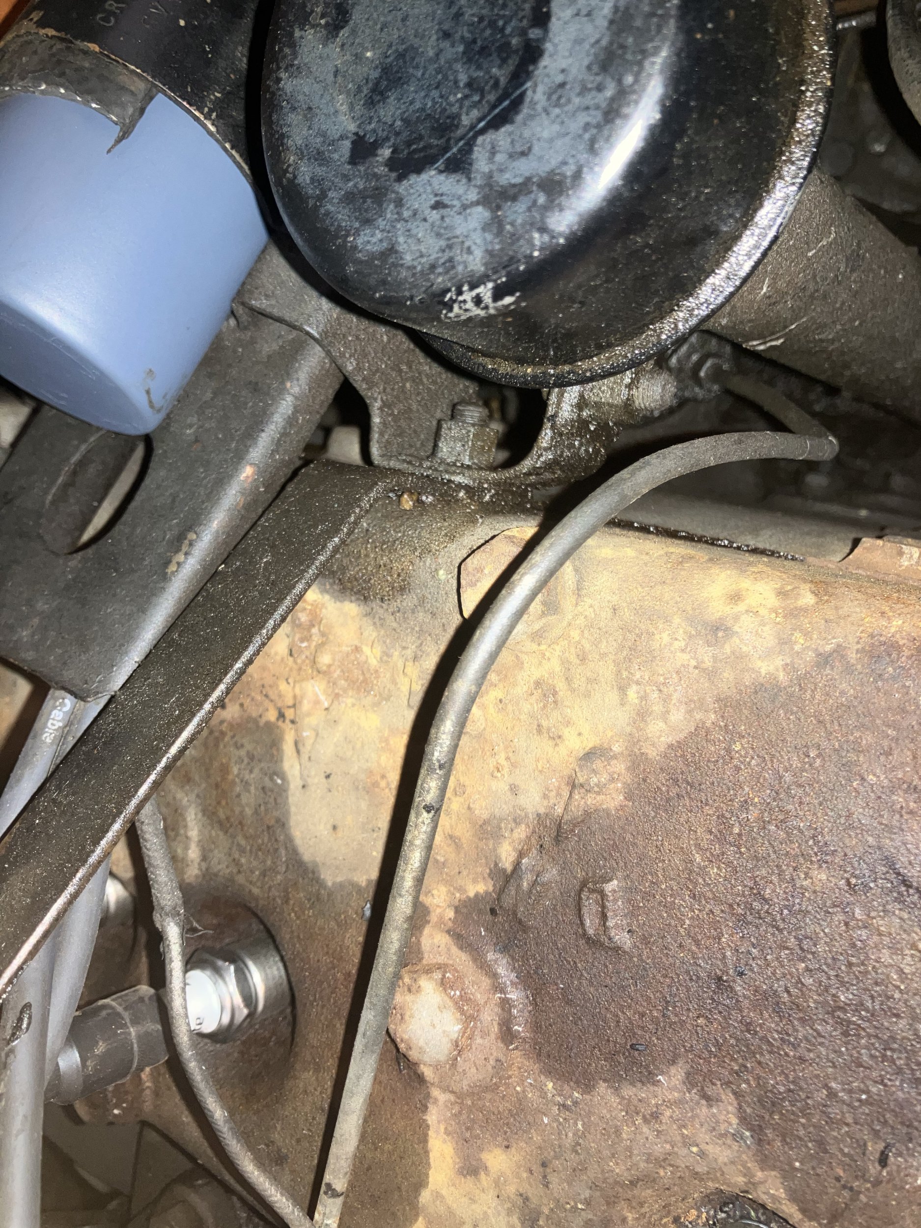

    IMG_1694.jpeg Finally had a chance to pull the head off of my spare/ new engine and it’s really promising. Cylinders are great with .030 over pistons. I know for now I’m going to swap the cylinder head off it onto the one in my car, as I really think the cars cylinder head has issues. The cylinder head looks like it’s pretty freshly surfaced. IMG_1695.jpeg

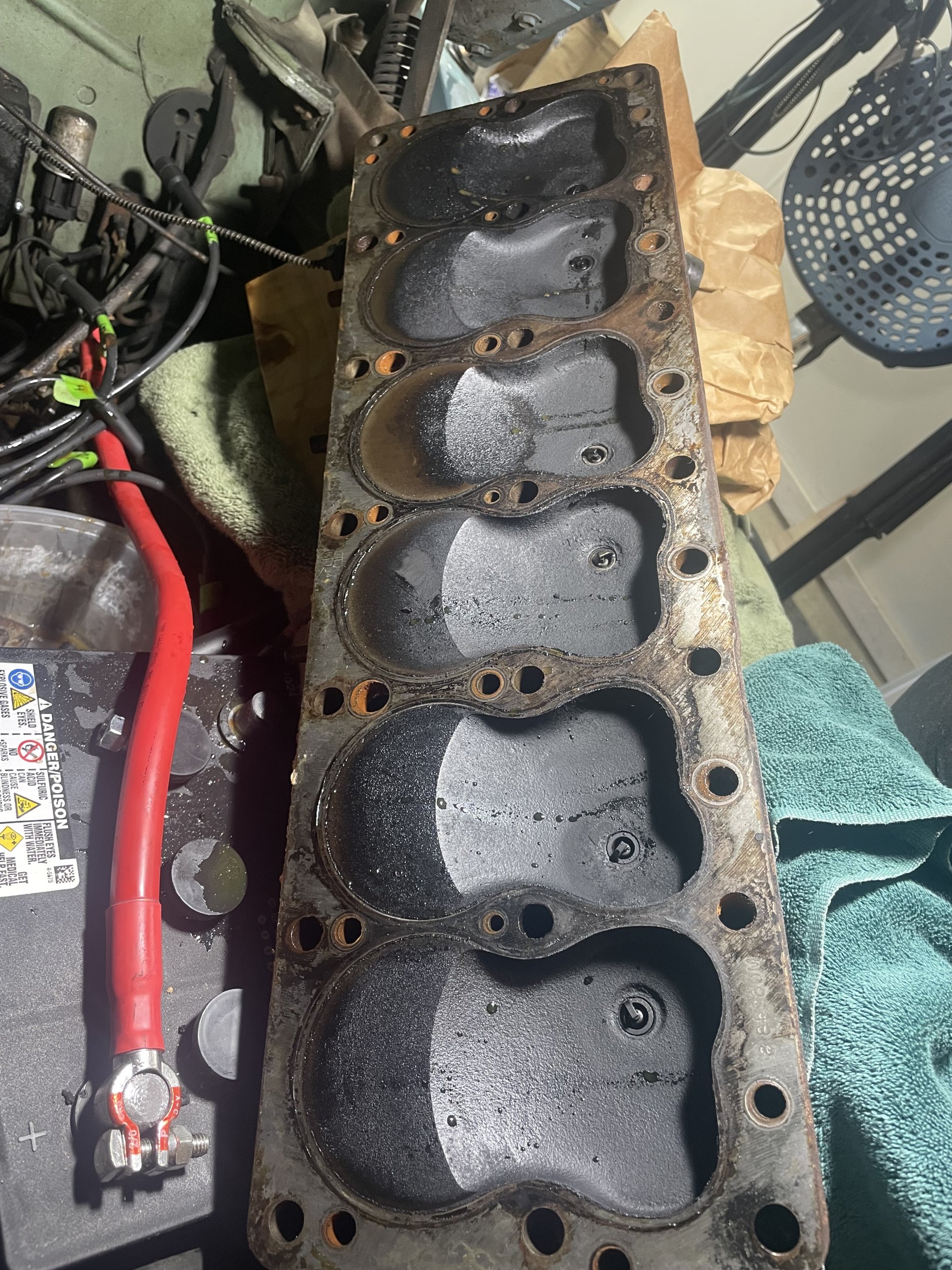

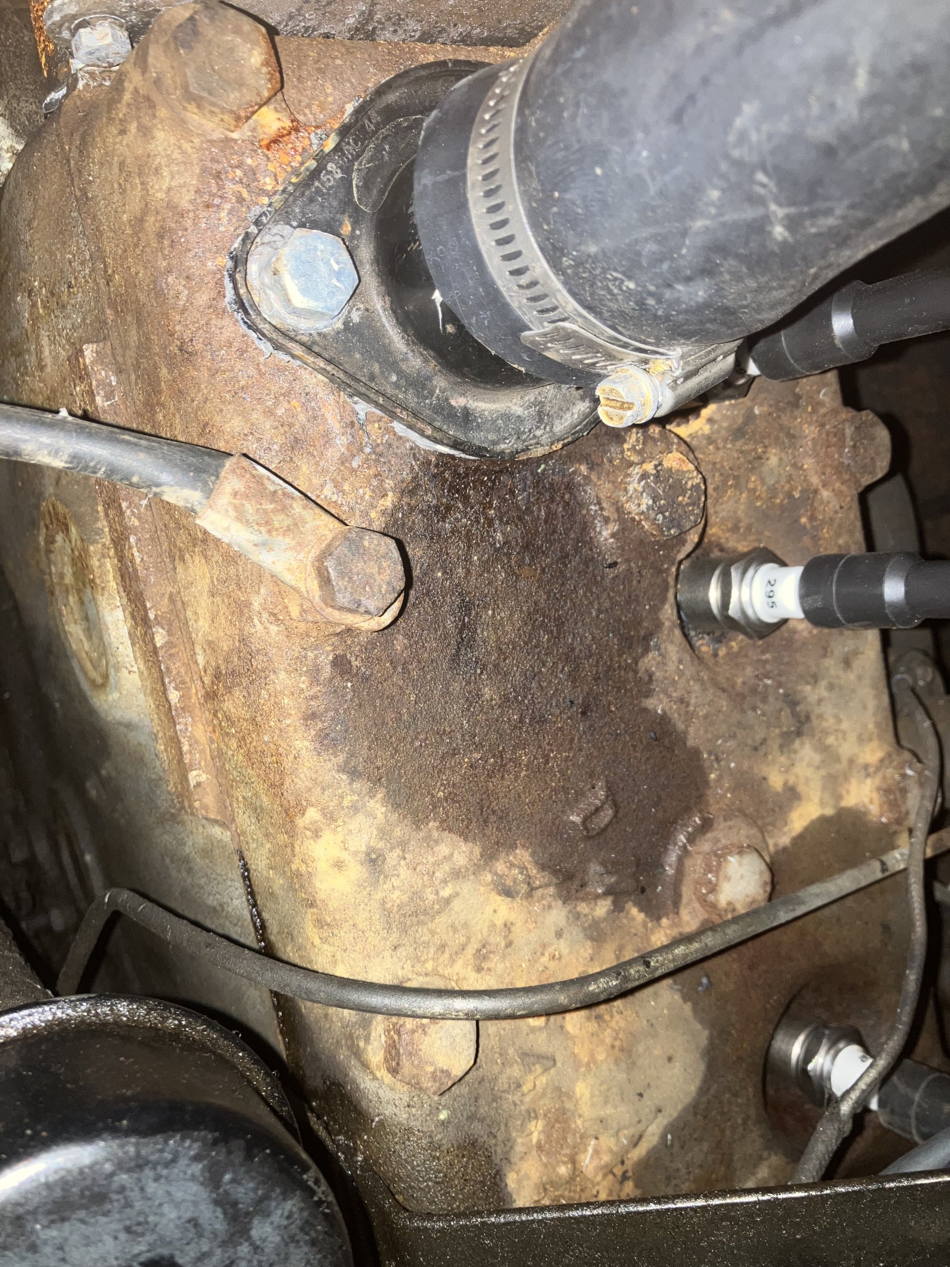

    IMG_1698.jpeg As to why I’m pretty sure the cars cylinder head is questionable. It has an oil leak out the side near 4 and 5 and the spot ontop of the head never dries out. IMG_1696.jpeg

    Had time to pull the head. I left the temp probe in the head and just set it to the side so I didn't break it and I'm pretty sure I didn't. At least I didn't smell ether.. Like what I see as the cylinders are in great shape, it looks like the head gasket may have been blown between 4-5 and the valves are very carboned up and not sealing. Somehow I don't have a detail wire brush to clean the valves so I'm leaving it for the day. I'm going to clean it all up and put it back together. Adjust the valves and see what happens.... The shiny stuff is just spray lubricant to keep it from rusting but if you look at cylinder 4-5 you can see the chunky carbon around the valves. IMG_1855.jpg IMG_1857.jpg
