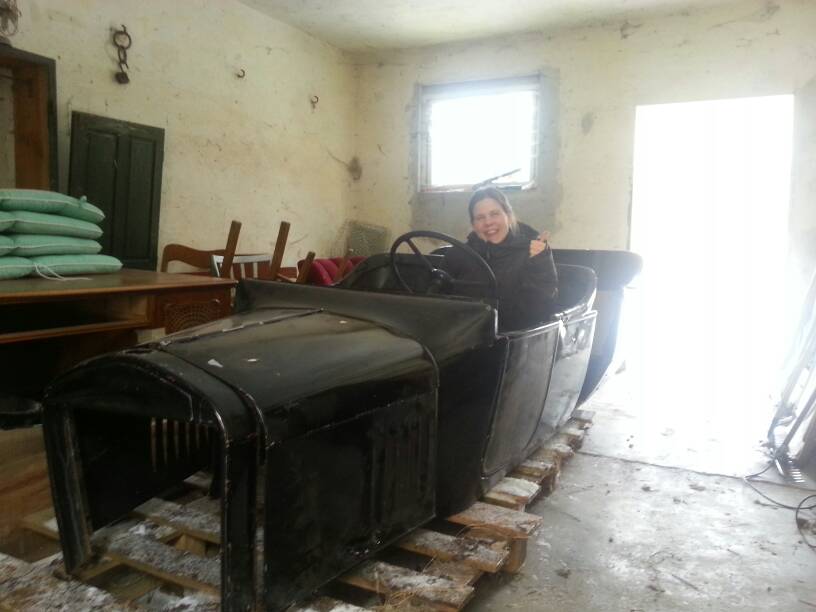

    Great Projekt!
    I will start the same this summer a banger t for the family 1392886922243.jpg
    My wife is trying sitting in it the first time...

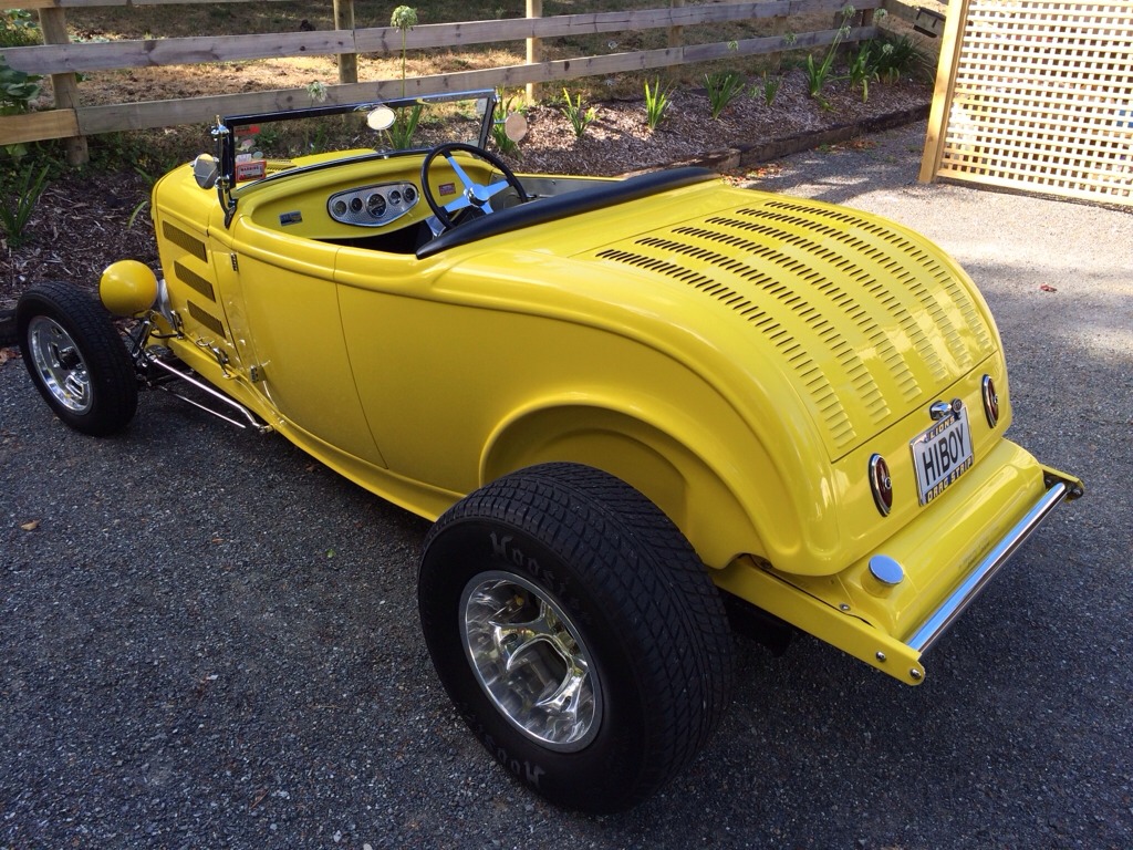

    Went out in my roadster tonight and couldn't resist this shot.

  6. No not that car - but I took it to Deuce Days in Masterton 2012
    Roy Brizio driving it

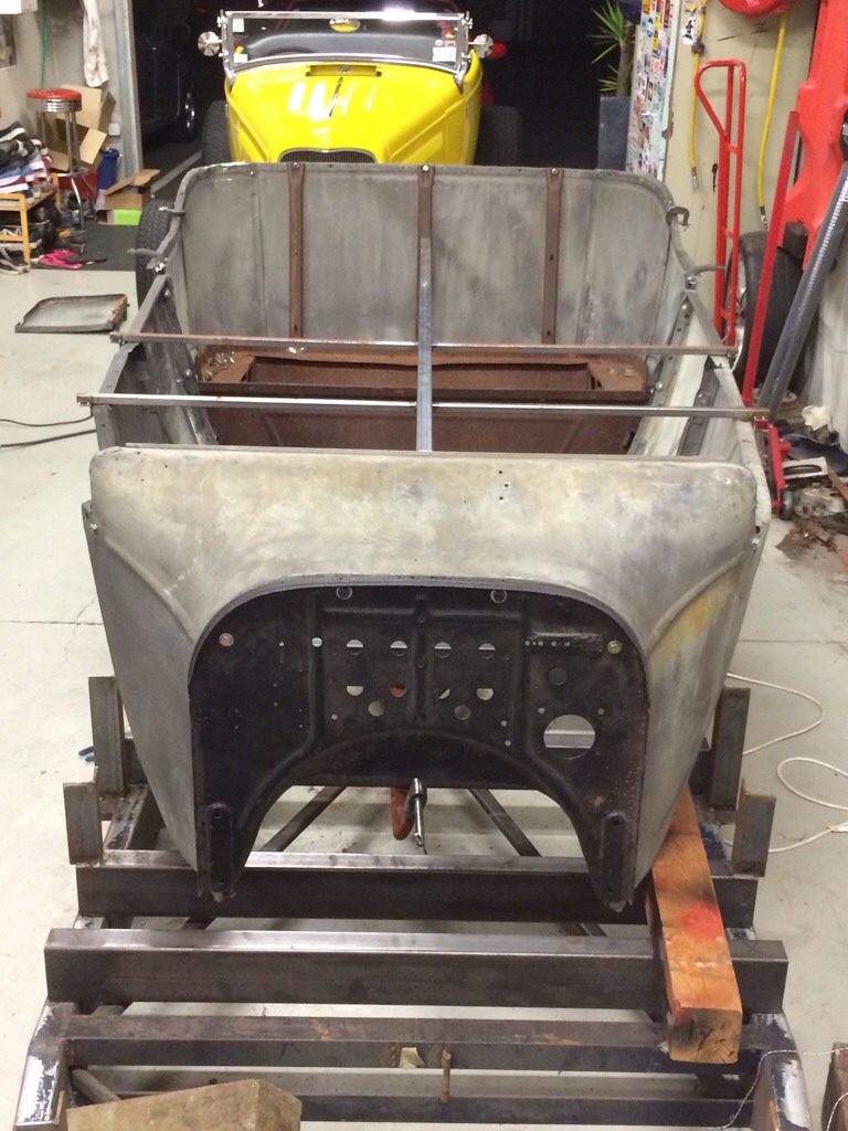

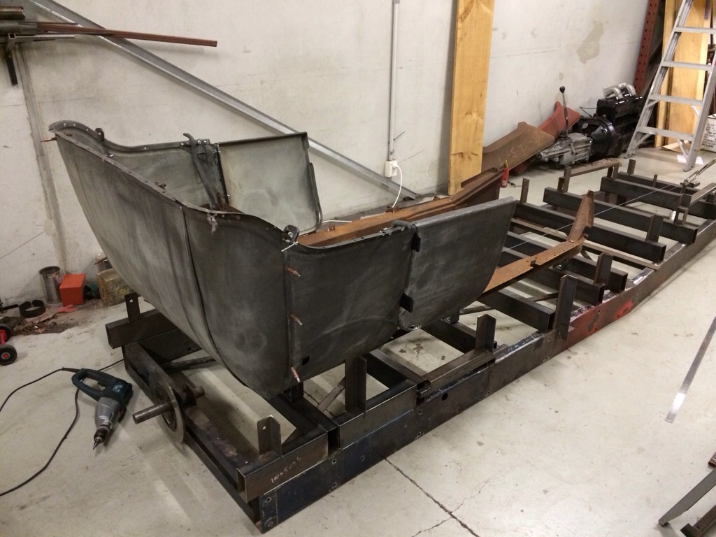

  9. Bolted the T sub frame down on to my Deuce ch***is jig. I now have a sturdy platform to work from to square up the body and frame it out.
    Got the rear section sitting on there and will move forward and mount the cowl etc this week.
  10. Tonight's progress - next up square this up and make a spine type frame to hold the body in place to steel frame it out...

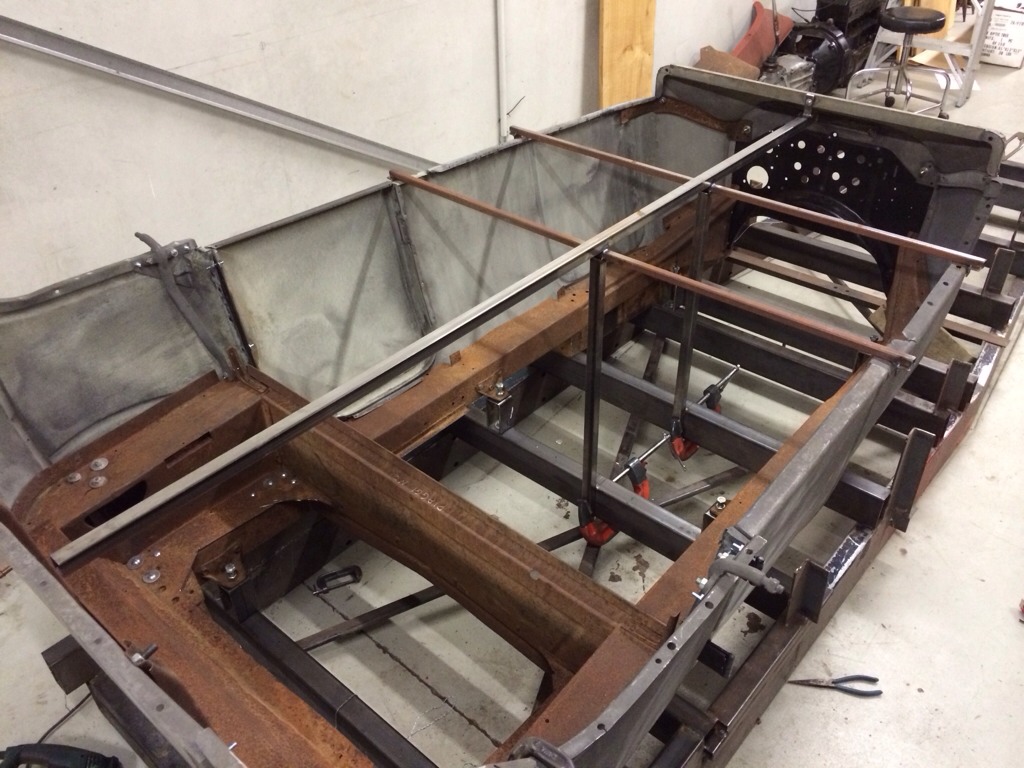

  14. Tonight's progress with the jig to frame the body ImageUploadedByH.A.M.B.1393325264.636421.jpg ImageUploadedByH.A.M.B.1393325286.658466.jpg ImageUploadedByH.A.M.B.1393325298.989043.jpg ImageUploadedByH.A.M.B.1393325312.463529.jpg

    That looks soooooo familiar. I was basically doing this same thing with mine about 4 months ago except I ditched the middle of the body and turned it into a roadster. There is alot more steel in your body than was in mine. I have never seen steel subrails, even those braces on the back panel are steel. Mine were wood.

    Ya, that's what I was saying earlier! Every "T" I have has had a wood subframe before '26... Interesting.

    I asked a few T guys I know and they have never seen them either. They are baffled.

  22. This body was imported from the USA - I don't know too much about T's so it's all quite new to me so not sure re the metal subframe or wood. I have been repairing the doors and even started to roll up the tube frames for the doors.
    Next up is to finish jigging the body and start on the frame out

    Make the subframe in steel. Much easier, holds up better and makes door/cowl alignment easier.
  24. Yep exactly - you cant weld wood. :)

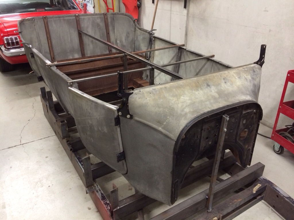

  29. The more you bolt to these floppy bodies the stronger it becomes - case in point was the screen stanchions.
    Bent some tubing up. The square 1" is for the door posts for hinges and latches to attach to. The small round tube is for the door frames themselves.
