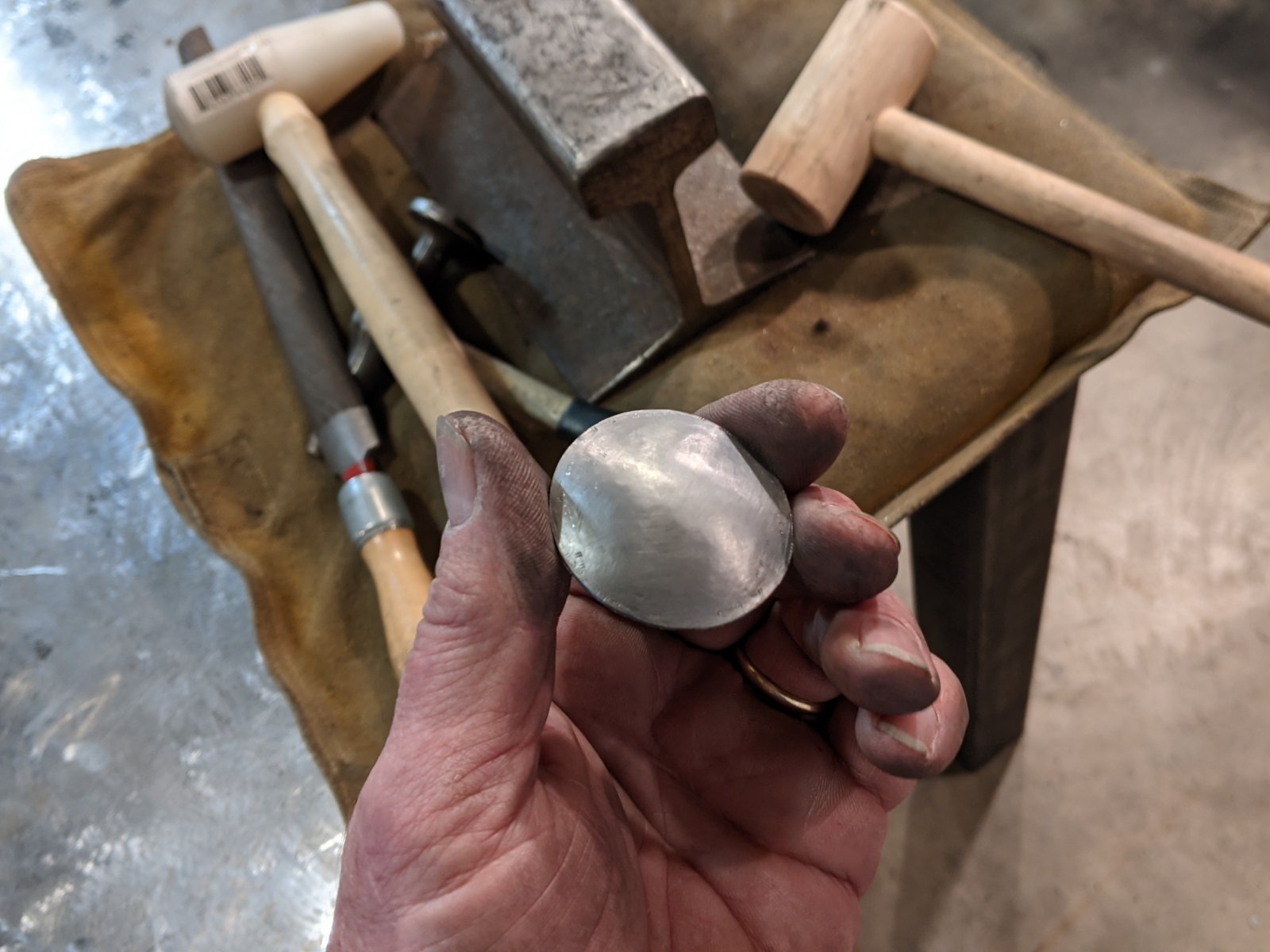

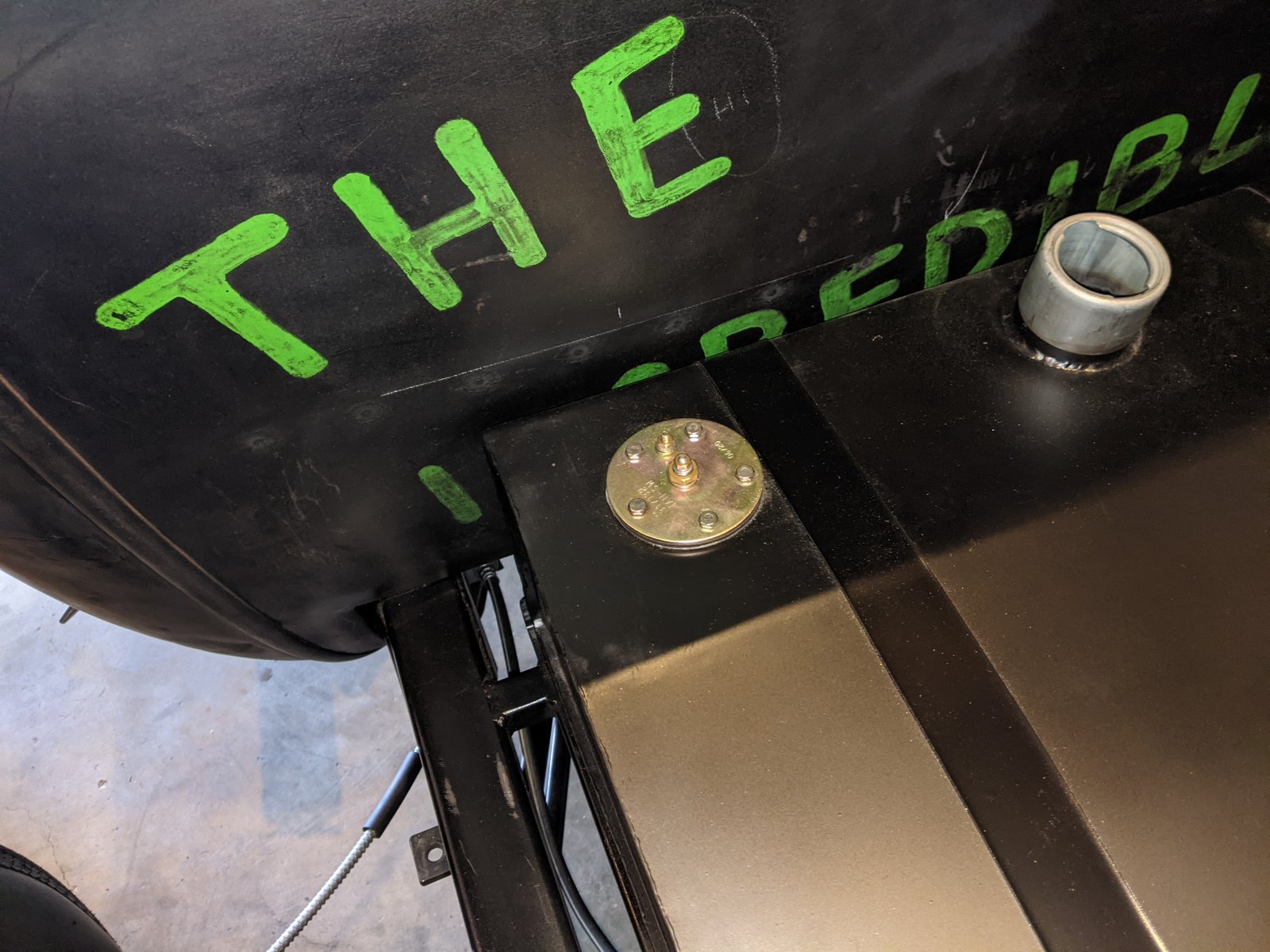

    Blister to clear sender
    PXL_20211024_192537887.jpg PXL_20211024_185926004.jpg PXL_20211024_192718627~2.jpg PXL_20211024_185947983.jpg PXL_20211024_194153160.jpg PXL_20211024_194207236.jpg PXL_20211024_195322814.jpg PXL_20211024_200708751.jpg PXL_20211024_220115660~2.jpg
    AHotRod, OFT, Stogy and 13 others like this.

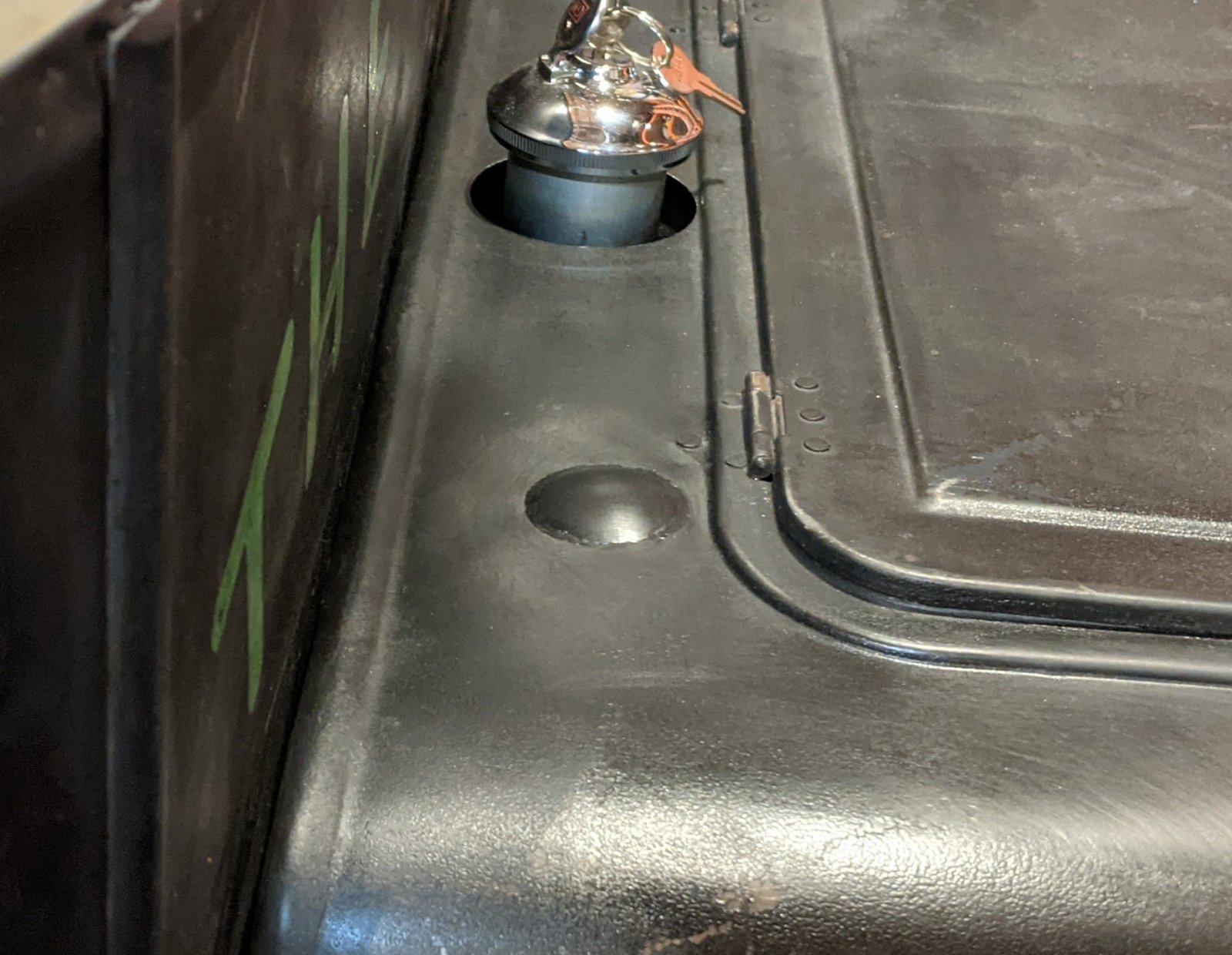

    Editor

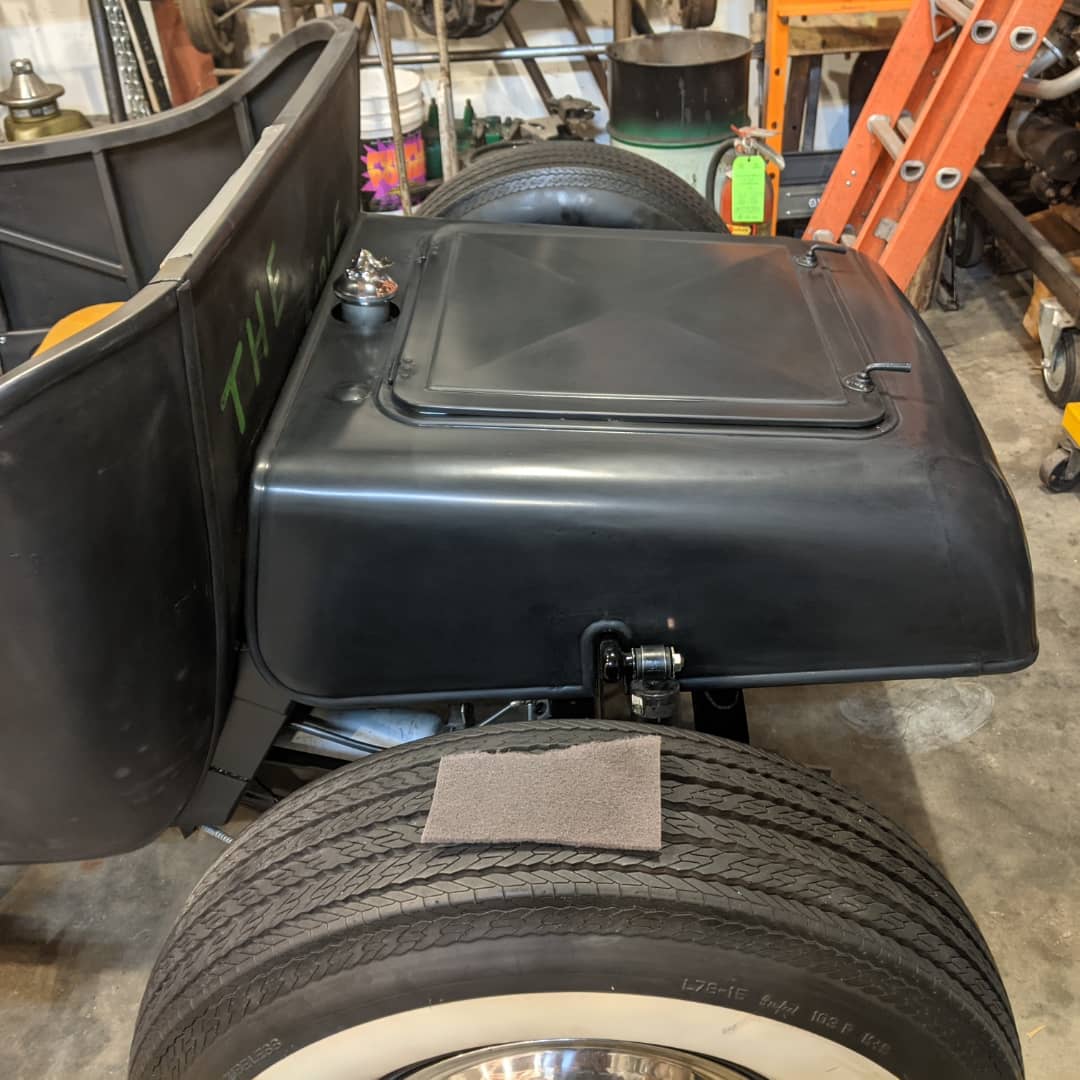

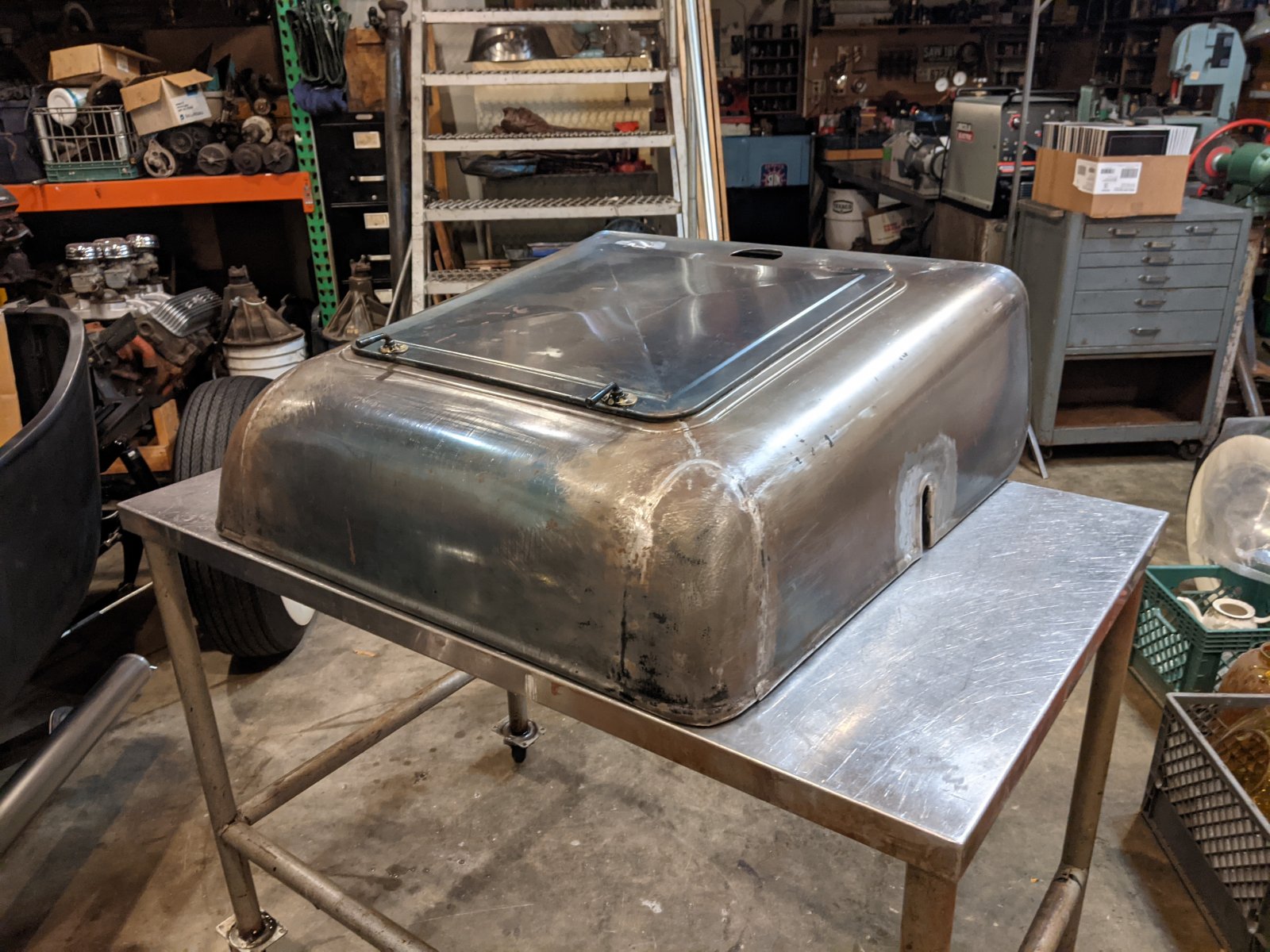

    Stripped the 100 year old paint off the turtle deck, paint was too far gone to save but the steel underneath is as clean and fresh as yesterday's.
    PXL_20211028_230326041.jpg PXL_20211028_230314184.jpg PXL_20211028_230241937.jpg
  12. Paul
    Joined: Aug 29, 2002
    Posts: 16,978
    Paul
    Editor
    Satin black to seal it and rub with grey scotch brite to take some of the shine out of it.

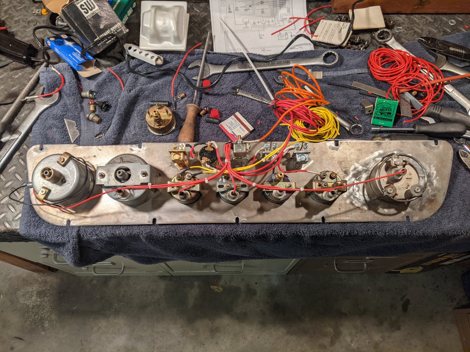

    Started wiring the dash yesterday.
    I have plenty of proper gauge wire, all new left over from previous projects
    but color choices are limited.
    RodStRace, patmanta, brEad and 10 others like this.

    Wow! Look at the spaghetti! I don't know about anyone else, but I go thru a couple of bundles of tywraps every time I wire something. Most of them end up on the floor cut off as I keep adding/changing/revising the harness. You should see my trailer, and it's not even complicated!
    brEad, loudbang and Paul like this.

    Fuse panel and ballast resistor mounted and dash ready to go back in.

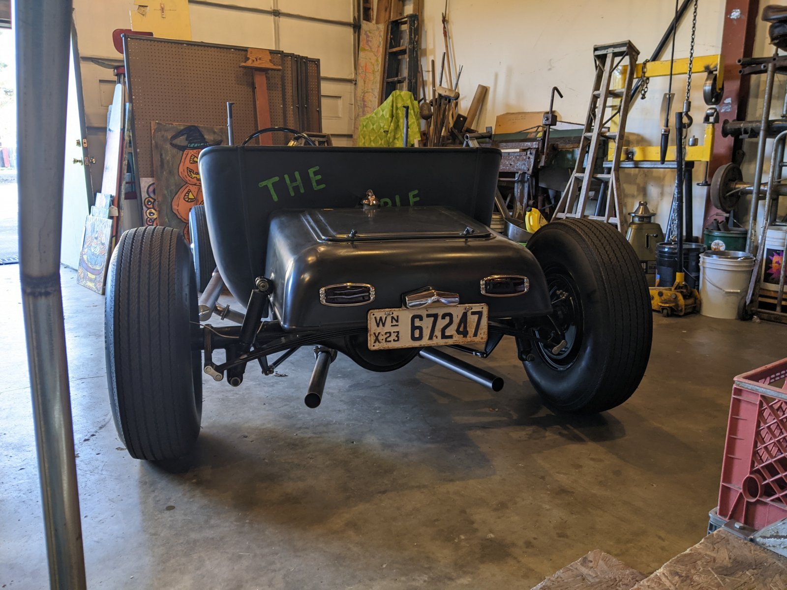

    Tail lights I ordered came today,
    Cheap reproduction Chevy style.. hopefully I can find some heavier bezels to fit because these are about as thin as tin foil..
    Oh well,
    I put blue tape around where they might fit, scribbled a bunch and drilled some holes and stuck them in place.
    Also mounted an NOS Hollywood tag light and YOM plate.
    Location will do but it will all need a little fine tuning to make it done.
    PXL_20211108_210602795.jpg PXL_20211108_224609906.jpg PXL_20211108_224629175.jpg

    Also begining to hate the tail pipes..
    Atwater Mike, brEad and loudbang like this.
  22. 64 DODGE 440
    Joined: Sep 2, 2006
    Posts: 4,433
    64 DODGE 440
    from so cal
    Liking that taillight treatment a lot. Looks natural.
    Don't sweat the tailpipes, that's an easy fix.

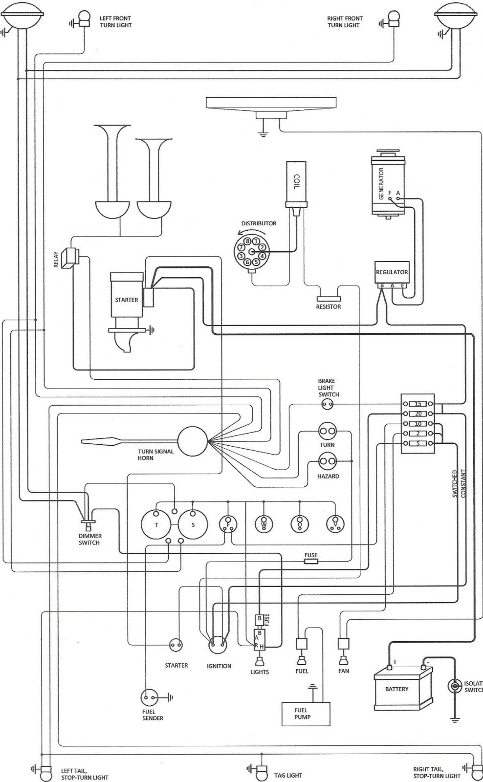

    Dash wires starting to fall into place..
    AHotRod, rod1, kidcampbell71 and 12 others like this.
  27. Paul
    Posts: 16,978
    Paul
    Editor
    drew up a wiring diagram.. hope it doesn't have too many bugs..
    winr, AHotRod, brEad and 13 others like this.
  28. charleyw
    Joined: Aug 5, 2006
    Posts: 2,322
    charleyw
  29. Paul
    Posts: 16,978
    Paul
    Editor
    Yes, Auto CAD 2015
    Atwater Mike, OFT, Stogy and 3 others like this.
