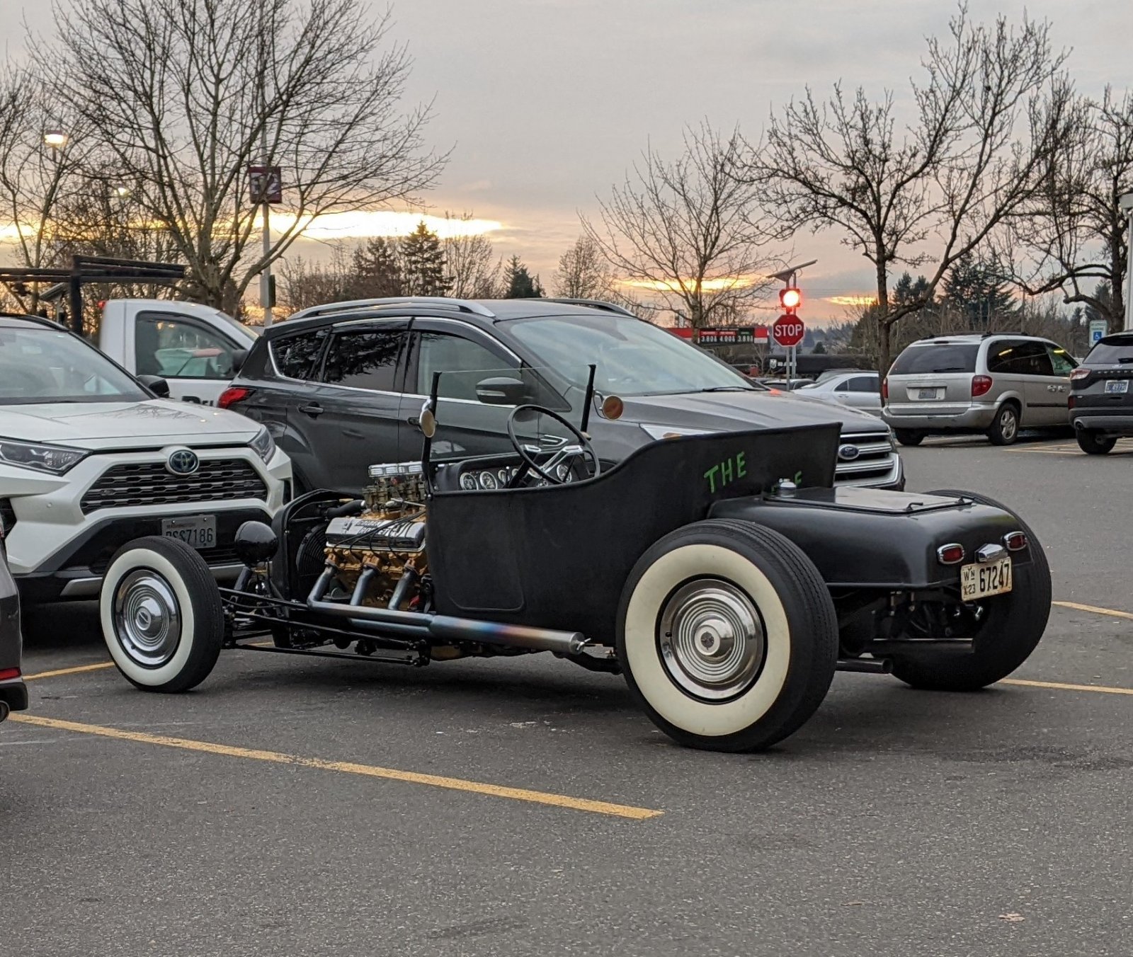

    I think I may have found the cause of uneven exhaust heat (and slight backfire at higher rpm).
    The heat riser tube in the exhaust crossover was burned/rusted through allowing fresh air to be drawn into the exhaust.
    I will be installing a manual choke so I just tapped and plugged both ends of the tube.
    It's all back together but of course it's raining again so test runs will have to wait.

    Another issue solved, something wrong with the charging system, generator was rebuilt a few years ago and run for a short time on the '27, then put on the shelf when I was lucky enough to score a chrome one, so I was pretty sure it was ok.
    Also fairly confident of my wiring schematic, but rechecked that anyway. All seems good.
    That left the regulator, it was an unknown I pulled from the shelf, used but visually looked ok, very clean under the cover and on the back. I put an NOS Badger chrome cover on it and crossed my fingers.
    Looked on line for a replacement and was surprised at the going prices.
    So I looked at it a little closer..
    The ground strap on the two mounting bolt end was missing, why I didn't catch that I don't know..
    As a temporary fix and check I pulled one of the rubber isolators and replaced it with washers.
    That did the trick, at idle with fuel pump and fan running the volt meter reads about 12.5, driving with headlights on it's that plus a bit.
    Drove around for a half hour or so and all seems good.

    Not much of an update,
    I did straighten out the tail pipes though,
    welded in a section of bend right under the rear axle and ran the pipes parallel and level back to end about the same distance back as they were.
    I think that will do.
    I've run about a half tank through it on the road now, getting closer all the time to a decent tune.
    Still not ideal yet, starts decent, idles nice and good power but coming off idle isn't quite right, I need to bring the rpm up to pull away strong.
    Maybe it's not getting enough squirt..?
    Just need it to stop raining for a few days to fiddle with it.

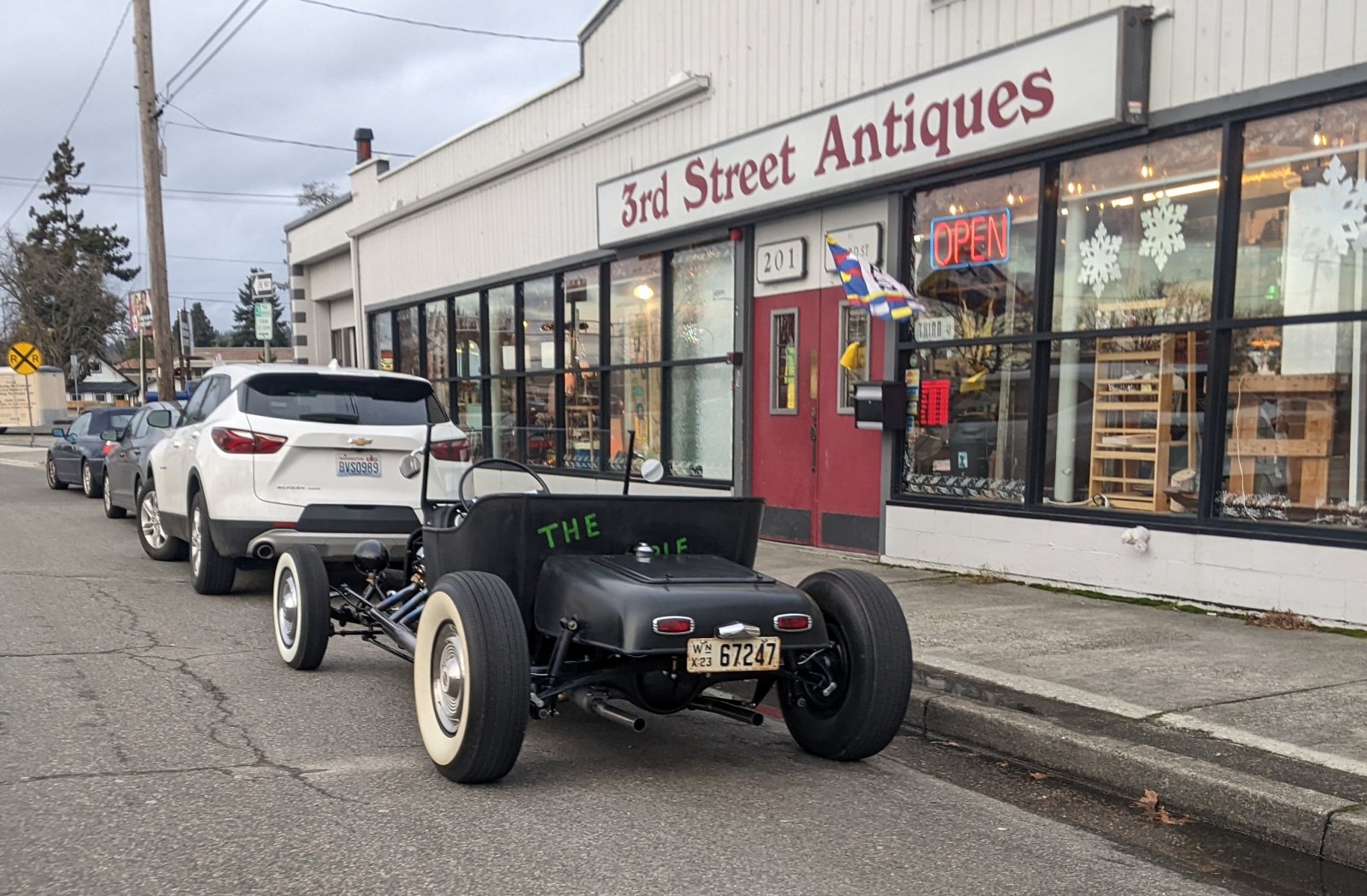

  21. 31Apickup
    Joined: Nov 8, 2005
    Posts: 3,637
    31Apickup
    Looks good, plus know that that establishment behind it very well.
    loudbang, Stogy and Paul like this.

  23. Paul
    Joined: Aug 29, 2002
    Posts: 16,964
    Paul
    Editor
    My wife has a couple spaces there and does the window. It's one of the better ones around here.
  24. 31Apickup
    Joined: Nov 8, 2005
    Posts: 3,637
    31Apickup
    We always stop in there when we’re down that way.
