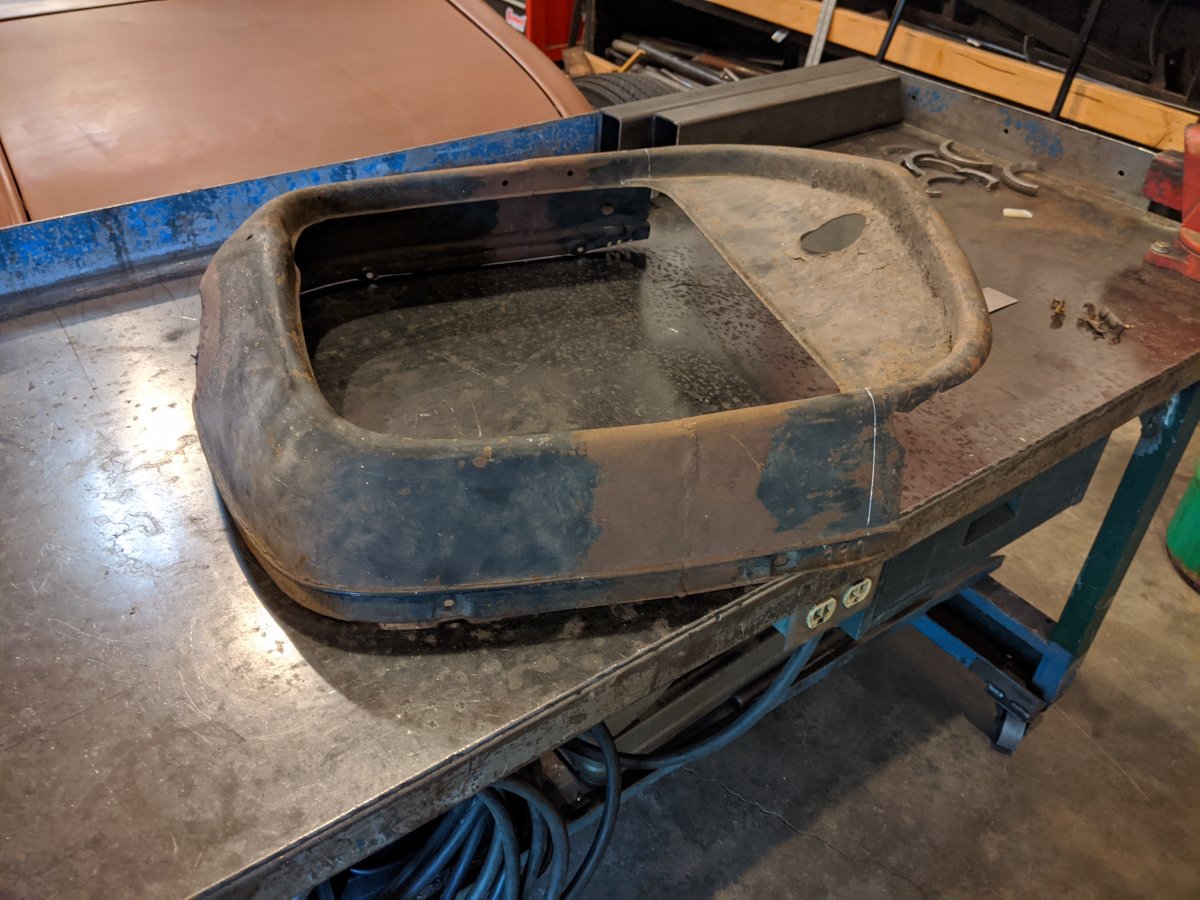

    Going to have to loose the bottom of this slightly modified original deuce shell..
    OFT, RICH B, loudbang and 3 others like this.

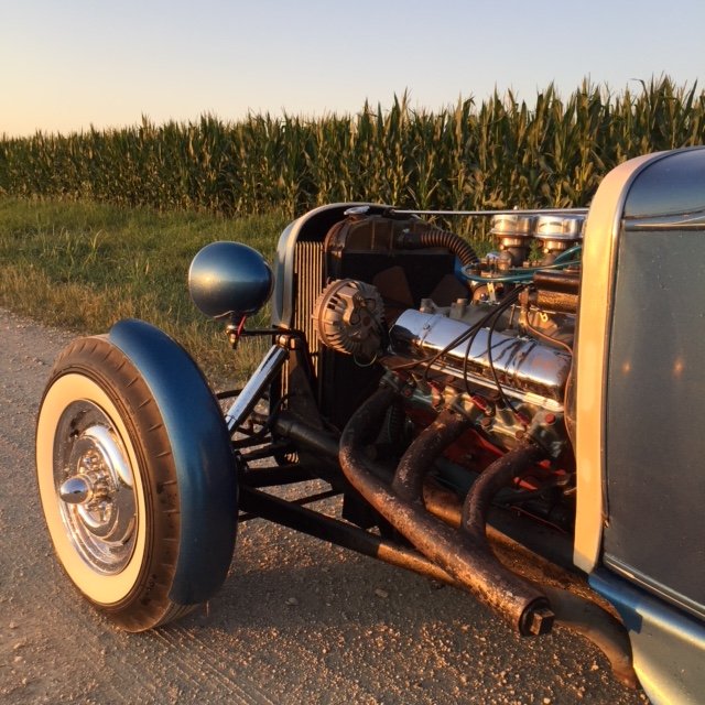

  10. Not that you asked but here are the headers on my roadster built in '58. My vote is to do them like Gene Chan's!
    neilswheels, Lil'Alb, Jet96 and 8 others like this.
