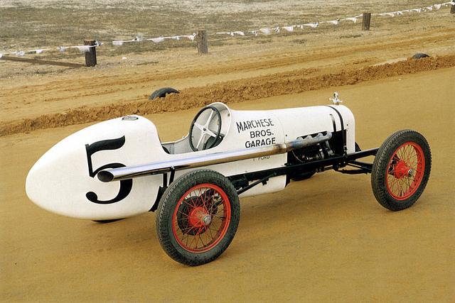

  22. The37Kid
    Joined: Apr 30, 2004
    Posts: 32,525
    The37Kid
    1925%20gallivan%20model%20t%20sprint%20car,%20marchese%20bros%20chassis,%20gallivan%20head.jpg
    Did I ever post this? Bob
  23. guitarguy
    Joined: May 26, 2008
    Posts: 650
    guitarguy
    You or someone did before. Its a neat car. There were a few cars they raced. I tried to contact them because I am pretty sure there is relations to me. Their grandfather was from Sicily, same as mine. No one ever replied...like alot of emails I send looking for info it seems :(
    kidcampbell71 likes this.
