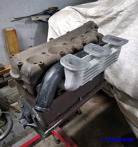

    @flyin-t , Besides two of my friends, your the only one in the public that commented on the B manifold. The truth is I absolutely love the look of the triples. But putting them all on active duty would be a disaster. While it's probable to do, not likely with this combo, so I'll just fake it with one center carb and two dummies on the end, but I have to keep that menacing look. This is for my "other" engine anyhow. The Fronty short block should be back within a week or so.
    winduptoy and Dannerr like this.

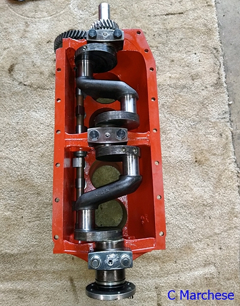

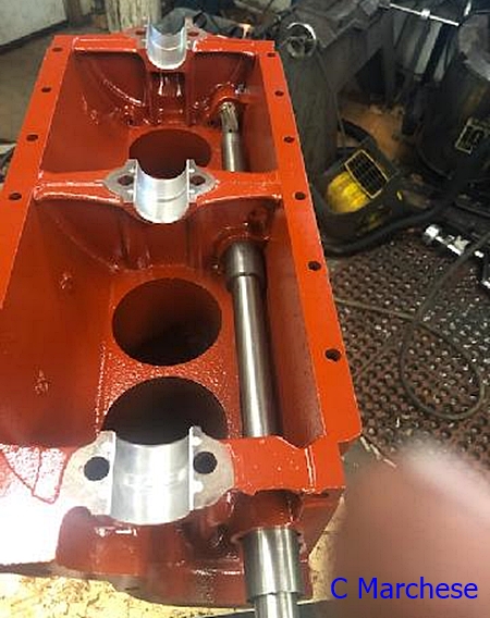

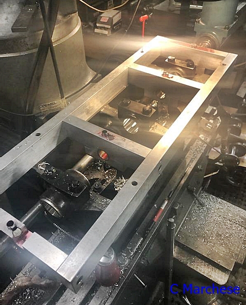

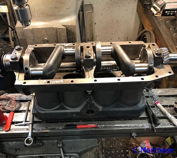

    OK, a smattering of pictures from the one machinist. The engine is all crated back up, and will leave this week and on its way back to me. With any luck, I may have it by the end of the week, at the least early next week.
    Then its on to my own machinist for some finish up work....then I can ***emble the short block for good. So much more to do. The tally is getting pretty high for a 60 HP engine. Kind of scary actually.
    So anyhow, the mains were bored
    Oil grooves cut:
    Then, the crank was finally able to live in its home:
    Reaming out the rear cam bearing:

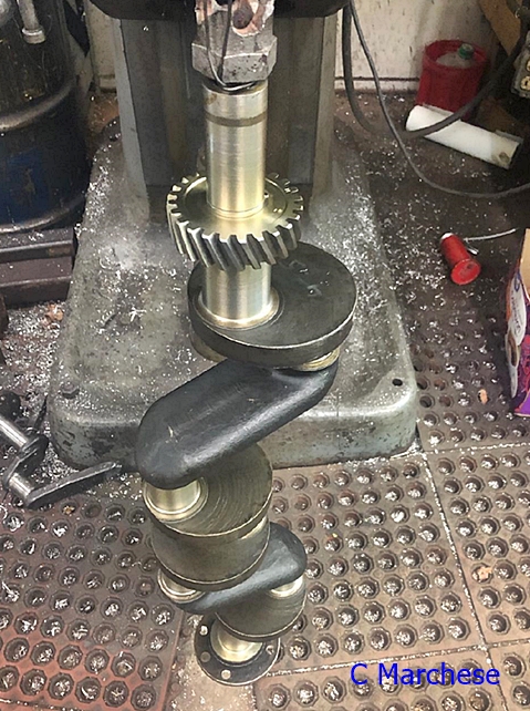

    The spare crank I had done, just in case. I definitely don't think I could trust anyone around here to do this work. Lets see if I can remember all that was done....
    Turned snout down to accept T timing gear (Dan McEachern gear)
    Shortened front main to move the gear back to T spec
    Modified gear key
    Turned snout down to have sleeve installed for smooth front seal running
    Shortened front of snout and re-radiused the threaded hole for the ratchet nut
    Turned mains to 1.590"
    Turned rods to cleanup the journals 1.475" (.025" undersize)
    Rear of crank is stock length, not shortened like most of conversions.

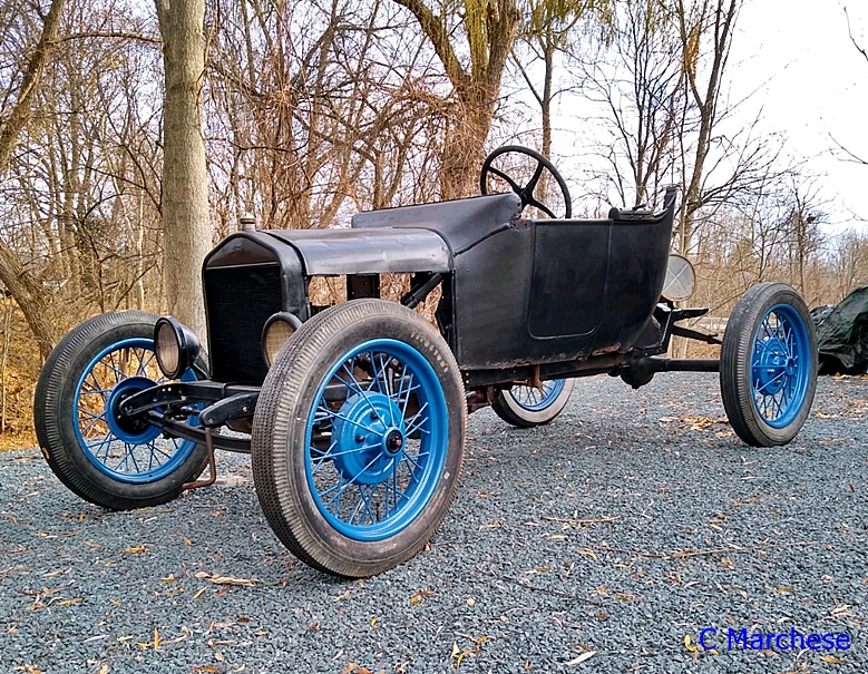

    Update in time for Christmas, I received my A crank conversion back.
    But alas, this is the end of the outside games until next year, I managed to get it all tarped up good for winter, so now I move onto indoor projects. Don't you love back yard builds?

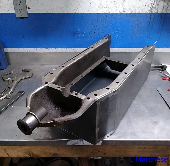

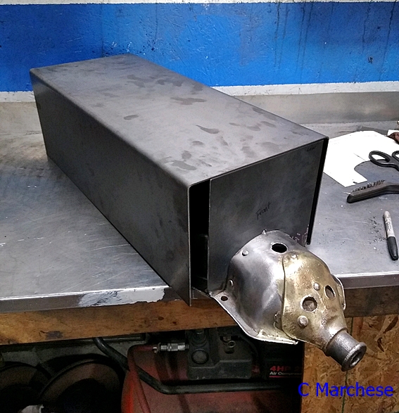

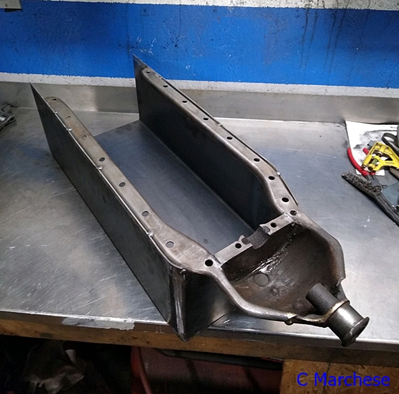

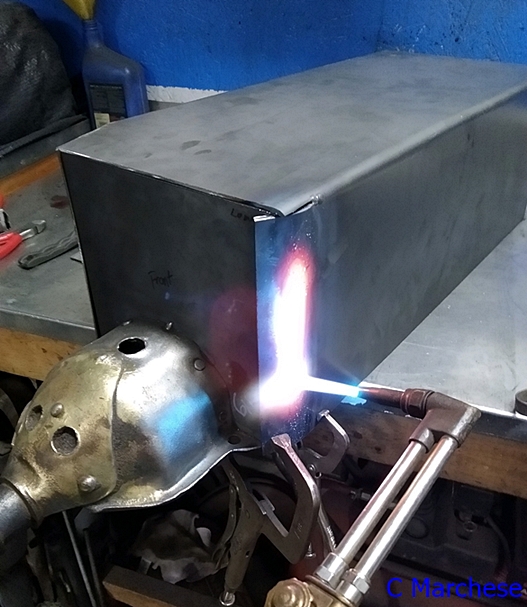

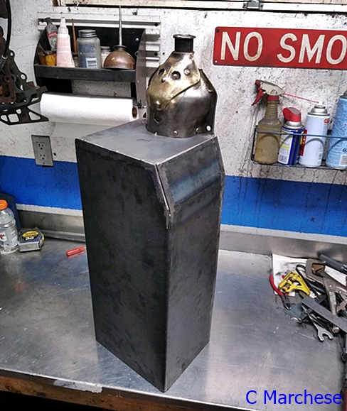

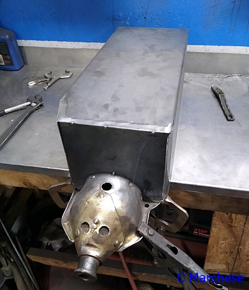

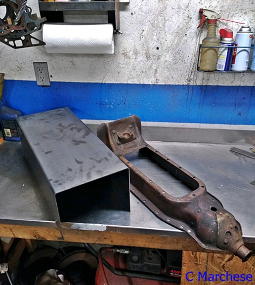

    Lets start building an oil pan, Frontenac style. This is loosely based off a real Fronty pan, which are about as rare as hens teeth----even the small run of repop ones.
    So here we go, start with an stock old 3 dip oil pan and trim the excess off. Then have the local metal supply company bend up the bottom and sides of the pan from 12 gauge sheet steel. A friend has a repo pan so I based my measurements off his, so the pan is 8" deep.
    Clean up the important parts

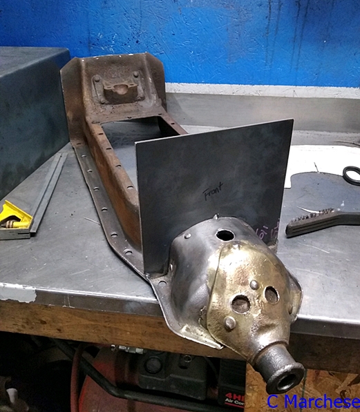

    Start making a template for the front endcap:
    And build it from plate steel:
    Set the "pan" on top for a test fit...all is good:
    After a couple of tack welds, start shaping the front sides to fit:
    Getting there slowly:

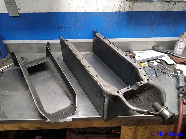

    Now cut the excess from the original out as we only really need the pan rails and front snout:

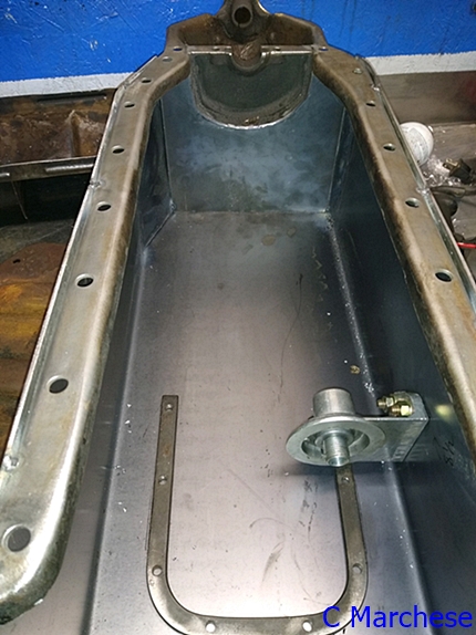

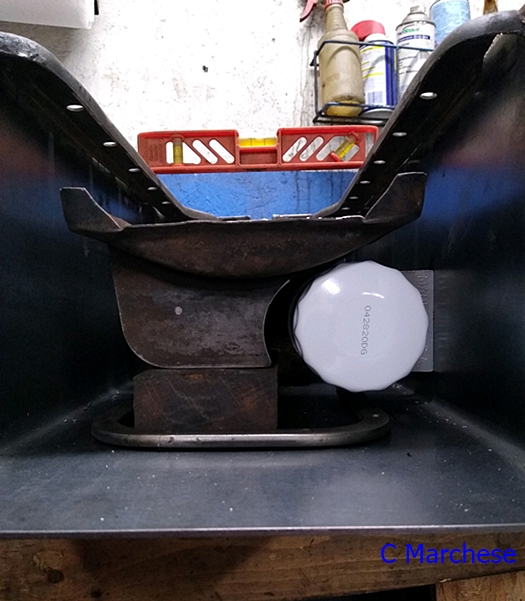

    This will be a semi pressurized oil system (pressure mains, splash rods), and I was told I pretty much need to run a filter my the guy who did A crank conversion. No issues there as I have been thinking how to hide such things so it all looks right from the outside.
    Test fitting with the A dip tray installed. Well shoot, I could have gone a little lower on the filter...so that will have to be fixed. But it all fits so far:
