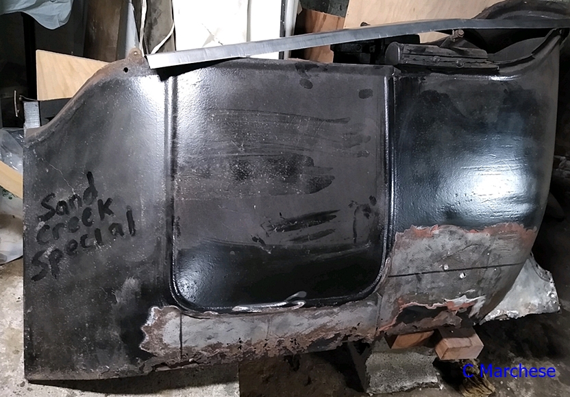

    So I took a couple of days off work. I decided today to start tackling the repair panels I had a friend of mine form, before they rusted in my basement with the rest of the body. So out to the garage i went this morning. After a quick setup, first order of business was to remove whatever this backing panel was that was put in long ago.
    OK, now that that is out of the way...for no reason on it being there....
    So lets do a quick cut on some of the old stuff:
    I then laid the new panel on to get a much better idea on where I was going:
    OK, not so bad, so alot of cutting, test fitting, cutting, test fitting, on and on until things were satisfactory...or I just went to far and created more work filling holes :rolleyes:
  24. Your friend does a pretty damn good job, I thought that was a patch panel for a second!
    guitarguy likes this.
  25. guitarguy
    Joined: May 26, 2008
    Posts: 650
    guitarguy
    That he does. These are one off panels so I am desperately trying not to screw them up putting them on. Which leads me to my screw up.
    Things were going pretty good, and that's when I noticed I was in trouble. I was losing the outside contour of the body were the panel splice seam was. Hard to explain, but it was like there was a serious misshape somewhere behind the fake door, and I had a huge valley as the panels sloped to met each other---even before I got to welding them, so it wasn't heat warpage. Well I had the front under the door already stitched in. So as I tried to fix the valley, it became quickly clear, the cut lines behind the door were now incorrect. I had to cut more off. Hopefully I didn't totally mess this up, but as I got to the end, my body line that was perfectly lined up was now a good 1/4 off. See pic below, I highlighted the line with a marker:
    Well shoot. Now what. Well, here is the deal. It wasn't really terrible (by my standards), but I had to so something. So I started tacking and hammering and repeat. I got it somewhat better...not perfect, but good enough for me...and probably most people. I fudged it the best I could. I mean I didn't exactly start with a pristine body here, right?
    The other issue I was fighting in this whole deal was where the bullet holes are, if you remember back a few posts, that was a huge dent and caved in and filled with lead. That area was thin and oil canning. I knew if i was careful, I could weld in that area and shrink the metal. It pretty much worked!
    And really sitting here thinking about it, where the body line is, it's on the lower section that starts to roll under, so hopefully most prying eyes don't see it in the end. My only concern is the back panel fit up, but that will have to come later and be tweaked as needed I suppose---it too needs a lower section replaced.
    So here is were I finished my day. The panel is tacked in place, and needs finish welding. Maybe tomorrow---maybe next weekend, we'll see. I'm pretty happy so far. Butt welding sheet metal is a huge learning curve....especially when one side is pitted old metal.
    Oh, I decided to leave one bullet hole for some character. I have to figure out how to deal with the huge crack above it though.
