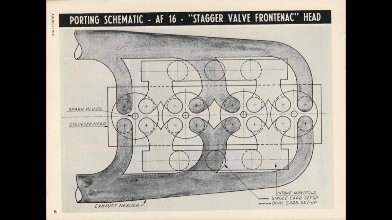

  26. Kevin Pharis
    Joined: Aug 22, 2020
    Posts: 662
    Kevin Pharis
    from Califunny
    You may want to reconsider... the only Fronty head for a Model A/B was the “Stagger Valve”. Nothin says awesome like intake and exhaust manifolds on both sides of a twin cam banger!!!:cool:
    Jet96, Dannerr, brEad and 5 others like this.
  27. Hey Kevin, do you have any more photos of this?
    Also, do you have an Instagram where you post progress on your winfield stuff?
  28. Kevin Pharis
    Posts: 662
    Kevin Pharis
    from Califunny
    Here is a great link to the history of the Stagger Valve head. There are a bunch of great pics of the design blueprints... but none of the finished head;
    https://www.chevroletbrothers.com/stagger-valve-fronty
    There is one on the Speedway museum website, but has been converted to cross flow... still friggin cool... but not quite as cool!
    Jet96, guitarguy and GuyW like this.
