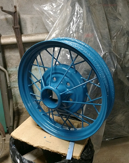

    Soooo, remember way back at the beginning I said this was a back burner project. Yup, as you can tell it's moving at glacier speed.
    The rewooding of the body has got me on a serious downer. It is quite a complicated process that I truly need to be in the right frame of mind to do. That and burning up three perfectly good bandsaw blades on reclaimed wood I was cutting for house trim only to find some hidden finish nails in the wood had me reeling on the purchase of more saw blades as money is definitely not growing on the trees out back.
    So back a few months ago, I reprimed two 19" A wheels I had straightened to a satisfactory state at some point prior. In the effort to get anything done, I decided to get at least one painted. I have had the paint for a while. It is Ace Hardware Stop Rust Harbor Blue. I have had good results in the past with it, and it is just about the right color I was after---although I thought it was going to be a touch darker. I'm still happy. A few touch ups and this one will be ready to mount. I have tires and tubes sitting here too. The tires are used but in excellent shape from a "stock" Model A guy that had to have white walls. So thanks to a friend that tipped me off to the craigslist ad, I scored his 5 tires for $100 plus a 3 hour round trip...the tubes and flaps I bought new.
