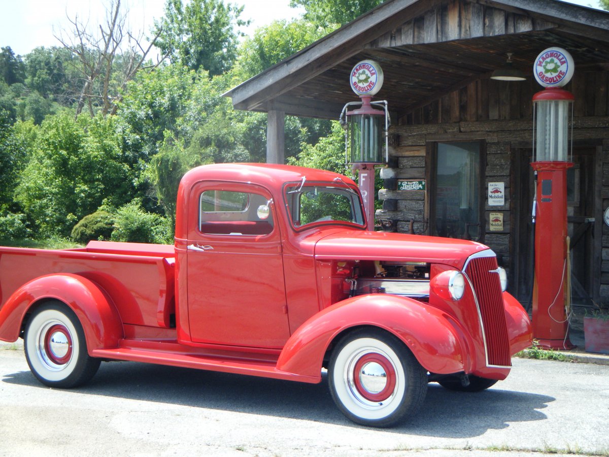

    DSCF1465.JPG DSCF1450.JPG DSCF1452.JPG I have a 261 with 2x2, mild cam, fenton headers and t-5. I used small block exhaust valves, 1952 powerglide intake valves 848 heads with a mild port, 2.8 electronic ignition and pvc valve in modified draft tube. 0.60 forged flat top pistons. I have over 40, 000 miles in my 37 PU. I love it. This replaced the 235 I wore out.
