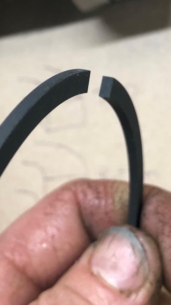

    Got my new rings in, but noticed a difference from the old rings.
    The old ones were chamfered like the drawing here. The top ring is the same, but the second ring is square. They were ordered from Hastings for this specific application, is this anything to be concerned about? [​IMG][​IMG]

    On closer inspection, 6 of them are chamfered on the inside, but the instructions say that the chamfer should be face down, while the ones I took off has the inside chamfer face up.
    Man, I don’t wanna **** this up. Little things like this drive me crazy. So many weird little things I’m not sure of. The ring thing. No lock washers or palnuts on the rod cap studs.

    s55mercury66
    from SW Wyoming
    Contact Hastings and consult your service manual.

    Looked at the manual, and called Hastings. Both say to put the square ring on top. Hastings said they’ve never seen chamfered top rings, and I noticed that the ones that were on it weren’t all the same. Some chamfered, some stepped, one of them was square... between this, the weird mismatched pushrods, the one headbolt that was too short, and just kinda sitting in its hole, and the way the transmission was put together I think it was rebuilt with whatever parts were just laying around the shop.

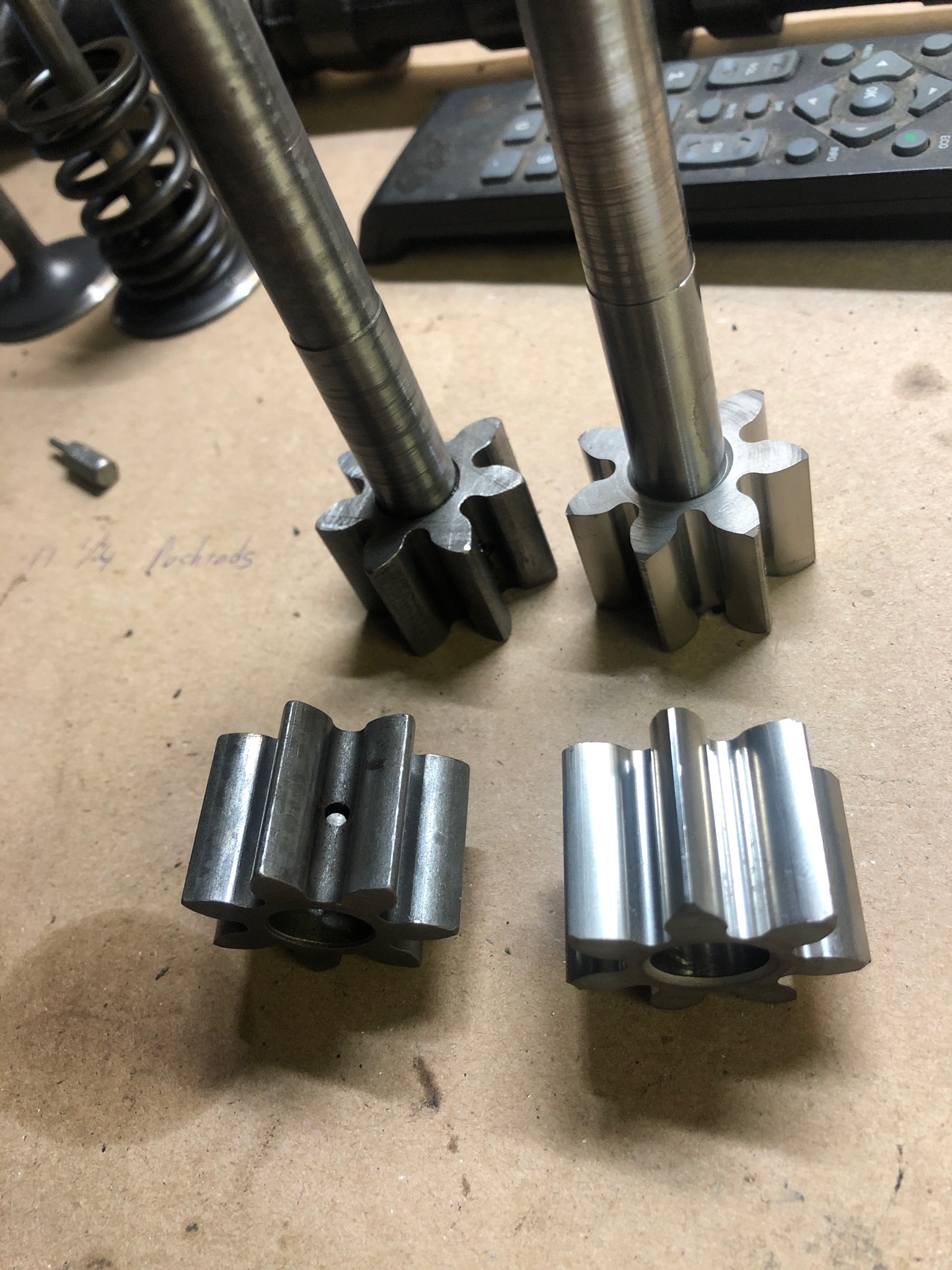

    Engine and head are now getting chem dipped, in the meantime I figured I’d waste some money and rebuild my perfectly fine oil pump. I notice the original driven impeller has a hole in it. The new one does not. I figure this hole is there so it can get oil between the impeller and the shaft. Should I drill a similar hole into the new impeller? The tolerance on this thing is tight as ****. I put it together without the gasket for a test fit and it’s so tight you can’t even turn it, old or new. I can’t imagine it would get much lubrication without that hole.
    Old on left, new on right. [​IMG]

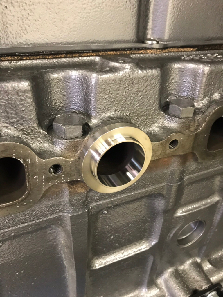

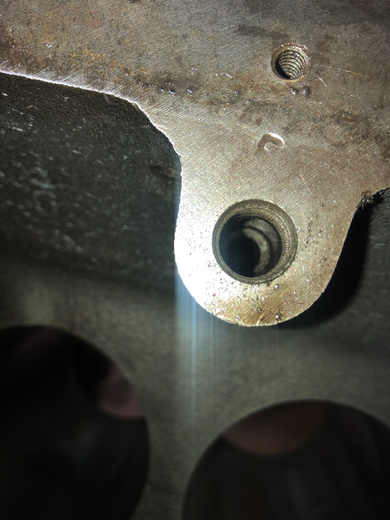

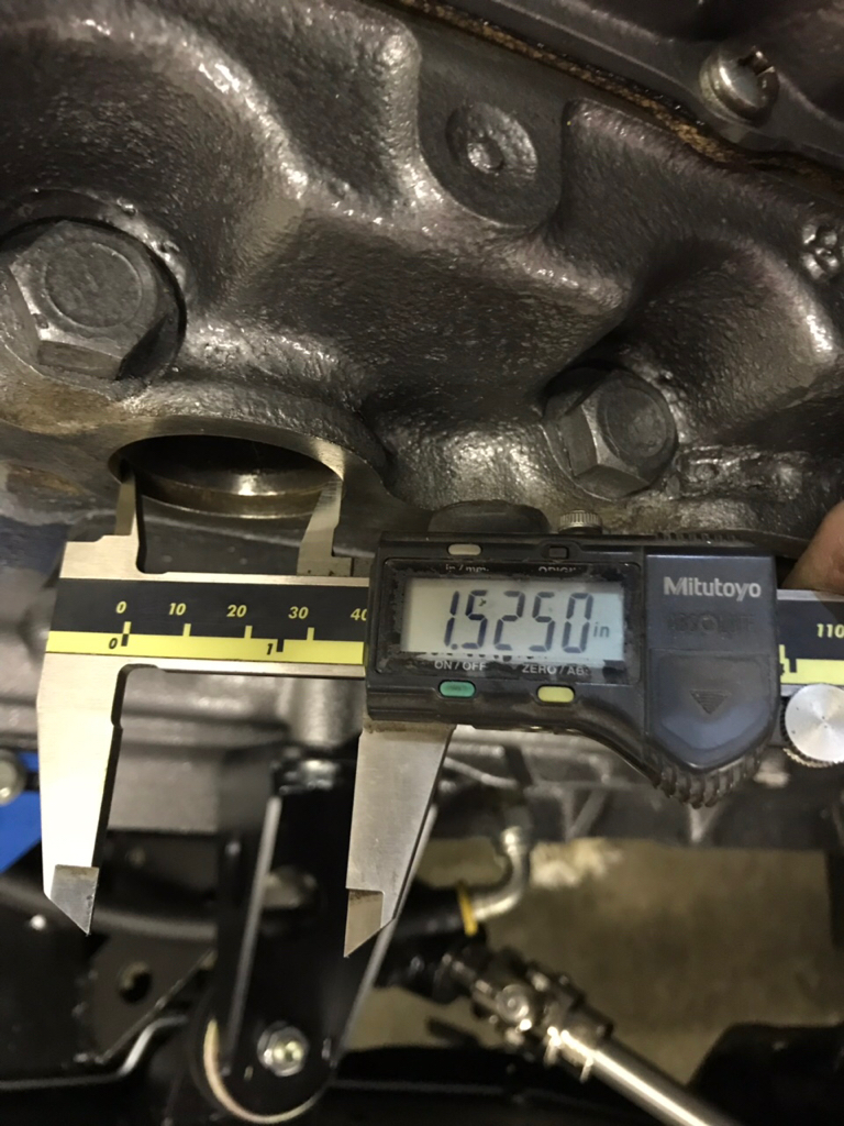

    Oh yeah, I also modded the block for a full flow oil filter. I’ll post a step by step once the engine is complete unless it’s already been done. Here’s a preview

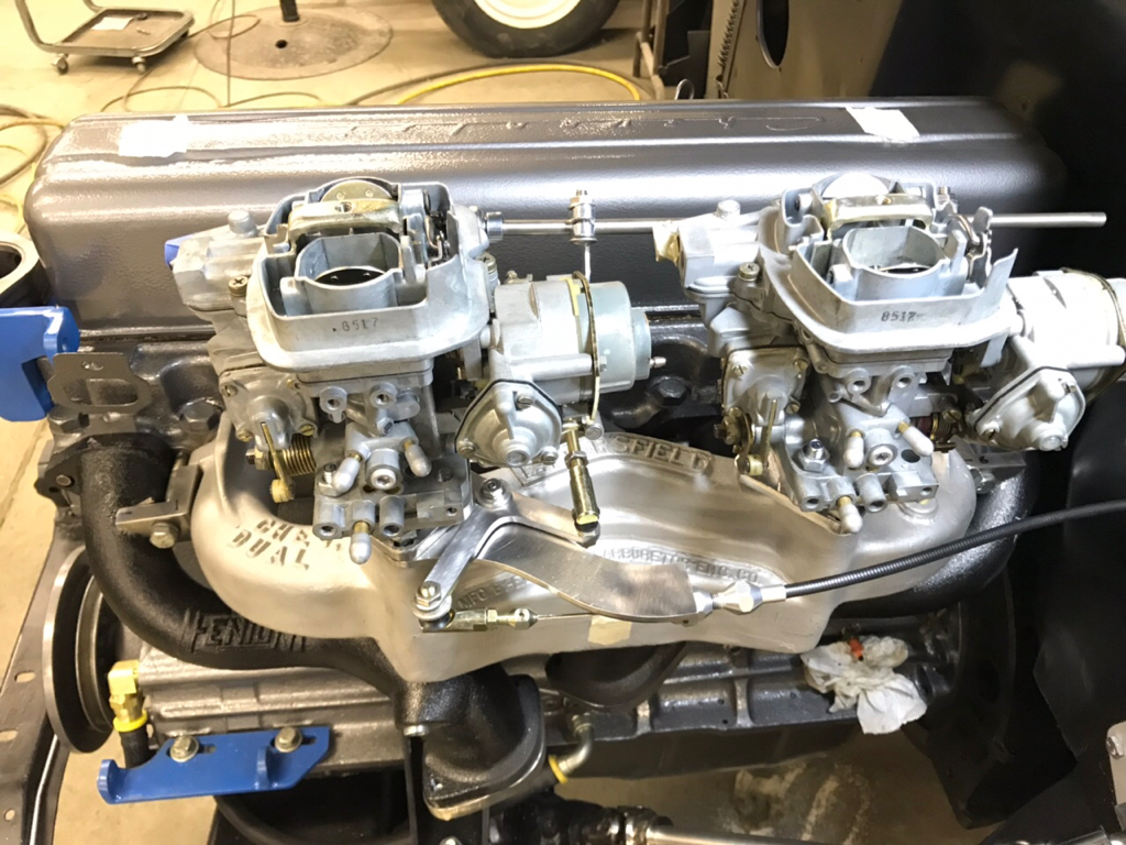

    I may be wrong, but I think that Thickstun is for a 216. You'll need different alignment rings to fit it, or you might need to open up the runners a bit.

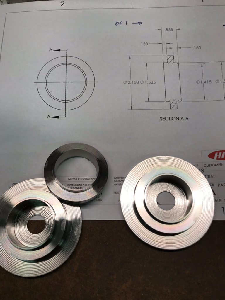

    I used a Tattersfield that was for a 216. I made adapter rings. I also needed to space it out 1/4” to better clear the Fenton headers. [​IMG][​IMG][​IMG][​IMG]
  13. I am concerned about your oil pump.
    It should not be very tight to turn,,,,,you need to check that out a little closer.
    Tommy

    Joined: Dec 6, 2005
    Posts: 493
    Ken Smith
    Alliance Vendor
    I agree. I would be more inclined to use the original parts. They typically don’t wear out.

    Does your oil pump need the gasket installed to have proper clearance?
    oilslinger53 likes this.

    I think that’s the issue. Clearance between the cover and the impellers should be .001-.003. Gonna put it together again tonight, with the gasket and see if it turns.

    Those are some damn nice adapter/spacers! Almost a shame that they won’t be visible!

    Put the pump back together with the gasket this time instead of loc515, and it spins freely.
    Also looks like the hole on the original driven impeller is for a roll pin. It’s the same as the drive impeller, which is pinned into the shaft. The new one is just a press fit, so no pin and no hole.

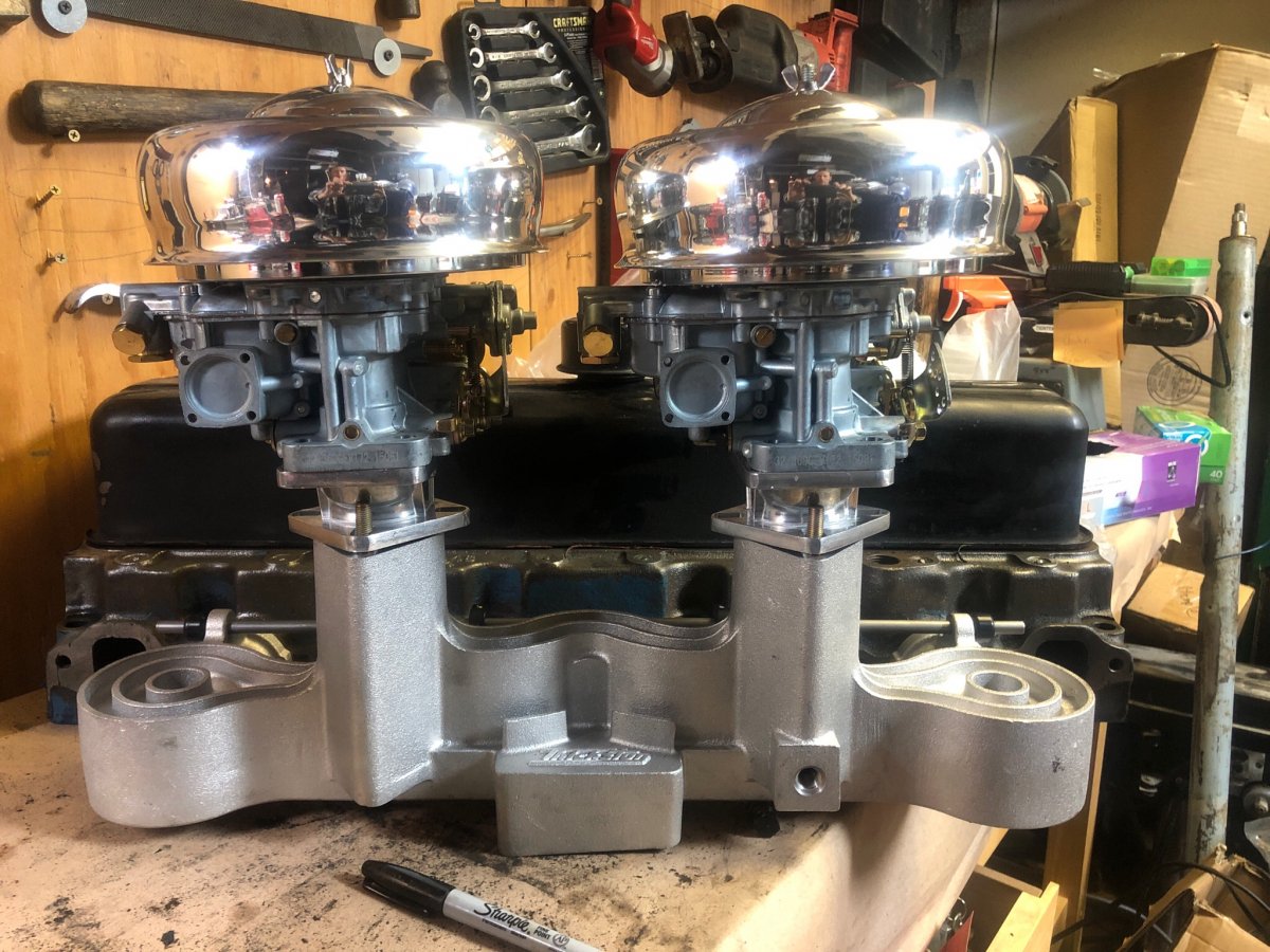

    Little update, work slowed a little, so the build also slowed a little. I’ve got all my parts, block and head have been chem dipped to remove all the scale. Saving up a little so I can take the block and head to the machine shop, and a bunch of stuff to the chrome shop. While we’re waiting, here’s a mock-up. When it’s done it’ll look like this, but the intake will be polished, headers powder coated, and engine doused in candy to match the car. [​IMG][​IMG]

    I was having alignment issues with the Thickstun valve cover until I realized there was a slight interference between the oil filler cap and the rocker shaft oil line. I also grew weary of getting the four stovebolts started that fasten it to the head in the small recesses of the Thickstun cover. Knowing the cover comes off often to adjust the valves in my case, I replaced the stovebolts with studs and hexnuts.

    Tom Langdon should have the adaptor rings for your intake.
