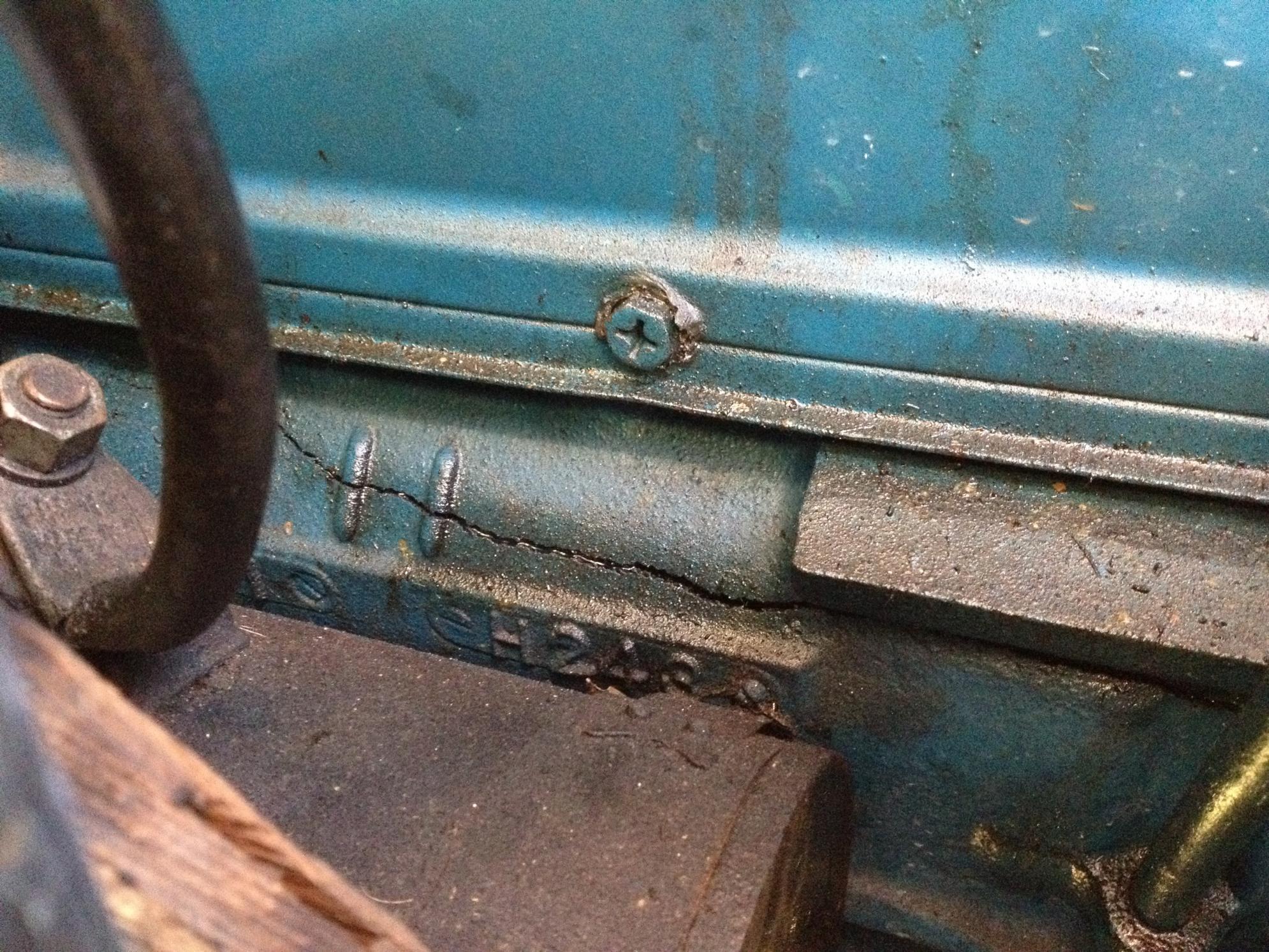

    from S.E. MI
    Your engine looks to be a 261 because of those "CAPTAIN BARS ". I have a 261 in my 50 it's so much better than the 235 I had ! The truck has loads of power shifting the 3 spd on the column. My oil pressure from the stock gauge reads about 30psi cold , at idle warm around 15psi. I use shell rotella 15w 40 and have more than 4 thousand miles with the 261 with no issues. My engine has had a 235 head put on by previous owner. All 261"s I believe had solid ifters/cam in them, that's while they have a ticking sound at idle. Mine has that ticking sound at idle. From what the old timers have told me if they sound like a sewing machine your golden ! Hope you can fix that block. Those are kind of hard to find.

    Truckedup
    Heathen pointed out 52-54 blocks have the motor mounts shown.It's also been noted,more than once,54 235's have Capt bars, so...........at any rate it's junk.
    Did the block just crack? Or did something inside the engine try to escape?

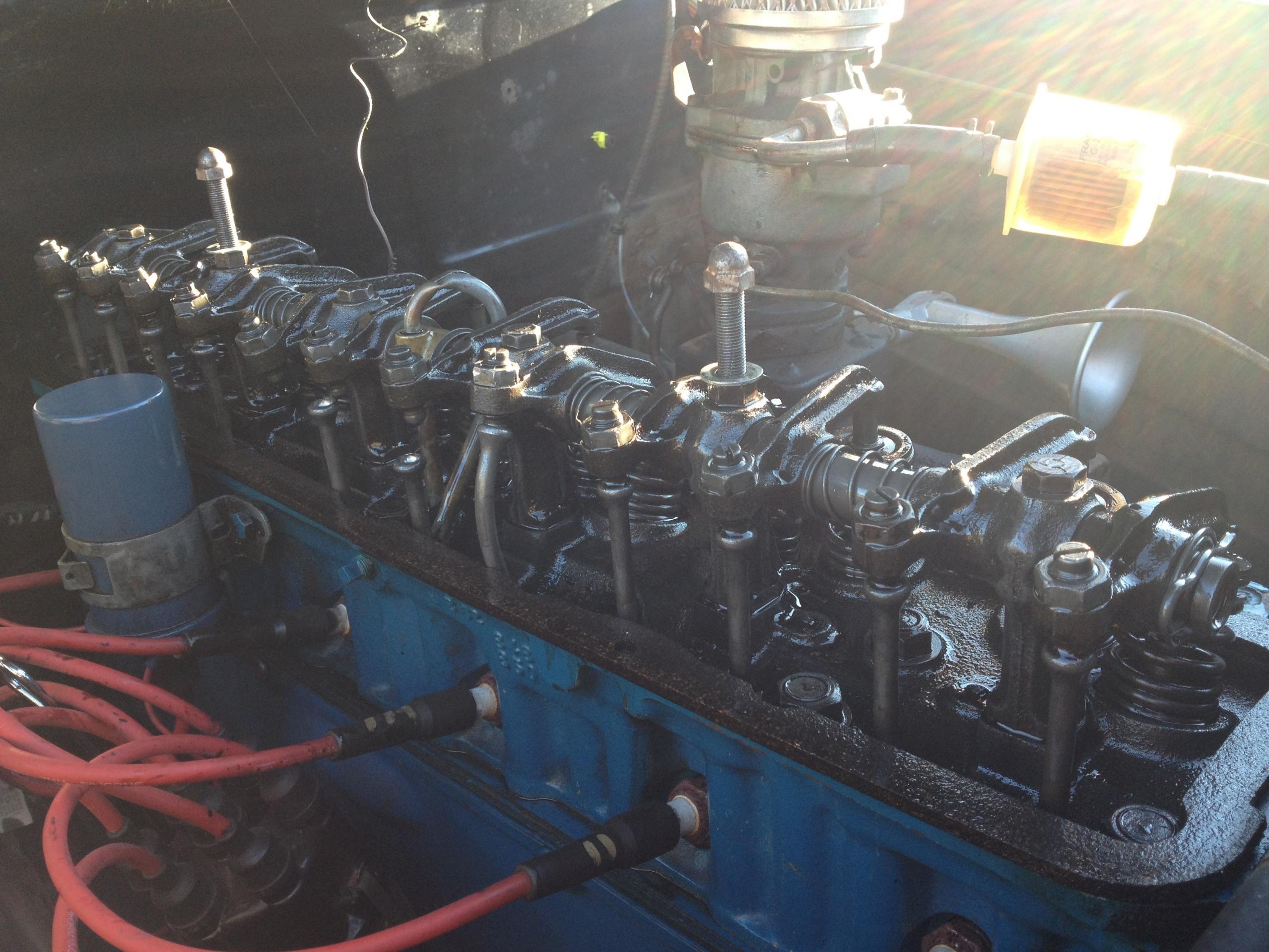

  7. slackcat
    Joined: Oct 25, 2010
    Posts: 562
    slackcat
    Brutal photos. Hope you stick with a six........then again I'm biased.:)

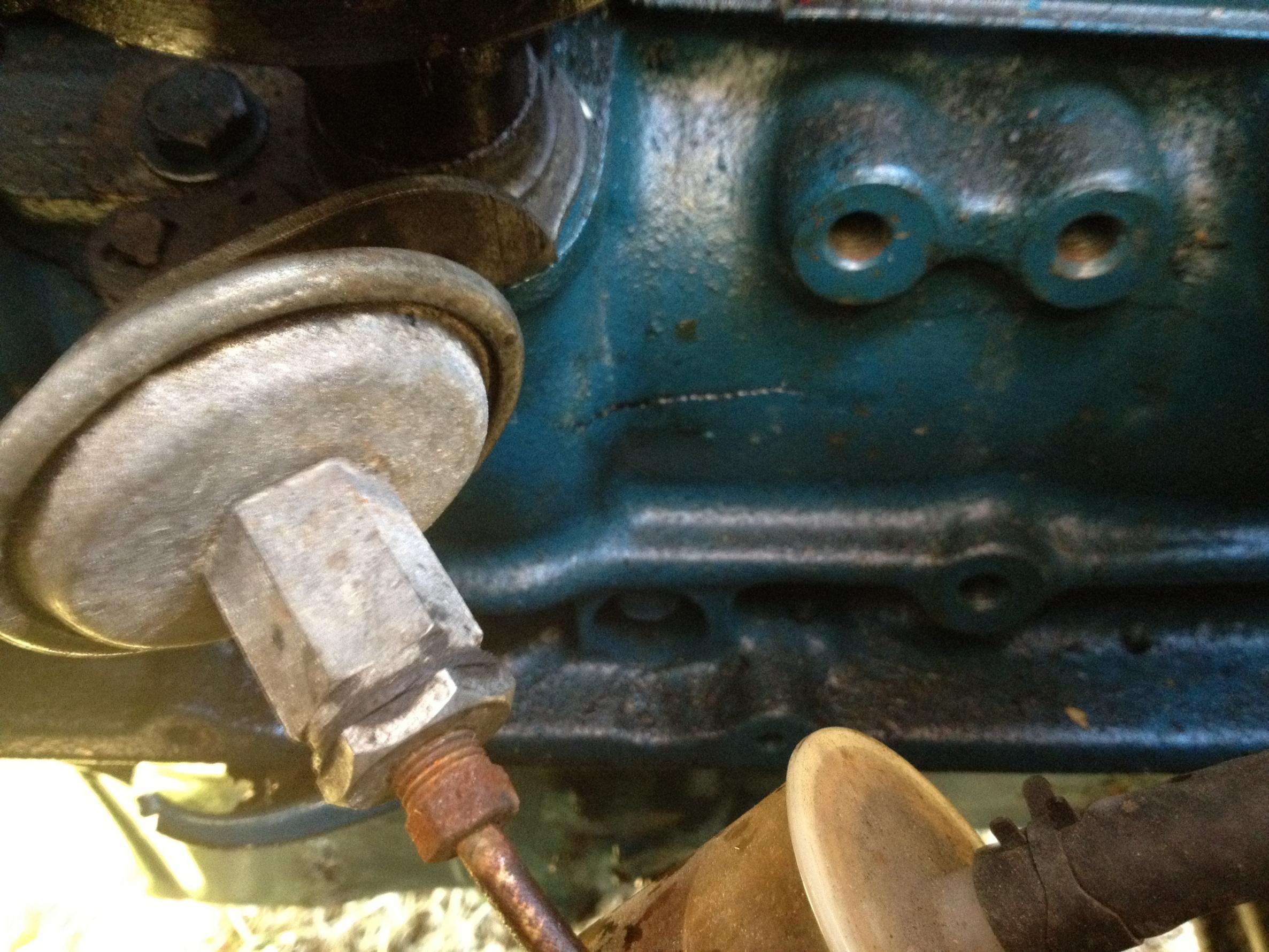

    Posts: 587
    g-lover51
    from Dallas Ga
    Something tried to escape. There is a few holes in the oil pan as well. And it left a nice trail of oil for about 1/8 mile on the country road I was on.

  12. HEATHEN
    Joined: Nov 22, 2005
    Posts: 9,061
    HEATHEN
    from SIDNEY, NY
    All right, you guys need to lay off of the "captain's bars mean it's a 261" bandwagon. Maybe, but maybe not. I've owned no less than three 235s with them cast on the p***enger side rear of the block above the starter. All of them were '53-'54 blocks, like the dead one the OP has.

    Joined: Sep 22, 2007
    Posts: 109
    36brothers
    Anybody else notice the pinched off tube that looks to be oiling the rocker shaft? :eek:

  19. g-lover51
    Joined: Oct 23, 2006
    Posts: 587
    g-lover51
    from Dallas Ga
    The pinched tube did nothing to cause this. Oil still got to the rocker shaft and returned properly through the head back down the engine. By pinching the tube all your doing is increasing the pressure to the rocker shaft but only by a small amount.

  23. 50ChevyFrank
    Joined: Sep 5, 2007
    Posts: 229
    50ChevyFrank
    You can also see the casting date above the starter H 24 3 = August 24, 1953. Which would be correct for an early 54 motor. I'm guessing you were running a 53 or older 216-style valve cover instead of the 4-screw 54 or later. As others have said, "most" of the time the captains bars means a 261, but not always. 54 was the first year for the 261 in 2-ton (and optional in 1 1/2-ton) trucks. And some 54 235 blocks have been found with the bars. Just curious; what is the stamped serial number behind the dist?
  24. g-lover51
    Posts: 587
    g-lover51
    from Dallas Ga
    Well I took apart the oil pan today and from what I can tell it looks like a connecting rod broke. But in the aftermath it role the cam in half, breaking the distributor and oil pimp. Then moving on to tearing the block apart. Oh well it will be running with a new mill in a few months. I will post more of the tear down and rebuild.

  27. MainProp
    Joined: Dec 25, 2007
    Posts: 316
    MainProp
    I have a `53 235, a `54 235 and a `57 261. Neither of the 235's have Captain's Bars. My 261 does. I'd pull the head out of curiosity and lay it to rest.
    261's have Captain's Bars on both sides of the block. One set above the starter and one behind the exhaust manifold below the center port.

  29. moefuzz
    Joined: Jul 16, 2005
    Posts: 4,951
    moefuzz
    These engines are known to self destruct due to cam failure.
    IMHO, I suspect you might have the order of destruction somewhat 'out of order'.
    When the cam breaks, parts fall down into the cylinder causing the piston to stop dead causing the rod to take the brunt of the dead stopped rotational forces.
    Additionally, when the cam breaks the broken half (which stopped turning) allows things like valves to touch pistons which additionally cause rods to take the brunt.
    Look at the top of the pistons to see if any are damaged from a blockage.
    The real key will be in finding bent valves as a valve will only become bent when it gets out of time with the crank and pistons.....
    jmho and believe me, this is a common occurrence on these engines.
