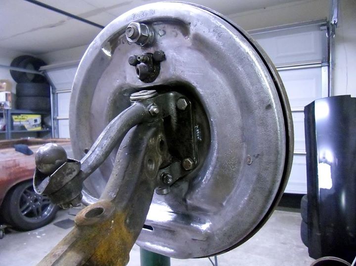

    Looking at this pic, with the early spindles and later kingpins, it doesnt look like there is any type of bearing? Is that how its going to be? How well does it work without one if thats how it is?

    The early spindles had cup-top king pins. The bearing went under the kingpin top above the axle.
    The early Ford spindle to axle rule...always use the kingpins that match the spindle as all axle ends are the same. The gets all necessary hardware like bearings in their proper place.

    I know that, thats why I used the terms "early spindles" and "later kingpins". I was asking what hes going to do. Change to different kingpins? Thin roller bearing?
