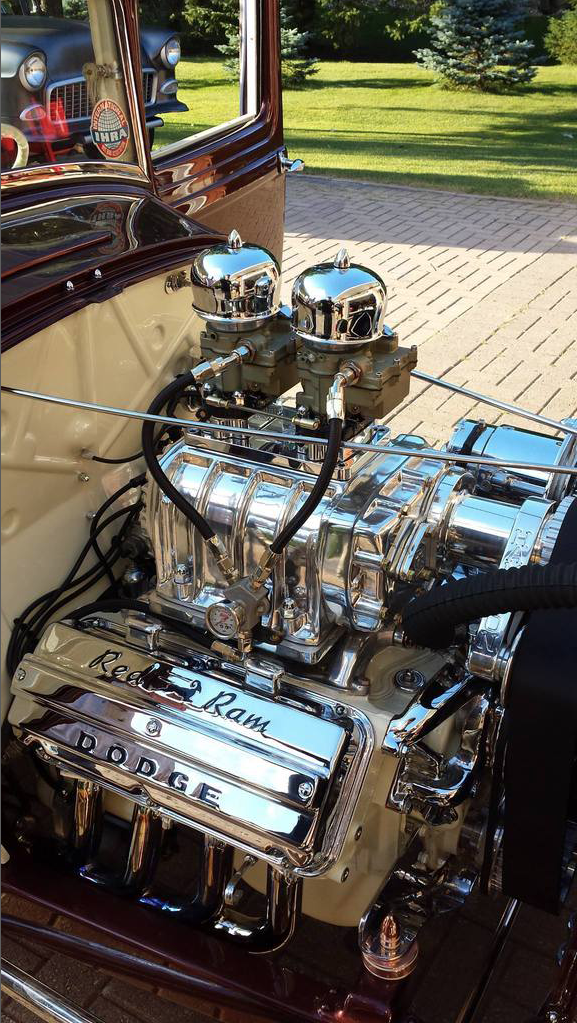

    Yea… them baby RR's….****.no parts anywhere… real weezers…. Screen Shot 2016-02-17 at 4.58.46 PM.png
    Baron, whtbaron, 270dodge and 6 others like this.
