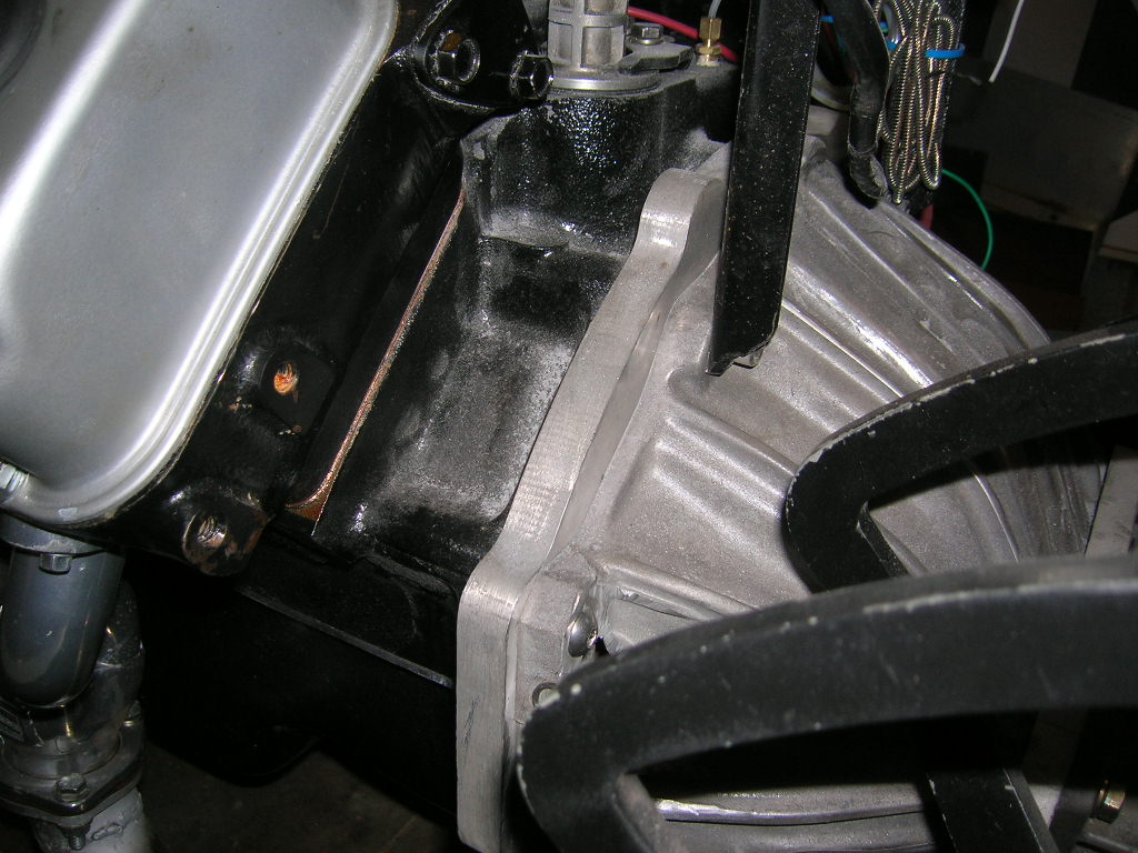

    I used an adapter and flywheel purchased from Hemi Hot Heads. Used a standard Chev aluminum
    bellhousing
    Hotrodmyk and loudbang like this.

    I believe Hot Heads adapters are actually made by Wilkap.

    How good are you at fabricating or machining? I made my own adapters. Used a new steel 426 Hemi 8 bolt flywheel, counter bore the back of flywheel 1/4". Then you don't need the flange adapter. Dis***emble a new gear drive stater and use the nose with gear to fit adapter plate.

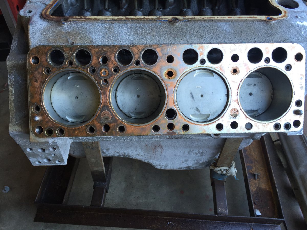

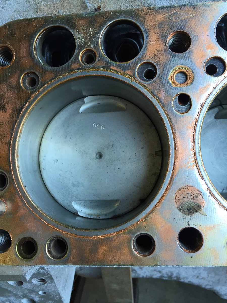

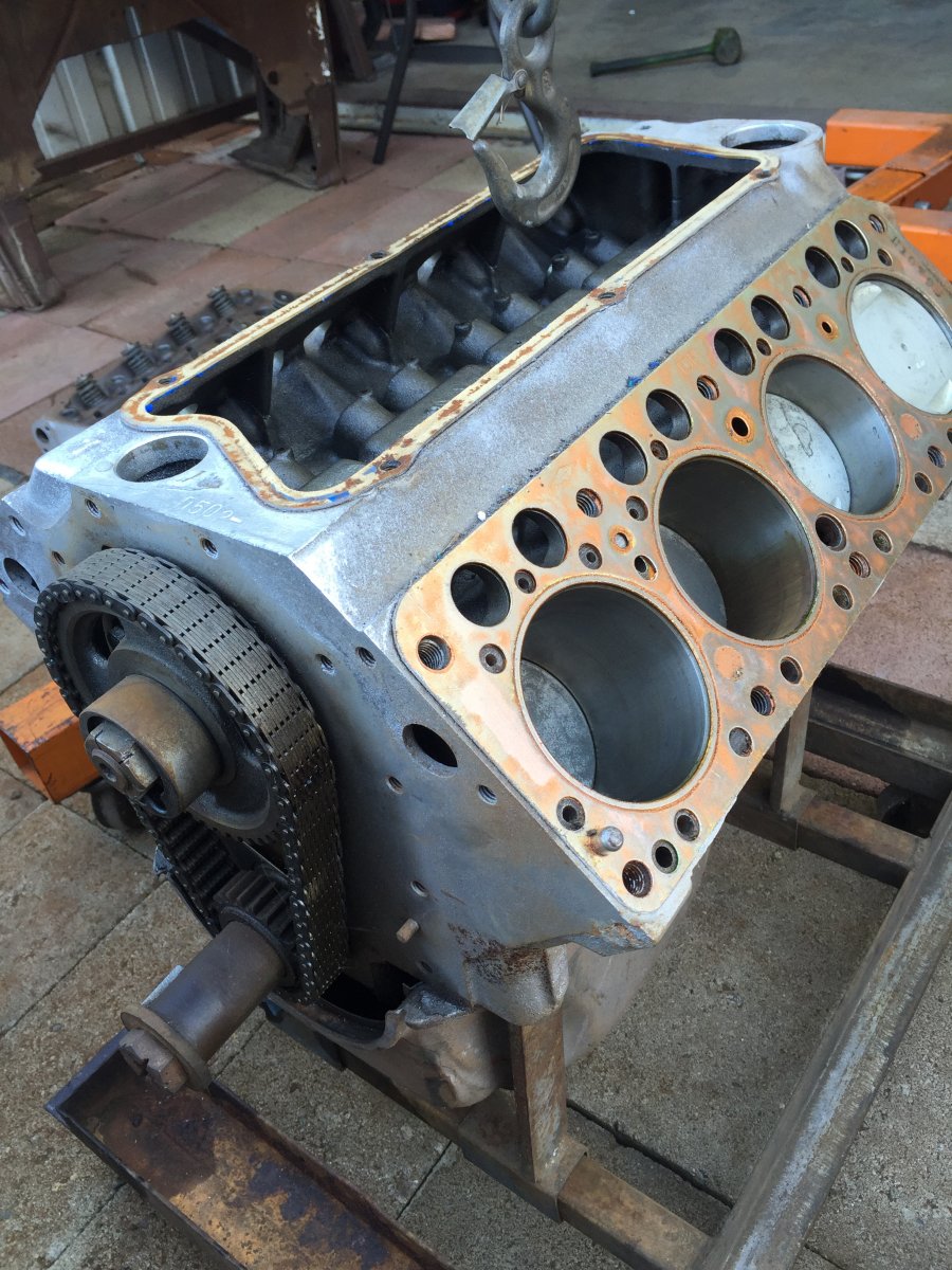

    Well, since I had purchased the 241 hemi(a year ago) I didn't really get a chance to really inspect it, other than a quick visual at the rocker ***embly and inside the valley pan. Well here she is...I thought it was rebuilt but then ran... I don't think so..
    loudbang and AndersF like this.
  11. 73RR
    Joined: Jan 29, 2007
    Posts: 7,342
    73RR
    ...just to give a little friendly insight at this point.......the pistons shown in the block are for the POLY head and valve arrangement, NOT the Hemi. Notice that they are not aligned vertically.
    Will this be a issue if you choose to use the engine as-is? If you keep a stock profile cam then probably not.
    The question is whether or not 140hp is adequate for your needs.

    I thought the Chrysler hemi was the only one to have the "Windsor" poly head? I've never heard nor seen of a Dodge non hemi motor...it'll be news to me if Dodge made hemis and poly versions at the same time.
  14. Black Panther
    Joined: Jan 6, 2010
    Posts: 2,374
    Black Panther
    from SoCal
    So....was intrigued....and looked into it. I guess Plymouth used a variation of the 241 with a poly head. Must have been only a couple years....but Dodge itself to the best of my knowledge offered a 241 hemi and a poly head motor at the same time. Not an expert but maybe those pistons are for the Plymouth motor?

    Personally, I would want (a LOT) more than 7.5/1 anyway, but if you need to, could you safely cut new notches in the cast poly pistons? They are probably pretty thick...
    And clean that overspray off the timing chain, that ****s gonna come off and end up in the oil pickup screen...
    jamesd1502 likes this.

    The pick up engine was a poly 241 and come in 54.
    The same engine was used on early plymouth 55 before it went to 260.
  17. Bader2
    Joined: May 19, 2014
    Posts: 1,143
    Bader2
    The hemi heads bolt right up to a poly block,pistons are different. 241/270 for sure.

    I have no experience with the 241, but I'm wondering out load here... since there's poly pistons in the block, is there a chance that this is a poly block with Hemi heads bolted on? If it is, does it really make a difference other than the pistons?
  21. Bader2
    Posts: 1,143
    Bader2
    It'll just be real low on compression.
