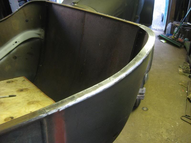

    Today I started on finishing the top of the back of the body where it didn't really exist. I cut the wood tac strip off and added 1 inch of flat with round stock capping off the end to match what Ford did with the door (s). I have the passenger side almost done and the rest just tacked in. This really strengthened the back of the body. I am still going to put some braces in the very back but it is really stiff already. After this I am going to focus on getting the turtle deck fitted.

    Today after work I got to work on the back and it is pretty much done, just some final finishing. I continued the moulding that connects the back and side panels over the top and I think it turned out nice. I need to to a little more to the body but overall I am happy with it. It is going to be a gow job afterall and they were not finished like show cars. I got some steel from work to start the turtle deck subrail and hopefully I will have something to show by the weekend.
