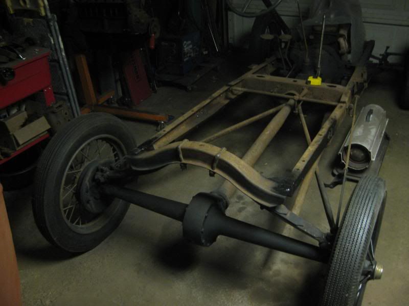

    Got the chassis in the garage tonight. First thing's first, get rid of the running board brackets. I am going to run rivets in all the holes where I removed a bracket. Not much of an update but hopefully soon the chassis will be ready for the body.

    Passenger side rail is done. I had to make the rails 32 inches at the rear. The turtle deck is 32 1/2 inches wide. I had a eucre game tonight so I had limited time. Came out nice so other side is a repeat (it was braced accordingly). Tomorrow I will do the other side and then do the rivets and hopefully by the weekend we will have a mounted body.

    Got the other rail pinched in after work so time to plop this body on and make some body mounts. Hopefully I can get a buddy to stop by to help. I could use my rafters in the garage and hoist it up but I just don't trust them enough.

    Today was a huge day for me, my brother stopped by to help put the body on. It fit almost better than I thought it would. I got in it and the steering and pedals are all in comfortable spots. Body mounts are going to be pretty simple but I won't get to them until tomorrow. I might put a T spring in the back or atleast loose half the Leaves in the A spring because this body doesn't way much and the rear is super stiff. What do you guys think?

    Looks damn good, that's for sure.
    It may need to drop an inch or so in the back.

    I would put in a T spring. I think it would get a little bouncy if you took to many springs out

    I am going tomorrow to the same guys house that had the windshield parts to get a T rear spring. He told me 50 bucks so why not try it and see what it does. I like the front though. Will a T spring drop it too much?

    I think the body needs to be lower at the back. Look at a line from the front of the body to the turtle deck. I looks like it's humped up where they join together.

    I actually prefer the rake. Put the T spring in the rear, flatten out the front crossmember, and it's perfect, IMHO!

    I can't flatten the front crossmember becuase the lower radiator hole takes up all that space. I could reverse the main leaf though?

    Looks killer I like the rake. I think I'd reverse both main leaves, play with removing a few and call it a day.

    T front spring won't drop it any. Reverse the eyes will get you 1 1/2". You can also remove a couple of leaves. Make sure the shackles are at 45 degrees or more. You need that for a good ride.

    Thanks for the compliments guys! Got the front and back mounts done. Still going to put one in the middle but I need to figure out the best spot for it first. Shimmed up the body and it fits well. I also got a set of 28 fluted lens headlights, some houdaille shocks for the front and my column drop I needed. Still looking for a T gas tank. Got the rear T spring too but I am going to finish up the body first. Still need to finish the firewall around the steering column and get a floor in it.
