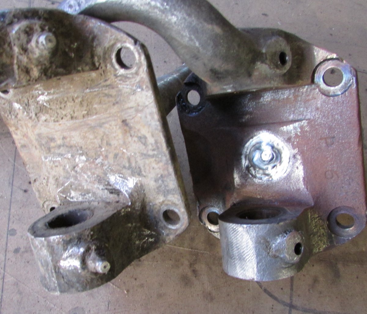

    With the axle positions mocked up and decided, it was time to get going on the suspension.
    I am using a '35 axle and spindles. I knew something would need modifying as I needed a 4" on 4 1/2" bolt pattern to suit the MGA wheels. A bit of digging on the old interweb told me that Toyota also used the same bolt pattern. More digging told me that the "Legends" race cars use Toyota hubs, rotors, and calipers. They also make and sell stub axles to take these. A quick visit to the Racing Junk website netted some new stubs and rotors and a pair of used hubs. I took the Ford spindles into college where they were machined to accept the Legend stubs. The welding dept then welded the stubs into the spindles. Its great to trade work with other faculty who need work doing on their cars :).
    With the spindles modified, I mounted them to the axle, then put the assembled axle into my fixture and mounted to the table. I have set the frame at ride height, and the spindles at tyre diameter, minus a little squish. I am waiting on some 4-bar batwings before I can establish frame mounts for those, so I made a start on the quarter elliptic mounts. These brackets were actually prototypes for the mounts when I designed the frame for the modifieds we built and sold at Real Hot Rods. They have been in my "bracket" pile ever since. Would seem a shame not to use them ;). I used a leaf spring I had to start with, but it will get cut in half to make the 1/4 elliptics.
    That's all for today, will finalise the position of the brackets and tack weld them to the frame next.

    I like your Toyota stub axle conversion; was never aware that anything like that was available, but it sure solved a lot of problems for you!
  12. Limey Kid
    Joined: Mar 5, 2006
    Posts: 1,024
    Limey Kid
    The Toyota inner bearing has a larger I.D. than an Early Ford one, so the original stub axle would have needed to be welded on, or a sleeve fitted. The Toyota outer bearing has a smaller I.D. Than the Early Ford. The distance between the bearings is also different. The Legend stub axle was a lot cheaper than welding and turning the originals would have been.
