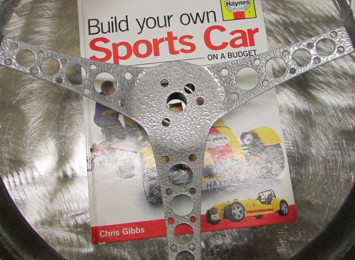

    image.jpeg image.jpeg image.jpeg image.jpeg image.jpeg image.jpeg Wasn't up to much this weekend, so just a bit of pottering about on a little project.
    I love those old photographs of the early drag coupes with lightening holes drilled everywhere. If you were to search for pictures of similar era sports cars they have holes drilled in all of the parts too. So with this build I have gone for holes in a big way.
    I had determined I needed a steering wheel no bigger than 15" diameter, so I don't drag my left hand on the body, and with a 3" dish. My first thought was a nice wood rimmed job, until I saw the prices, and that changed my mind :(. So what would a sports car/hot Rodder have done back then. Modified what he had on hand, that's what.
    With that in mind I noticed the old Superior wheel I have had hanging on the wall for 20 years or so. It came with some basket case I bought back when. I have put quick release steering wheels on most of the cars I have built, and have always used this wheel when I needed to move those cars around. The chrome was peeling, it had some rust, and the foam grip had some battle scars. It was perfect! I found some self- adhesive binding tape on eBay, so I will wrap it with that. I cut the foam off the spokes and then sanded off the rust and chrome. Then I did what those drag and sports car guys did back then, drilled more holes!!!
    It was free, as I already had it. It looks the part for the car. I love that it has been on a lot of cars I have built. I rattle canned some Hammerite on it. I will leave it to harden for a few days before I wrap it.

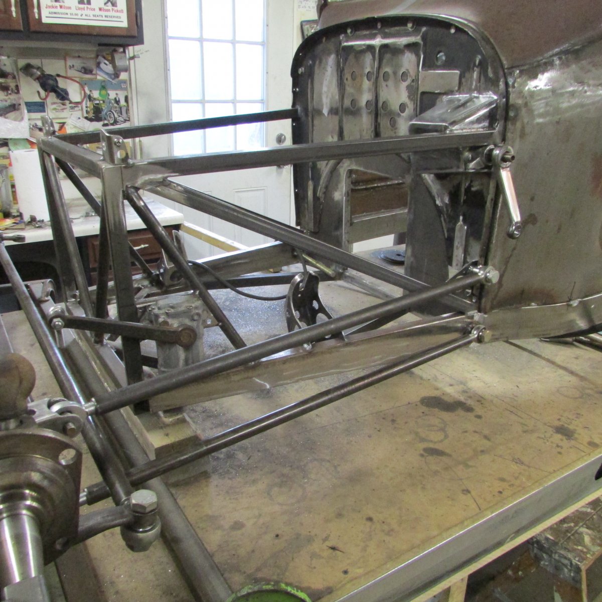

    Started on the 1/4 elliptics. I found a T-Bucket spring in my stash of parts. It was a standard eye, and I was going to need a reverse eye to get the spring pack lower. So using a press I went about re-arching the spring to effectively reverse the eyes. IMG_1751.JPG
    I then cut the main leaf in half to create the 1/4 elliptics main leaves. Using my stash of various 1 3/4" leaves, I cut down what I needed to form the spring packs. Took some time to sand the edges to smooth out the ride. Modified some shackles to take a through bolt for the shock link. Mocked it up on the bench using a Ford TT spring perch and an old MG lever arm shock. The shock link will be 5/8" round stock drilled and tapped to take the 3/8' Heims.

    Started to install the bushings in the frame rails for the rear mounts of the 4-links. The bushings are the same DOM tube I use for the tie rod and 4-links, just drilled out to take a 5/8" bolt. I drilled the holes in the outside wall of the rail no problem, but to get to the inside wall, I would need an angle drive drill. No problem, I have one. Problem is, my compressor took a dive and is in for repair, so no air! Anyway a couple of pictures to show where they will go. They won't stick out that far when finished, as they will protrude out of the inside wall as well. This allows for a nice weld bead all around the end of the bushing.
    So, I moved onto the shock mounts. Was going to make them out of 2" wide 3/16" plate, but didn't have enough. Decided to use 1/8" plate, and bend a couple of flanges to give it more strength. Then came up with the idea to use some 1/8" wall 2 1/2" square tube. So I hade these cut out and ready. Thought they looked a bit boring, so added some lightness. Much better! Tacked them in place, and mocked up the spring. Not sure that there will be enough clearance between the spring and the bottom of the shock body. I can't move the shock up without the mounting bolts interfering with the frame tubes, can't lower the spring as it will lift the car. I am going to wait until the car is fully loaded and sitting on the springs to make a decision. The air compressor will be in the shop for a couple of weeks, so all work will have to work around that. I will probably start on the back axle and suspension next.

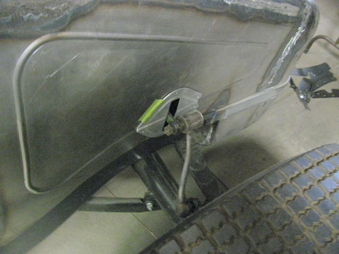

    So today I got the Drag Link made and installed.
    I'm using '35 spindles, so the Speedway steering arm isn't a straight fit. The holes on the spindle needed to be drilled out to 3/8", and the arms of the Steering Arm bent to fit the different bolt pattern of the earlier spindles. With that done, I could measure for the length of the Drag Link. So a length of DOM was cut, the ends drilled, and then RH and LH threads tapped.
    Not a lot of work, but progress all the same.

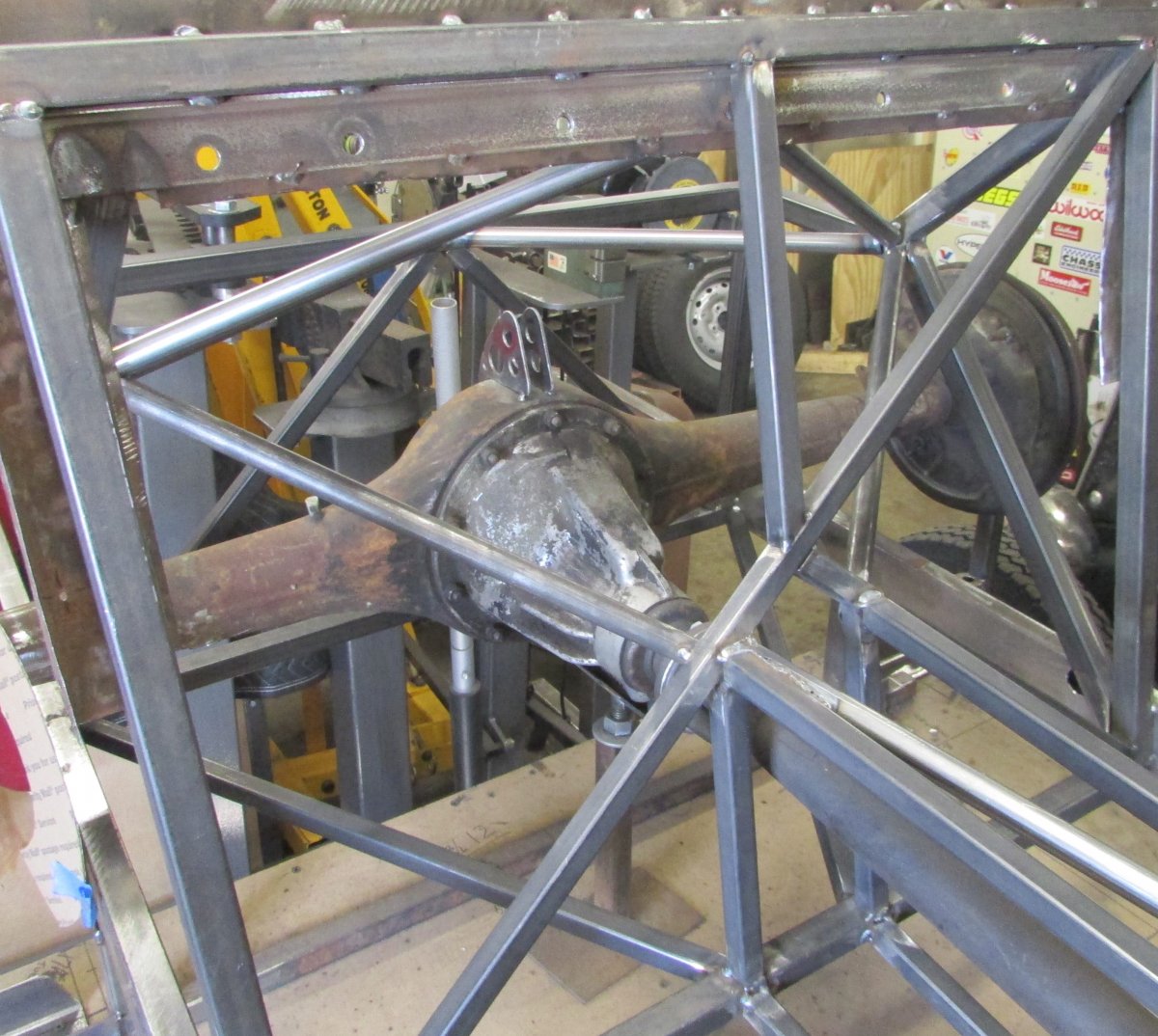

    image.jpeg Been out of town/state recently, so not much progress. I made some supports to hold the rear axle in the correct position on the table, and then made the axle bracket for the top link.
    Cheers,
    Stewart.

    I've got the rear of the frame finished, tube wise, just need to finish the mounts for the rear suspension. In the end I went with coil-overs. I was trying to use 1/4 elliptics and MG lever arm shocks, but the packaging of them was fighting me all the way. The coil-overs will be inboard of the frame within the turtle deck, and with the full length belly pan will not be seen unless the trunk lid is open. I then put in the transmission tunnel which joins the engine bay to the rear frame, strength wise.This frame ended up very well triangulated. It will be light, yet very rigid. Its all 16ga tubes in 1" square and round, and 3/4" square and round. The lower "frame rails" are in 3'x1" 16ga.

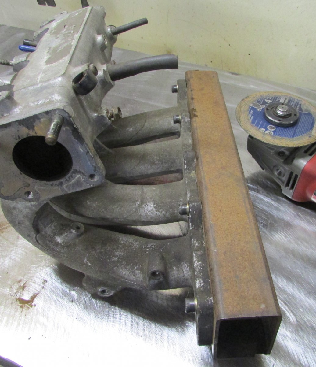

    I also made a start on converting the engine from EFI to Carb. The intake manifold is being totally remade. Just need to make and weld the plenum on the log.
    I am looking to have it on its wheels within the month, all being well.

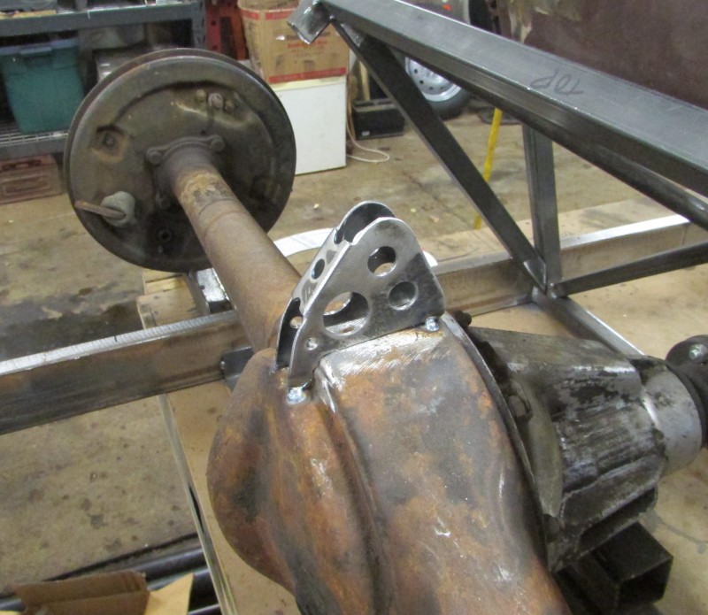

    Just a quick bit of work today. The rear Top Link and the brackets on the frame.
