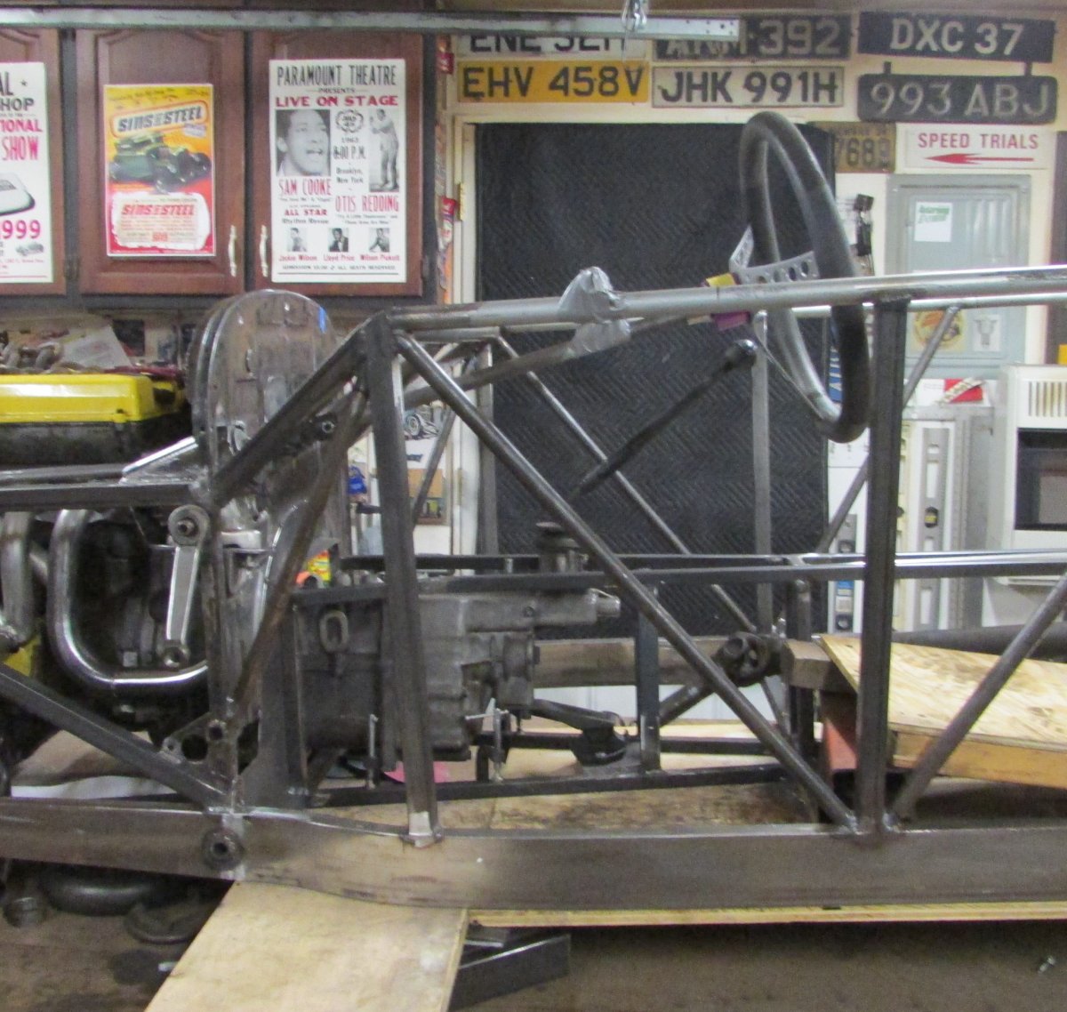

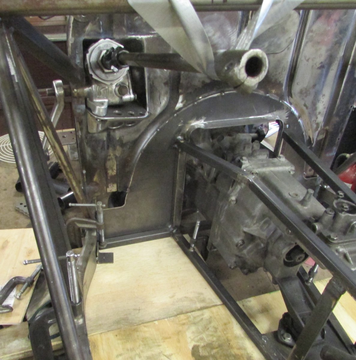

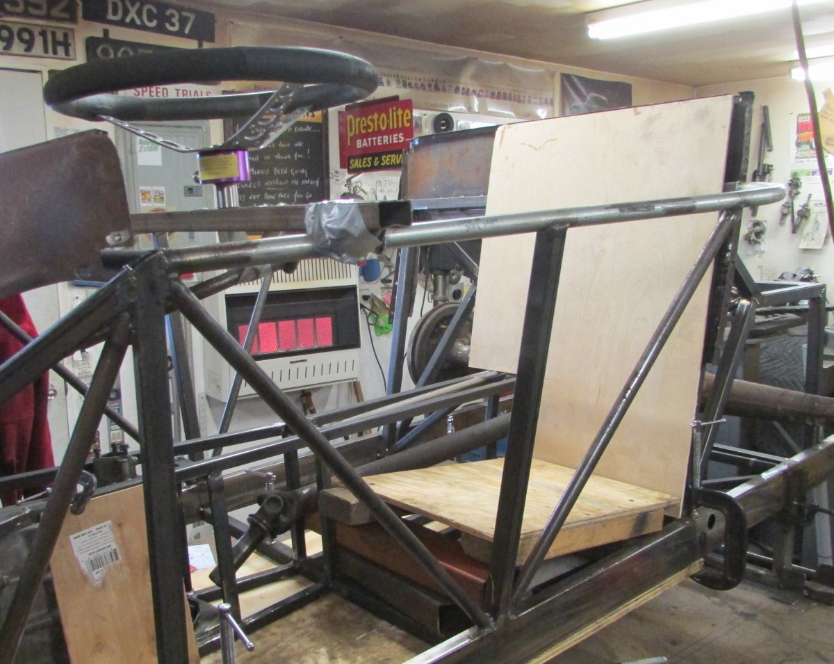

    So today was a "2 steps back, 1 step forward" kinda day.
    Having finished the transmission tunnel framework, I mocked up the rear bulkhead and seat. I'm 160lbs, and 5' 9", not exactly a big guy, but it was too snug. So I cut out the offending tubes, and had a re-think.
    The rear portion of the tunnel gets wider towards the back. I decided to narrow the drivers side 3/4" at the floor and at the top of the tunnel. The front portion needed more room for my right leg and foot. I kept the floor tube, but made a dogleg in the upper tube. Of course that meant I had to cut and modify the driveshaft safety hoop as well!
    With all of that completed I again mocked up the bulkhead and seat. Much better! Next was mocking up the steering column. Using duct tape to suspend it, I arrived at the length needed. I cut an old Ford shaft to length, and ground the end to a "double D". I will need to turn up a collar on the lathe to accept a bearing, then I can weld the supporting tubes to the collar.

    Nice update. Don't forget to add the thickness of the insulation and carpeting while measuring up your feet / combat boots for the pedal location! Thanx, Gary

    It won't have any stinkin carpet or insulation! It adds weight! I'm all about adding lightness, as Mr Chapman said.

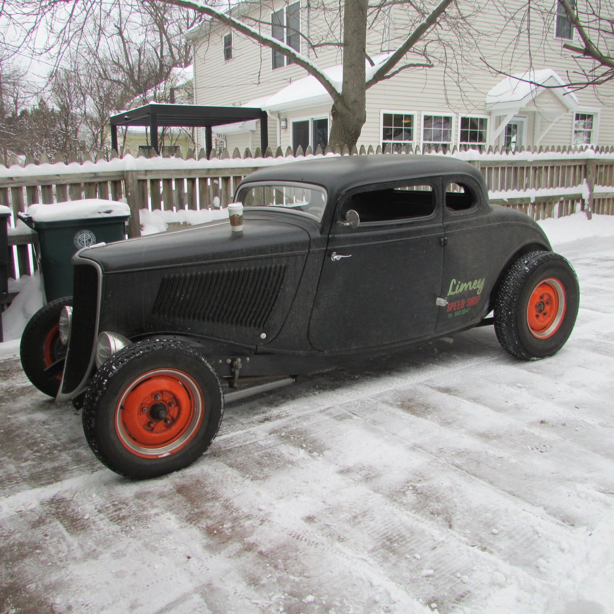

    We just got 6"-8" of white stuff out of the sky, and I am driving my coupe, and it still doesn't have any Windows or door seals yet.

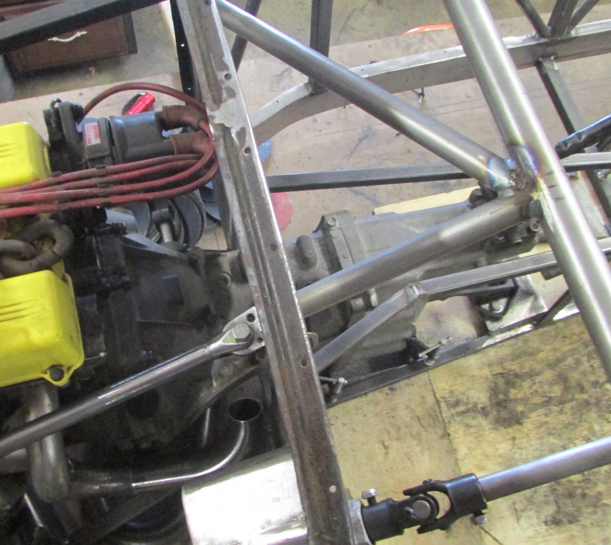

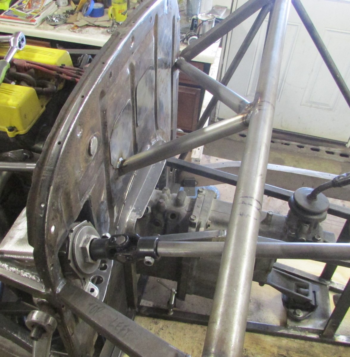

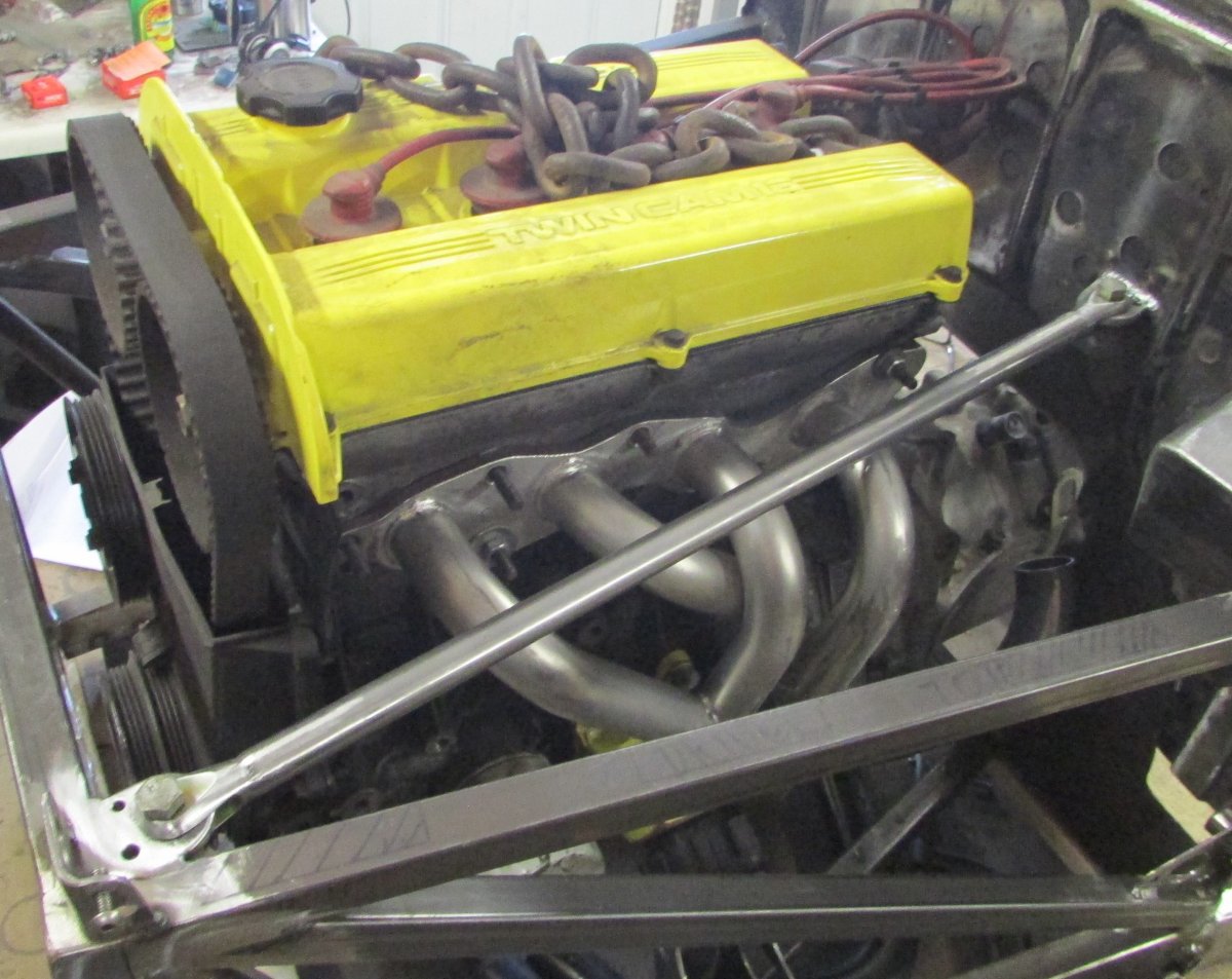

    Todays project was to make and install a removable diagonal tube in the engine bay. The rear mount for this on the firewall has to line up with one of the tubes coming from the dash bar. I used a pair of clevis, which I cut down and plug and seam welded to the ends of the tube. The brackets were some reject brackets I found in the bin which happened to be 3/8" thick, with a 7/16" hole, perfect. I just cut them to a shape that suited this use, drilled some lightening holes and shamfered the bottom edges to visually lighten them. They got welded to the firewall and front corner of the engine bay. Originally I was going to route the exhaust under the oil pan, but with a rethink, I decided to take it over the top of the bell housing. This means the manifold will be quite bulky, hence the need to make the diagonal removable. Theres also a shot of the steering shaft, steering wheel and shifter relationship.
    Some mandrel bends and a "Y" collector arrived this evening, so I guess the exhaust manifold is next.

    Nice Work. And thanks for the pic of the Coupe. I remember it from a while ago. Forgot how cool it was though.....

    You already have a strong space frame - why the diagonal? Looks stronger then hell now. Love the build. I have read "the book" on Lowcost Lotus 7 & some have lighter frame with lots HP. Some run V8 or turbo 4.

    With the ****pit area of the T being larger than a Lotus, that leaves a much larger "open" top with no triangulation. The driver and p***enger need to get in and out! Also my transmission tunnel is not linked up to the dash as on a Lotus. With both these things in mind, I decided to try to get some triangulation in the the "open top of the engine bay. From the rear bulkhead back, I have a lot of triangulation, so that area is fine.
    I have had both "books" for years, with all sorts of notes scribbled in the margins! I also have a full set of prints for a Series 1 Lotus 7.

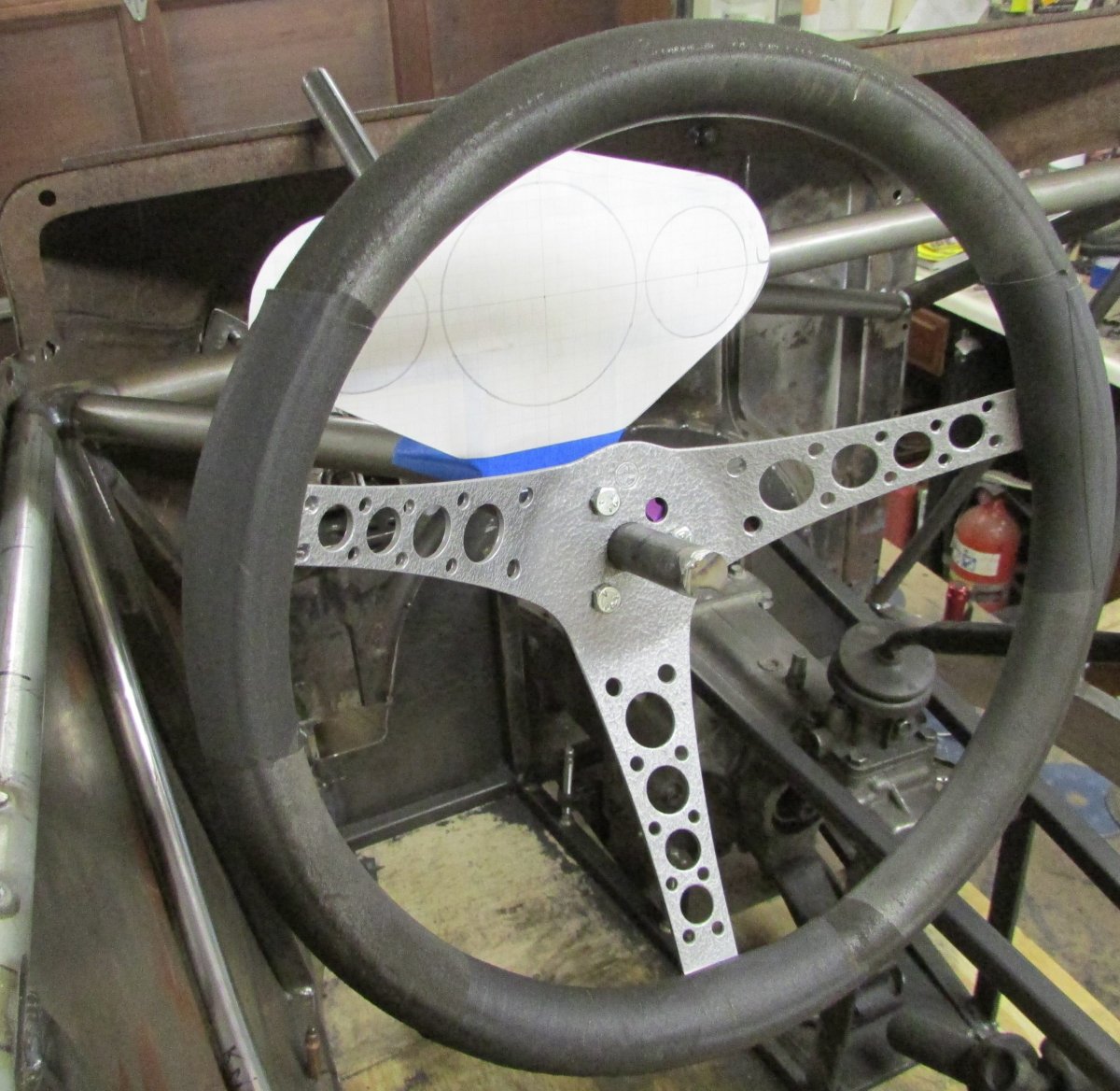

    Got the support tubes for the steering shaft done this week. This was held up by my indecision on what to do about the dash. With my driving position being so low and as far back as I could get, the normal dashboard seemed a long way away. In the end I decided to build a "pod" to hold the gauges, and weld it to the bottom 2 support tubes. I need to make the pod, and weld in the 3rd support tube. I rested a random length of tube to get an idea where the 3rd tube will bolt to the flange at the top of the cowl. I then sat in the car, held the steering wheel, and made sure I could see the gauges. All I works OK.. I have struggled with this all week, but I know what it will now look like, and how I will fabricate it. The 3rd support tube is the last tube in the frame.....I think, so there is light at the end of the tunnel.

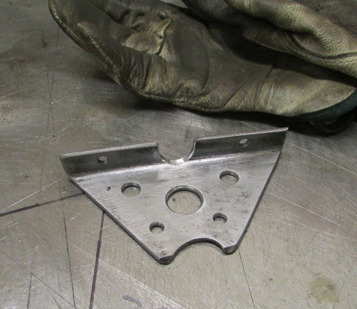

    So, on to making the top support tube. A made a gusset for the 2 lower tubes, drilled and tapped a couple of holes to mount the gauge pod, added some lightness and tacked it in place. I want to bolt the upper support tube to the cowl. A mounting plate was made, and bolted to the cowl. A length of tube was then cut and fitted. I need to fettle some of the sheetmetal to fit better. Once that is done, and the sheetmetal fitted, I can weld the tube to the gusset and the mounting plate.
    With that done it was onto the gauge pod. The front panel I made in 15ga. steel, marked out, and drilled pilot holes for the hole saws I will use for the gauge holes. I also drilled the pilot holes for the idiot lights. I made a spacer 3 3/8' thick to space the front and rear panels. The rear panel got made in aluminium. I bolted the front panel to the spacer through the pilot holes, and clamped the rear panel, making sure everything was in line. The top panel is in aluminium also. I bent a 3/4" flange, much wider than I need, but fits in the shrinker better. With the shape close, I trimmed some of the flange off to get the ends shrunk as the radius got tighter. Once it was the desired shape, I clamped it to the front panel, drilled though both for the mounting bolts. I drilled and tapped the front plate and filed the flange on the top panel to shape. With it all bolted and clamped together, I can now take it into school, and get one of the friendly welders to weld up the top and rear panels , as I don't have the skill nor equipment to weld aluminium. Once that's done, I can weld the front panel to the lower support tubes and make and weld the bottom panels in place.

    I like the pod. It looks cool, serves its purpose well, and with that removable top, it will be convenient for wiring. Well done.

    The idea is that the wiring will run up the top support tube then under the cowl top.
    Hope it looks better with the gauges in. Now it's done all I can see is E.T. and I mean as in "call home" as opposed to elapsed time. :).
