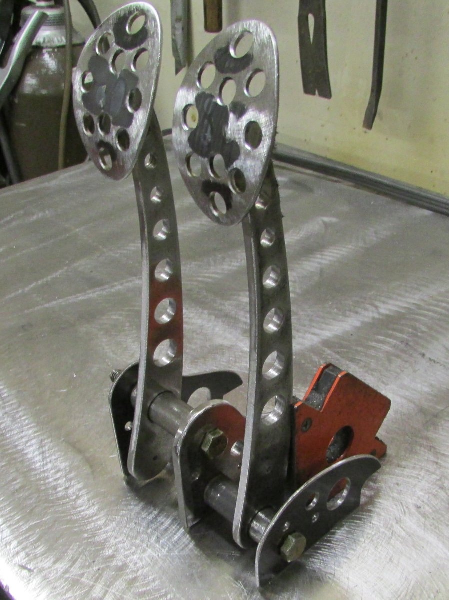

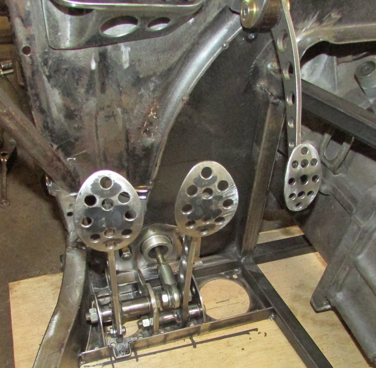

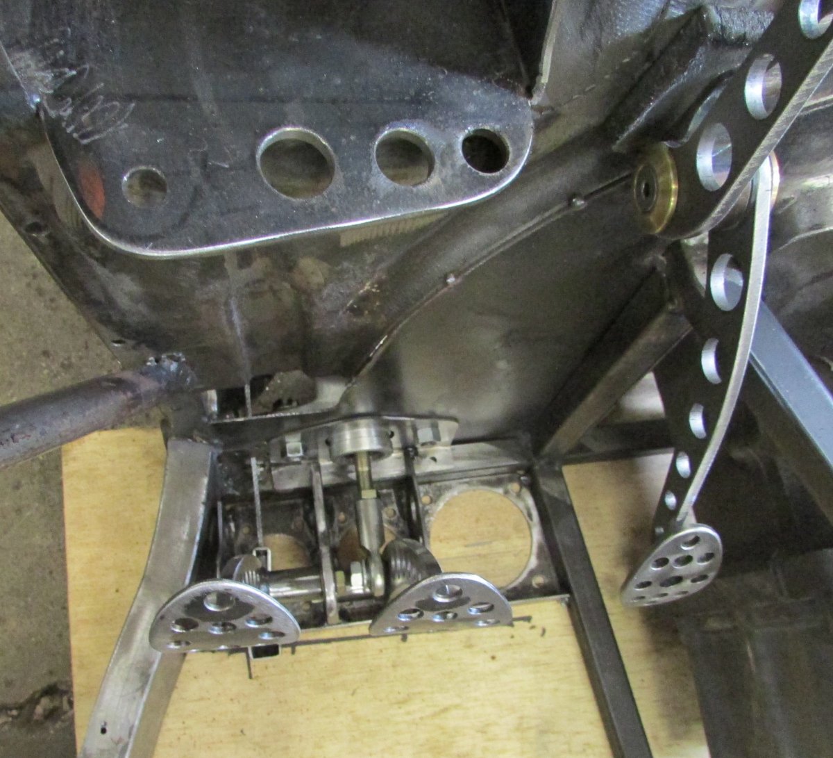

    Mocked up all 3 pedals in the car. Started on the centre support.

    Stewart, these look similar to my TR3. My experience was the distance between the clutch and brake was not critical. The closeness of the clutch to the cowl wasn't critical. The distance between the brake and the accelerator is very critical. The reason being is that when you depress the accelerator your shoe tends to get wedged between the brake and accelerator. This can be very exciting, sort of like a stuck throttle and not being able to step on the brake because you can't get your foot free from the accelerator pedal. Just an experience of mine that probably only happens with TR3s. Keep up the good work.
    Greg
  4. Limey Kid
    Joined: Mar 5, 2006
    Posts: 1,024
    Limey Kid
    Greg what isn't apparent from the shot above, is the dogleg in the side of the transmission tunnel. This means that it's mainly the left side of the sole of my right foot when it's on the gas, and leaves enough room not to hit both pedals at the same time.
    This had all been carefully worked out and made, then realized it wouldn't work, so carefully worked out again and moved! 3rd time was the charm.. Of course I won't admit to that in public. ;)
    Cheers,
    Stewart.

    The pedals, m/c, and clutch cable are officially in!!
    Finishing off the exhaust header and intake manifold are next.

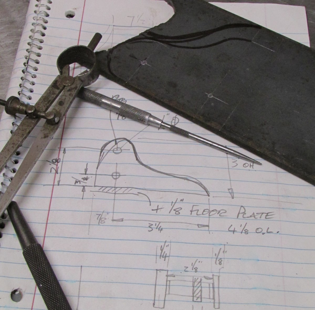

    Limey Kid

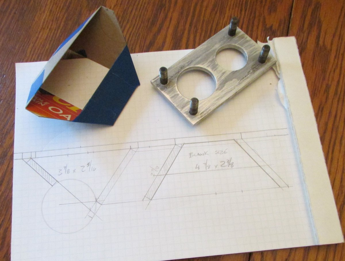

    Cheerios Aided Design at its best. I haven't taught old fashioned drafting (ya know, at a table with a pencil an a big sheet of paper) for 35 years! So using squared paper and a compass and rule, I designed and made the templates for the intake plenum. I had to retrieve Truncated Pyramids from the depths of the old grey matter. Also made the carb mounting plate. The card is the inside plane of the intake, which is why it looks too small. I will be making it out of 1/4' aluminum plate.

    I don't think they even teach that in high schools anymore... At least they don't here. I took all those classes I could get in school, probably because there weren't very many electives I was interested in. They permanently closed our metal shop class before my senior year, to make a bigger weight room for the damn football team .You should see the look on Nathan's face when I make him do trigonometry in the shop...priceless.

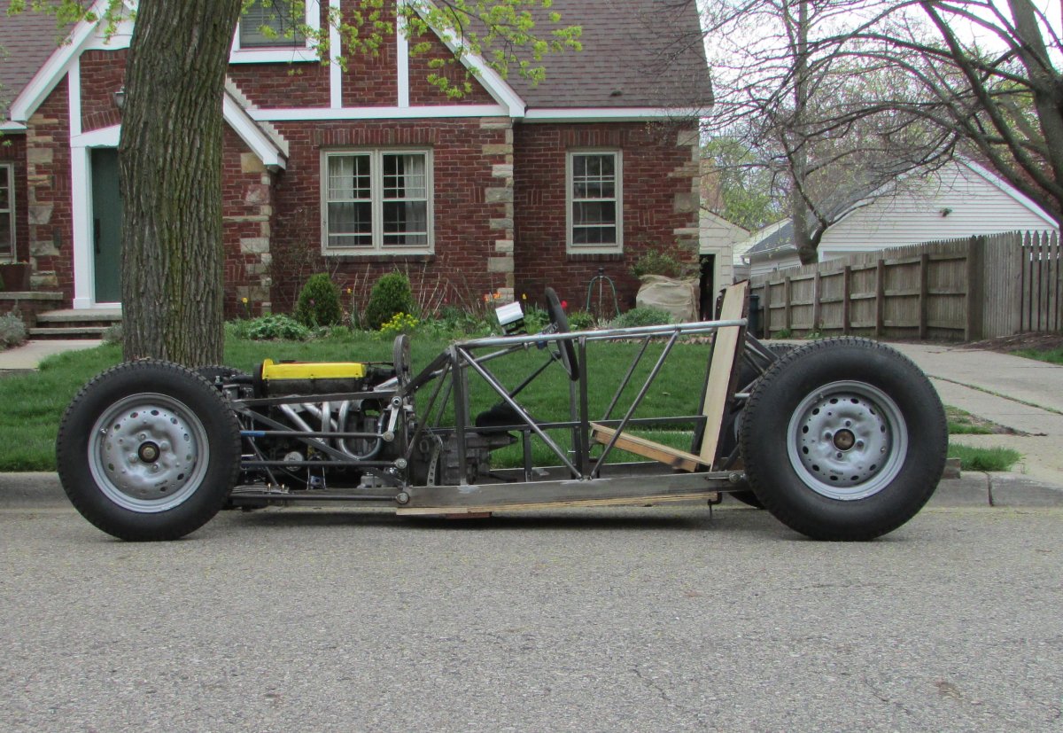

    So I put the front suspension on and pushed the car to the street for a better look. The front needs to come up 1", so I will move the spring mounts down 1" on the frame rail.

    If you are raising the front 1" for clearance, I would raise the rear 1" for looks. Love the rake it has now. Keep up the great work!

    The original plan was for 4 1/2" clearance at the front and 6" at the back. It wasn't enough rake for my tastes though. I decided on keeping the 4 1/2" at the front and raising the rear to 7". I guesstimated the position of the the front spring plates, but only 3 3/8" clearance, so I will just move the plates down 1". I don't want to lift the rear any more to help keep the air underneath causing the rear to lift, as the belly pan/floor gets mounted to the bottom of the rails from grille shell to rear valance.

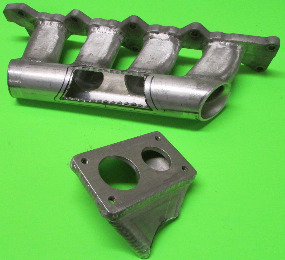

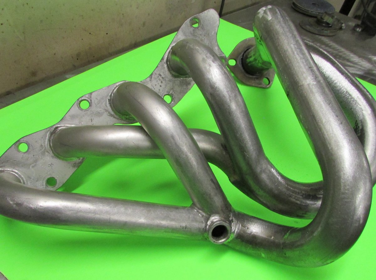

    Finally got the header finished.
    The welding dept at college finished the plenum, so I cut out the rough opening in the intake, but that's all I got done .
    Cheers,
    Stewart
