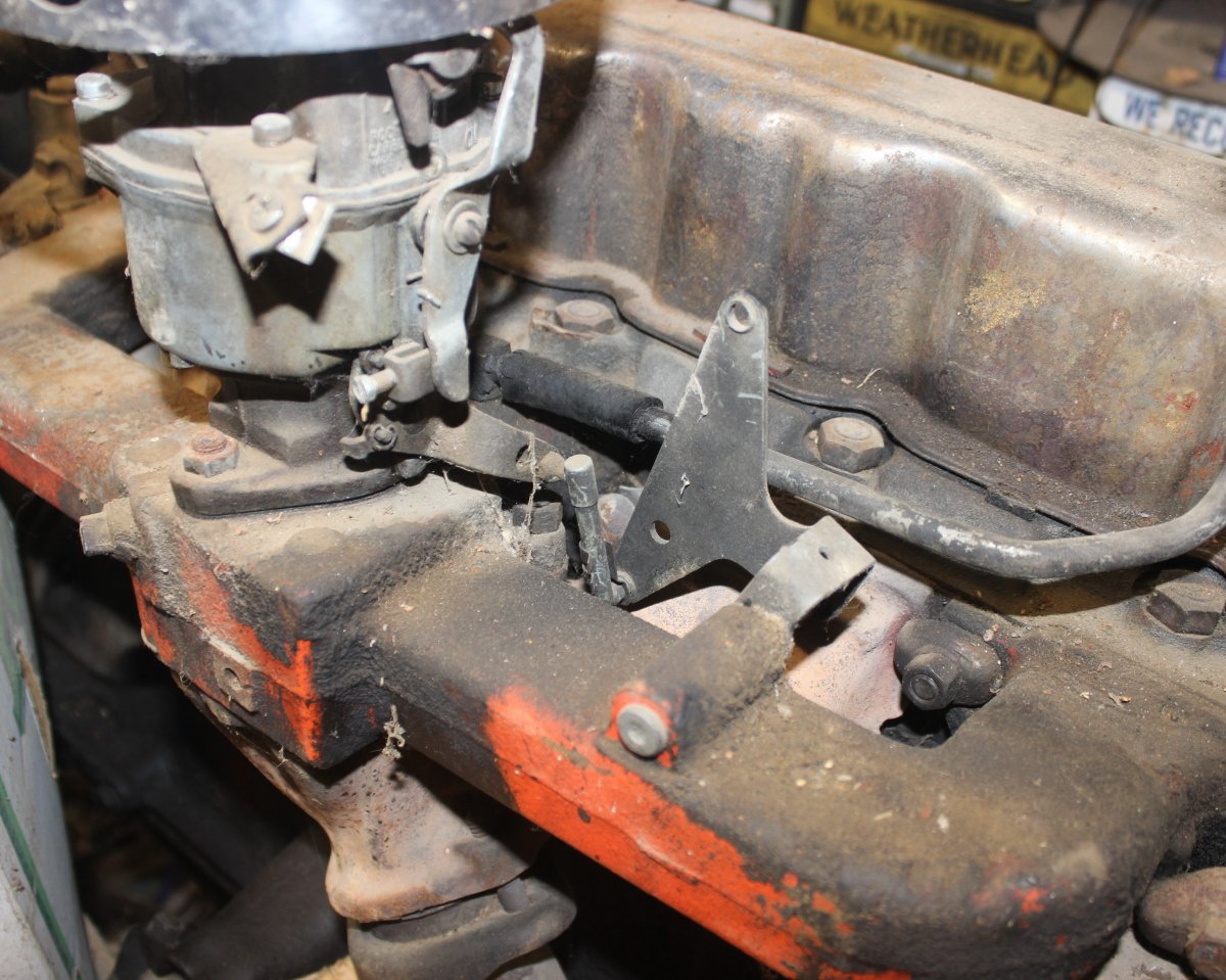

  20. Mr48chev
    Joined: Dec 28, 2007
    Posts: 36,505
    Mr48chev
    IMG_9512 (2).JPG I ran a 250 in my 48 truck for years.
    Length is the issue in swapping them into older Chevys either car or truck. you can shorten the shaft on the water pump and run a shorter pulley to get some clearance though. Fan to accessory clearance becomes an issue then though.
    The V8 style bellhousing that fits the 194,230,250 and 292 won't bolt directly to the stock 51 standard trans, if you are going open drive that isn't an issue.
    Throttle linkage may take some thinking to get around. I swapped pedals and used a cable on my 48 but a lot of guys want to keep the original pedal and linkage.
    Looking at a photo I took of the 68 292 that is going in my 48 they have a bellcrank on the intake to work mechanical linkage to the carb that would be an easy hookup.

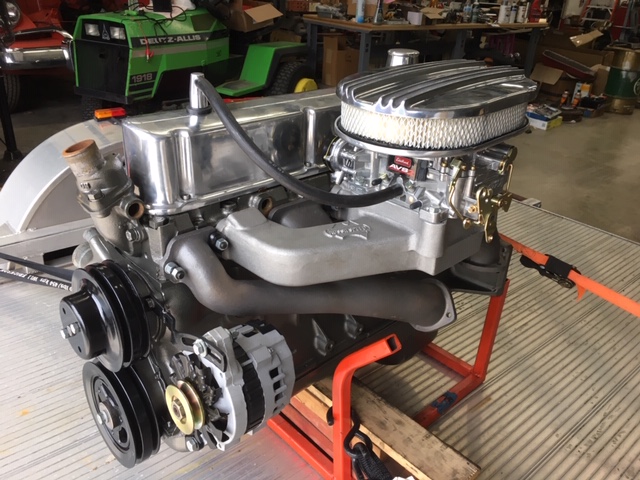

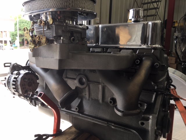

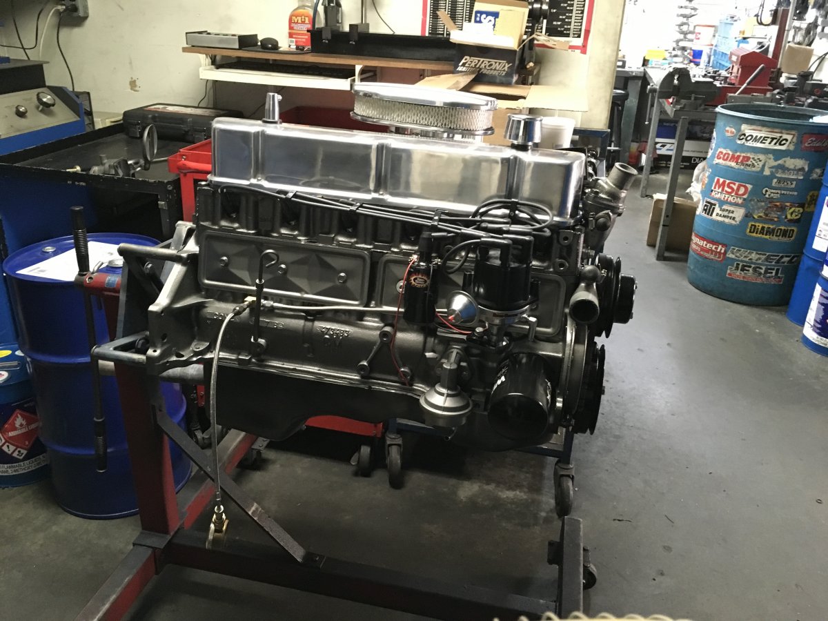

  30. Hnstray
    Joined: Aug 23, 2009
    Posts: 12,357
    Hnstray
    from Quincy, IL
    I haven chosen a warmed up 250 for my ‘37 Chevy coupe project. I wanted to be (sort of) traditional, keep with a warm six. Some years ago that would have meant a Jimmy 270. But, I want the lighter weight and seven main bearings, etc., of the later engine.
    02ACC489-BFDF-4625-8ACA-6F3D41A4FACD.jpeg D4507CB9-13CC-44C0-A0C8-114BC46CC06D.jpeg A61A8B7C-46C9-4777-94EF-DF6C59BA26BB.jpeg
    Ray
