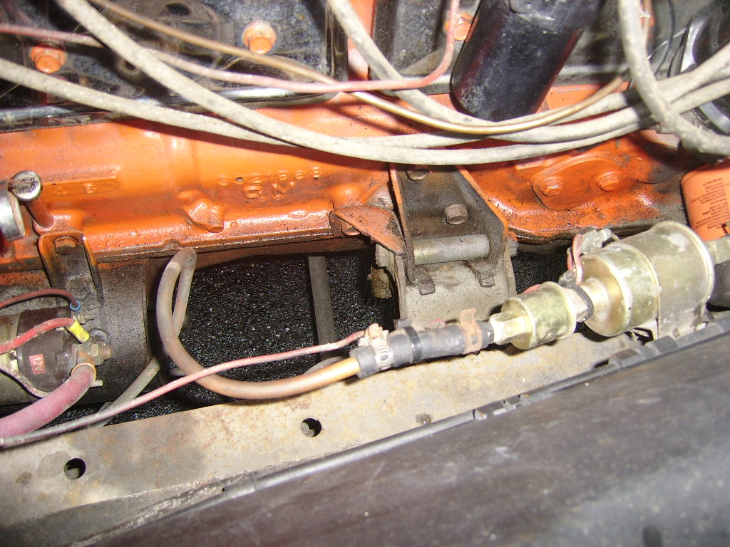

    Yep, I was gonna say that too. All 49-54 1/2 and 3/4T 3 speed cases will work for this. I think the truck case is just a tad shorter than the car, maybe 1/4" or so but not enough to matter. It has been done to put V8s in 49-54 vehicles too, but that is really overloading the early trans internals. If done that way, be sure to check the cluster gear bearings or bushings as well as all other parts for condition.
  3. Steady Freddy
    Joined: Dec 21, 2019
    Posts: 84
    Steady Freddy
    Have a 50 3100 with a 250 and 350 ******. did not build the engine and ****** was in when I bought it .. Has 250 with what we used to call a 3/4 cam , headers , holley 650 carb with vacuum secondarys . Engine is offset 2 inches to give header to steering box clearance, with no ill effects . Engine is rearward as far as possibly with fingers clearance at rear and that allows just enough clearance to rad. The engine/trany set up works great . This engine loves the RPM and really pulls strong.It has as near as I can figure , a 55-57 chevy differential and possibly 54 chevy front hubs and brakes. I also installed electric power steering ( saturn vue) that works great in all situations
