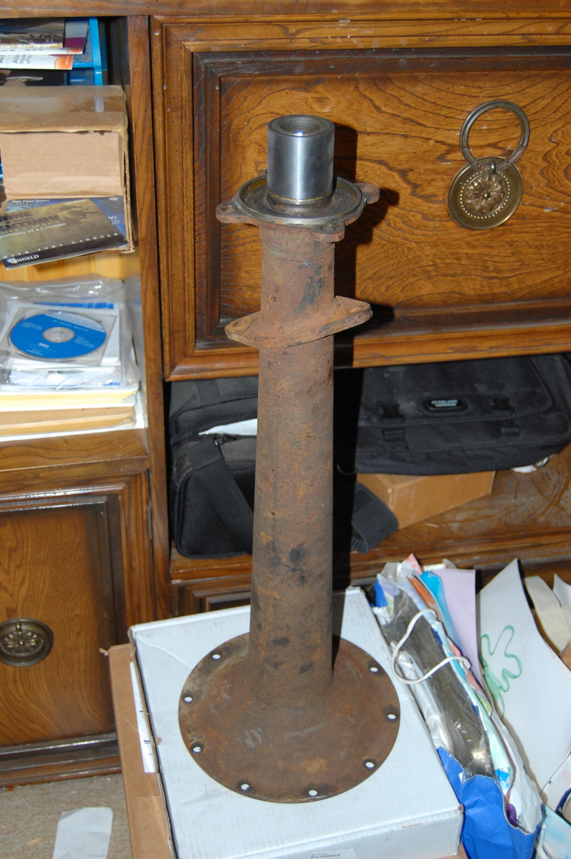

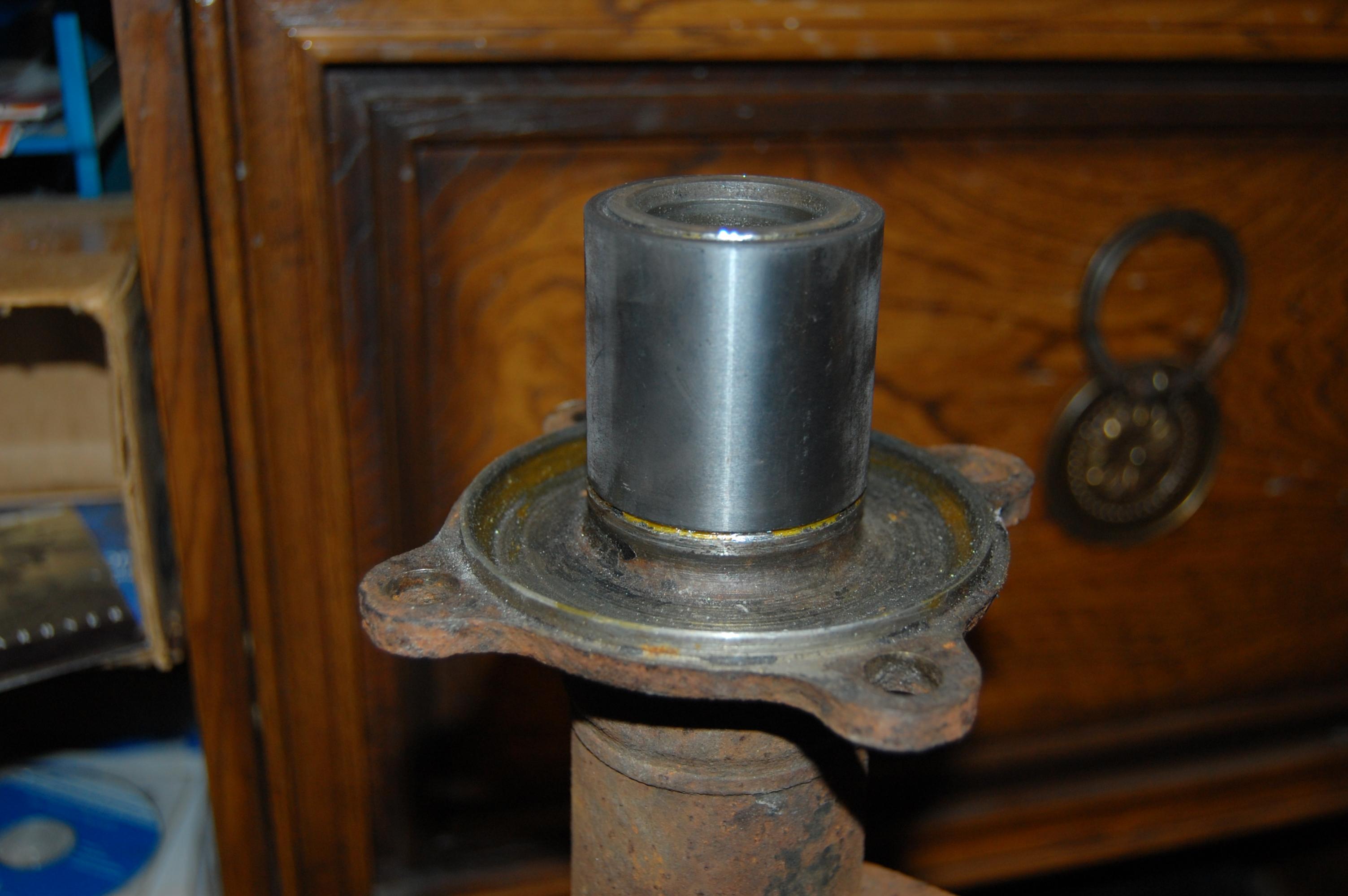

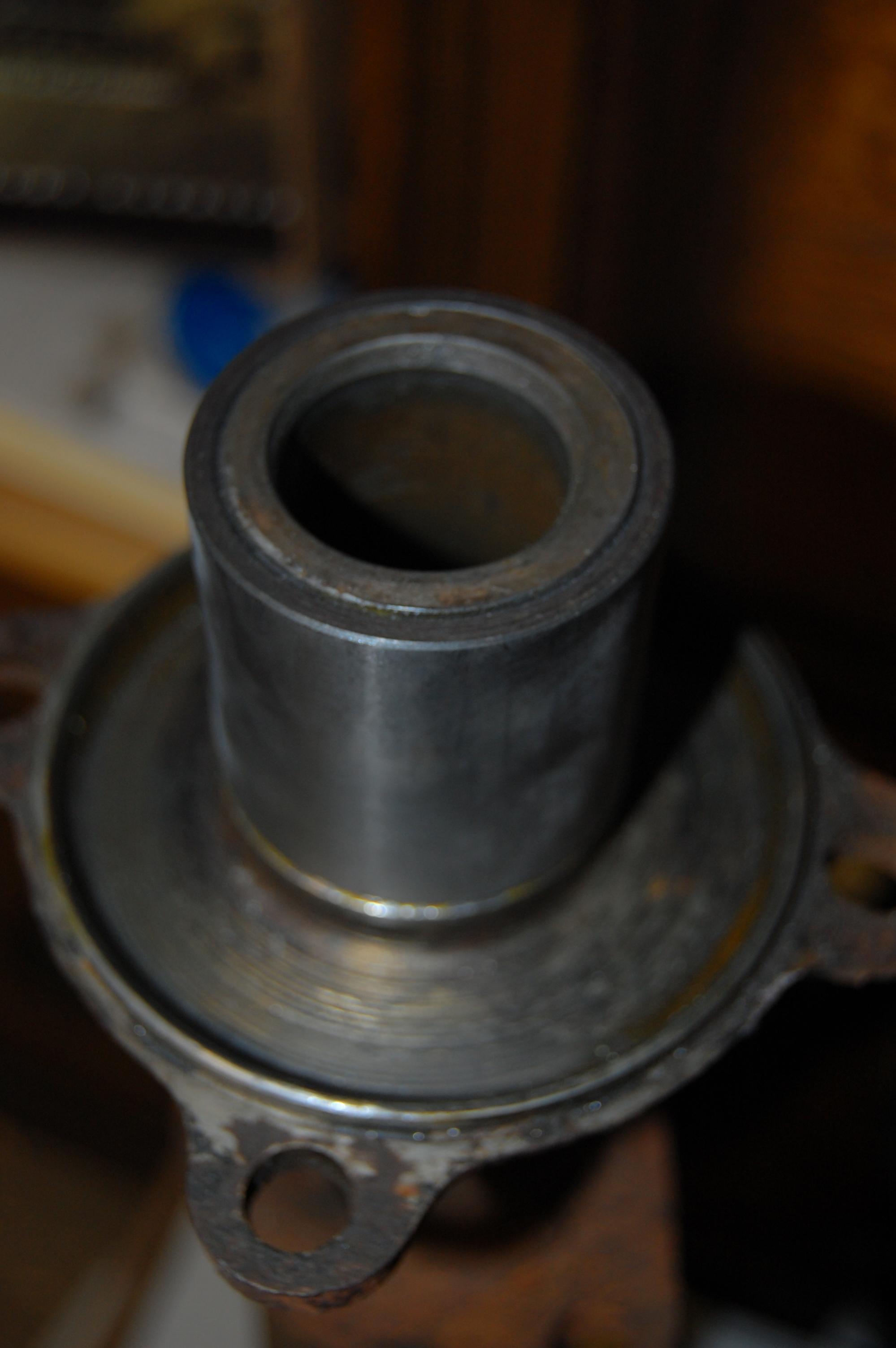

    Looks like my quick change should be here tomorrow. been playing with the new OT beach buggy and got a little behind. good thing jim keeps going like the energizer bunny. Nite before last he chucked up one of my 35 axle tubes and turned down the race on the end of the tube. it was pretty pitted so i got a new race from Early Ford down in San Dimas, Ca. Directions said turn it tight about a .001" tight, put the tube in the freezer to shrink it, and place the race in the oven to swell it up a bit. Add lock tight and press it on.
    The freezers full (Thank you Jesus) and we dont have a press. Got a 4lb sledge though. Jim left the tube in the cab of his truck over nite while it hit 28 degrees. The put it in the bed and headed 40 miles to work at 5am still pretty froze out, + windchill shrunk it right up. He put the race on the defroster and cranked on the heat. got to work. put on the lock tight. Grabbed the sledge and a piece of 1/2" plate end smacked it a couple times and it gently slid right in place. Looks good and should work just fine.

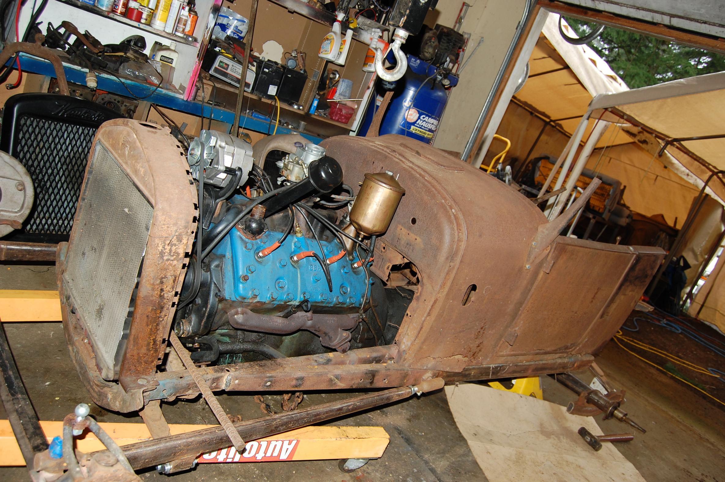

    Never could make peace with the 2.3 ranger motor. Yeah they wind up r economical etc but with the amount of work we pui in to use old original Ford parts it only made sence to use a flathead. Momma wouldn't cut loose with hers she thinks since she bought she should get it in her car (29 coupe). Finally found a nice runner over in Spokane and made the drive.
    I'm still tore up but got to get this on the road, been down to long. Grabbed a manpon and m gettin after it . I will try to post progress

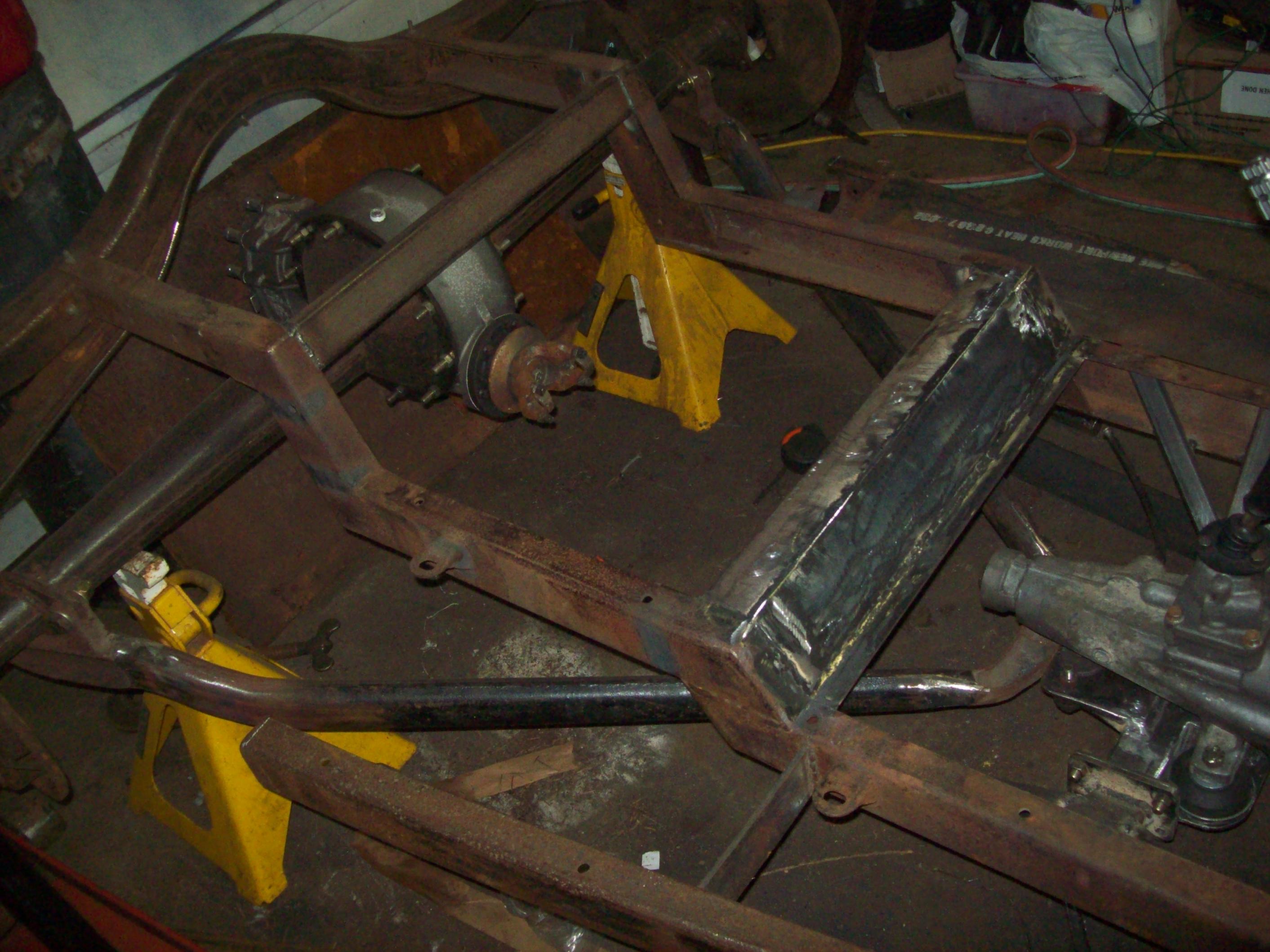

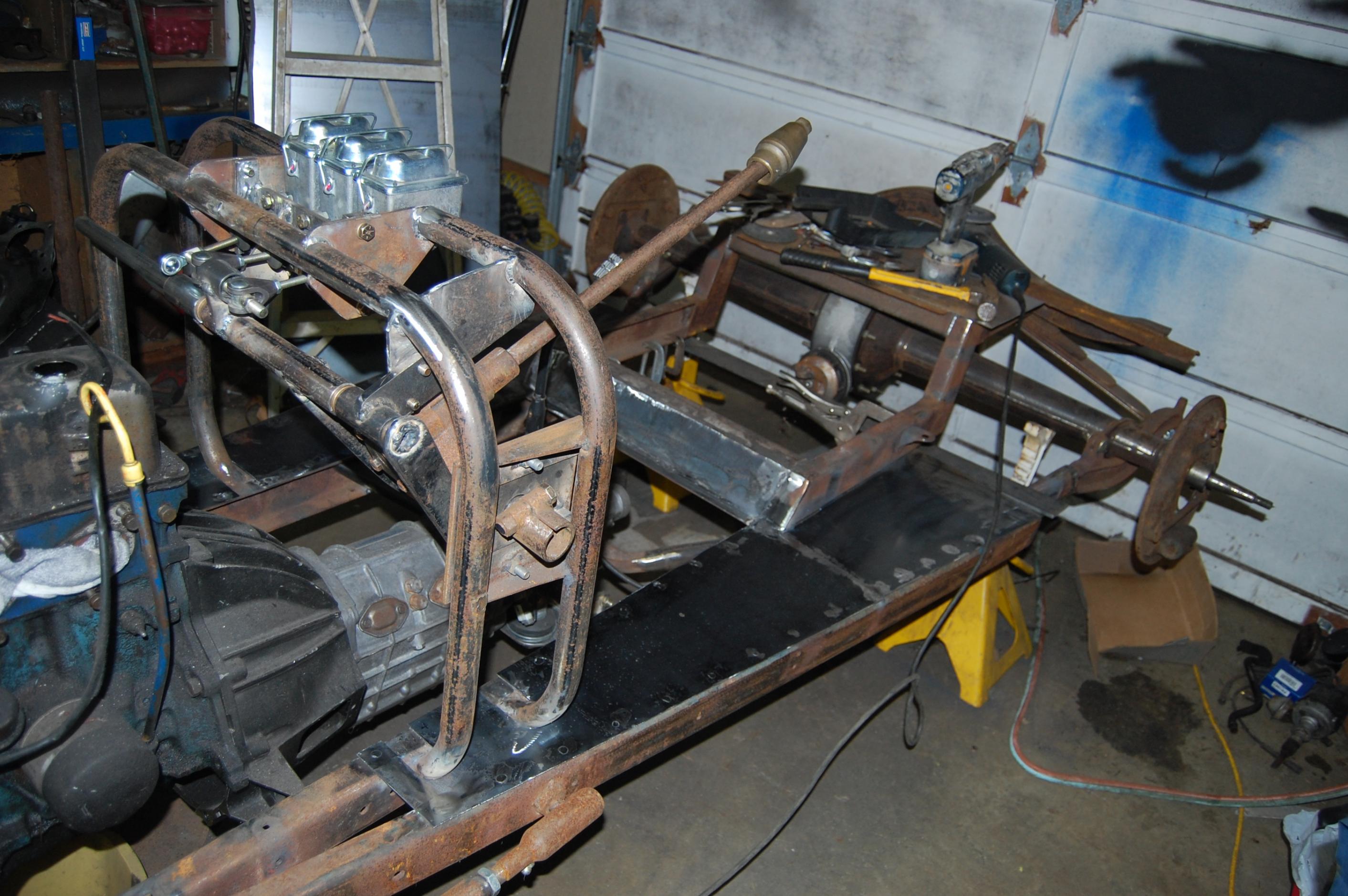

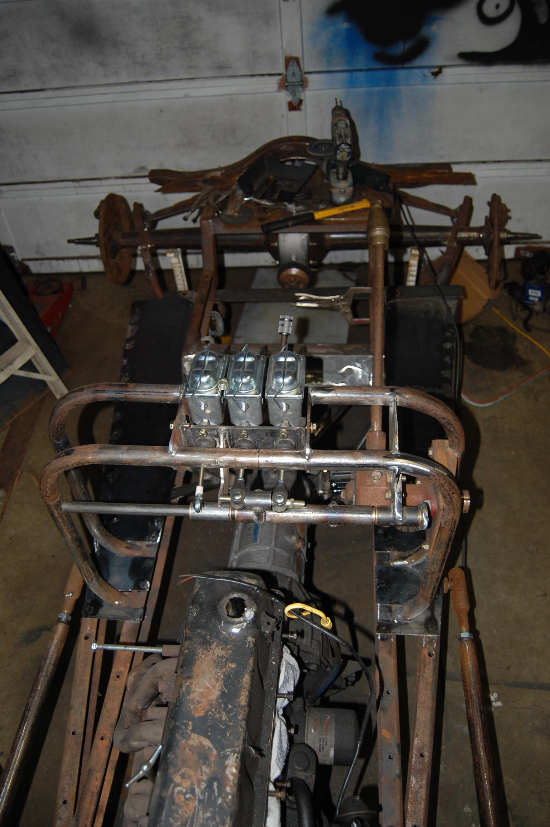

    I'M BACK! Well here we go. Took some time off to get healed up a little. Got sick and tired of being sick and tired and decided to get back after it. So far we got the rear end triangulated with the dropped front bones (46ish) Salted away the Flattie and decided to stay with the nice light 2.3 with a 4 speed. Always stay with your first thought. Built front biscut mounts for the 2.3. Then built a ******/rear bone mount couple weeks ago. Been working on the brake design. Looks like we got it figured out. (Oh Yeah!) Today we hacked out the fire wall and formed N s***ched in the new flat metal. SMOOTH.
    Heres a few pics.

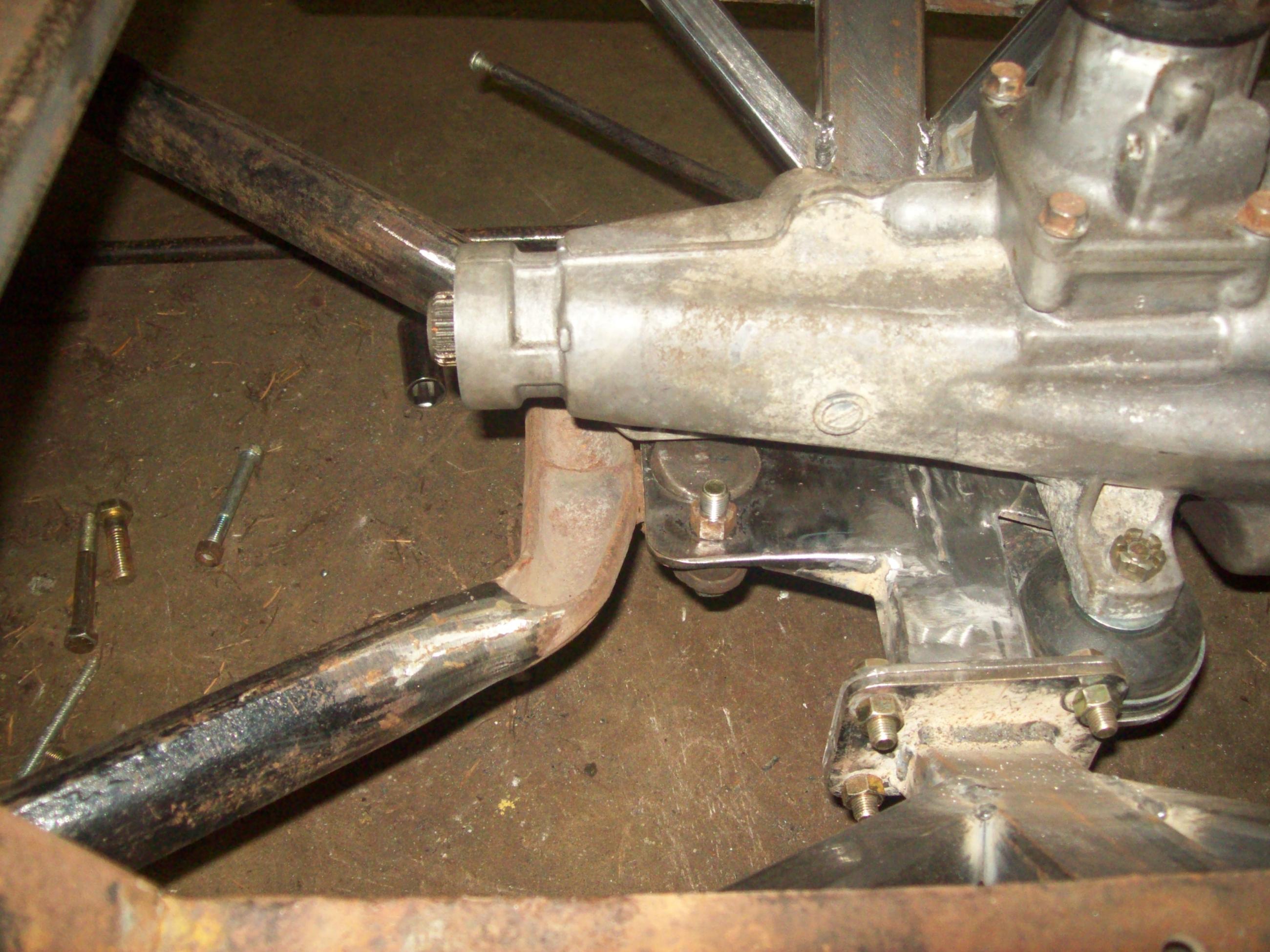

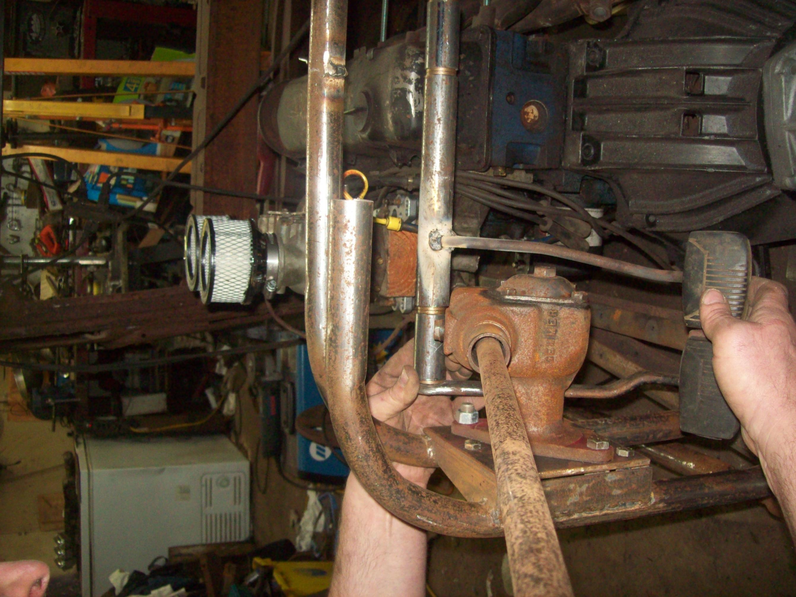

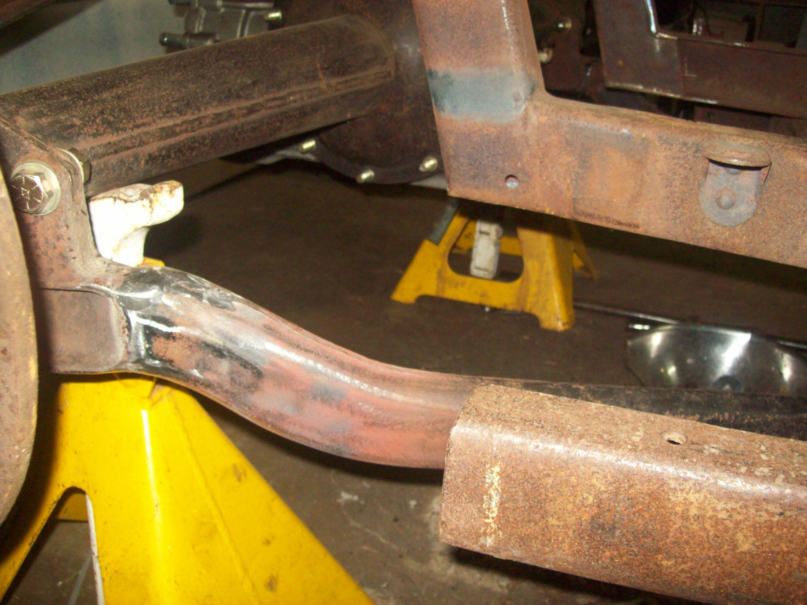

    Thought I would take a minute to try to get caught up a little. Forgot to take pics of the rear end after we got it put together. We used a model spring set on 35 rearend with a winters QC. Removed the 35 bones and re-triangulated it with late 40's dropped front bones. Gusseted in and tied back together with a model a ball. Just plated in the transition where we stacked the frame. Should help keep twist out of the frame and be handy when we put in the floor

    Getting the pedals built
    We didn't have a 3/4" bit so torched a hole and made it round. Filed to fit and tacked it. Trued it and welded it. This will be the clutch. Added our bronze bushings from the local hardware store. Built the brake pedal, and a couple tubes to hang it. Then check the fit .

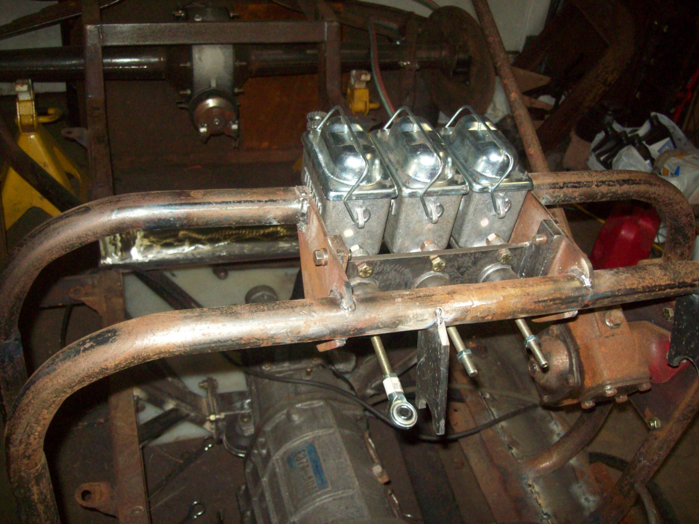

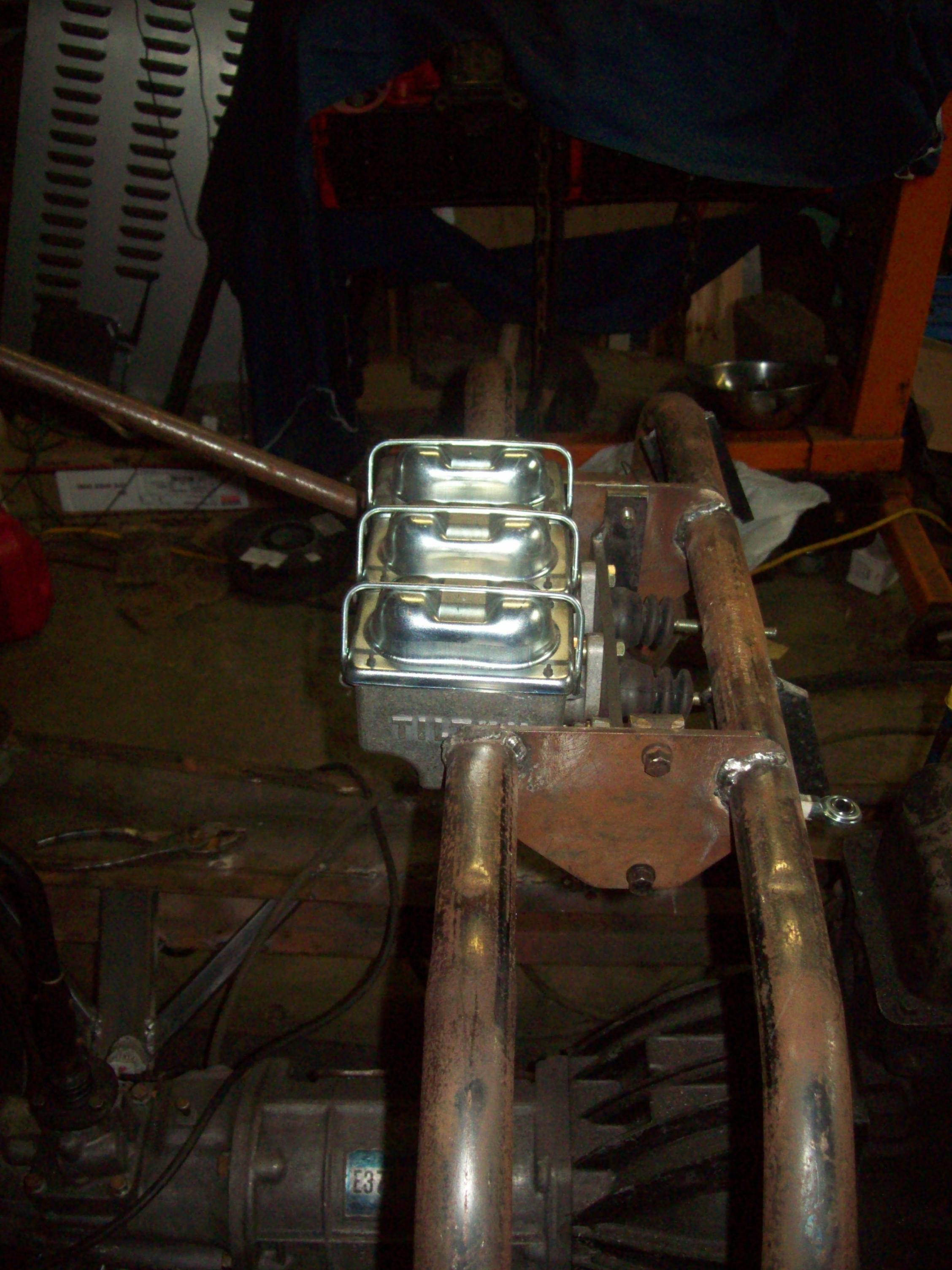

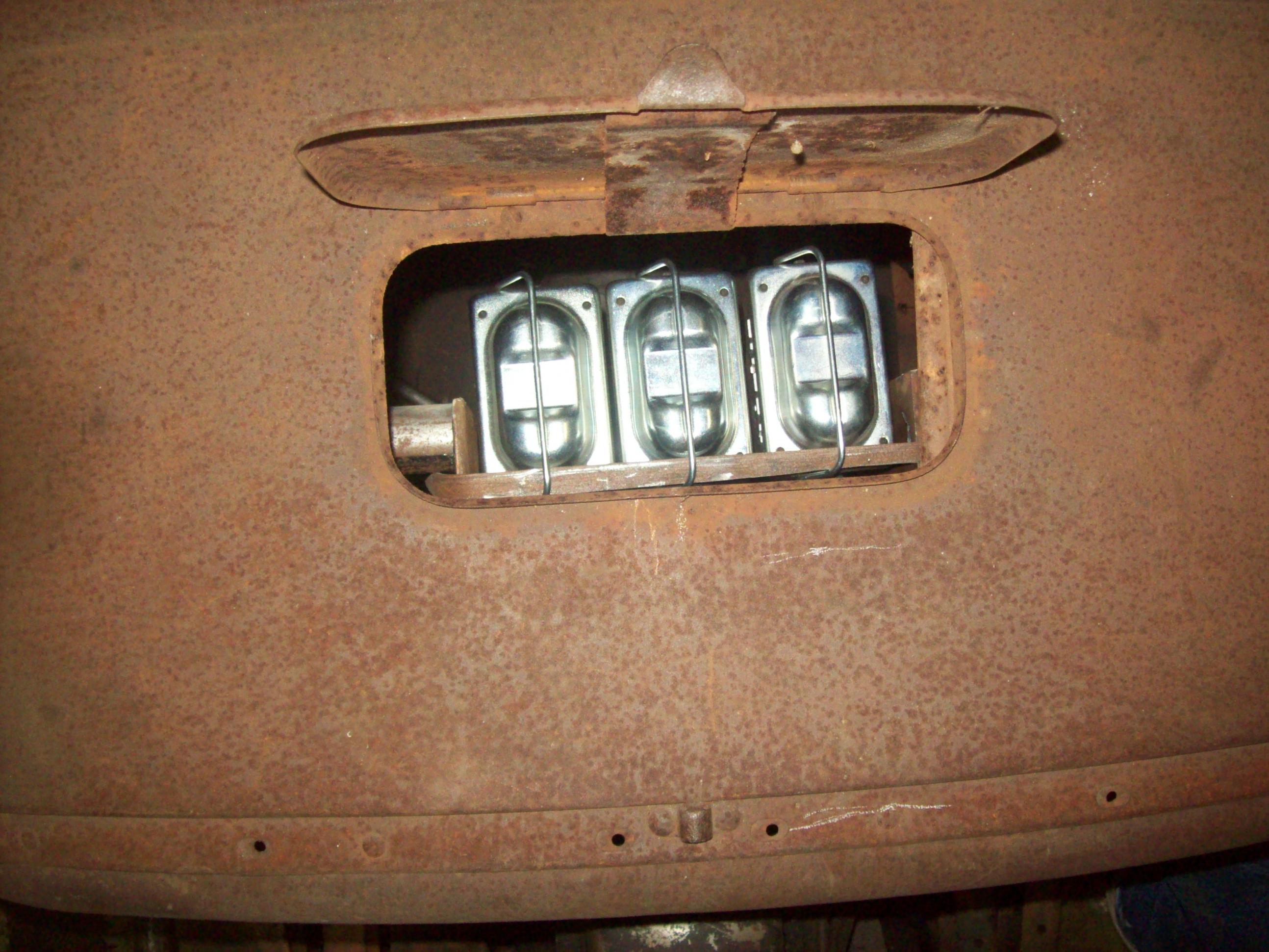

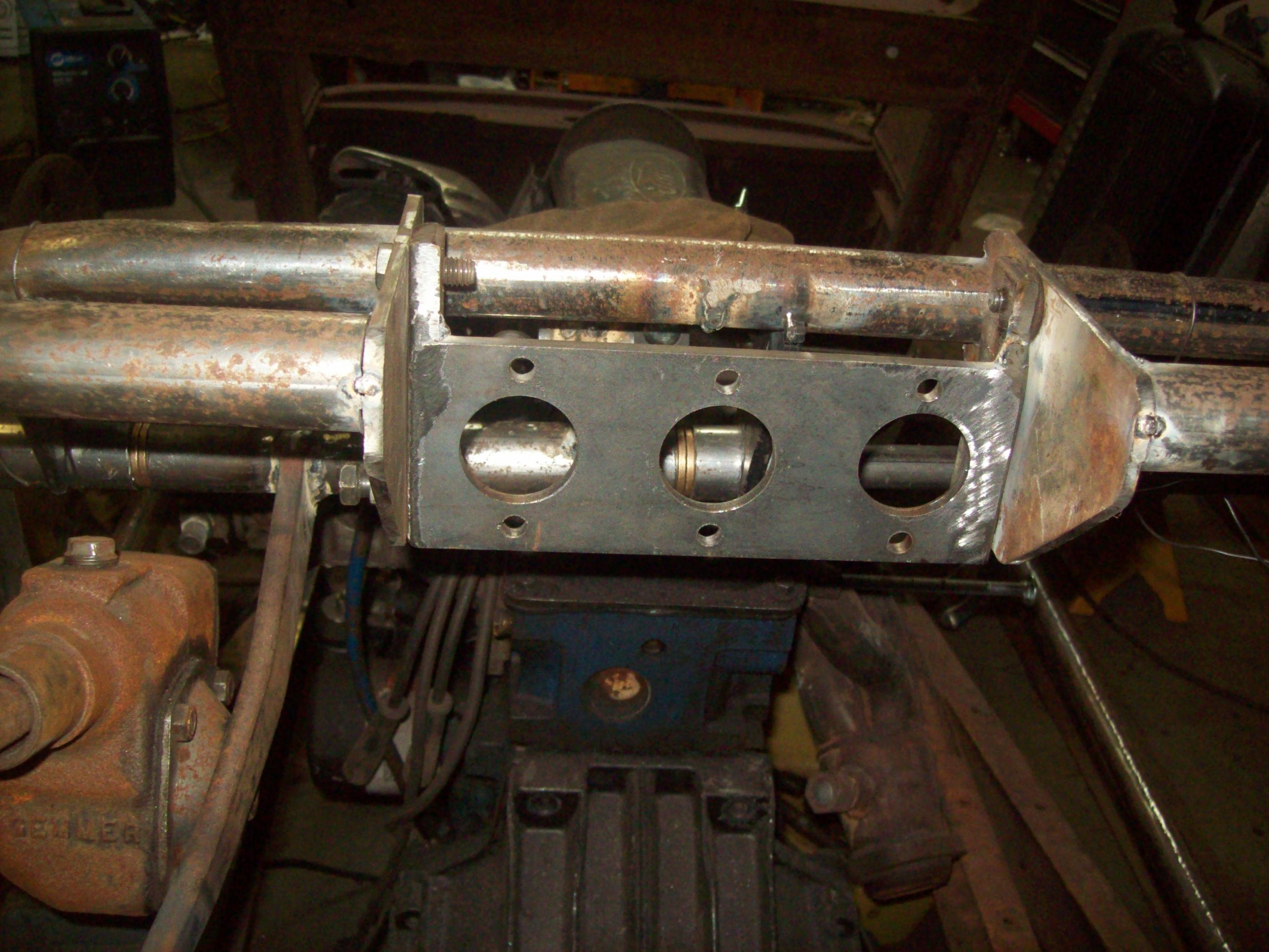

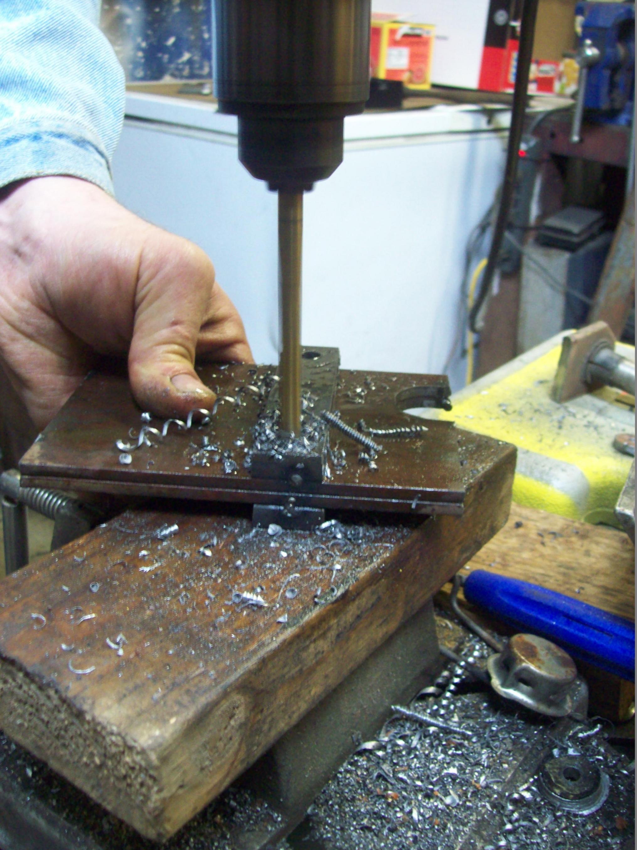

    Stayed in the shop pretty late last night We really wanted to get the masters hung. Made all the mounting plates in our high dollar machine shop. That old drill is the ONLY thing in my garage that says "Speedway"
    Have I ever mentioned how much I hate Speedway. Sorry!
    Got all the plates fitted and tacked into [lace. Used a thin washer to space the master cylinder mount for clearance when we powder coat.
    Nothing like building it tight and digging up the powder coat trying to get it to fit again.
    Set the body back on. Looks like we hit right on target. It'll be nice to be able to walk up, flip open the gas flap and check/add fluid for the brakes/clutch. Those "Tilton" master cylinders worked out absolutely perfect

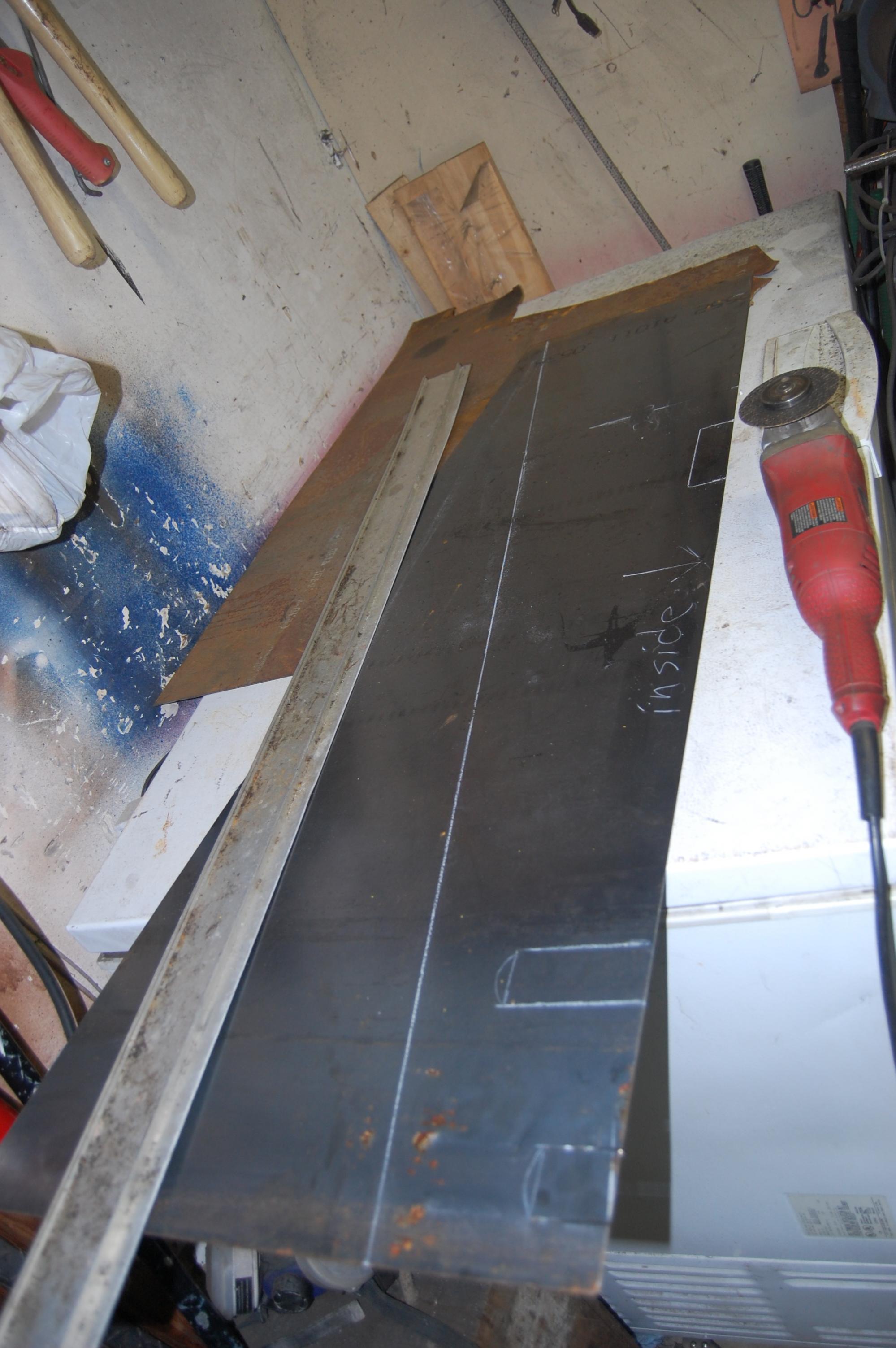

    Rather build then sit here typing. Got my second outer floor panel cut and mounted. pedals are mounted.

    Well heres a couple shots of cutting out and punching the p***enger side. Tried twice to get the fitted shot to load. Note the 70+ yo hole punch.
