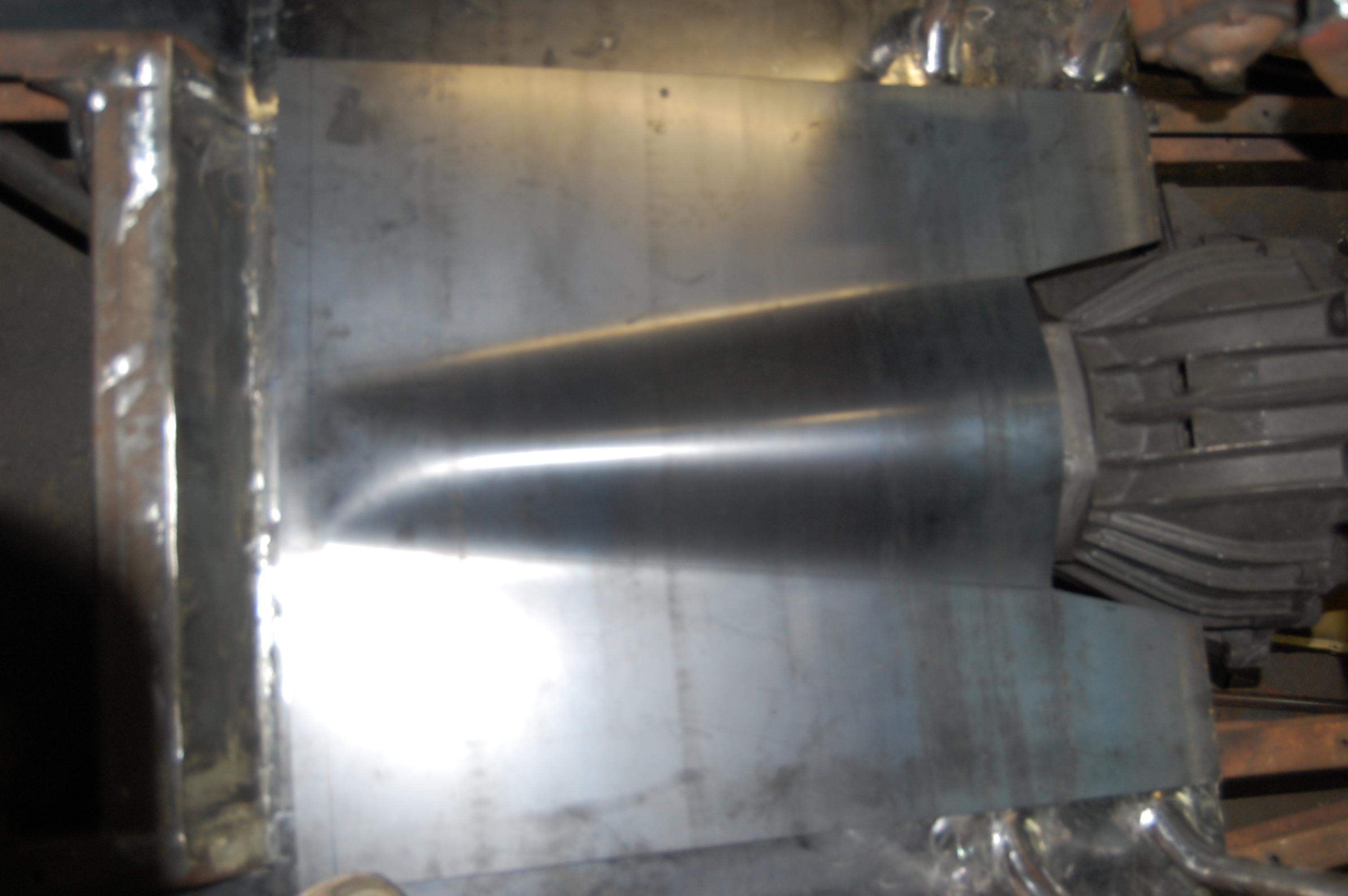

    Got the start of my inner floor shaped and laid in place. Not bad for a half hour, a couple cuts with the cut off wheel and a trip to the "Jim Ford Knee Bender 2000".

    It takes a good eye to make the bend that symmetrical. Great job!
    What gauge material did you use?
  3. fastrnu
    Joined: Feb 26, 2009
    Posts: 739
    fastrnu
    from shelton,wa
    Thanks!

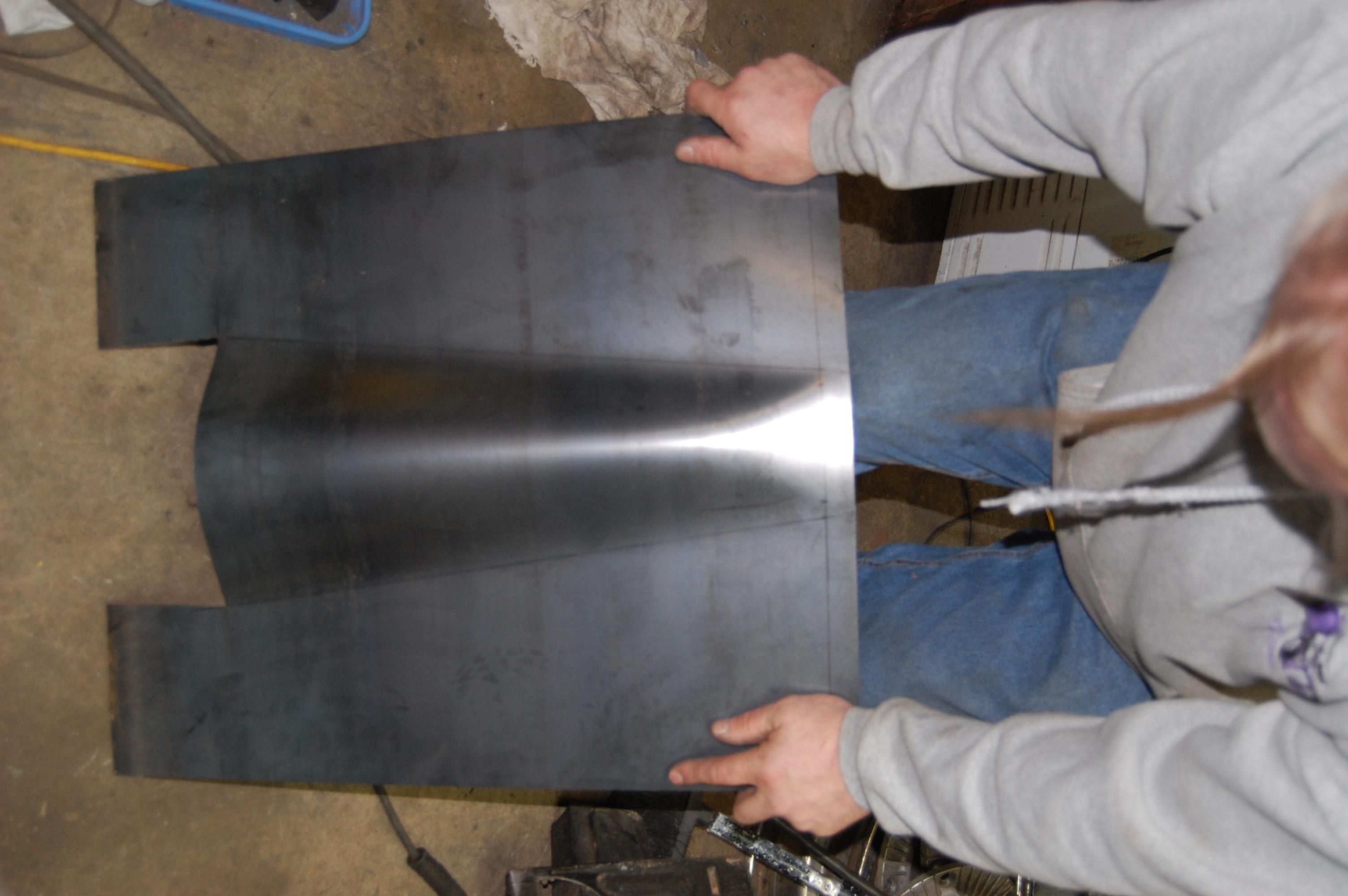

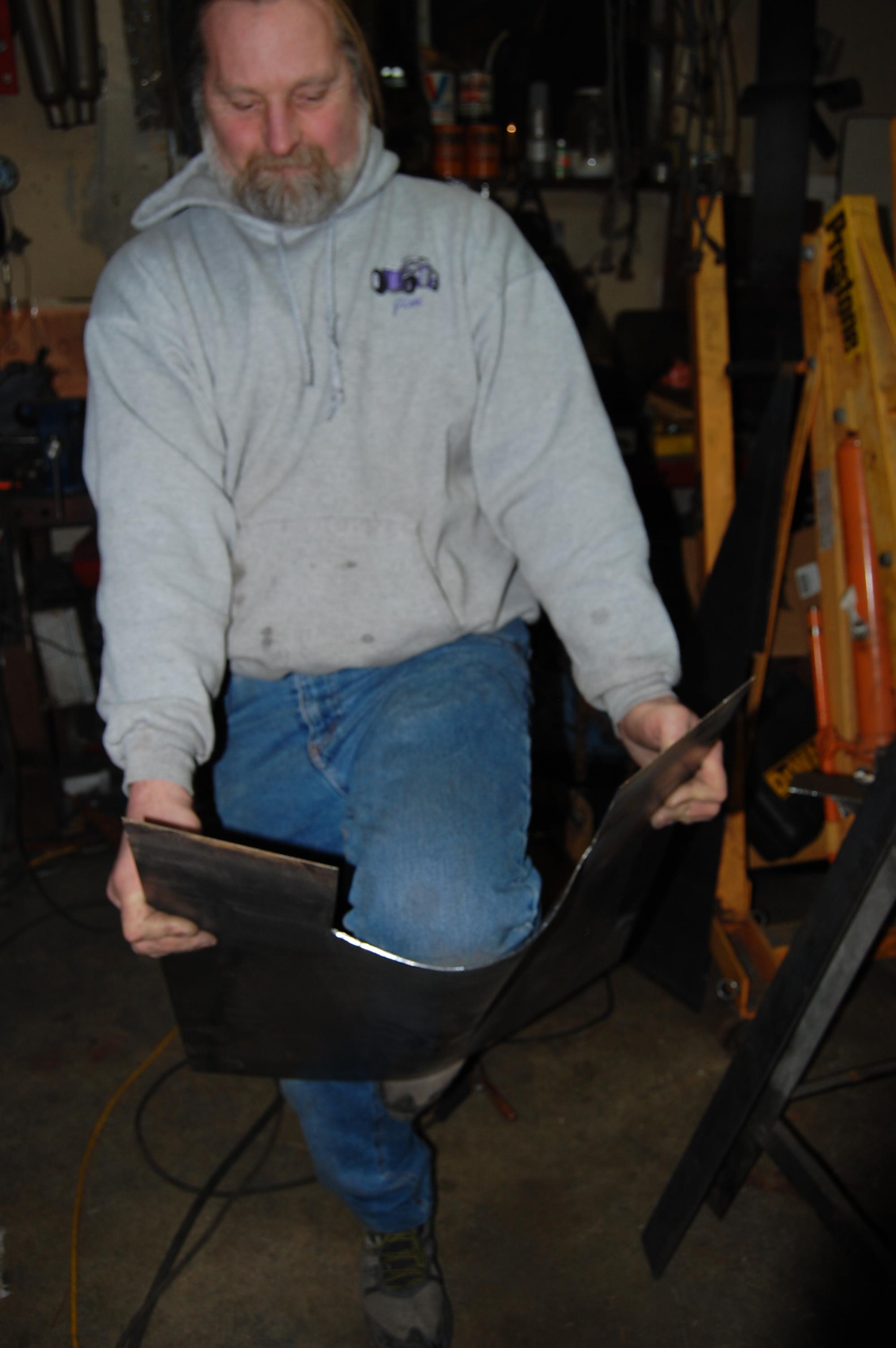

    We took a piece of 16 gauge and drew it out. Cut out the area for the bell housing. Laid it on the floor with a piece of 3"x1/4" flat bar. My son and I stood on the flat bar like a couple of ballerinas (NO TUTUS HONEST) while Jim bent it till we got the outsides bent. We'll be calling this "The Floor Brake".
    Stuck it in the Knee Bender and worked it into shape. Couple whallops with a rubber mallot at the *** end to bring the tunnel back to floor level.
    Once we add the piece for the bell housing it will be solid. Since I built this on a T frame the inside width is only 20" or so.

    That "Jim Ford Knee Bender 2000" sure works nice!!!
    That is one of the best transmission humps I've seen. :D

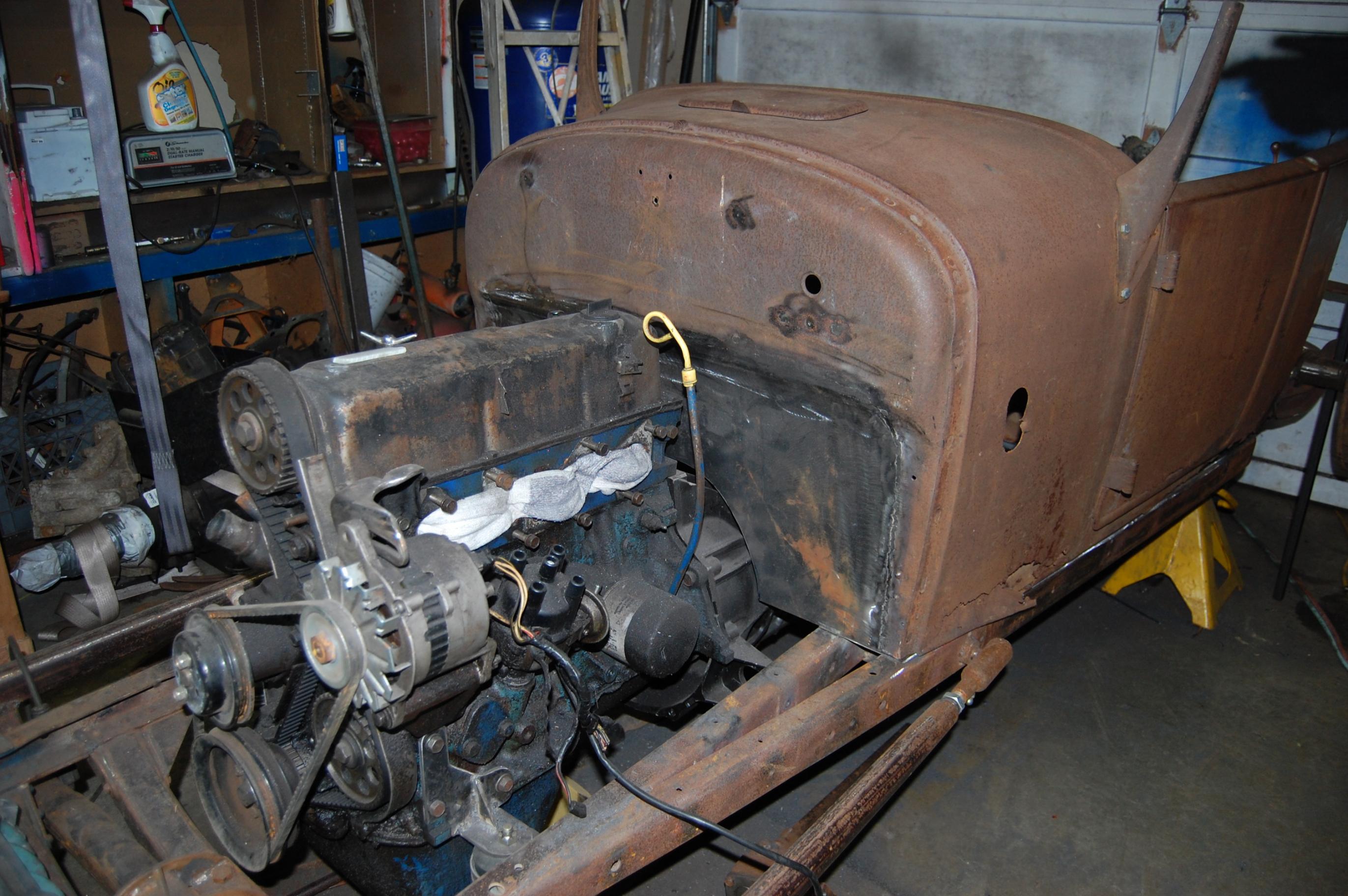

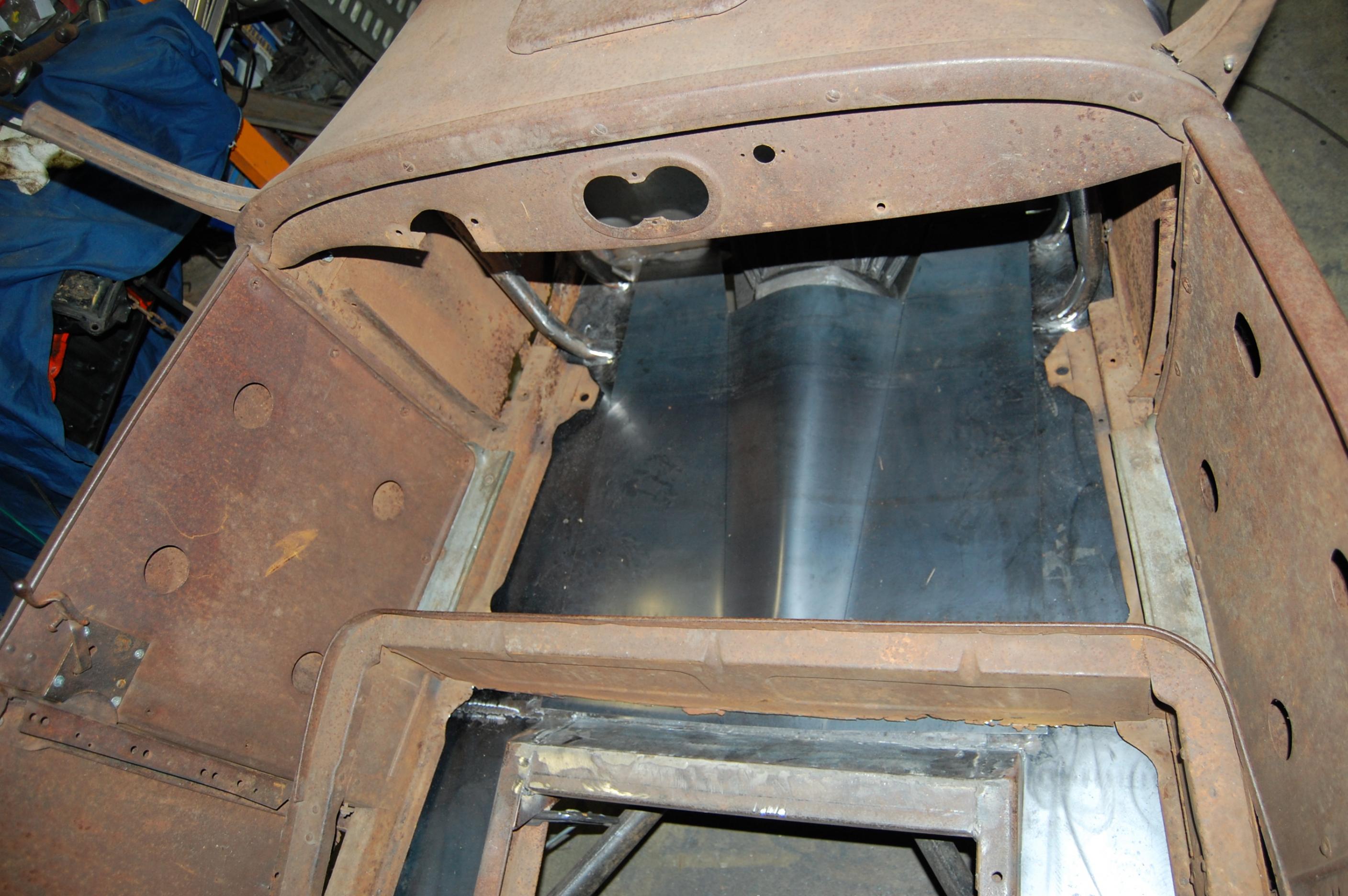

    Finally got some shots of the new fire wall formed and put in. We formed it on a piece of 1.5" exhaust pipe in a vise.
    Set body on to see how it works with the new tunnel. Looks pretty good.

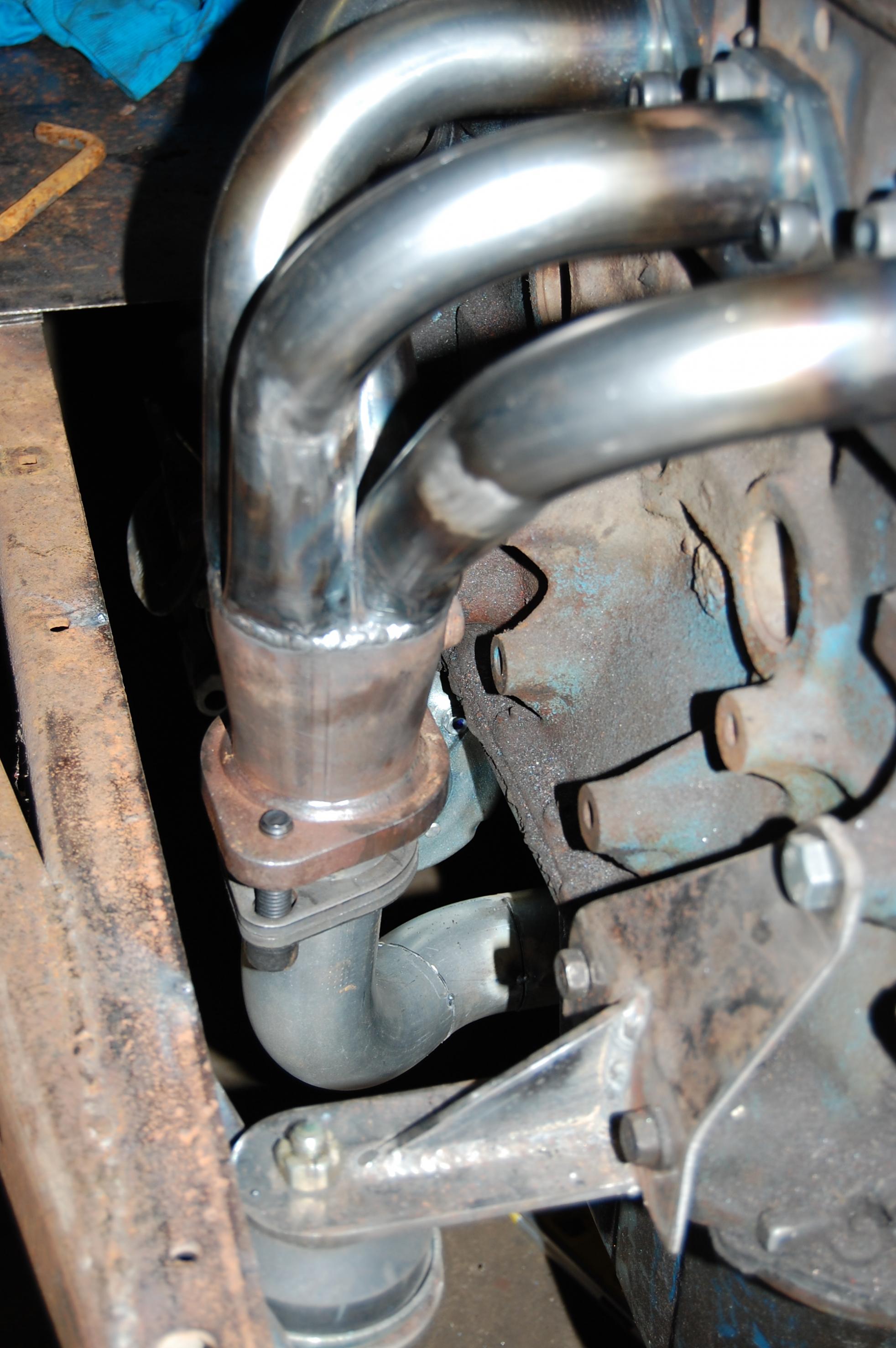

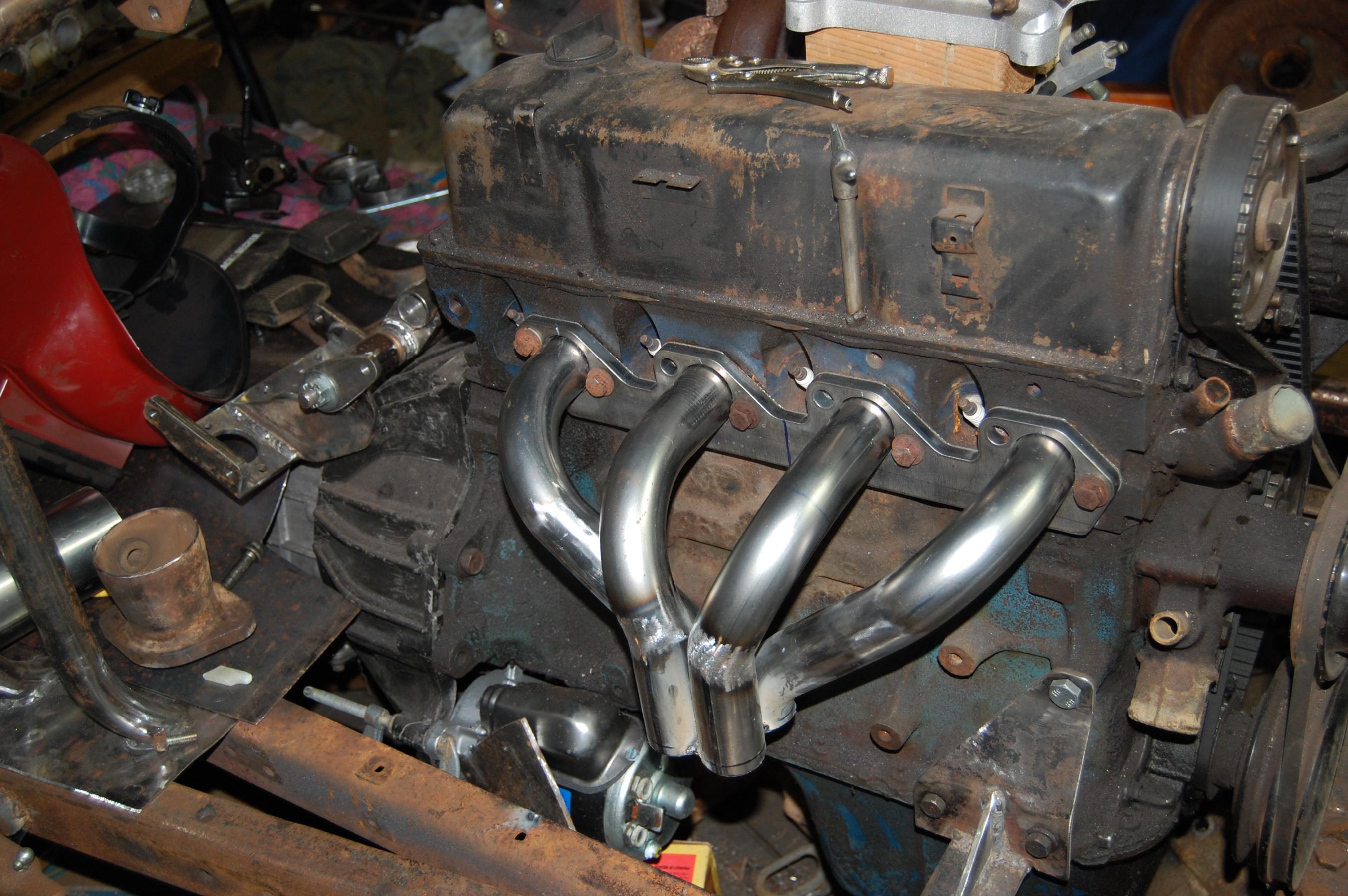

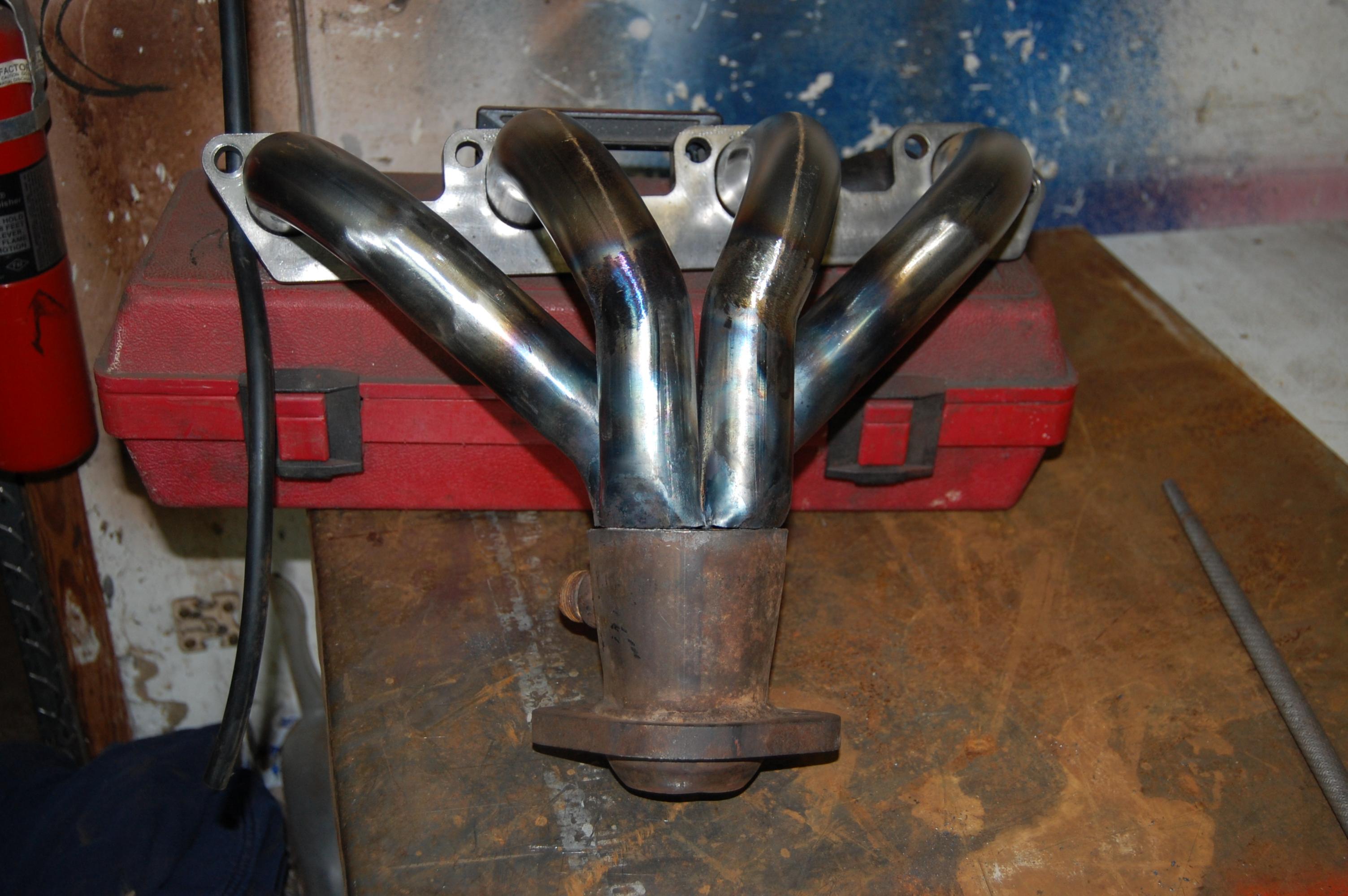

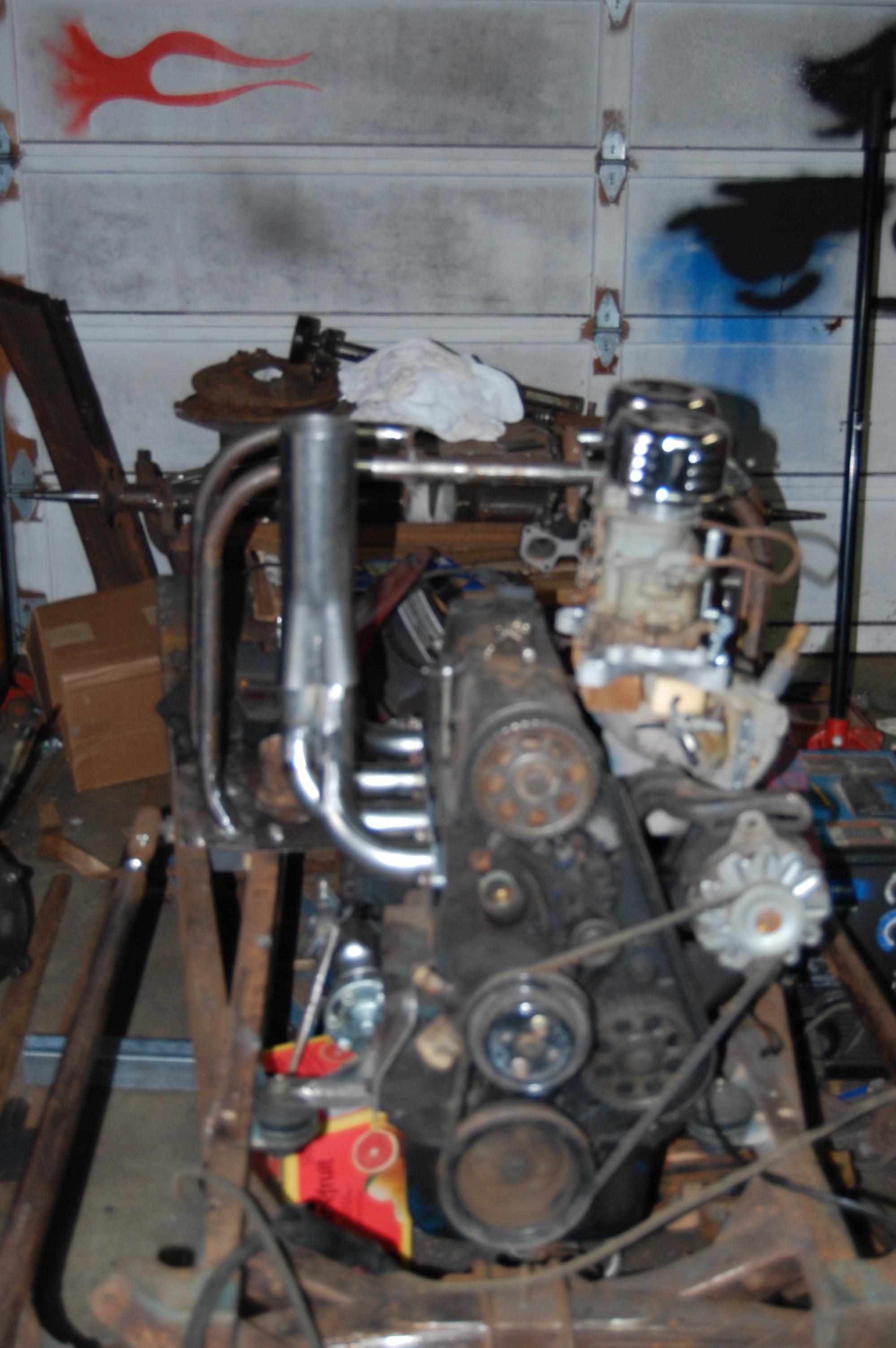

    Sorry about the delay. Found out I been fighting pneumonia and a broken rib. Heres some shots of the header progress. Plus a mockup of how the carbs will sit. I have my bro "Gator" making the aluminum adapter between my Eelco twin adapter carb and the stock turbo manifold.
    55willys should have the header finished welded t'morow the 2 1x4" bends showed up today so we can start building the header to turbo pipe next.
    First shot was for kicks and grins.....pitty the p***enger LOL
    Soon as we get the crossover pipe done they get sent off to the powdercoat guy.

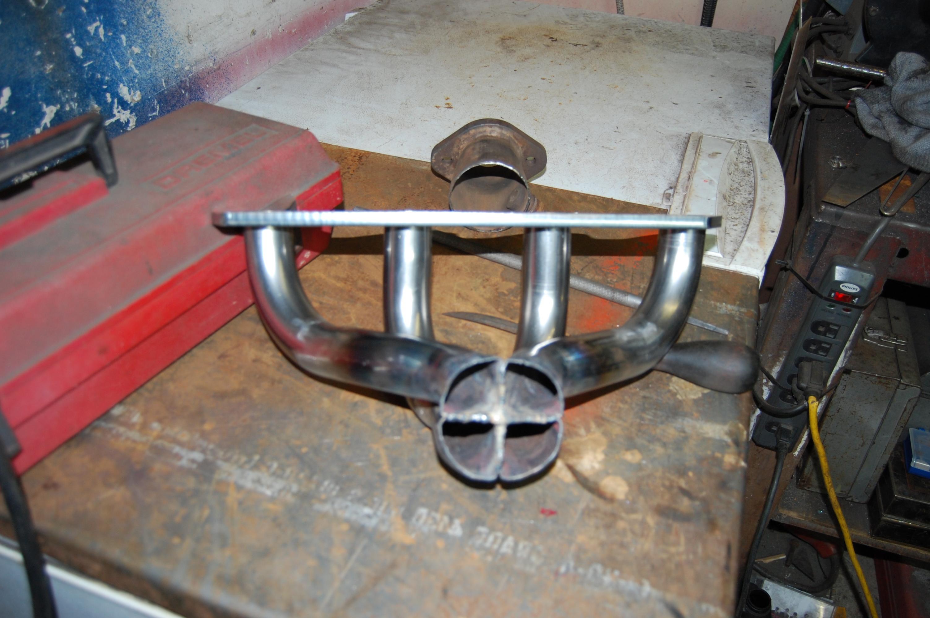

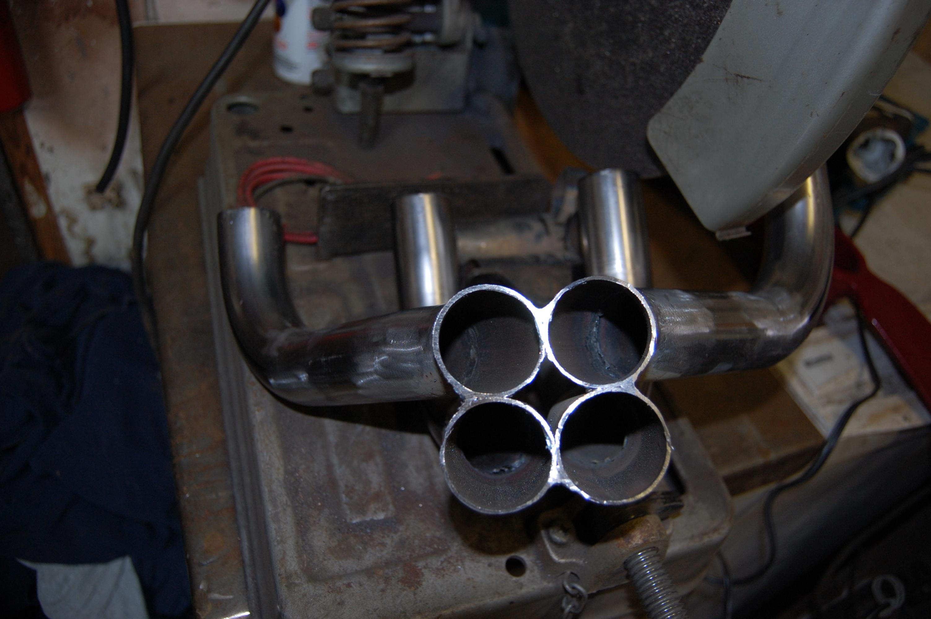

    heres a shot of the tubes getting ready to fit inside the old collector we scavenged of another 2.3. We heated the tubes on the inside corners and use a square punch handle to make the inside 90's.

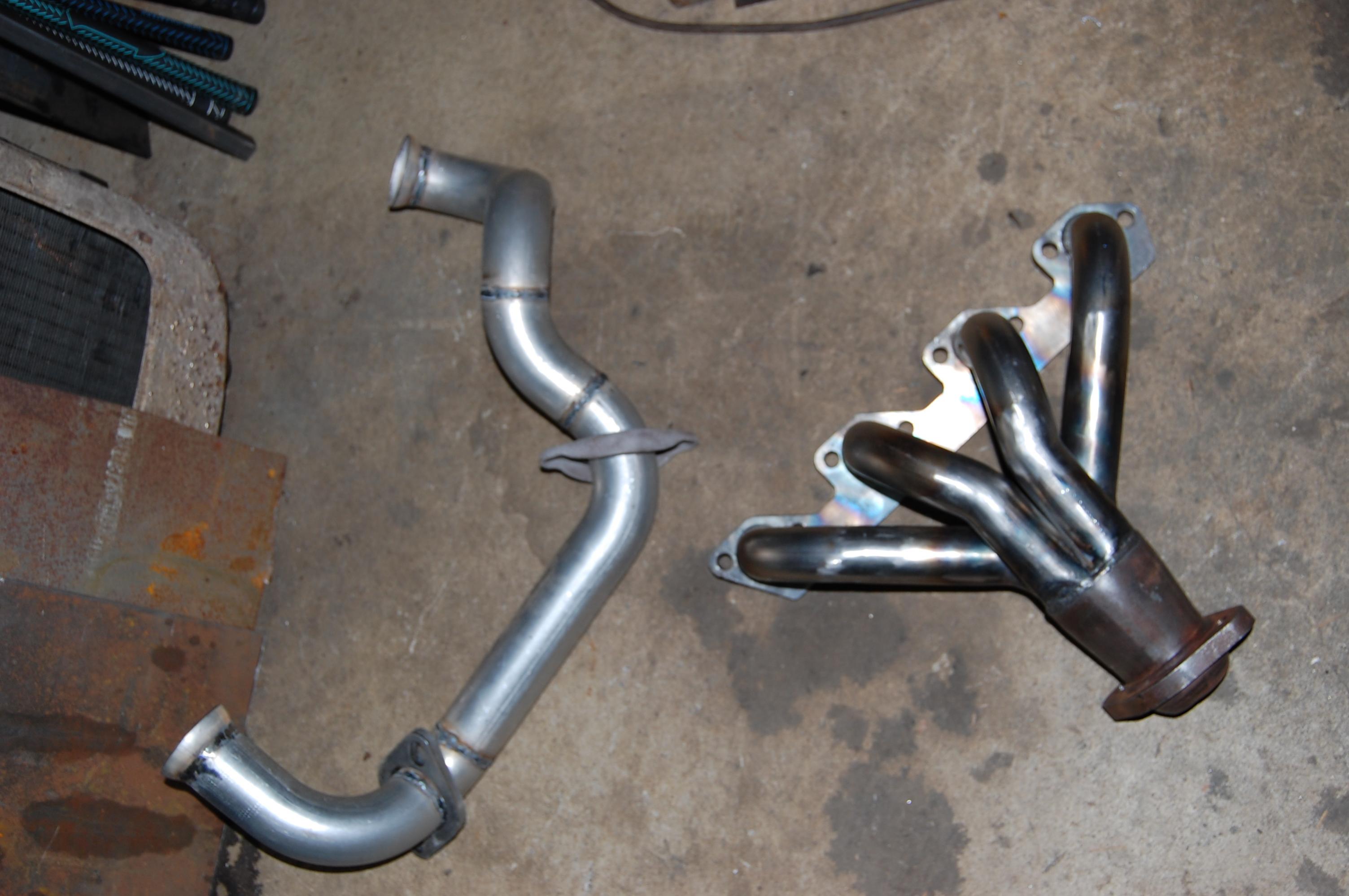

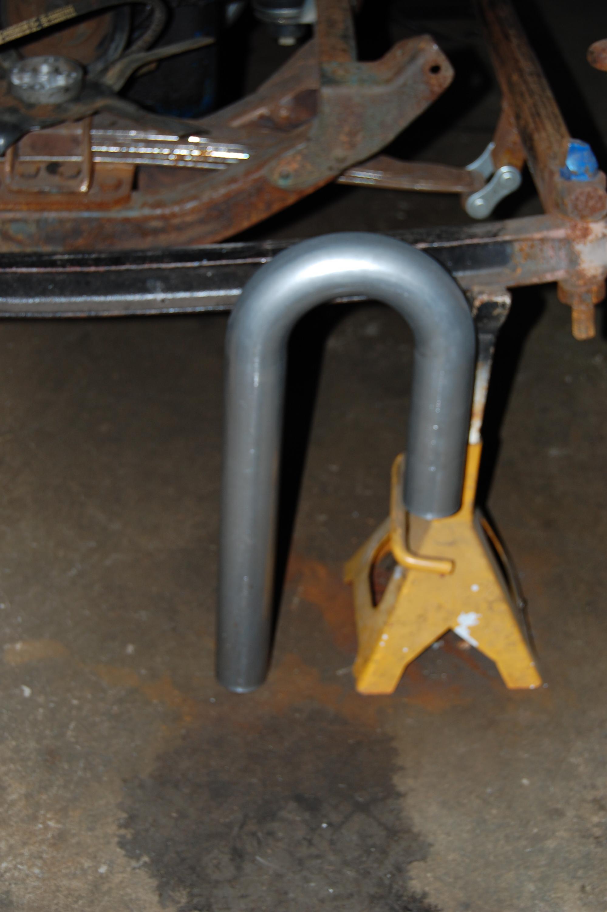

    Spent last 2 days workin with 55willys building the crossover from the header to the turbo. Gotta say he's an artist with a cutoff wheel. We bought 3 J bends and went after it. Mission accomplished. Now it gets taken back out for the 27th time and will get tig'd. On schedule for next Thursday for the crossover and header to go get coated. Starting to move a little better right now. Found my Model A shocks today need to get back to pimpin attorneys, bux are getting a little low.

    Also 55willys finished the TIG welding on the exhaust. Plan to dismantle the turbo t'morrow nite so we can send it all off to get coated. 55wills buddy is taking a cl*** this weekend on doing Cerakote and needed some pieces to do in the cl*** and I need an affordable type deal. At $18.00 for a 1" by 1' strip I sure need any break I can get. Will post picks when they come back
