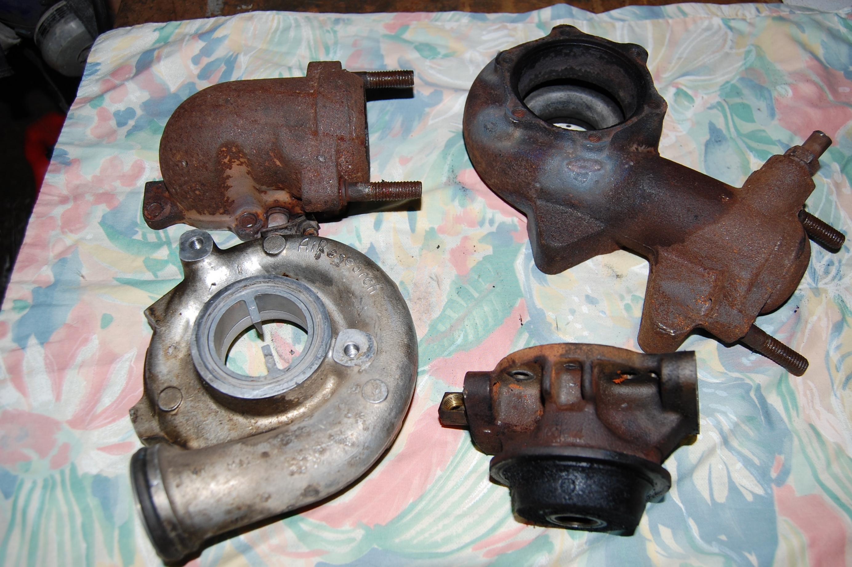

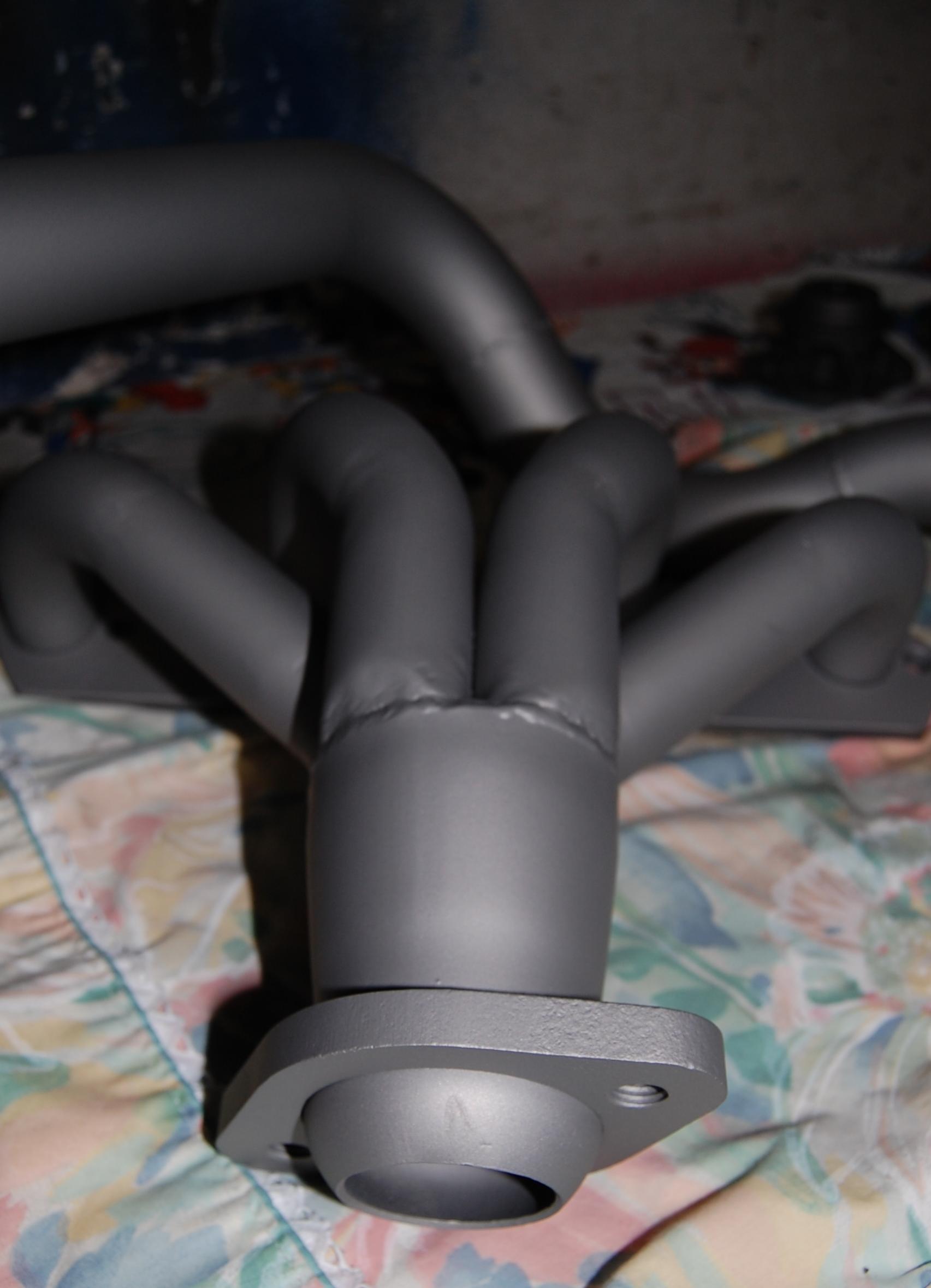

    Heres a shot of the turbo getting ready to be coated with Cerakote. Good to 2,600 degrees

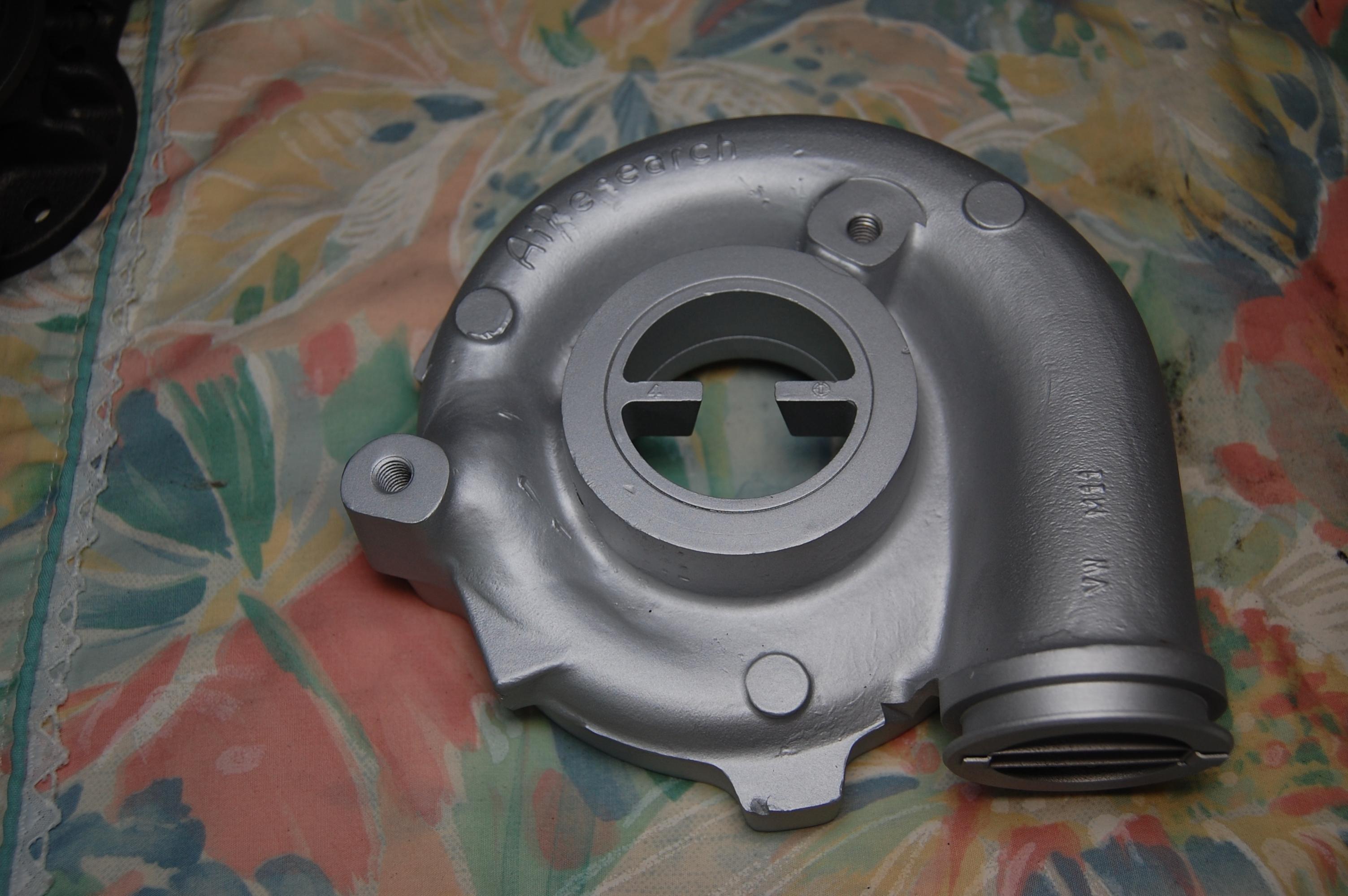

    Turbo parts come home from coater on Monday. Still need to order rebuild kit.

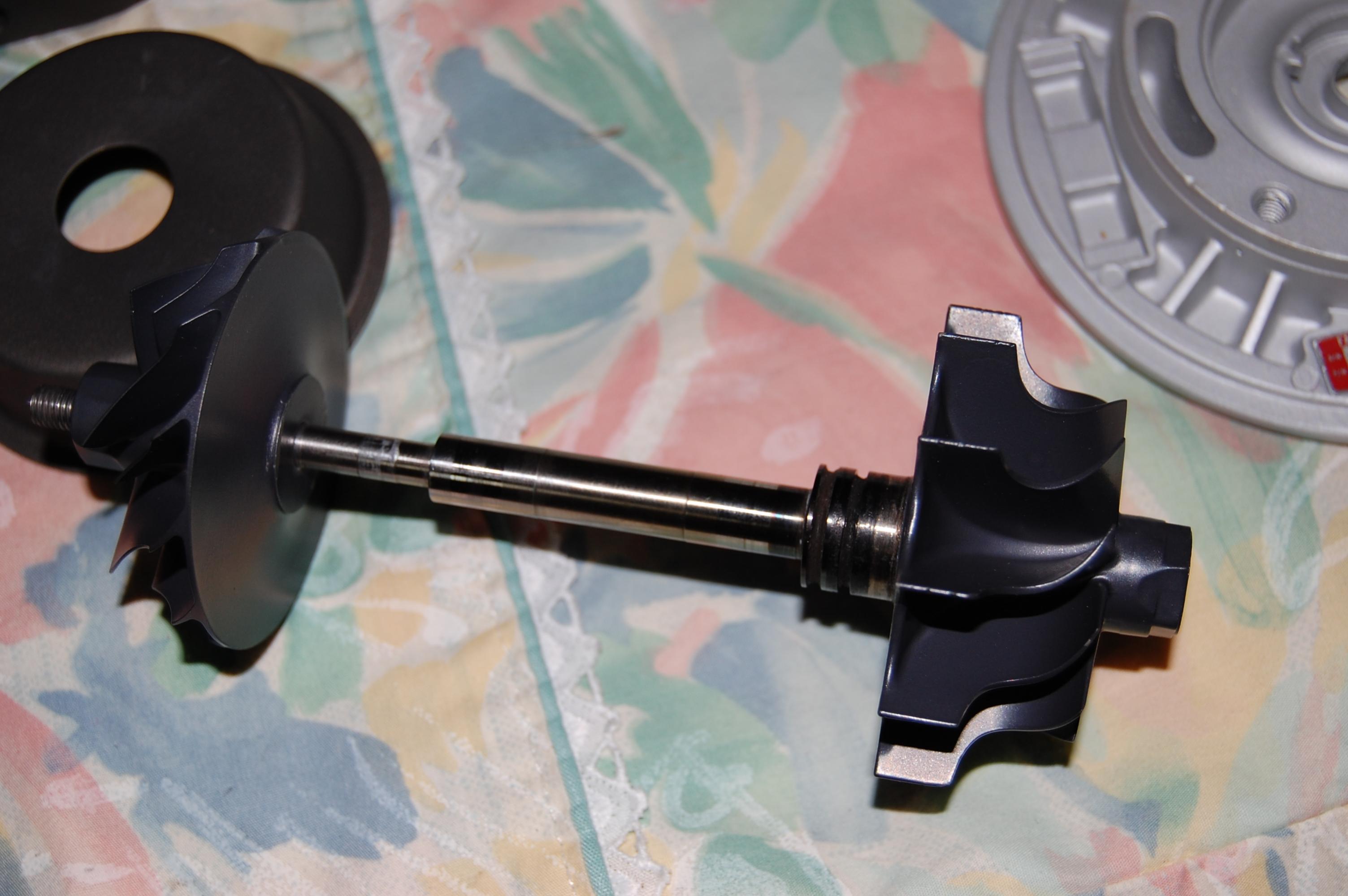

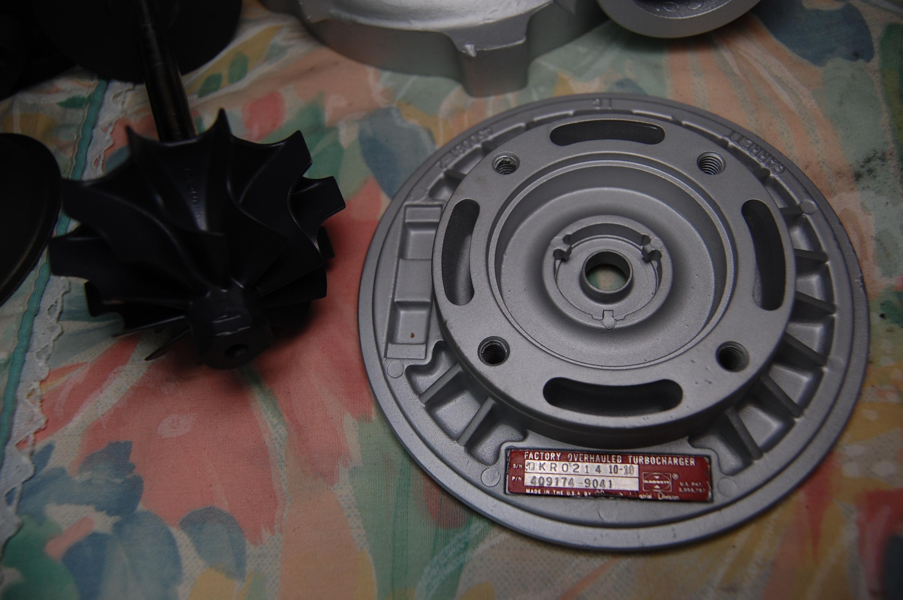

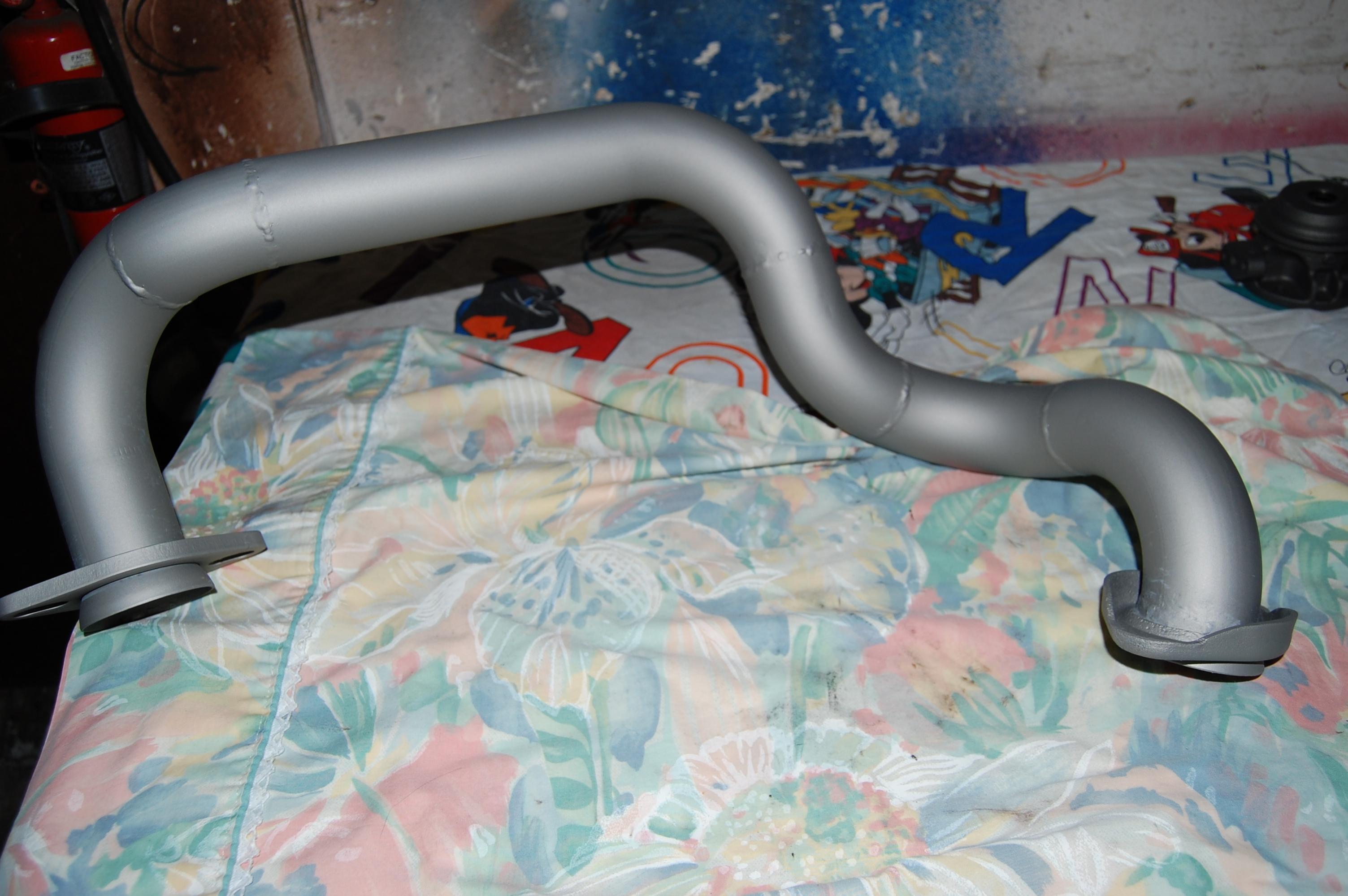

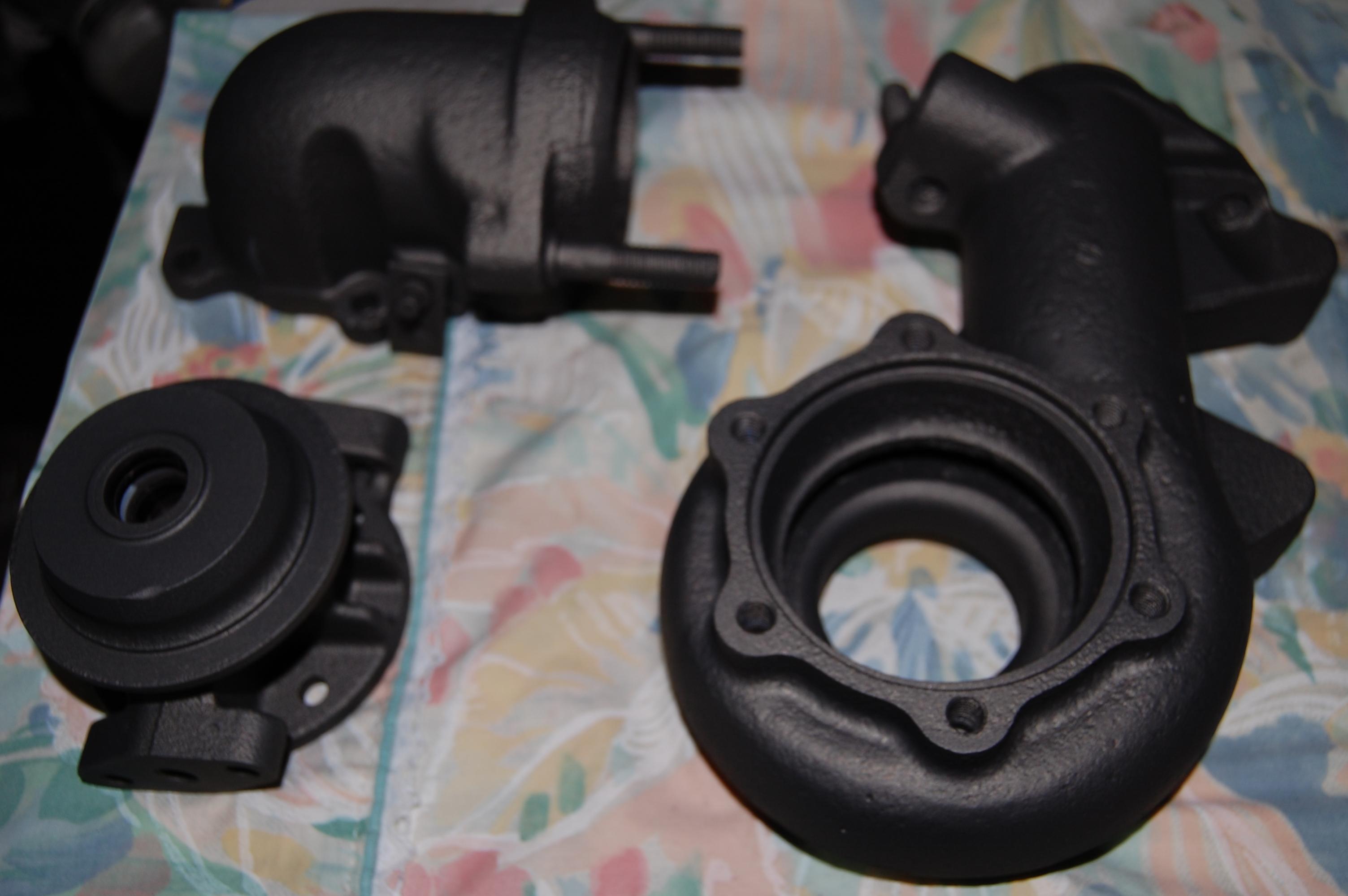

    Got my blower parts back from the coater. Totally impressed. Now send off to G-Pop to get Compressor wheel and turbine shaft re-balanced. The aluminum was to stained for clear so Jason went with an aluminum finish on the housing. I appreciate how clean he kept his work. Note the old rebuild tag! Total cost 0.....Thanks Jason!.

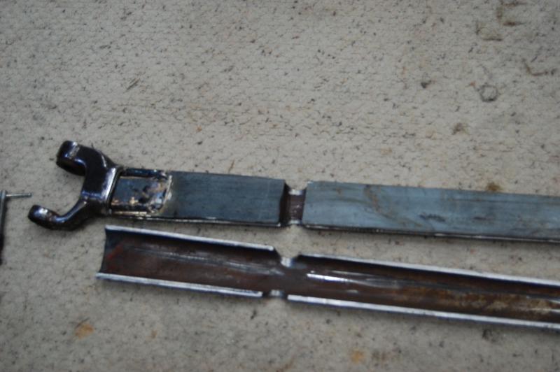

    We pie cut the ends of the front bones set them at 10 degrees over the weekend.

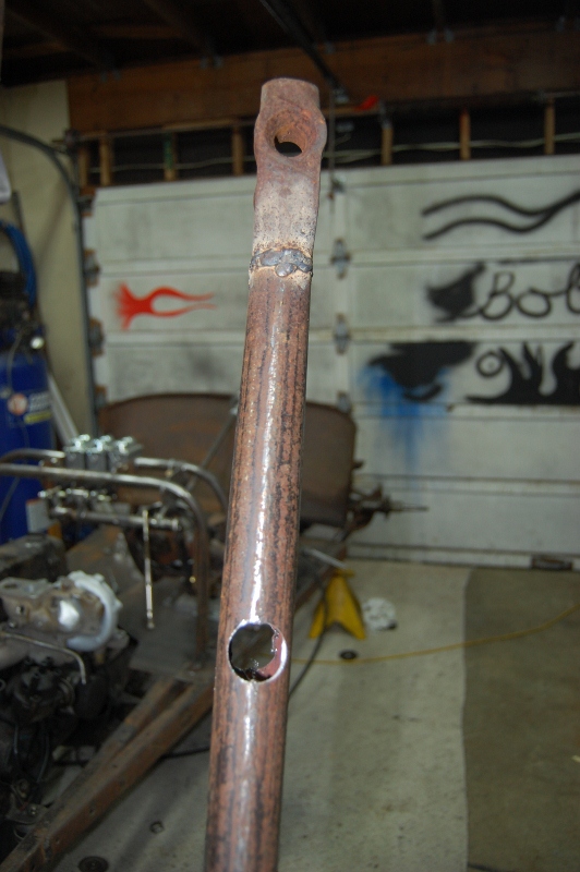

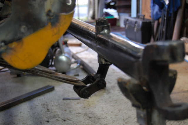

    Got my first bone back together yesterday. Thought the 11/16th DOM looked kinda small sticking out of my bone So I called my local shop and they had some pipe with .995 ID. Grabbed a chunk for a buck and cut sleevee to go around the DOM. Filed the seam down on the inside and removed a little material aon inner wall. Then I persueded them over the DOM with a 4lb hammer. First rule of physics: "with enough force anything will fit". Now they look more substantial and fit the look of the bones. Left a little material on them for when 55willys machines them to fit the perches.
    Note: I left the bottom bung un-welded for the pic to better show what I did.

    Another full day at it > Got the second bone done for 55willys to take up to Bremerton and machine the new bosses for their perches. If things went right he should be showing up with some original A perches and shackles.
    Ya ever have one of those day. where the harder ya try the worse it gets. Got 2" of the left middle finger with my 4.5" grinder. Ran right up it. Damn that stings. Still didn't put the gloves on so I could get my index finger too. I quit with a pair. Wasn't going to try for 3 of a kind.

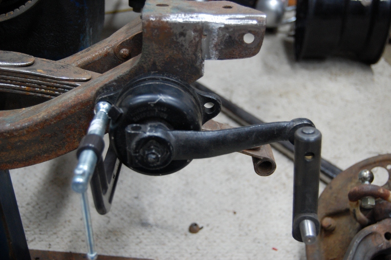

    While the bones are off getting machined, lets get after shock placement. We wanted to keep them close to the axle and as outboard as possible. We decided on the front of the frame was a great place. Just needed a good spot.
    First I piecut the wings on either side of the T frame, and laid them down. The shocks lined up perfectly using the lower inside rivet. Perfect locator. Grind it and drill it. We needed a filler piece for the outside boly and to keep it from looking like it was just hanging out in space. Made a quick template. Scrounged through the s**** box and found an old piece of a B.K playground i got paid to haul off 19 years ago. Thank you Burger King! Their 18gauge made a great floor for my Avatar. It works out perfectly for the little piece it is. The template will just get flipped and work for the other side.
