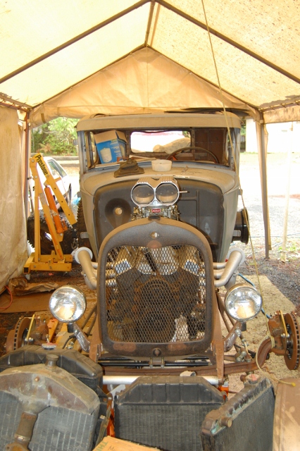

    006 (640x426).jpg 005 (640x426).jpg A buddy came by looking for some model A part so 55 and I got him to help get the body down and set it on the frame to get a current perspective. Keep the vision fresh in our minds. Here's a couple shots...
    The tires are Goodyead bias plys...750-16 in the rear = 32" high which puts the spindle at 16" off the ground. Fronts are 500/525-16 =27' which puts theier spindles 13.5' off the ground. thats 2.5 inch rake on a 96" wheelbase.
    Front cross member sits 3.5-4" off the ground. Right now trying to decide on whether to go with wide 5's or wire spokes. It seems traditional rodders like wires, racers prefer wide 5 for less wheel flex. Got both seem to keep twistin it in my mind.

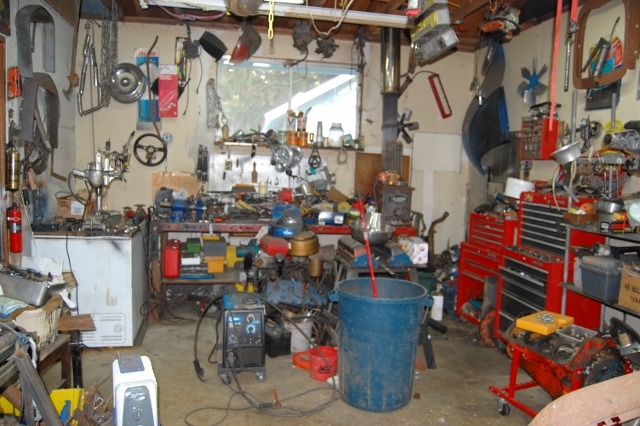

    010 (640x426).jpg 007 (426x640).jpg 008 (640x426).jpg "WOW. Let's just say I have shuffled, what I thought was a capable garage....and have added some really cool tools of late.....keep it going, so I can keep learning !!"
    Here's a couple shots of my high end shop and a shot out the door of momma's 31.

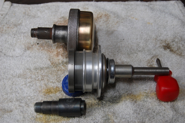

    7 degree reemer came. now we can clean up some holes, cut some new ones, and put things back together.

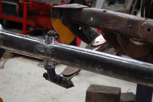

    Since we got the reamer we have reamed the 2 steering arms ( still need to do a little torch work on them) Also reamed the hole on our steering loop so we could put a tapered model a ball in it. Finaly made the cut and shortened the drag link. Would post pics but blew it back apart and am going after getting my A shocks mounted. Will post pics in the AM. Been a long day heading for the hay.
